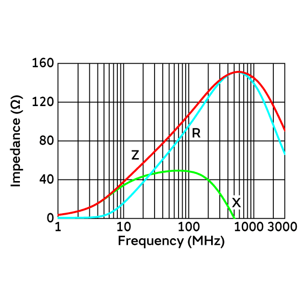

i delibaretly choose the last ferrite bead to be effective even in the 2-3Ghz range (WLAN) while offering low DC resistance (22mOhm)
add to this the pi filter configuration

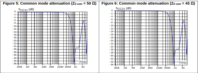

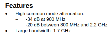

and the common mode choke on usb lines:
very good to filter out usb signal harmonics from what i understand , and its even a bit effective at wlan range (around -15db)
from what i read thats not only it, just part of it..... the general high impedance will also REFLECT noise, searching some more low impedance path, thats where its crucial to not leave a "open drain" to your hifi systemYes, this is basic physics. Read here how ferrite beads filter noise:
https://www.analog.com/en/resources/analog-dialogue/articles/ferrite-beads-demystified.html
"A ferrite bead is a passive device that filters high frequency noise energy over a broad frequency range. It becomes resistive over its intended frequency range and dissipates the noise energy in the form of heat."
