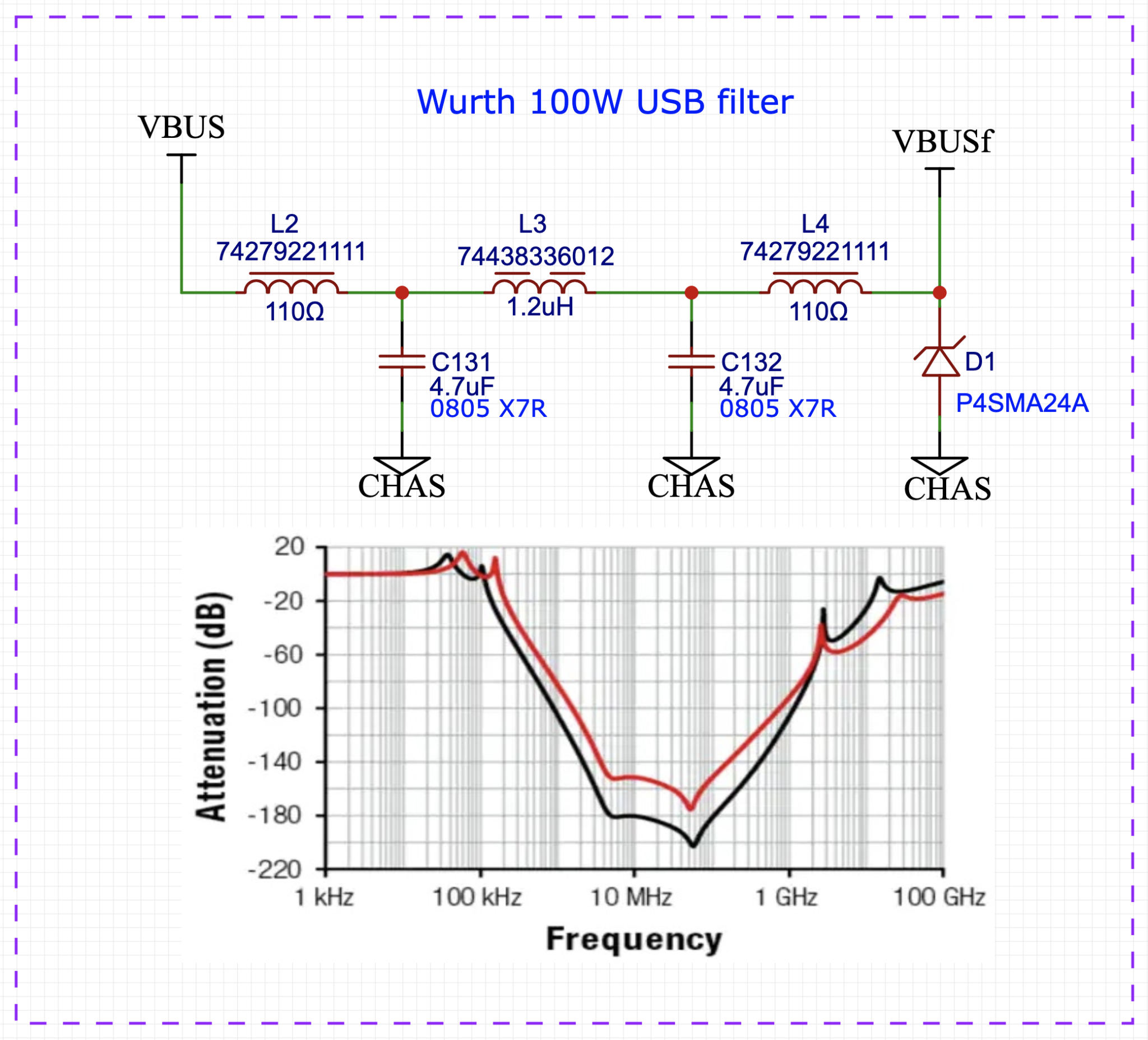

i have to say, im not doing it because i think this "THE usb fix" but it may be very well a improvement with many dacs which atleast should be explored 🙂 specially the filtering on each cable end made me curious since its not often seen, actually the only time i seen it was in these neutrik emf filtering connectors and i think they did this for a reason, not because its fixable inside a device but additional filtering might just help "more", specially with bad implementations but where we draw the line between good and bad here?

^That type of filter can be good when the main problem is USB +5v power rail noise relative to USB ground.
However, there can also be a problem with USB power ground noise forming a ground loop once the dac is connected to the AC power ground. Even if there is not a ground loop in the sense of a wiring path back through the AC line ground, there can still be a problem where the USB ground acts like a noise antenna and radiates noise into dac or other downstream circuitry.
So, the overall best solution is wideband galvanic isolation in the dac, with care to also avoid radiated EMI/RFI coupling. As said before, it can all be done pretty well in the diy case. However, a USB isolator by itself may or may not be better. Turns out Topping makes a USB isolator product. My sad experience with that one is described in a post at: https://www.diyaudio.com/community/threads/problematic-usb-isolator-unit.399247/post-7356655

imo galvanic isolation is the way to go, the question is if additional filtering afterwards can be beneficial, in the case of the HS01 i pretty much think so, might not be the case for all isolation circuits tho

which measurements do you wanna see ? im pretty sure this filter "does something" as the datasheet/common sense suggests, exactly, we end up arguing wether its audible either case, just move along please...From what I have seen so far some people don't seem to know how to take measurements and so have to resort to unsubstantiated claims based on purely sighted subjective listening.

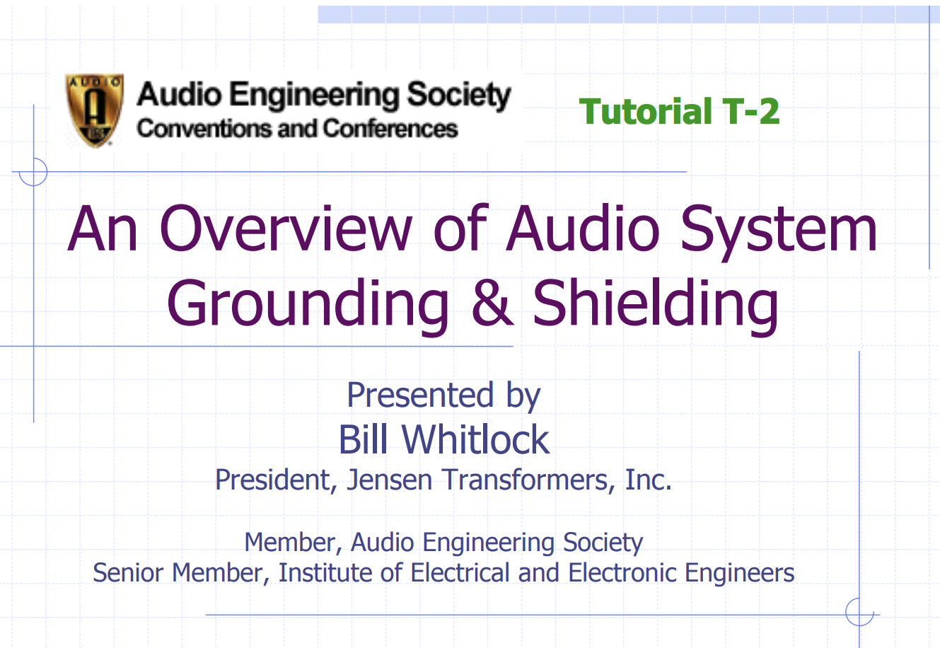

Even Bill Whitlock doesn't seem know how to measure all the noise effects he has found in audio equipment. He said the evidence of a noise problem can merely be the presence of, “Veiled" or "grainy" quality in audio. How do you measure veiled and or grainy?
And BTW, Whitlock did not publish any controlled listening test proof of his claim in his document I quoted from. Nor did he publish such proof anywhere else I am aware of.
