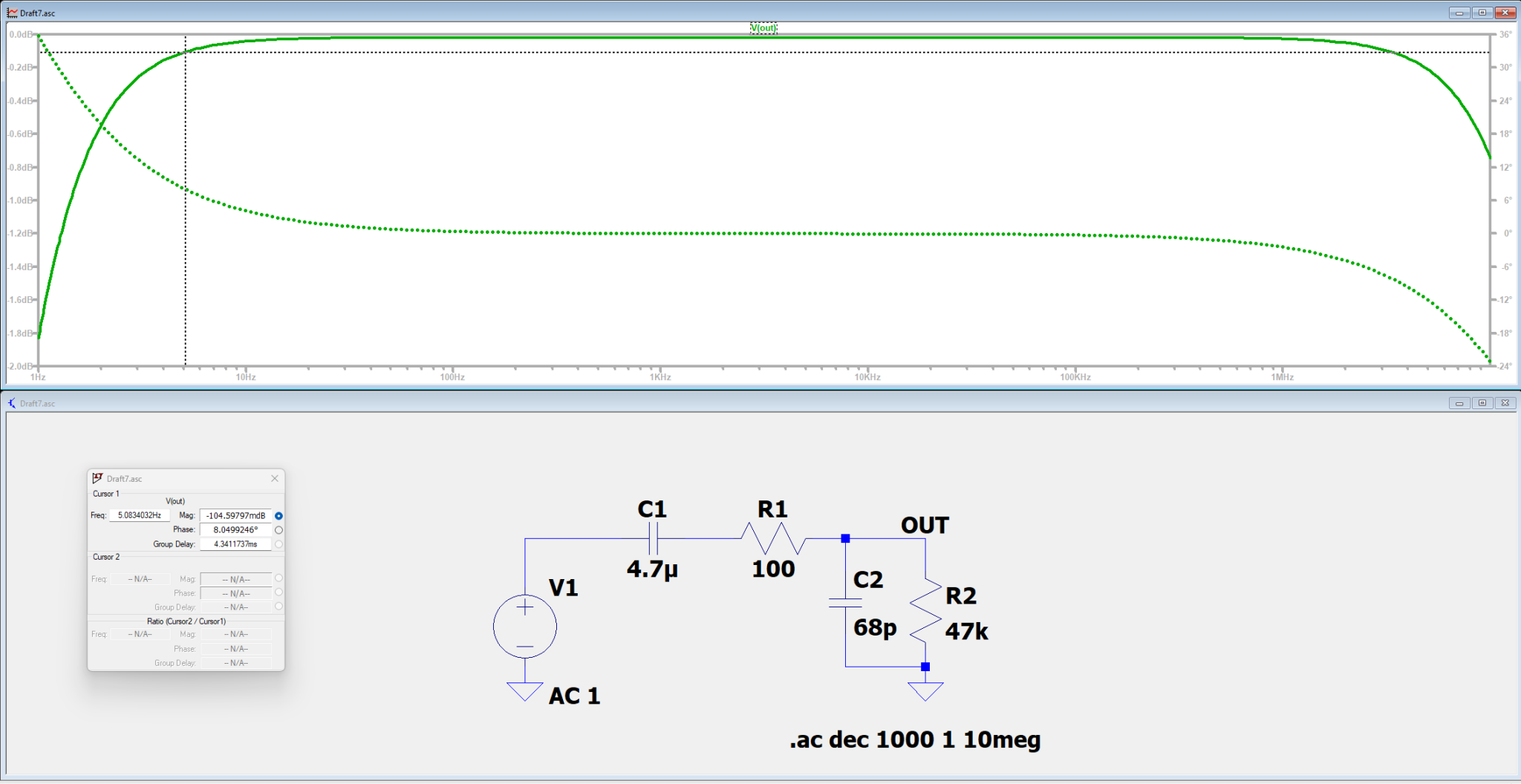

You've got a point that it's probably not the same type of distortion. But still. Is it even worth chasing? Here's a fairly typical input section. 0.1dB down and 8 degrees phase shift at 5Hz? Is that really worth all that effort?Coupling capacitors primarily cause low-frequency roll-off and phase shift
...and unless you're going full Kamikaze and skip all kinds of DC blocking, you're going to have a filter SOMEWHERE, and that filter WILL have roll-off and phase shift. So what have you gained?

It's all a matter of budgetting. Ideally the whole chain from microphones to loudspeakers should be flat within 0.2 dB over the audio range, but that is not going to happen, because the microphones and loudspeakers are already worse than that. The best you can do then is ensure that the circuitry in between the microphones and loudspeakers has negligible frequency response errors compared to the loudspeakers.
For harmonic distortion, people routinely design 1 ppm distortion amplifiers to drive 1 % distortion loudspeakers, so about a factor of 10000 less distortion is attributed to the amplifier than to the loudspeaker. When you do the same with frequency response errors, that -0.00876 dB and -2.5728 degrees at 16 Hz is suitable for a -87.6 dB and -25728 degrees at 16 Hz loudspeaker.
All in all, it is perfectionism, but it is not crazier than designing for very low amplifier distortion.

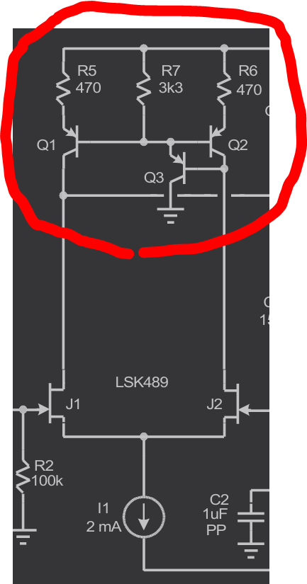

I'm not quite understand why. Currently, the 0.1V output DC offset is created due to the Q5125 base current flowing through 56k R6405, but the Q5105 base current instead of flowing through the matching 56k R5025, flows through a much lower source output resistance. If that's true, then by using JFETs (devices with much lower gate currents), the absolute DC offset value should become lower proportional to a decrease of the current:Regarding redesigning for JFET input devices: because of the lower transconductance, imbalance of the DC currents in the input stage may have a bigger effect on offset than with bipolar transistors.
Voff_JFET = Voff_BJT * (IGate_JFET / IBase_BJT)
Isn't it the case?

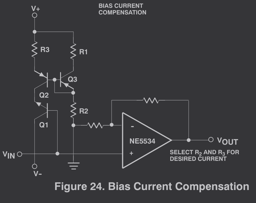

Are you talking about something like on the attached Bob Cordell's sample, correct?That could be a reason to update the biasing first, for example to something with a current mirror.
Or did you mean something similar to this one? Just learned it from OnSemi's Audio Circuits Using the NE5532/4 🙂Regarding redesigning for JFET input devices: because of the lower transconductance, imbalance of the DC currents in the input stage may have a bigger effect on offset than with bipolar transistors. That could be a reason to update the biasing first, for example to something with a current mirror.

There are several effects contributing to the offset, such as:
Base current and unequal resistances. This will indeed be essentially gone with JFETs.
Base current mismatch due to unequal hFEs. Also gone with JFETs and not dominant anyway because of the different resistances.
Base-emitter or gate-source voltage mismatch at a given collector or drain current. You are going to select your FETs to get this under control.
Differences between the collector or drain currents that flow through the input transistors, as set by the rest of the amplifier circuit. You can calculate this back to an equivalent input offset voltage by dividing by the input stage transconductance (and to an equivalent input offset current by dividing by the input stage current gain, but that goes to near zero again with JFETs).
This differences-between-drain-currents-calculated-back-to-an-offset-voltage term might get worse with JFETs. Then again, I don't know if it gets big enough to be a problem. Looking at the schematic, it is clear that the designers did their best to keep the currents well-balanced.
Yes, but I don't know if it is needed. A current mirror in the signal path also complicates the high-frequency behaviour, so I rather avoid them if they are not required.
