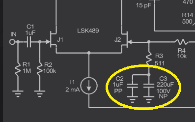

If I got your description correctly, the proposed circuit should be like the attached one, correct?
Then, the first issue is that the amp has dynamic power rail voltages depending on the 4 and 8 Ohm loads. Those could be either +/-24V, or +/-54V. So, the first idea I've got is to add a Zener diode in parallel to Cbig. Does it look good or there's something else you could think of?

MarcelvdG, thank you for the response! Noted this.Sounds like a good idea. With a Zener diode, you will have to reduce Rbig1 to get the current through the Zener in the range where it works. They are usually specified at currents of the order of 1 mA and more rather than microamperes.

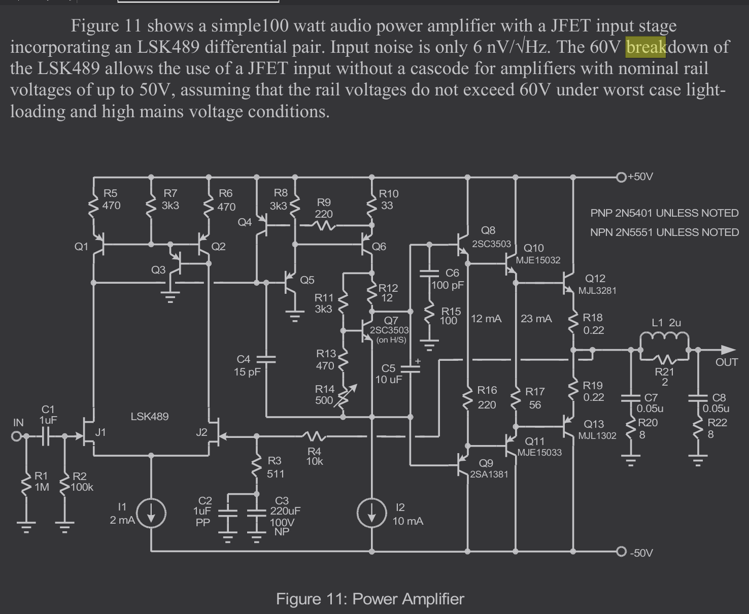

However, after diving deeper into the topic of input stages of quality power amps, I was extremely lucky to come across some master classes of an iconic engineer Nikolay Sukhov (Nick Sukhov on this forum) (and actually my teacher since I was a teenager 🙂, and I think I got a much better idea than messing with DC biasing of the BJT input stage, but due to lack of knowledge and experience in this domain, I would like to get some guidance first.
The current idea is to kill two birds (get rid of the biasing currents and, at the same time, decrease distortions) with one stone by using FETs in the differential input stage instead of BJTs. Ideally, I'd start experimenting with de-soldering those two input BJTs and sticking in FETs in the same TO-236 package. But I'm sure it must be much more involved 🙂
At the moment, I'm trying to figure out some good FETs for this case. I'd appreciate some ideas in this regard. Also, some considerations regarding required changes in the schematic and\or element values are highly appreciated!
njswede, sorry, I might have been used a wrong term. By 'getting rid of the biasing currents', I meant eliminating the need for injecting the current into the inverting input of the differential input pair as we talked with MarcelvdG previously.
With the BJT input, the base currents of the input pair are about 1.8uA and with a JFET input. those gate currents are expected to be in a region of tens or hundreds of pAs. As I see it, this should eliminate the need for introducing the extra biasing circuit proposed by MarcelvdG to achieve 0 DC at the speaker output.
You need a pair of well-matched JFETs then, which means you either need to select them yourself or use two paired JFETs in one package, like the JFE150 that Texas Instruments promotes via this thread: https://www.diyaudio.com/community/...ts-from-texas-instruments.375079/post-6734233
You may have to cascode the JFETs, because of insufficient voltage handling or because their gate current increases too much at high drain-source voltages when there is drain current flowing (I believe they blame that on impact ionization in the channel).
As the transconductance will be less than that of the bipolar transistors, you will have to analyse loop gain and stability.

Yeah, at this point I'm trying to avoid using dual monolithic JFETs as those come in a different package than my current TO-236 input BJTs. I'd rather get, say, 10 of TO-236 JFETs and match those by Vgs myself.You need a pair of well-matched JFETs then, which means you either need to select them yourself or use two paired JFETs in one package, like the JFE150 that Texas Instruments promotes via this thread: https://www.diyaudio.com/community/...ts-from-texas-instruments.375079/post-6734233
I've just come across the attached design from Bob Cordell's LSK489 Application Note where he points out just that:You may have to cascode the JFETs, because of insufficient voltage handling or because their gate current increases too much at high drain-source voltages when there is drain current flowing (I believe they blame that on impact ionization in the channel).
So from this, I assume I need to to figure out some 60V breakdown TO-236 JFETs. Are there some known recommendations for those?The 60V breakdown of the LSK489 allows the use of a JFET input without a cascode for amplifiers with nominal rail voltages of up to 50V, assuming that the rail voltages do not exceed 60V under worst case light-loading and high mains voltage conditions.
Bob utilizes a current mirror as an active load in this amp, but I guess I could get away with one load resistor (just like it's in my amp's schematic) after the supposed drop-in replacement of the BJTs with JFETs?

And how are you going to deal with the DC versus AC gain without using capacitors?
The feedback net in this circuit has unitary gain for DC and 19.5 for AC.
If you remove this cap too (J2 gate), DC gain will go to 19.5 which will complicate the offset at the output.

He stated that he’s solving that by never getting any DC on the inputs.And how are you going to deal with the DC versus AC gain without using capacitors?
ron68, just to put it clear, at the current iteration of improvements, I'm eliminating the side effect of shorting the input cap only (the one that causes 0.1V DC at the speaker output).And how are you going to deal with the DC versus AC gain without using capacitors?
