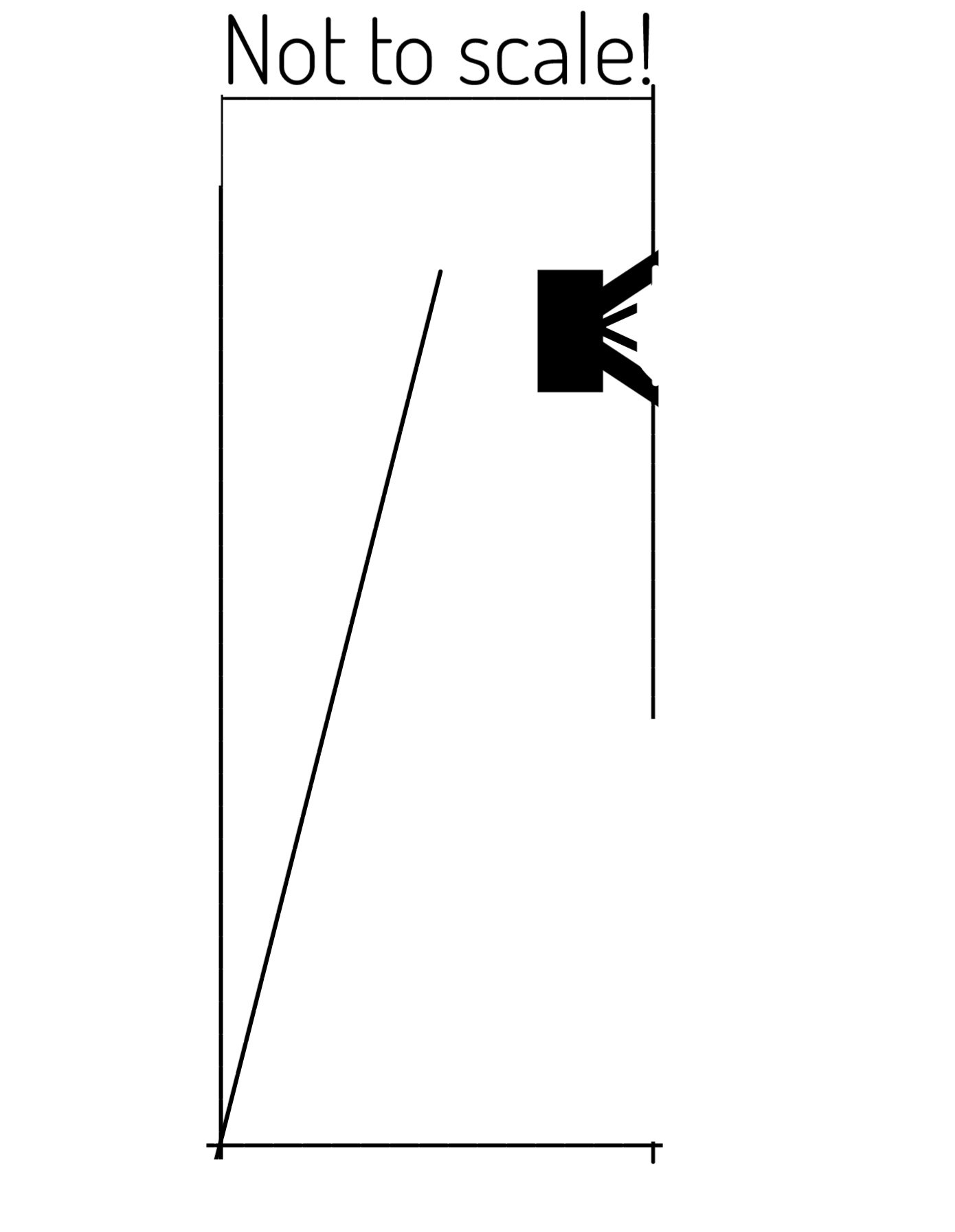

I have two more questions after a bit of pondering over it all:
1. How close does the ceiling need to be to the upward firing terminus in order to be most beneficial?
2. In case of a layout as shown in the diagram attached - the throat beginning at the rear bottom and the terminus firing forward at the bottom - are there any disadvantages (besides a marginal reduction in efficiency) to placing the driver at about 0.6 or 0.666 of the pipe's axial length?
Thanks in advance!
I'd say close, but not too close. Too far apart will cause ripples, @GM told me a few months ago, as far as I remember.
However I have to say: I don't have "golden ears" and my BIBs are ~10-15cm away from the ceiling and I don't hear much rippling going on.
Maybe it's my ears, maybe there aren't many.
At 1KHz, probably -you'd need to do some excursion modelling yourself to know for certain, but power demands fall rapidly > 500Hz and the box load itself isn't going to significantly affect driver excursion at that frequency.
The box only loads the driver to its upper mass corner (Fhm) where T/S theory peters out, so the driver is for all intent & purposes being modulated strictly by any > 1 kHz signals and the pipe's harmonic structure that will have petered out to inaudibility as long as it's located at the optimal pipe offset:
Fhm = 2*Fs/Qts'
Fs: Fhm*Qts'/2
(Qts'): (Qts) + any added series resistance (Rs)

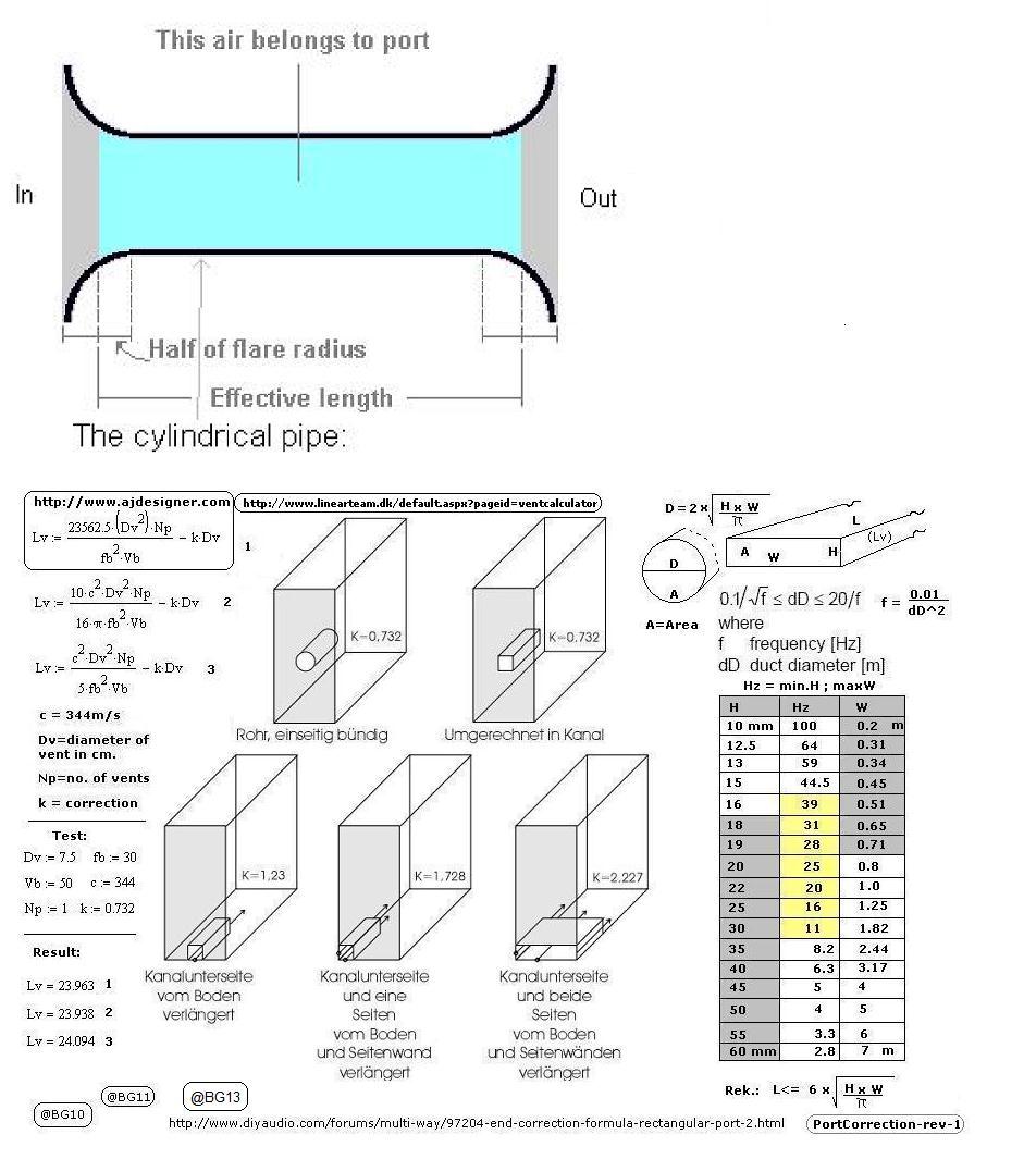

Yes, basically if yours is/are in free space, though as usual there's more to this 'story' in that we ideally need to factor in any boundary loading, so the attached chart is preferred.
Assuming yours are well away from any boundary except the ceiling, then K = 0.732 and use the math on the left side.

GM, thank you for the explanation and the chart.
Honestly, although i do get an idea of the principle that an adjacent boundary effectively extends the acoustic length of the pipe, the mathematical formulae are quite beyond my comprehension.
It was quite silly of me so far to take the "radius" as the radius of the mouth opening equivalent to the rectangular cross section of the pipe's mouth.
About the radius as shown here, how does it pertain to a pipe which has a linear rate of expansion as in a Bib?
I will certainly be putting the pipes in the corners, but with them tuned to 50 Hz, with a height of 68 inches and a ceiling which is 12.5 feet high, i doubt if there will be any useable benefit from the ceiling.
dude, you're overthinking :-D
the BiB follows the formula "more is better", if I had to describe it. It's a TQWT-esque speaker with gigantic dimensions.
You can also put the BiB on its head and put some pieces of wood under the four corners to lift the BiB up a few inches. Maybe move the speakers closer to the fold then so they're not at "knee" but at "ear level". of you Google "ibib", as in "inverted bib" you might even find the thread or pdf file on this forum. 🙂
just build the thing and have fun. I have only one bib somewhat in the corner and it's working just fine for my ears.
