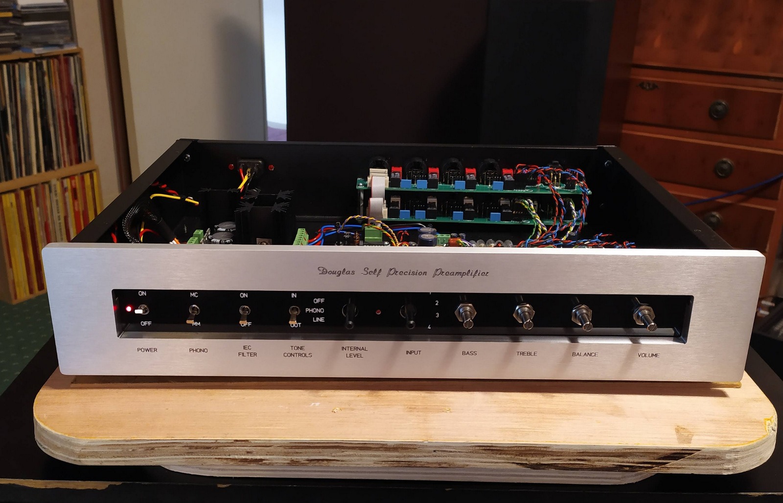

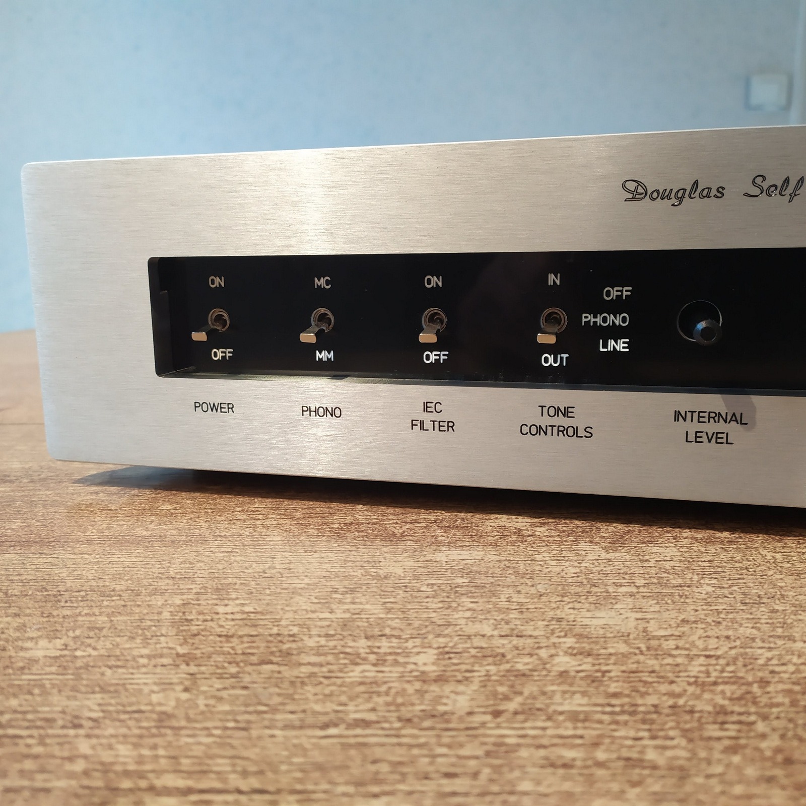

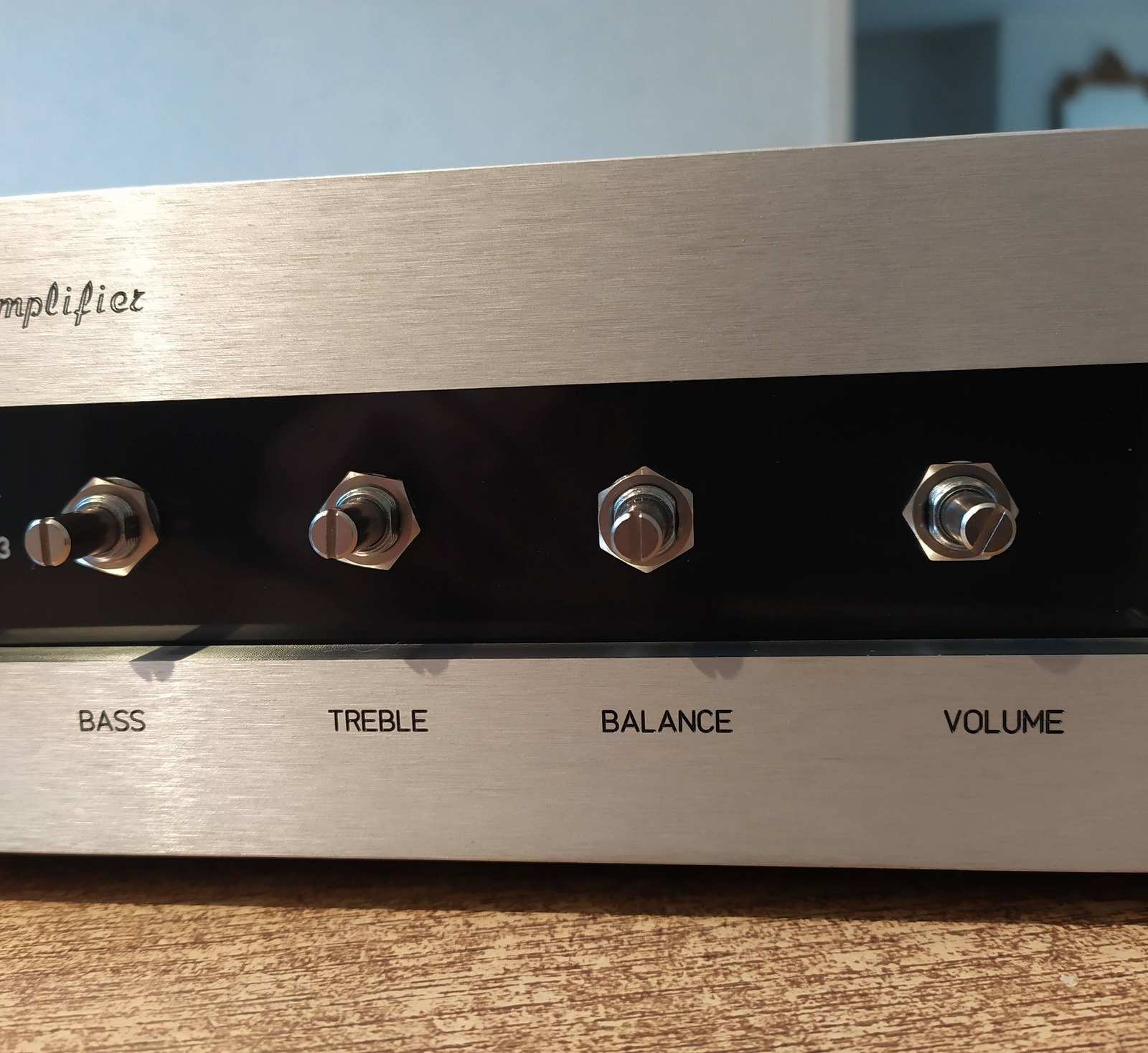

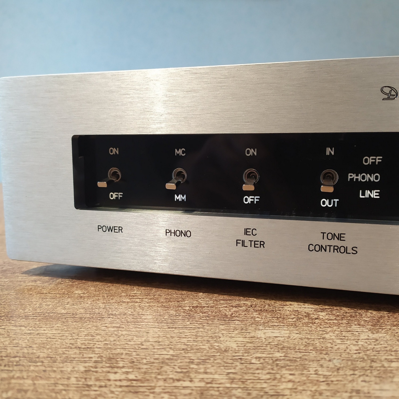

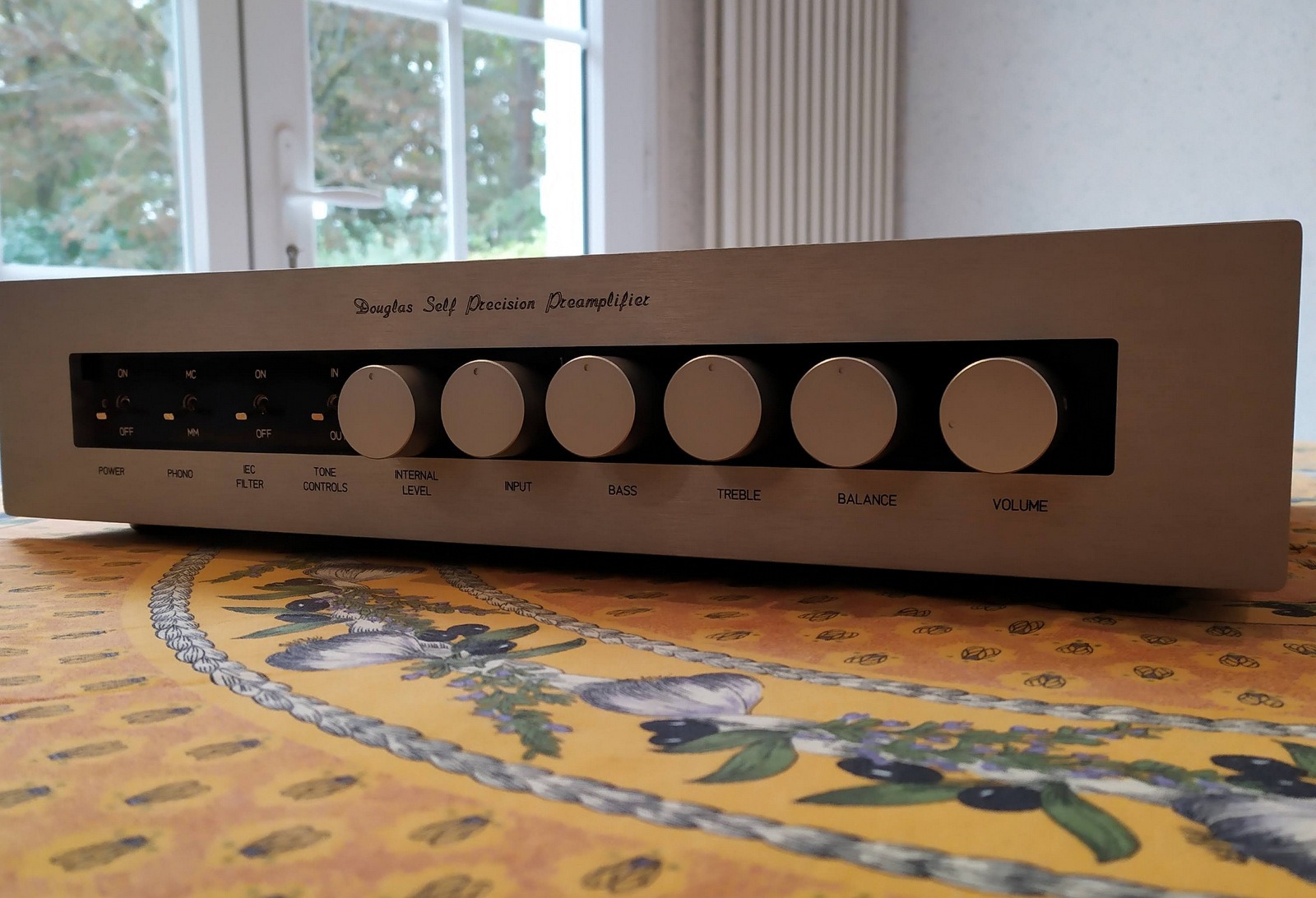

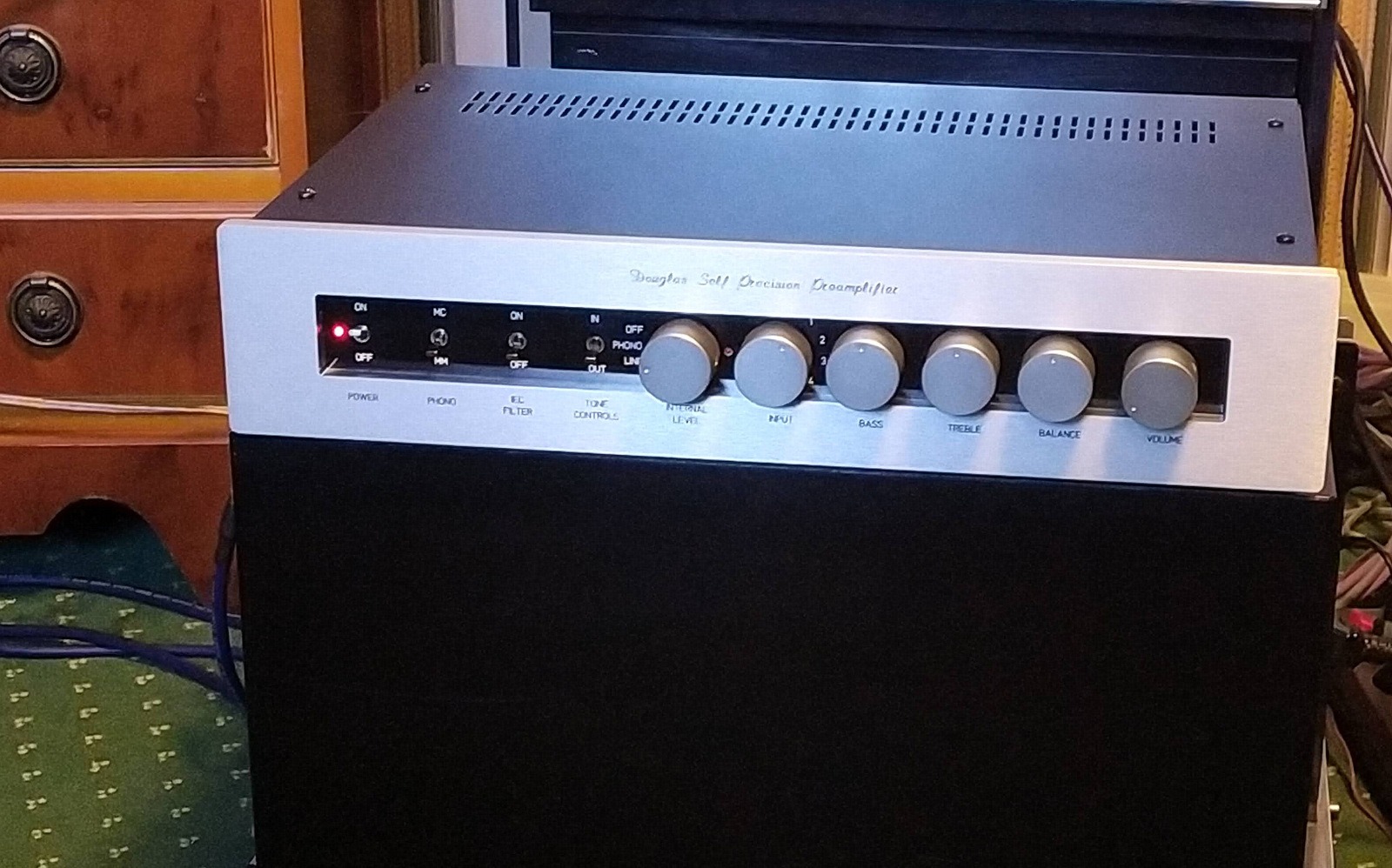

Today I received a new part for the front panel and temporarily installed it to make sure it fits as expected. For fun, in the future I may order another one in bright red with white lettering.

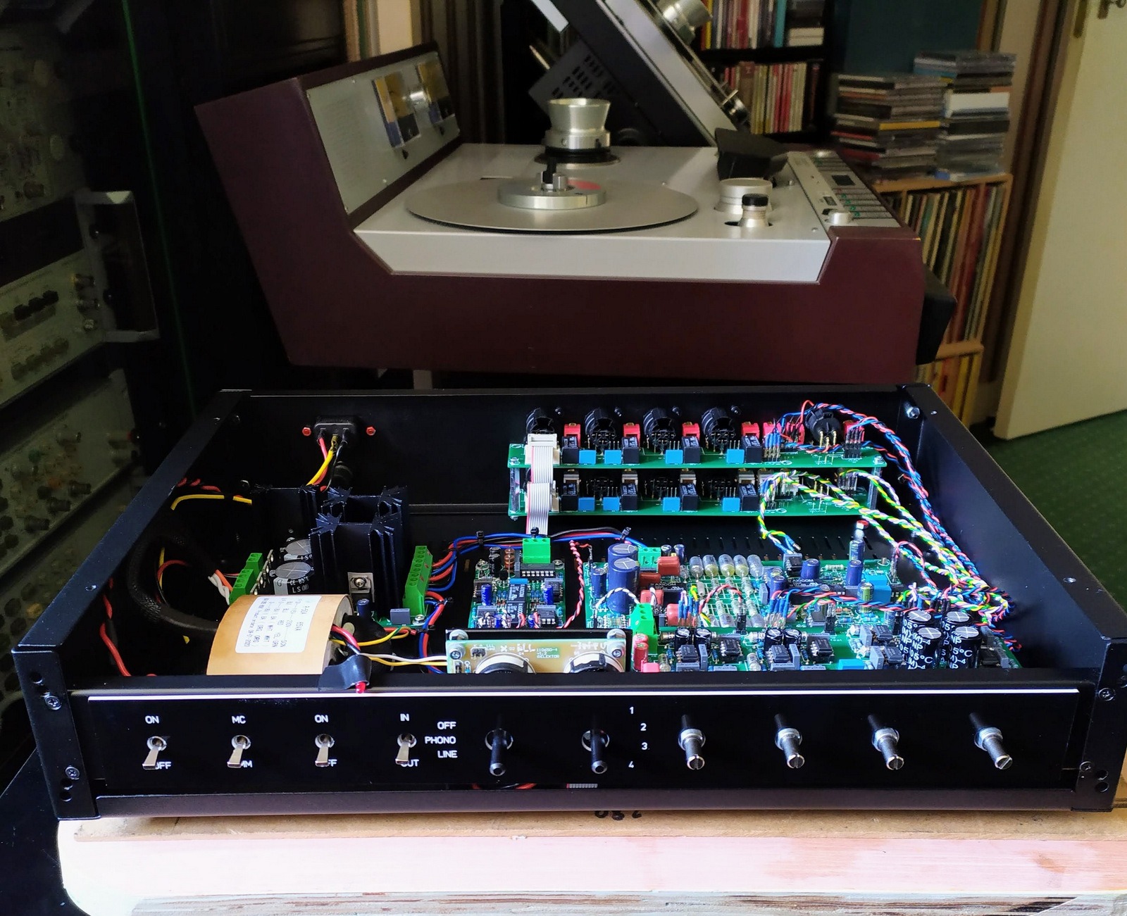

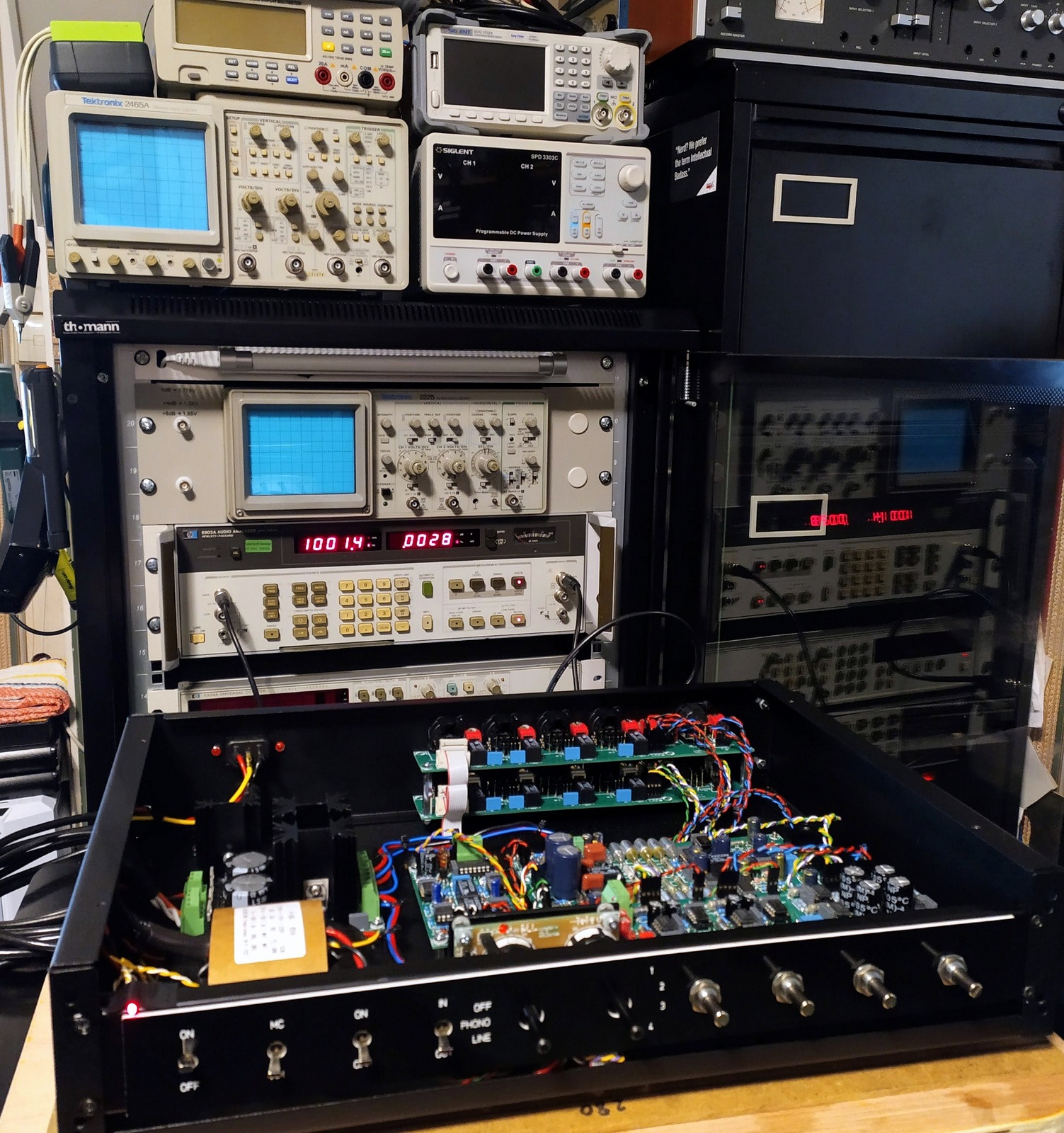

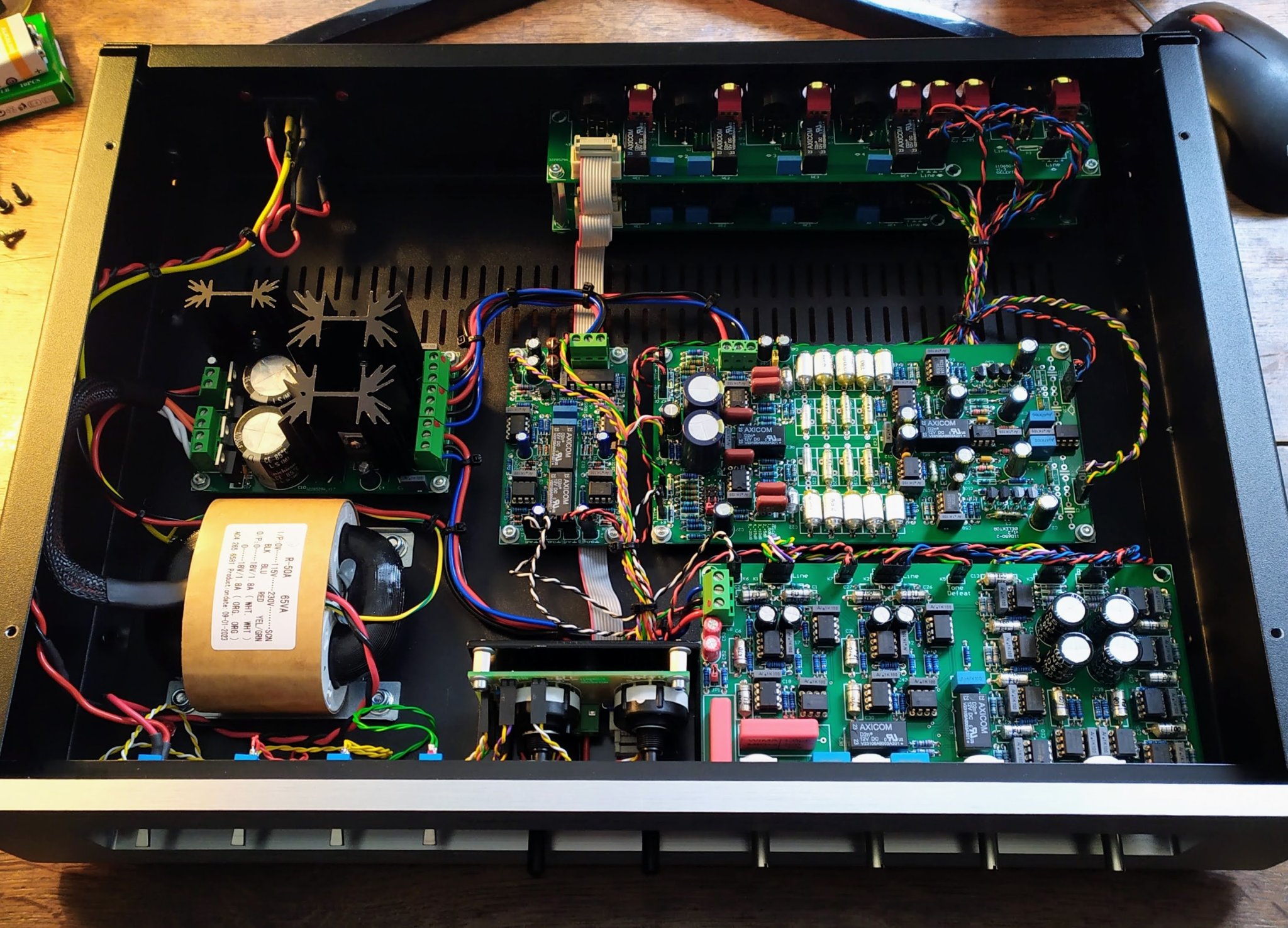

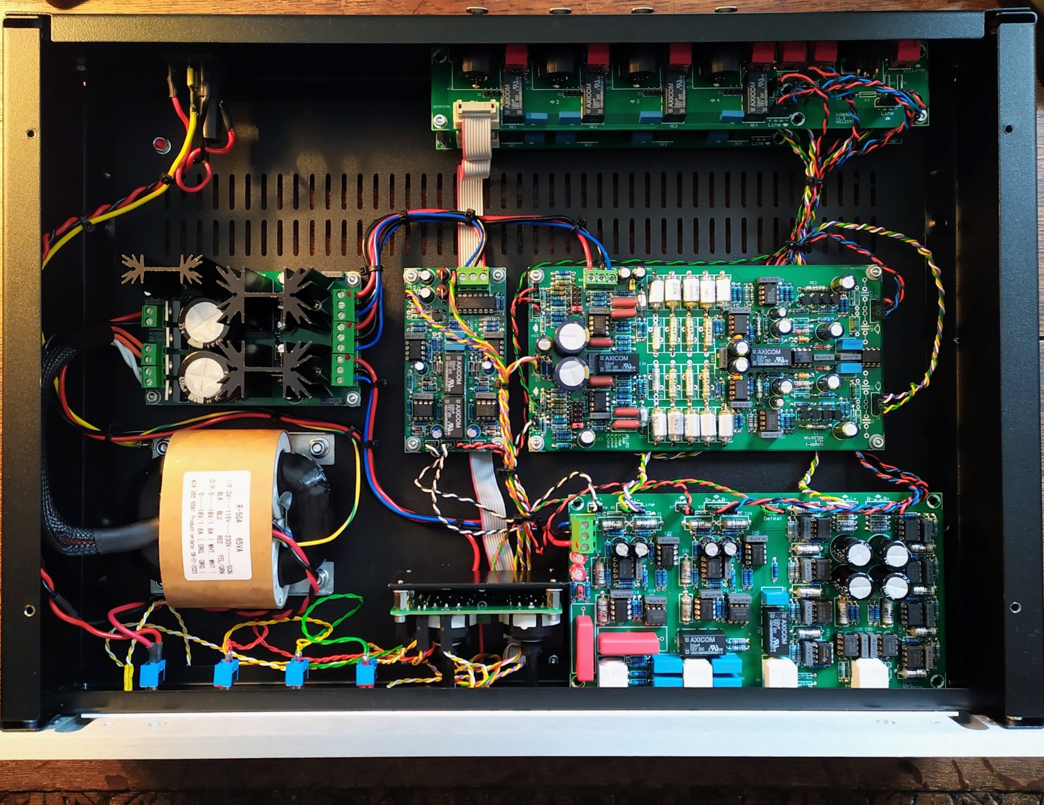

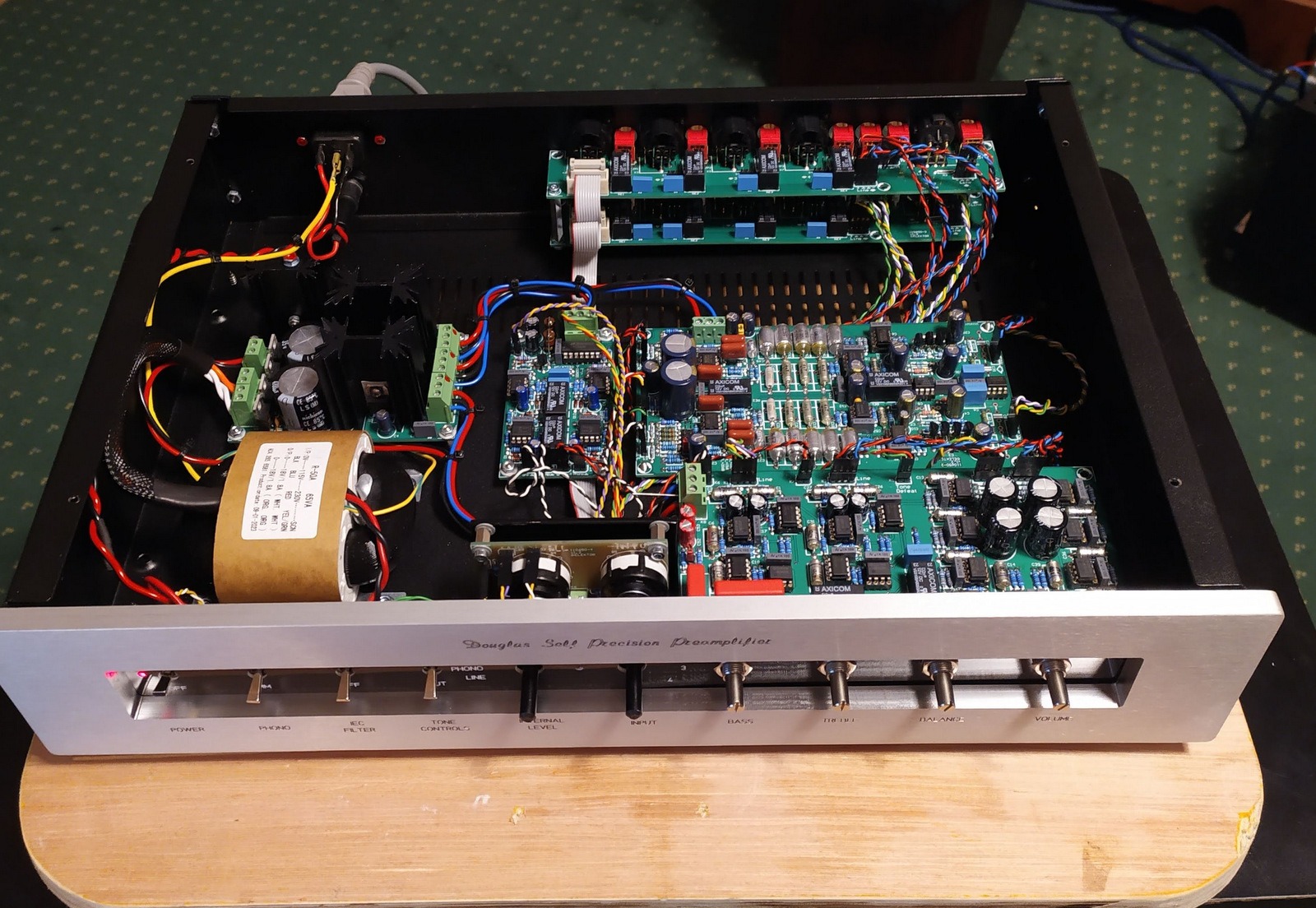

Wiring is ongoing, what a hassle. I'm using Harwin M20-1180042 connectors and corresponding crimping tool, along with Harwin's M20-10 crimp housings. In addition, for sake of long term reliability, wires are also soldered in the connectors, which is a bit of overkill but will avoid unwanted corrosion effects in the future.
Today's progress ...
I am still waiting for the front panel's last part, it should be there tomorrow.

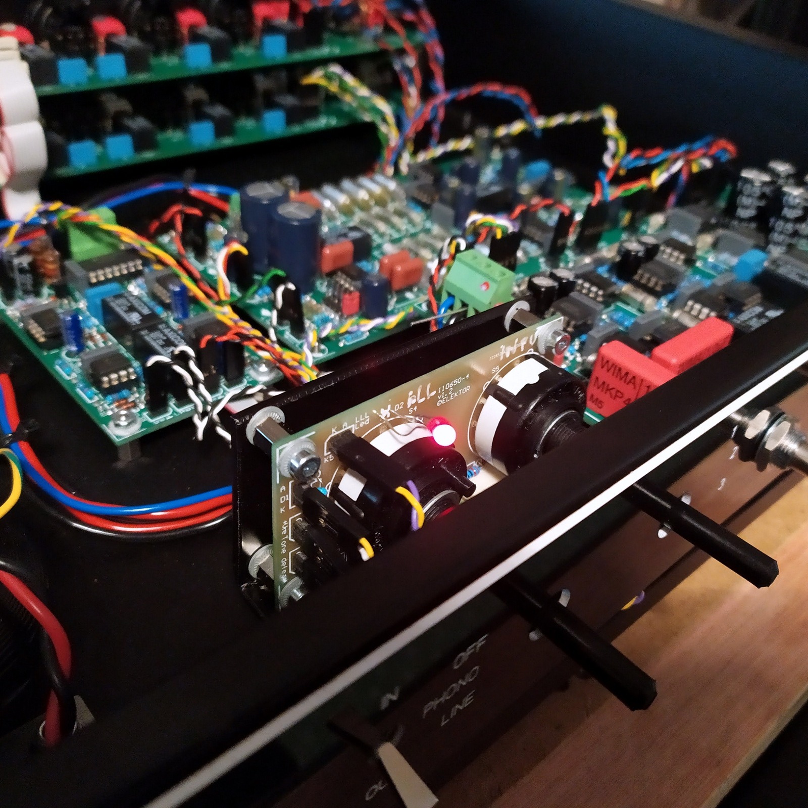

Meanwhile wiring has been completed and I fired the preamp up : everything worked perfectly right straight away, thanks to Elektor's article clearness and thorough checking everything prior to power up.
I have done some further testing by measuring maximum output voltage, it is consistent with Mr Self's specifications. Same for THD under various input levels and frequencies, it never exceeds 0.0028% which again was stated in article. It should even improve after I tidy up the wiringa bit.

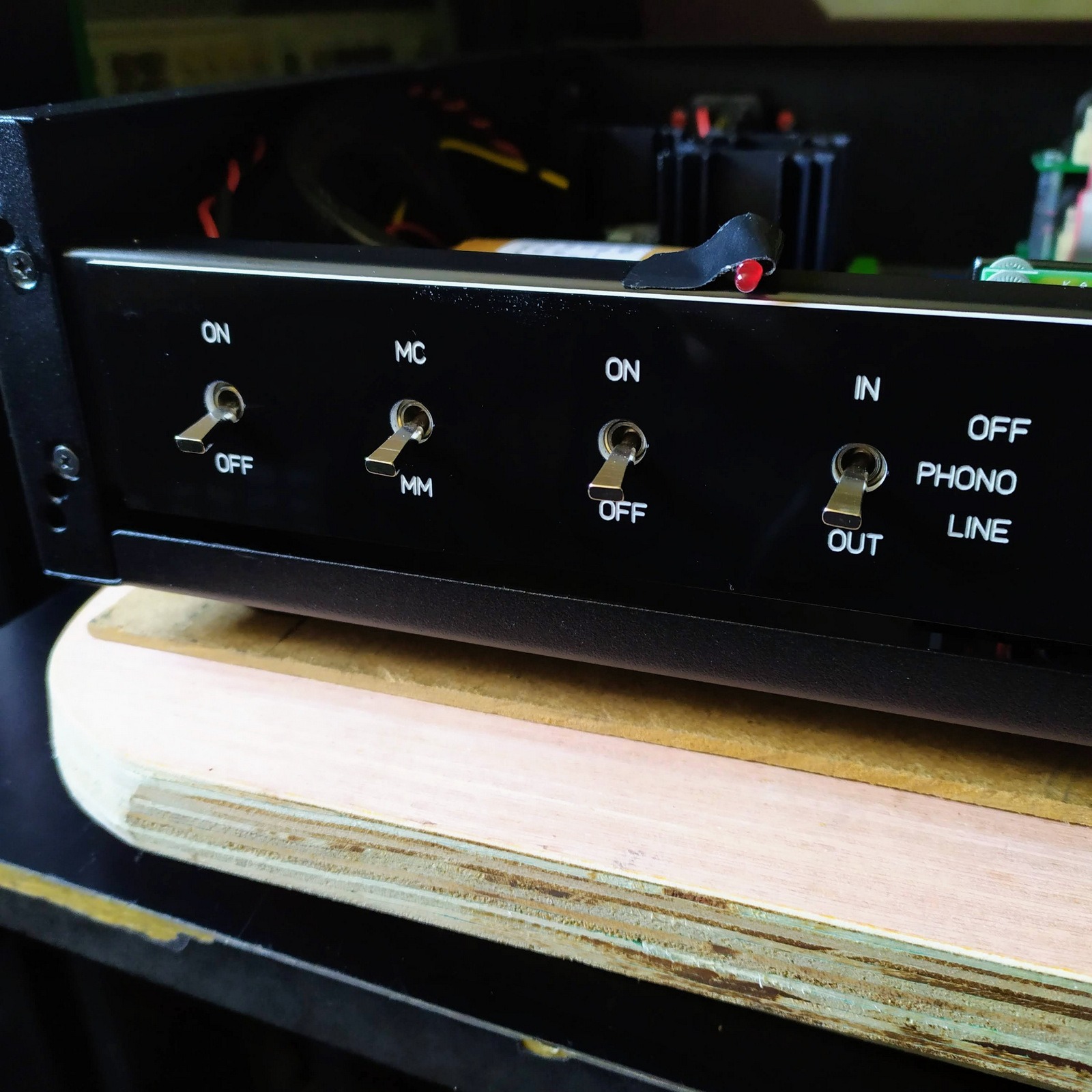

Last test consisted in checking the LLL display with an LED installed temporarily on the front PCB : the LED starts flickering when input voltage is about 1,9V pp and it is fully illuminated @ 2,1V pp.
Next important step will be listening to some music through this puppy, after all that's why I built it...

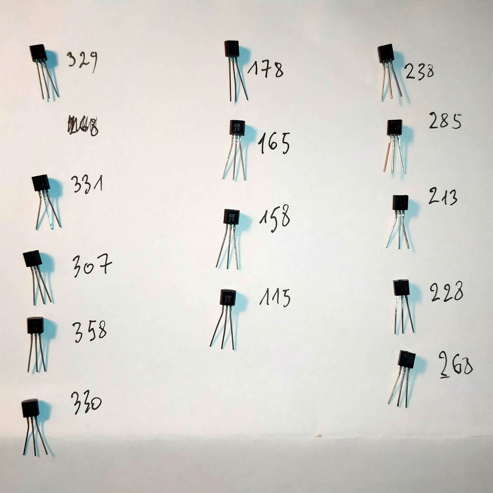

Brillant, when we see the mesure material you have in back, sûre you are a specialist. What are the transistors you use for the riaa preamp ?
I have bought 14 examples of the 2SB737 in the "S" and "R" ranges, of course not from chineese sellers since you're 100% sure those are fake ones.What are the transistors you use for the riaa preamp ?
I found 5 transistors from a french shop, the last they had in store (made by Röhm). Five others were from a retired pro audio repairman who stocked them to build microphone preamps, and 4 from KA Electronics, soooo expensive when you add shipping + custom taxes. That probably makes them the most expensive TO92s I ever bought in my whole life 😱
I will sort them by HFe to achieve similar amplification on each channel.
The 2SA1085 are definitely unobtainable, anywhere.

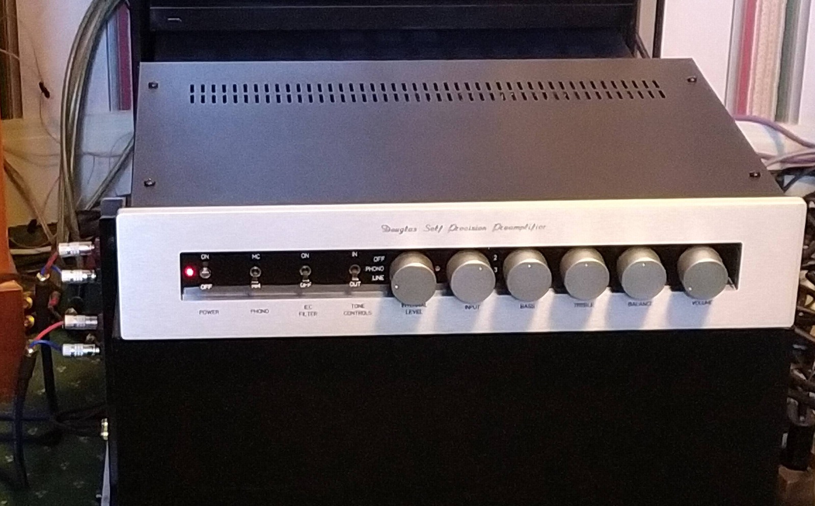

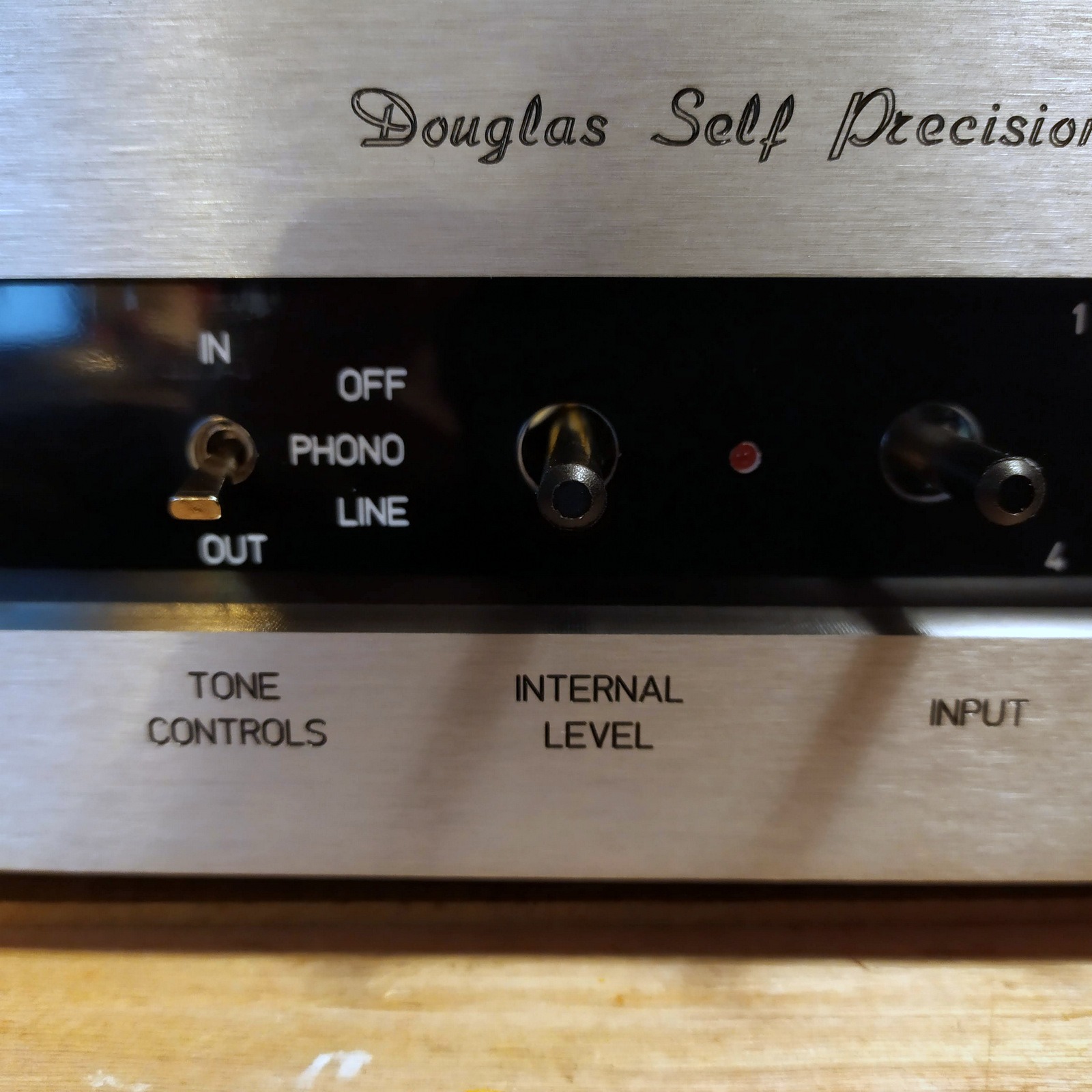

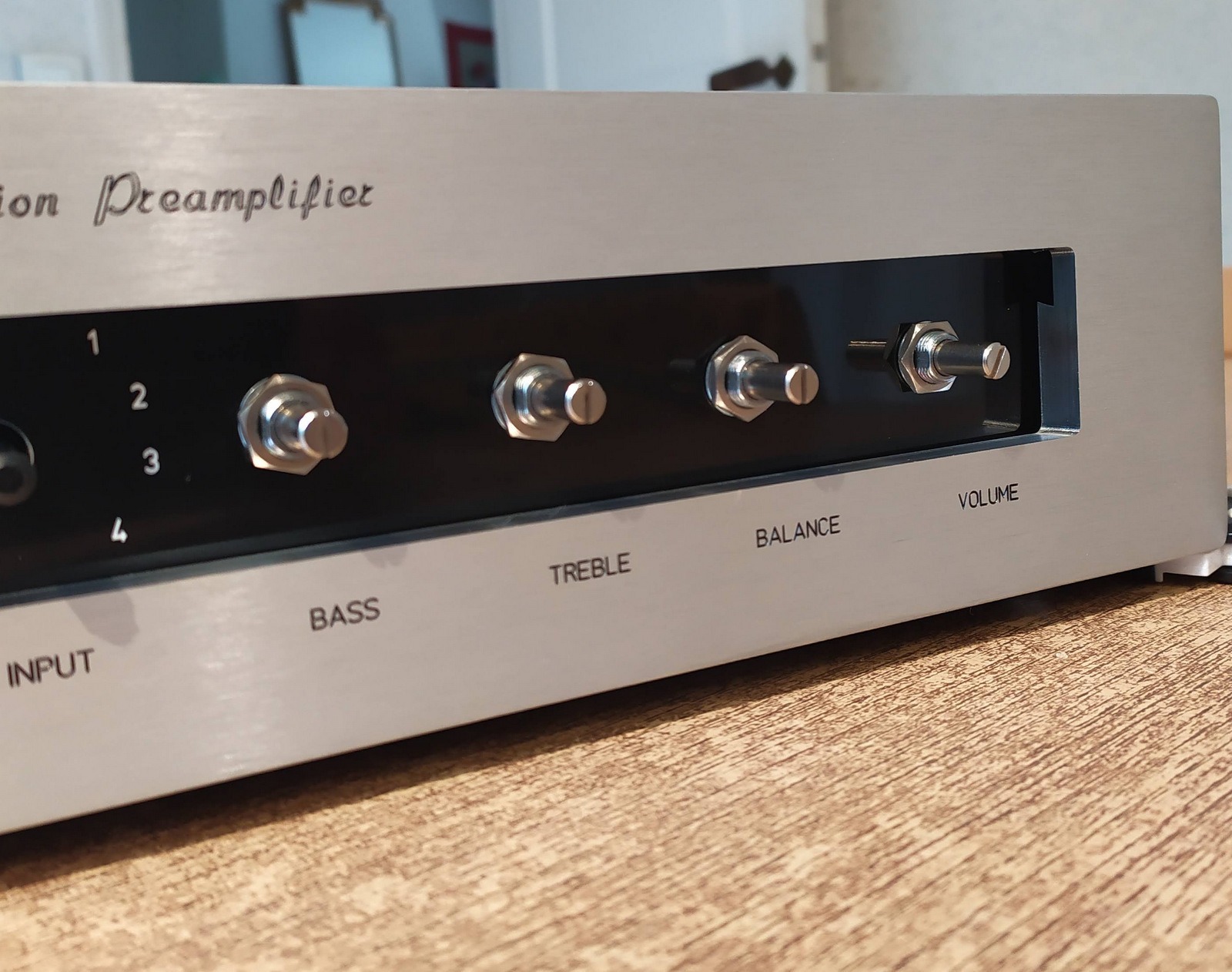

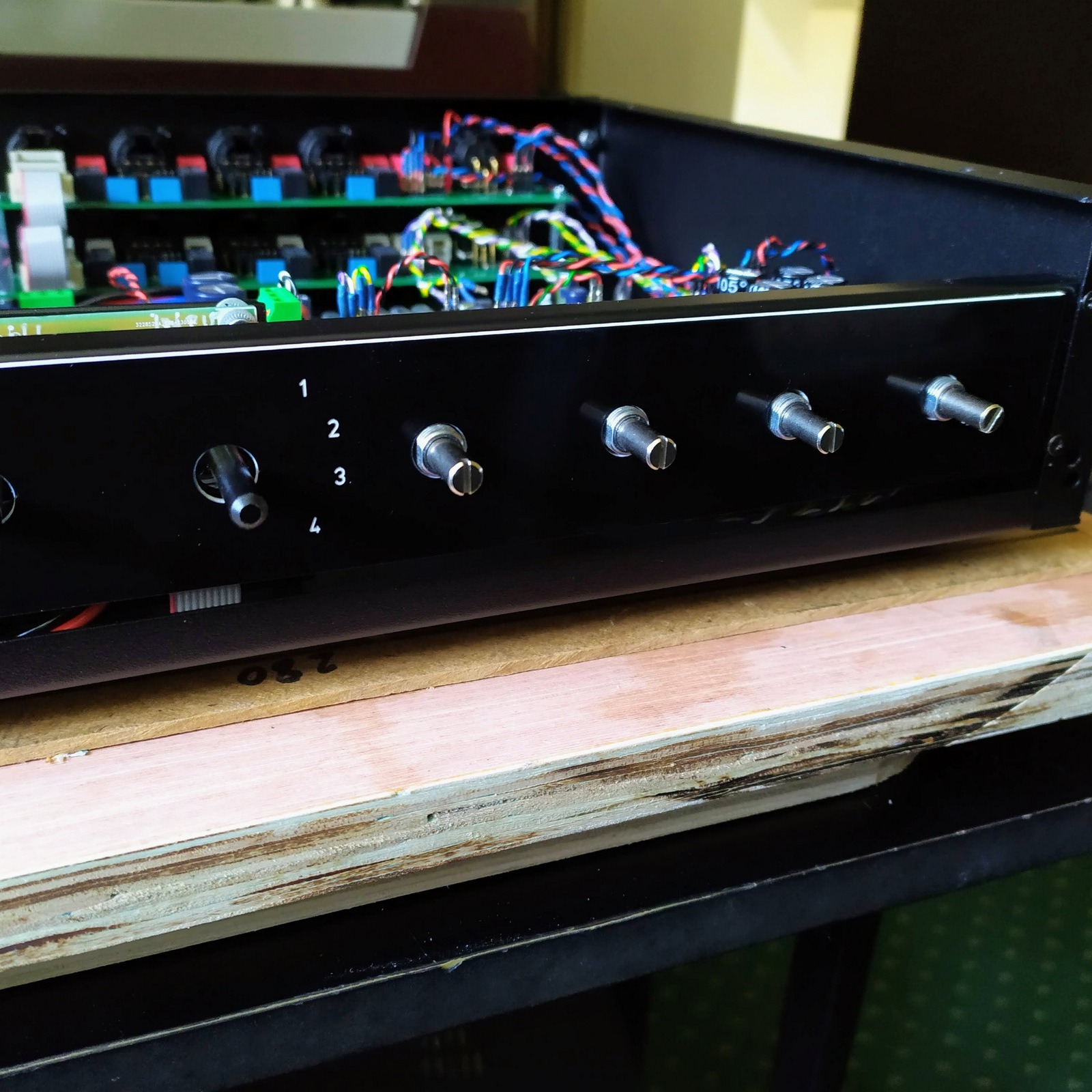

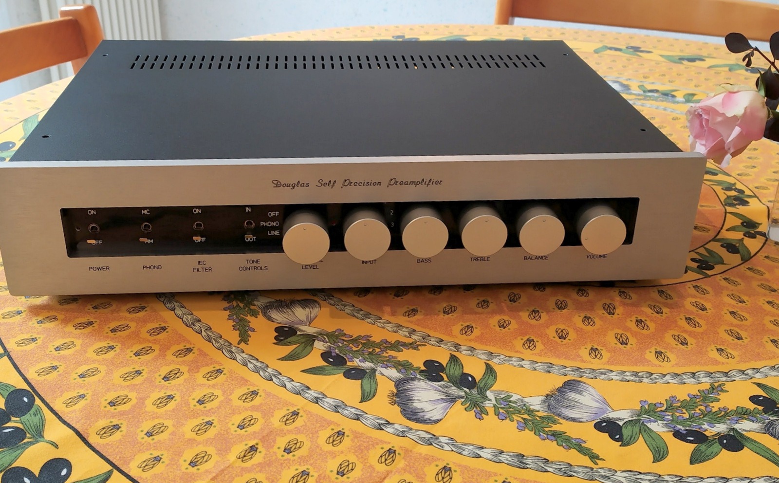

Today's progress : front bezel was back from workshop, now need to install the control knobs. Also, selected the 2SB737 on Hfe.

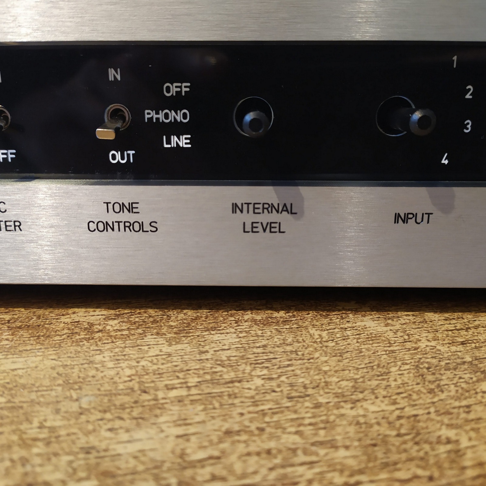

What a beauty, both internally and externally 👍! The design's only drawback imho is that there are four inputs only.
Best regards!
Best regards!
Thanks for the good words.

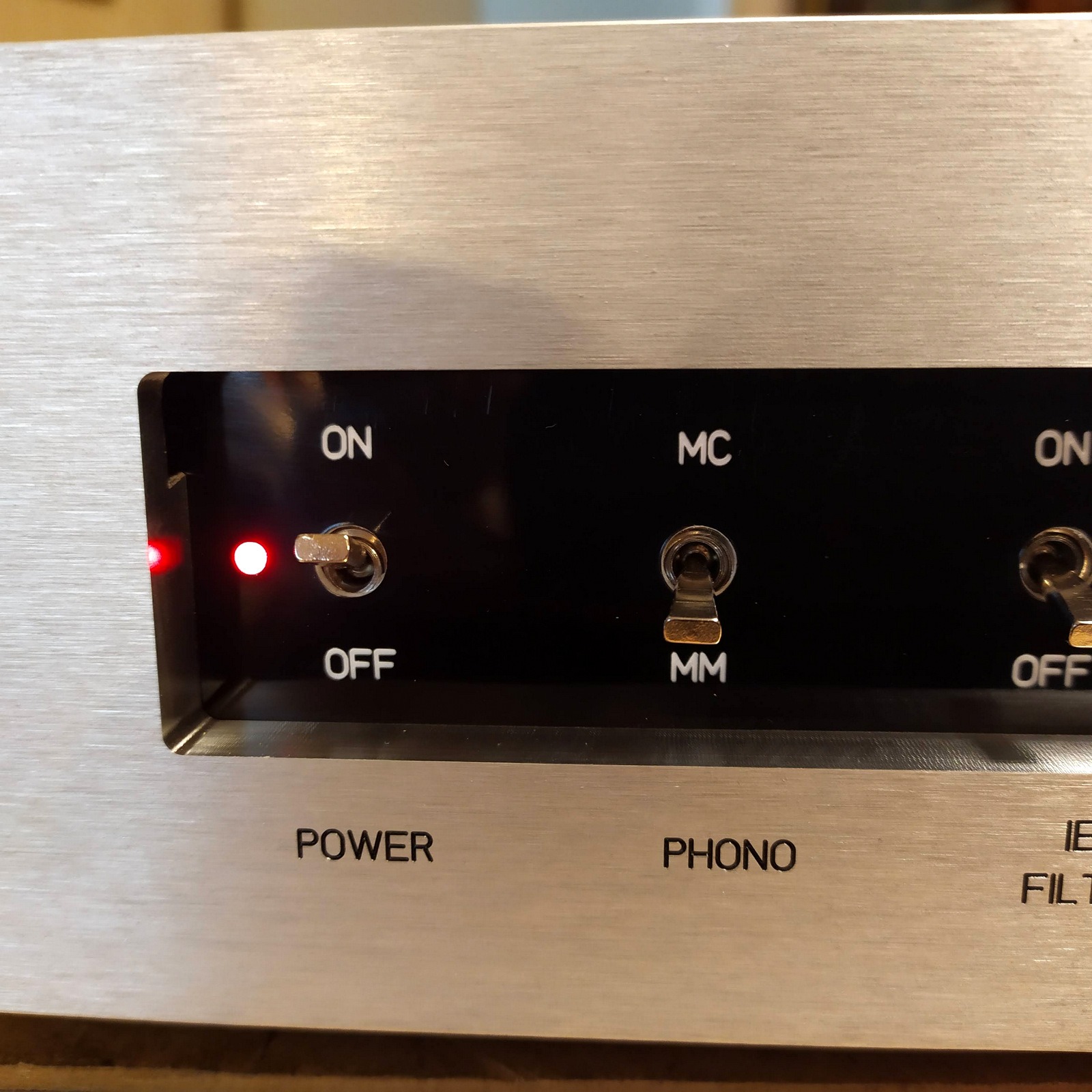

I agree, four inputs is a bit tight but I mostly use only three line level sources (CD, tuner and another digital, all Studer with balanced outputs) and a turntable. But I reckon some users might want more inputs.
Currently listening on Quad ESL63s powered by a Studer A68 amplifier.
Accuracy and transparency of this preamp are just awesome 😳

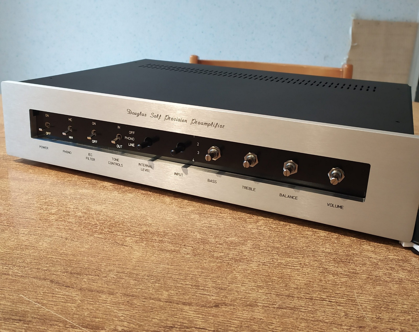

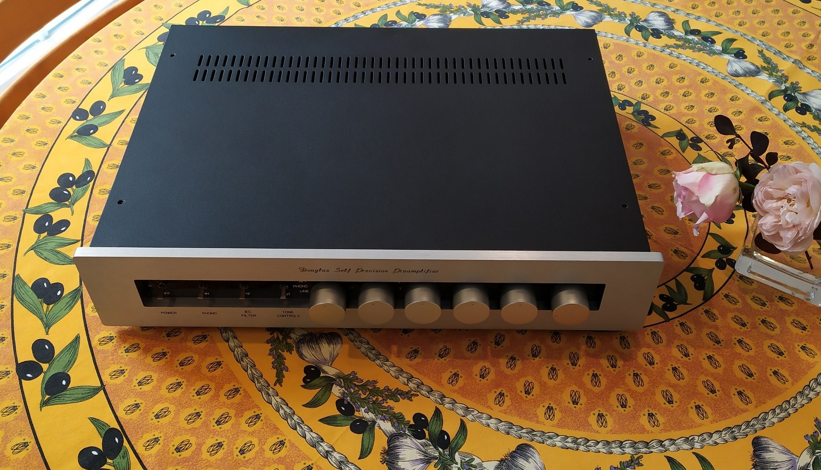

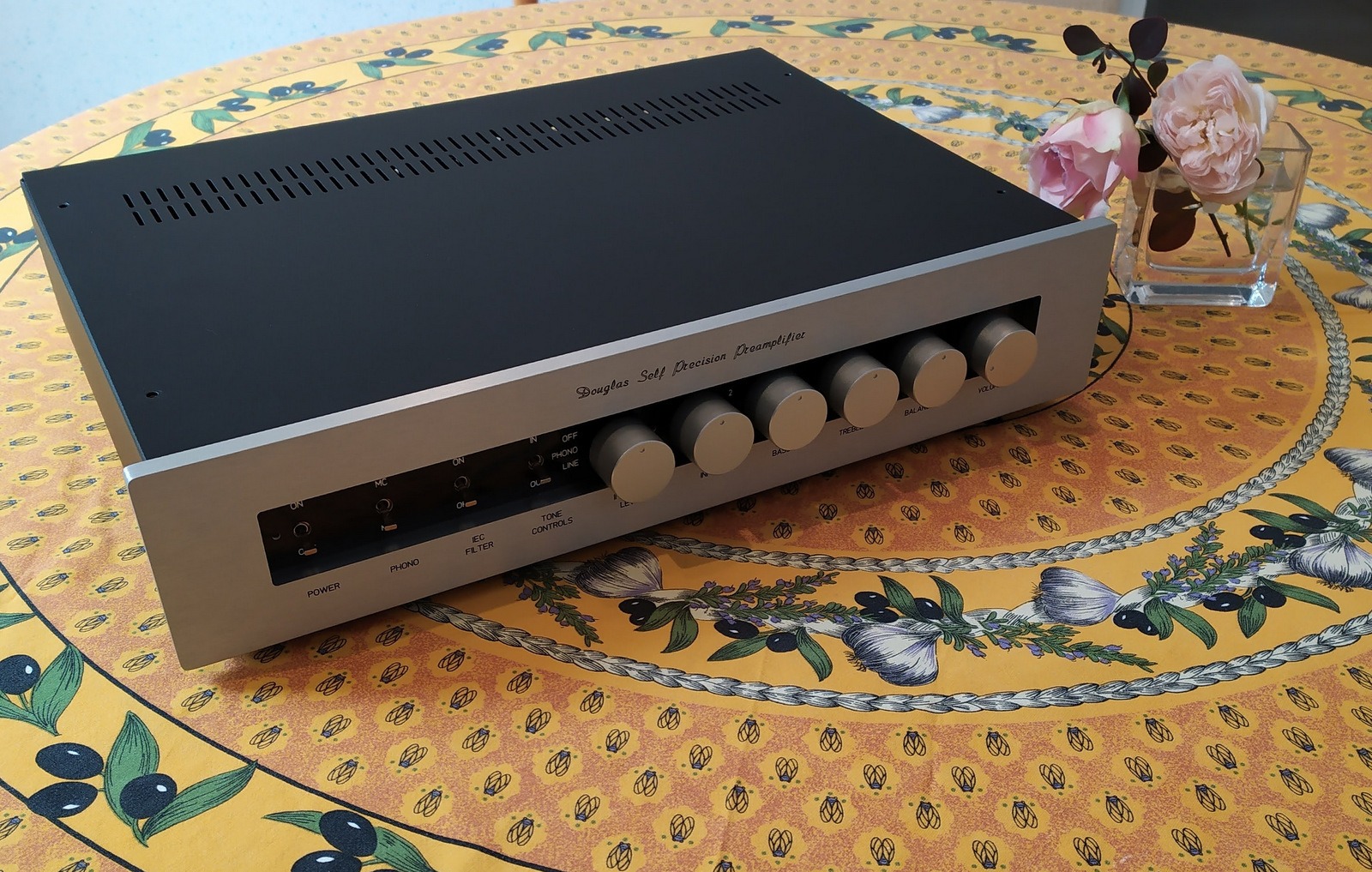

Project completed !
Project completed !

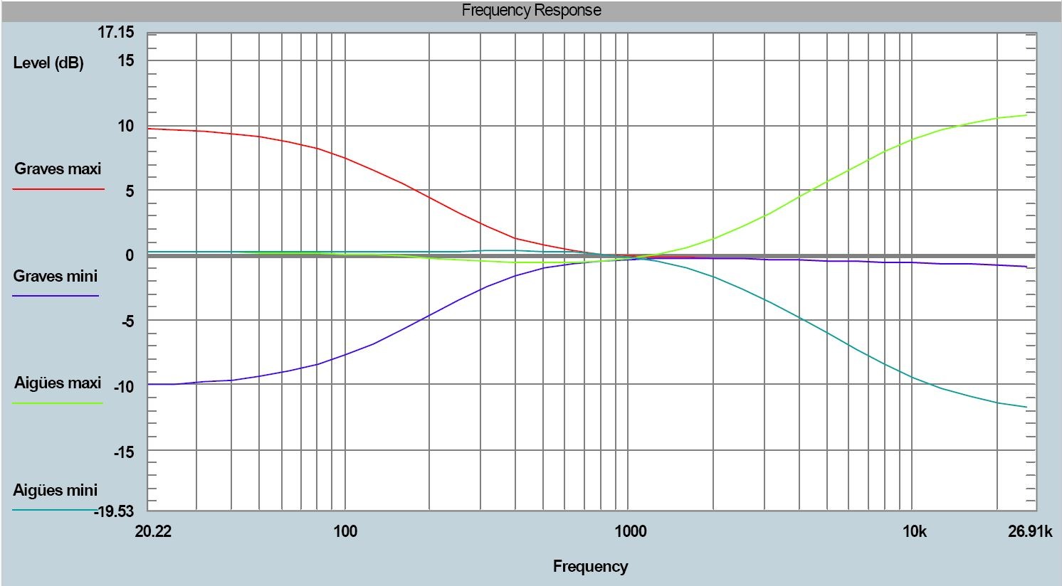

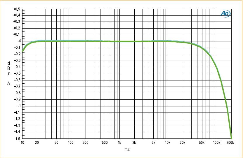

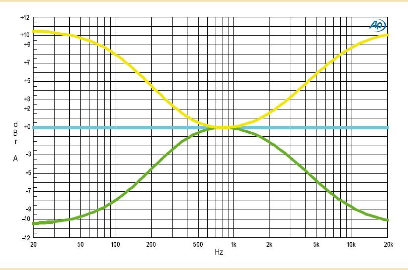

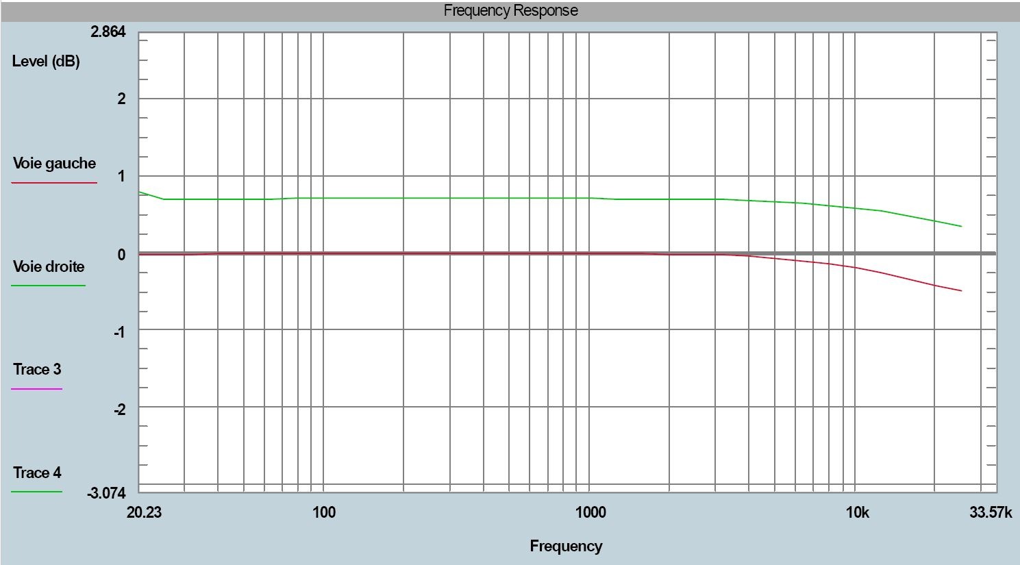

I did some checks, results are as specified in Elektor's article.
Both the frequency response and tone controls efficiency conforms to the published curves (see attachments).
Level difference between channels in frequency response graph is down to unajusted balance control during measurement.
