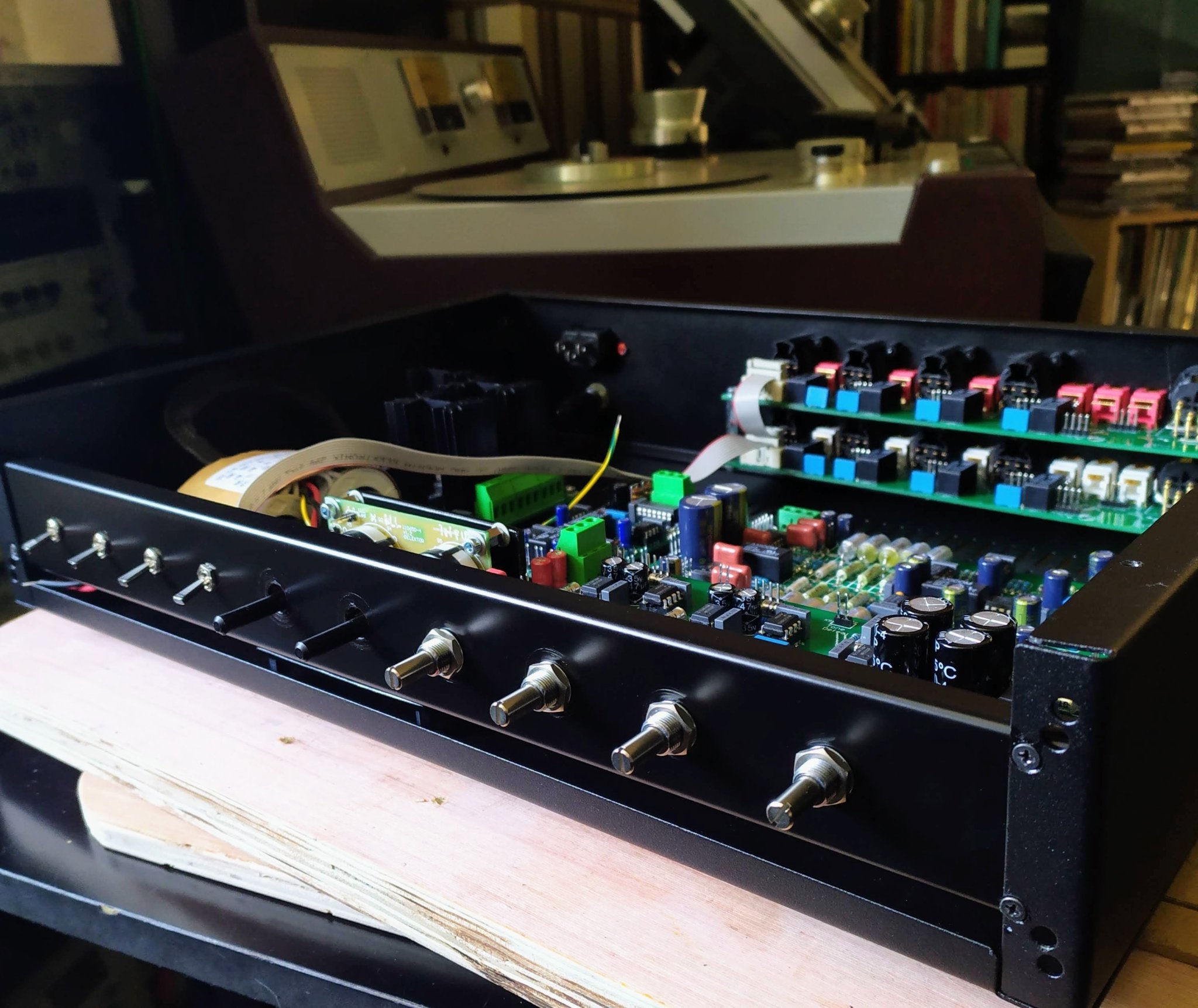

I'm thinking about the chassis but I'm undecided yet. It will certainly take some time before boards implementation in any chassis. I first need to listen to the kit on the long run, let's say to make sure building this was a good move.
I'd have liked a 1U box but given the height of the heatsinks and sandwiched in/out boards, a 2U is mandatory.

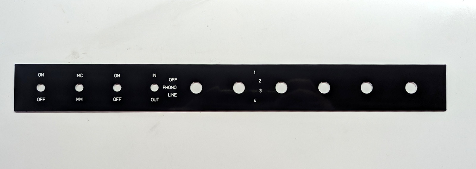

This week I made some progress.

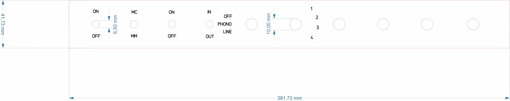

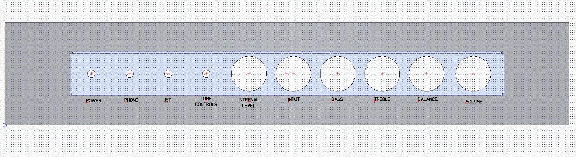

Left to do : solder missing parts, wire boards together and have the faceplate machined. Drawing's white circles represent control knobs locations.

Thanks for the compliments, I try to achieve a clean job. Trickiest part was cutting the input/outputs panel, the rest is easy.what is/are your music sources(s)?

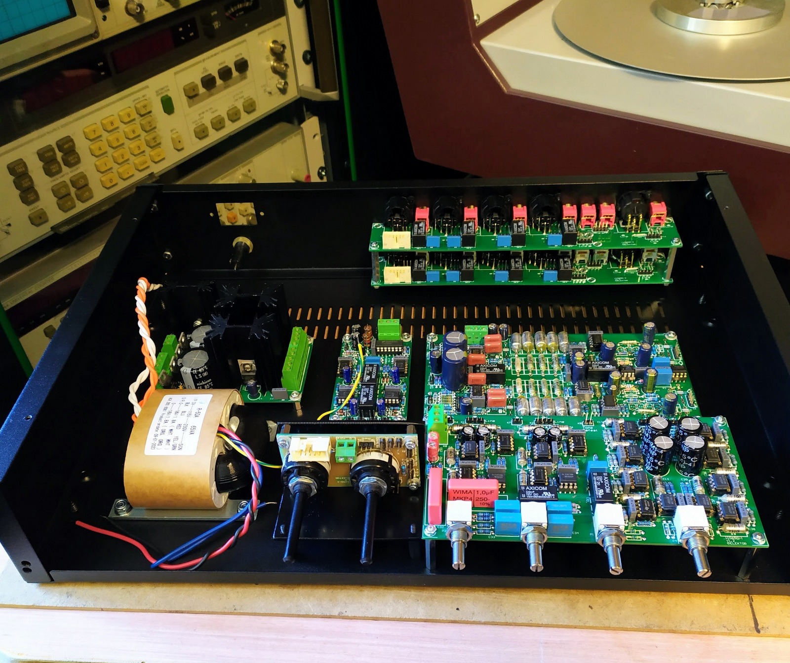

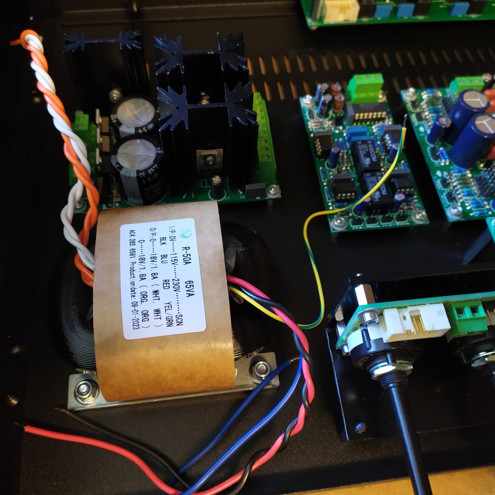

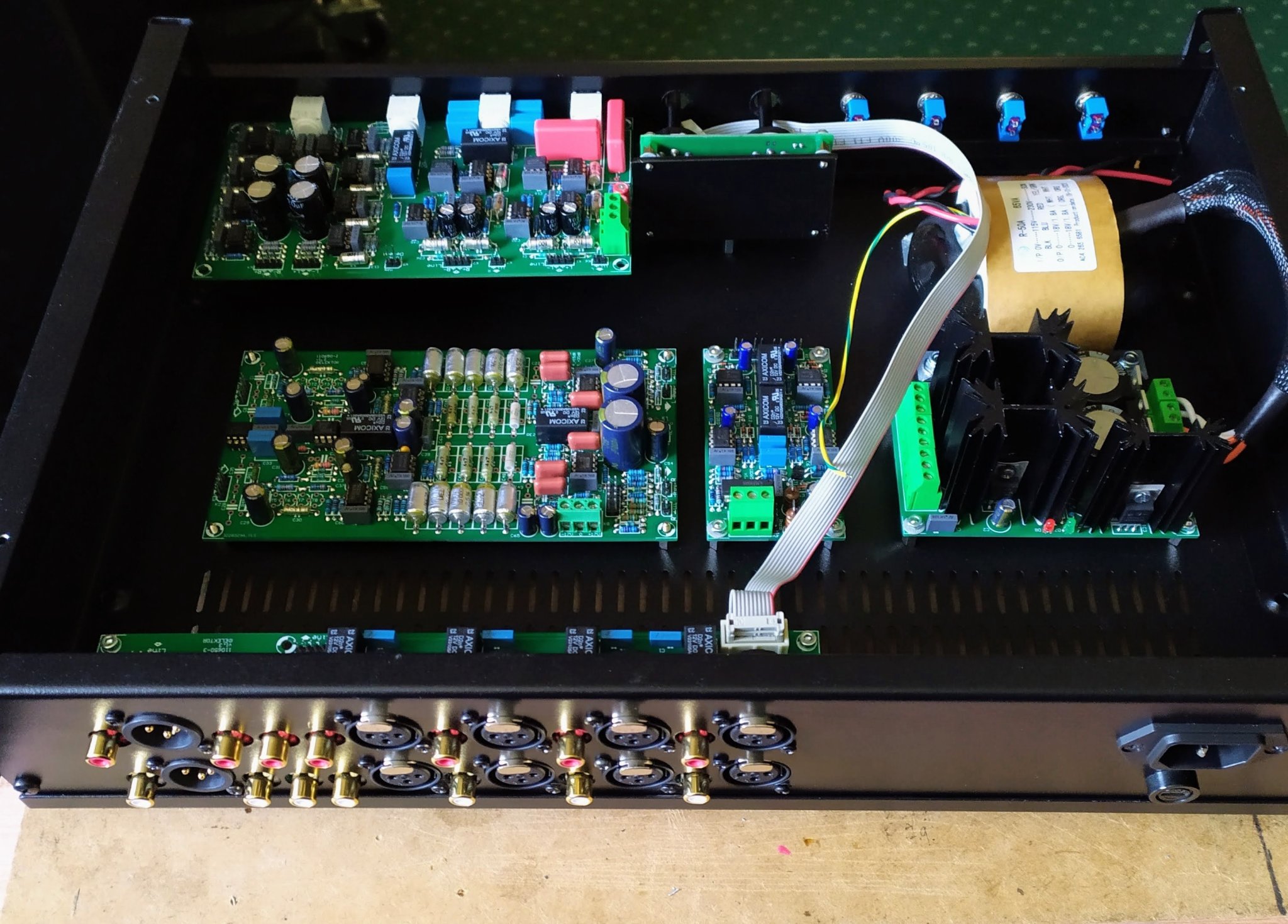

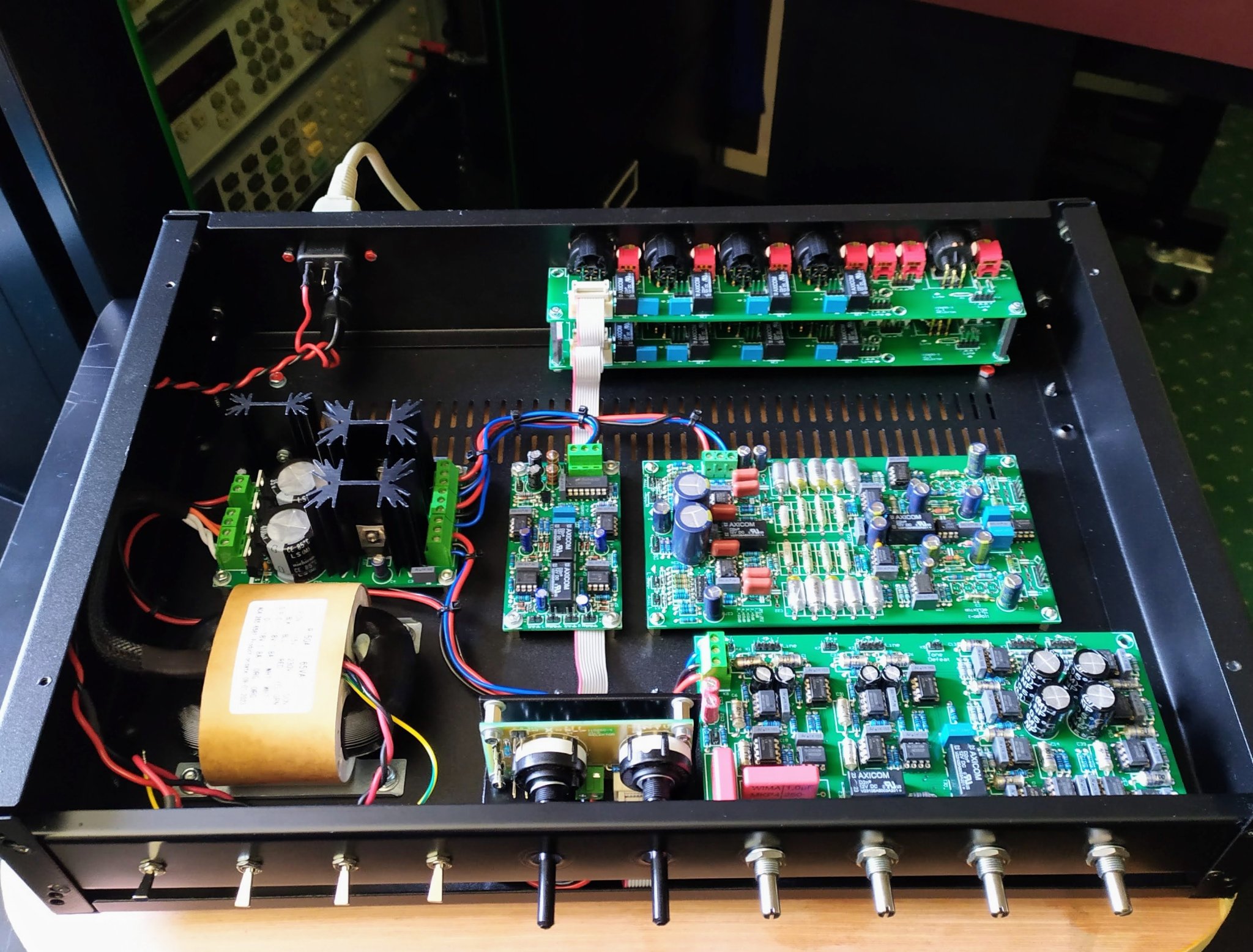

Looks good. I'd site the ribbon cable away from the power transformer, however.Today's progress..
Why ? It's only for powering the input relays.Looks good. I'd site the ribbon cable away from the power transformer, however.
There could be a possibility of hum pickup, although if it's just for energizing relay coils, then likelihood of induced hum is small, and it's no issue.

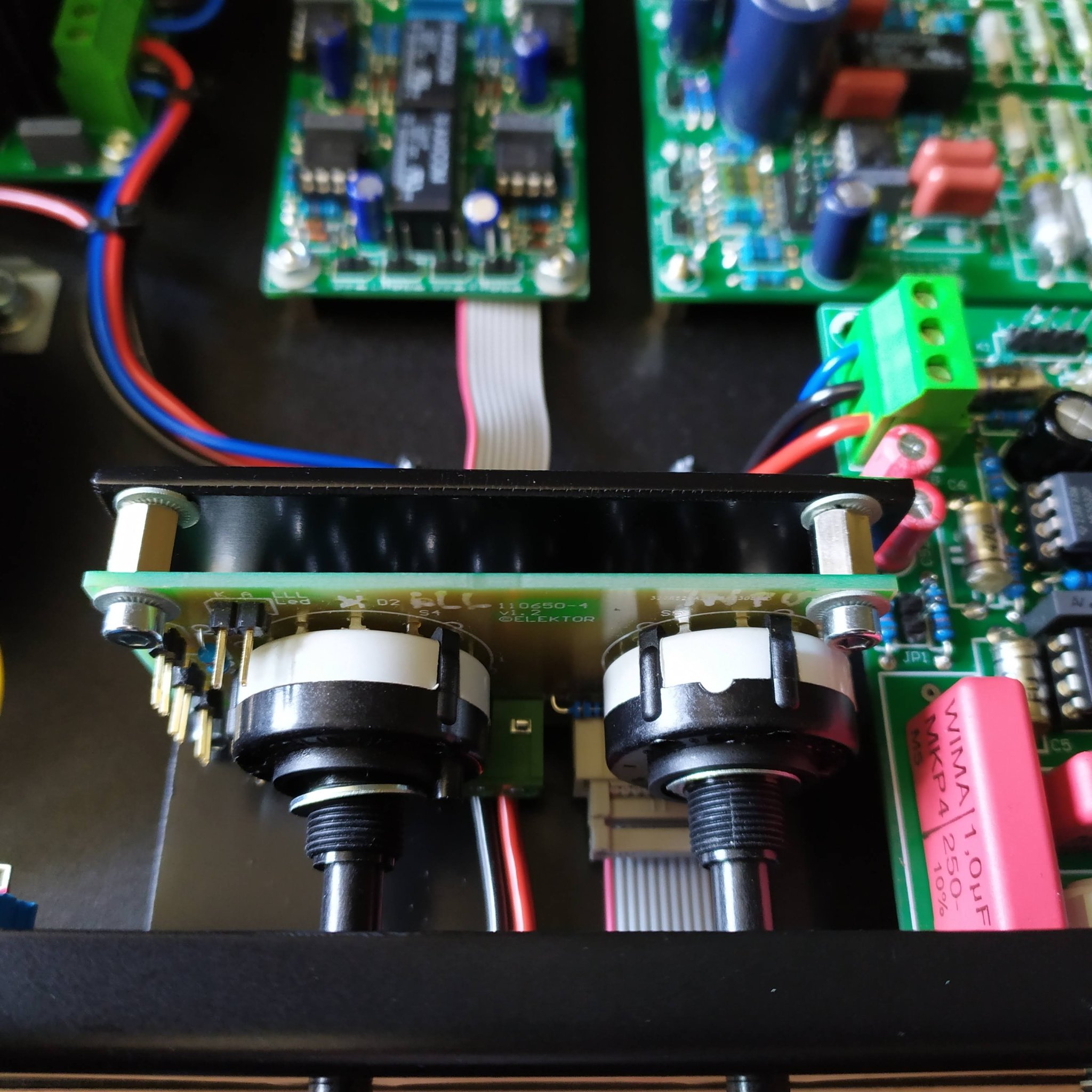

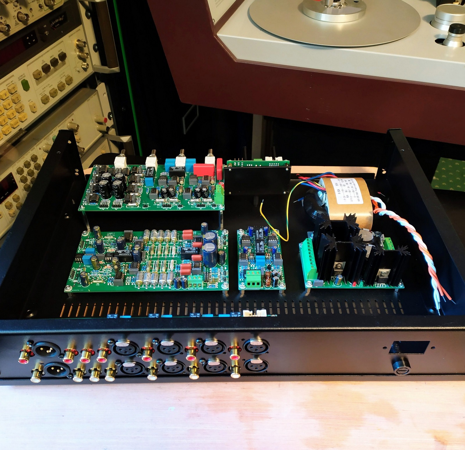

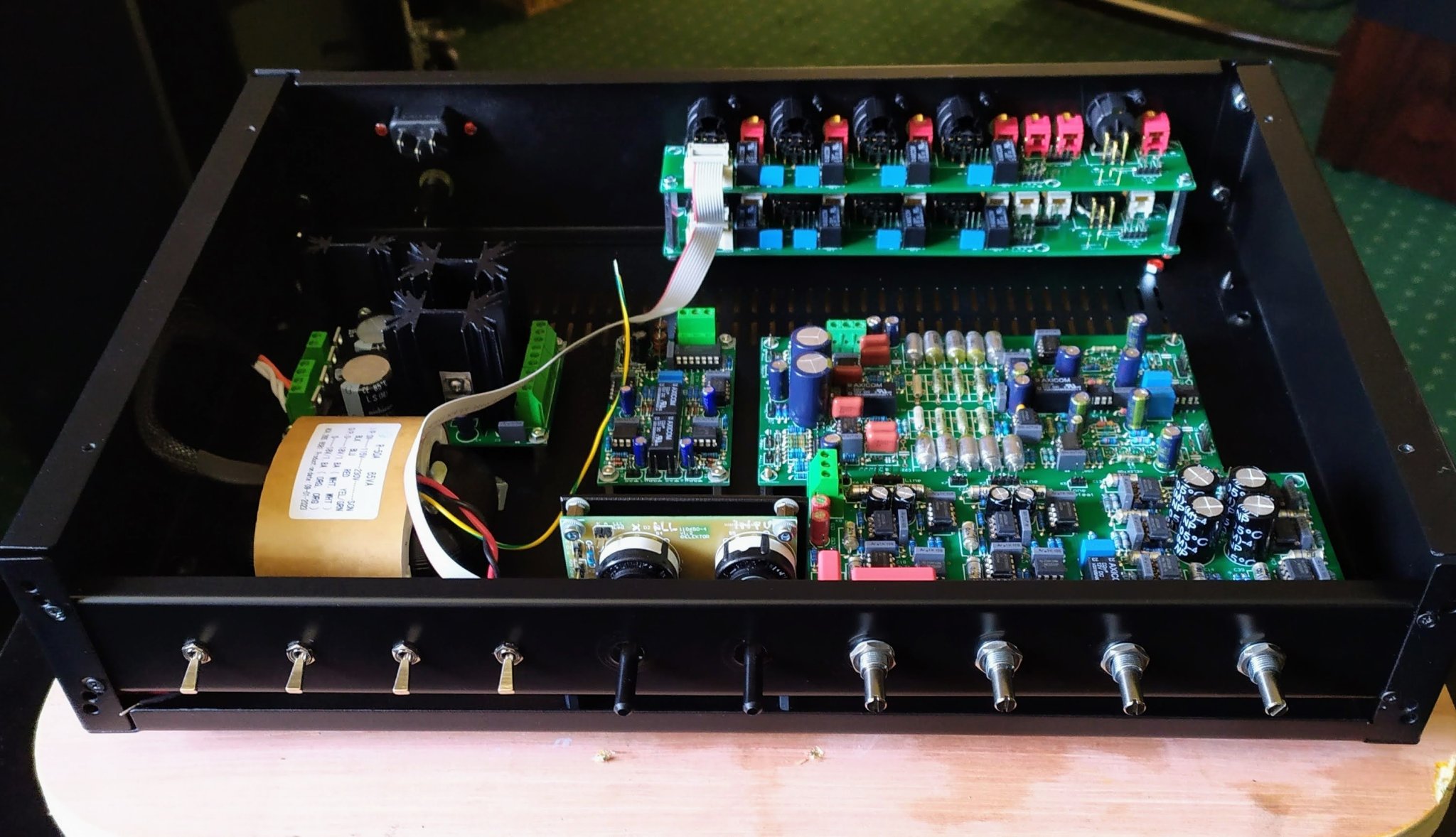

This is a good presentation of what it is possible to do and how to arrange the pcbs within the case. When do you think the first tests would be done in order to have your feedback. Back on the picture we can lots of old but profesionnal HIFI materials ! Are they from your job/business ?Started wiring +17/0/-17 & 15V supplies.
Let's say I have built, maintained and repaired so many pro and consumer audio products that it became an habit to do so.Are they from your job/business ?

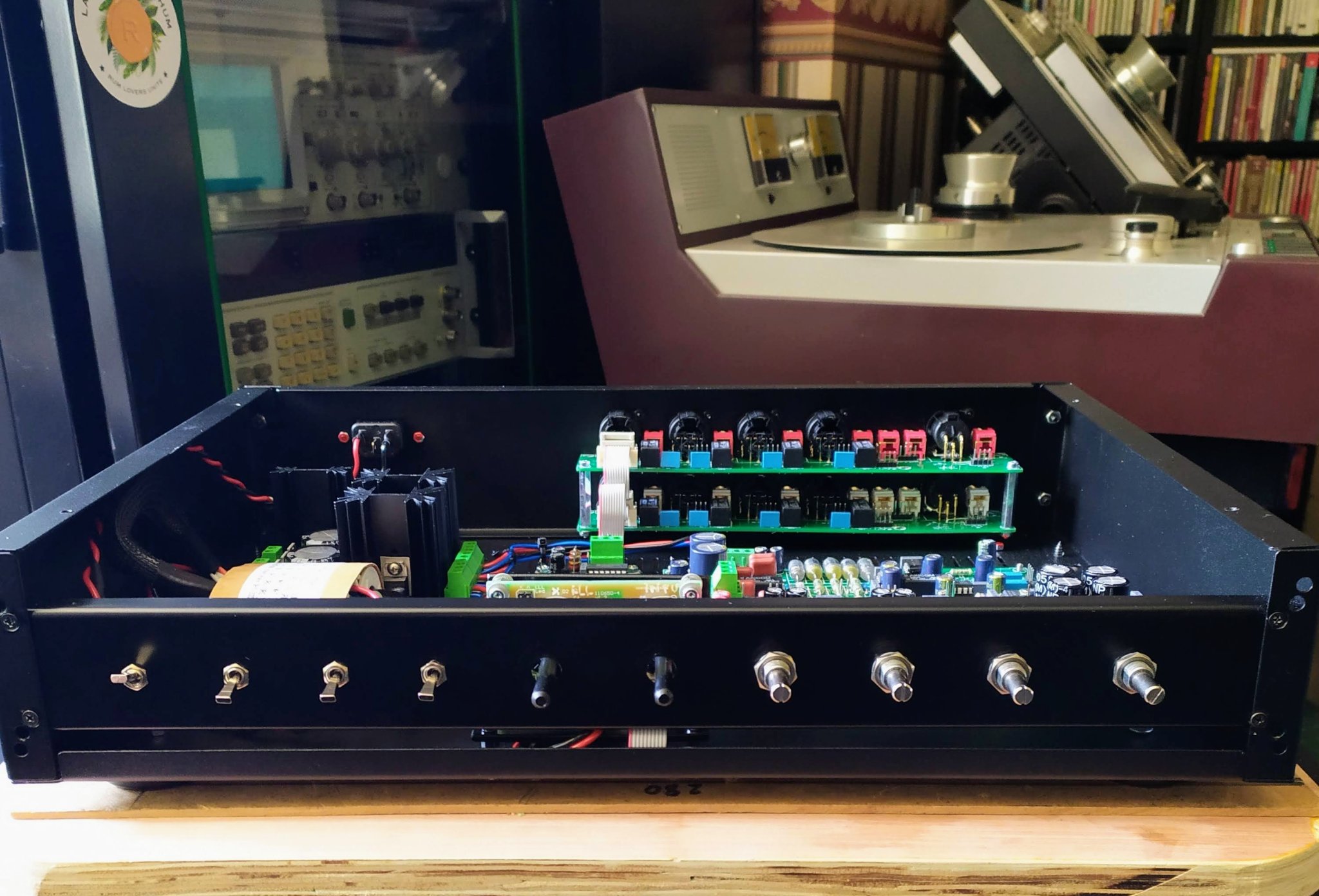

I still have to fabricate all the boards interconnects, that alone will take some time, probably a week or so. Last front panel parts are almost ready. Then I will insert it in a system and focus on listening, but I feel confident about the result.When do you think the first tests would be done in order to have your feedback

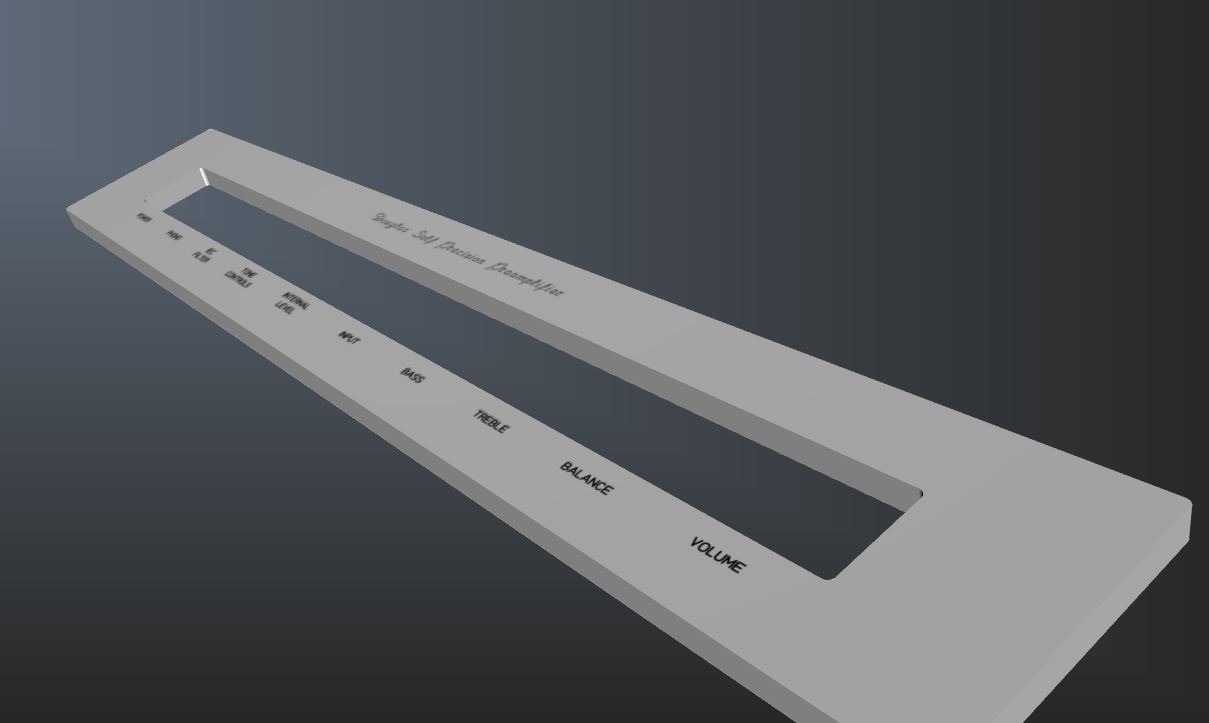

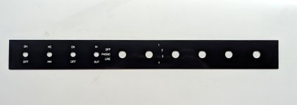

Main elements of the front panel : aluminium front plate and engraved glossy plexiglass backplate, this one is to be installed behind front plate's rectangular aperture. 30mm diameter machined aluminium knobs are being fabricated.
