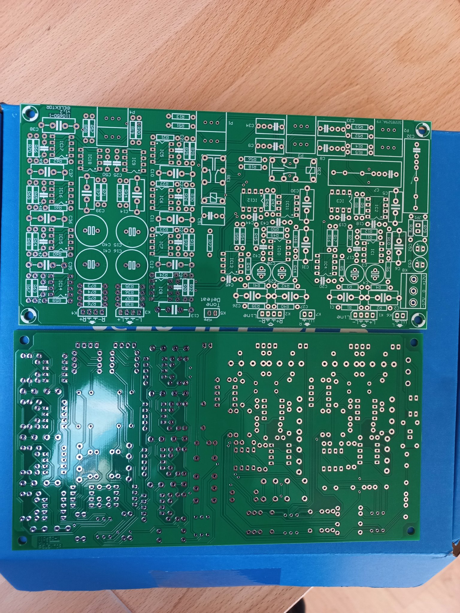

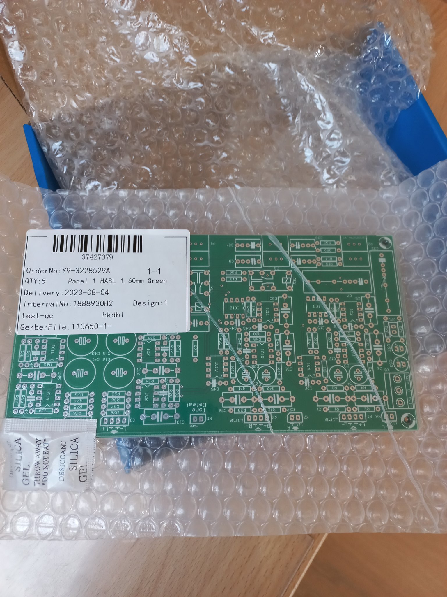

I am building a clone of the SUGDEN A21 amp (class A) and want to associate a very good preamp with RIAA, tone control.
That of ELEKTOR 2012 caught my attention. To validate the quality of the PCBs manufactured by JLCPCB, I ordered the tone corrector part from them. Superb quality.
Now that I am sure I can have PCBs, I would like to have feedback from those built or use/used the Elekto Preamp 2012 or want to go in the same adventure than me!
So any feedback from this preampli would be appreciated, going to build it alone with no support is a bit hard.
Please let me/us know
Georges

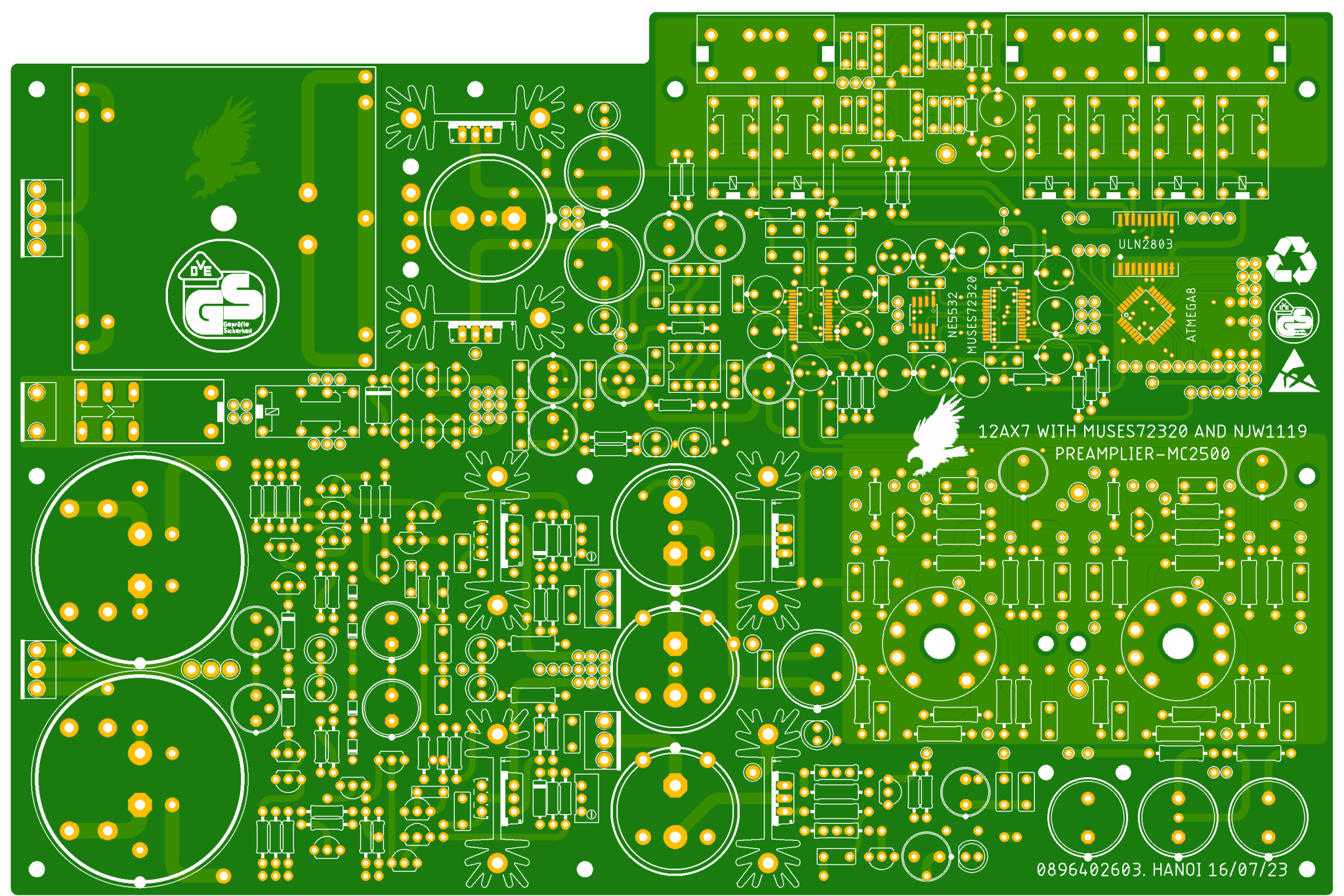

I've downloaded the Gerber files, might start working on this project :scratch2:

When you order PCB to JLCPCB the minimal qty is = 5. I ordered the Main PCB to see how job's done. It looks perfect. So I have 2 more I can resel if that interrest someone. Same thing for the rest of PCBs, I planned to make the order to JLCPCB on september, keep 3 to me and resell the 2 others at cost price +shipping costs. Lets discuss if any are interrested, just to help.

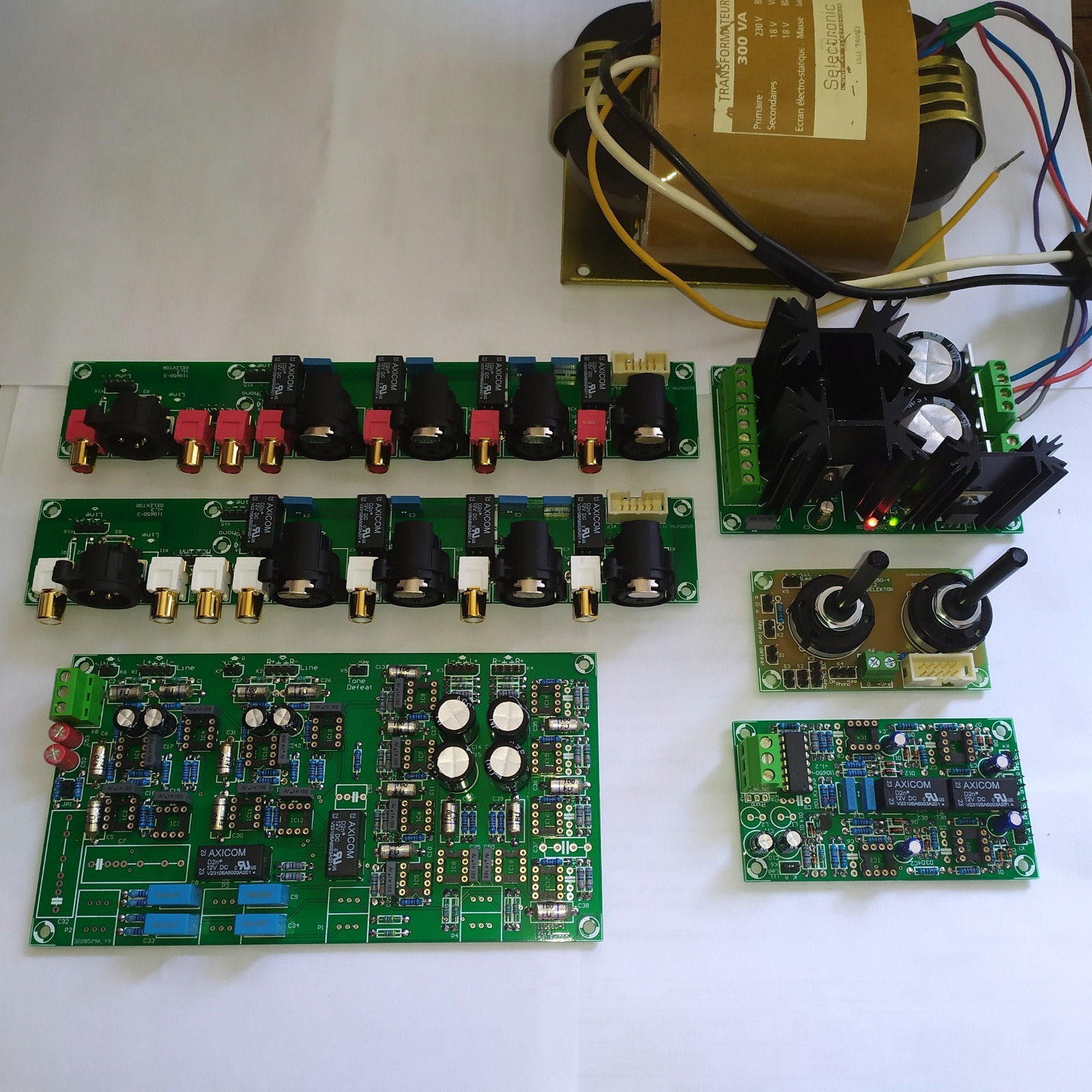

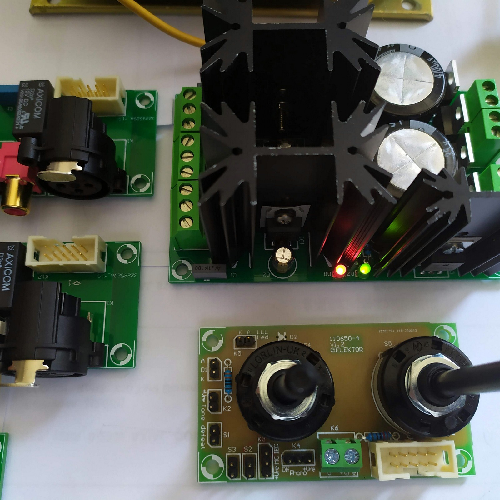

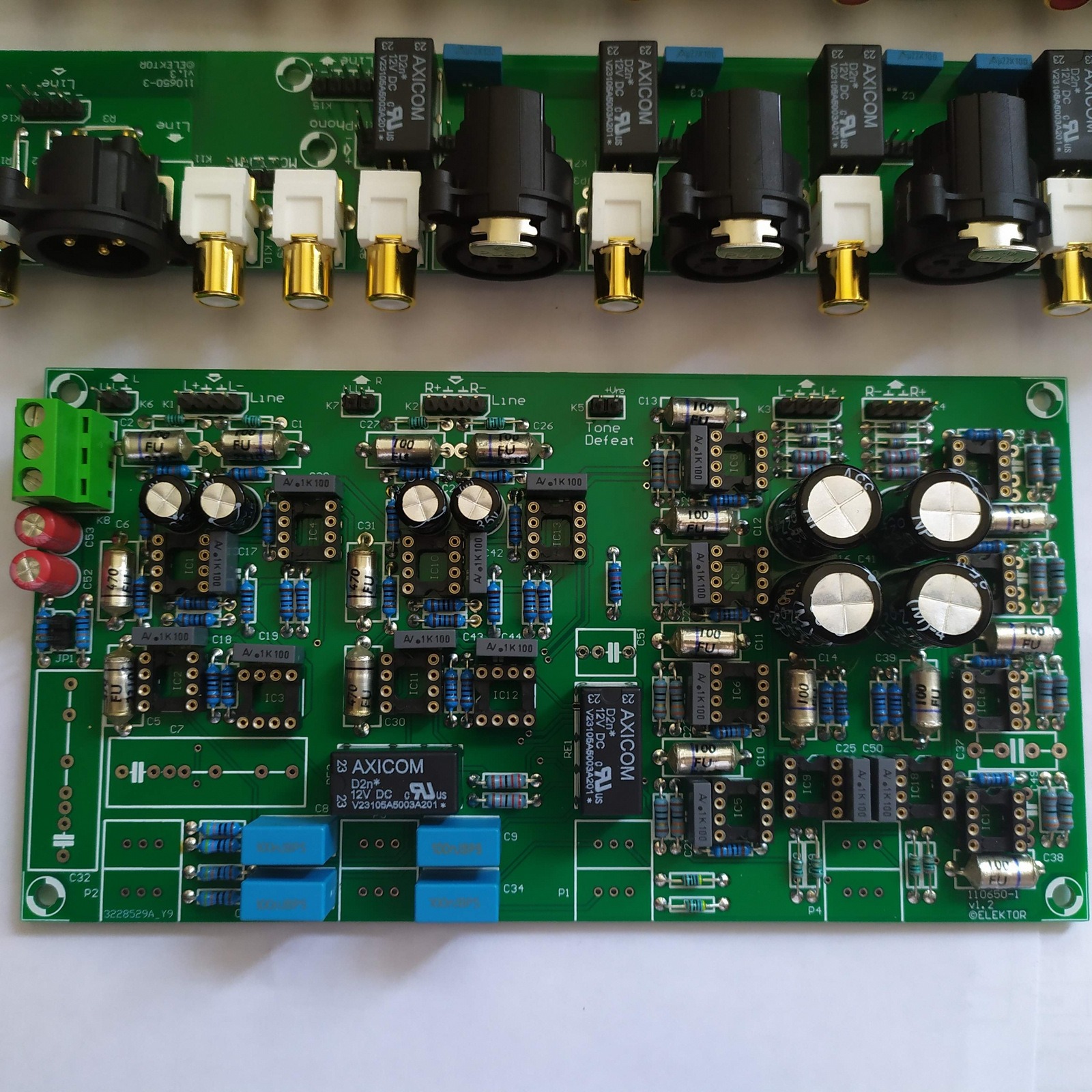

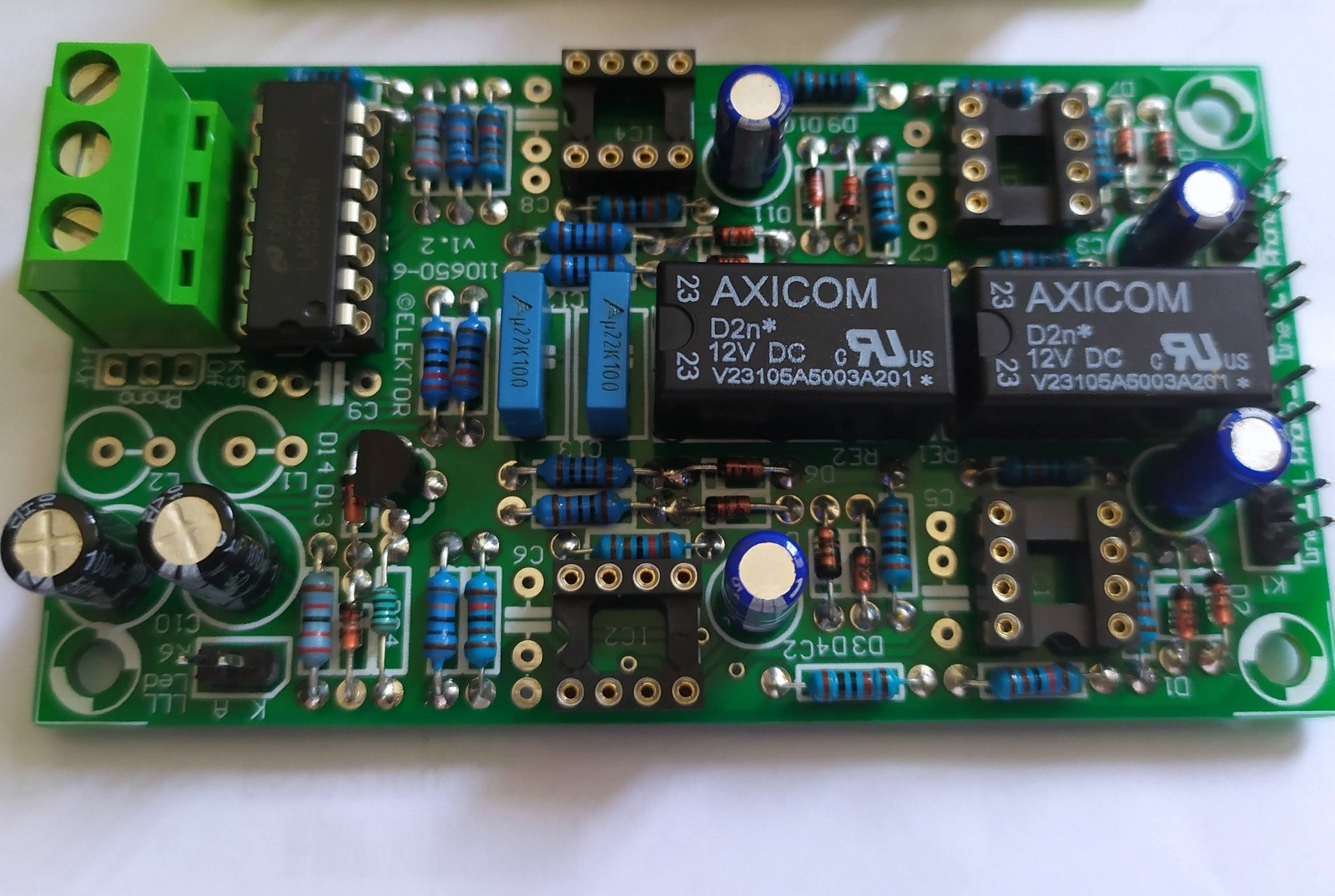

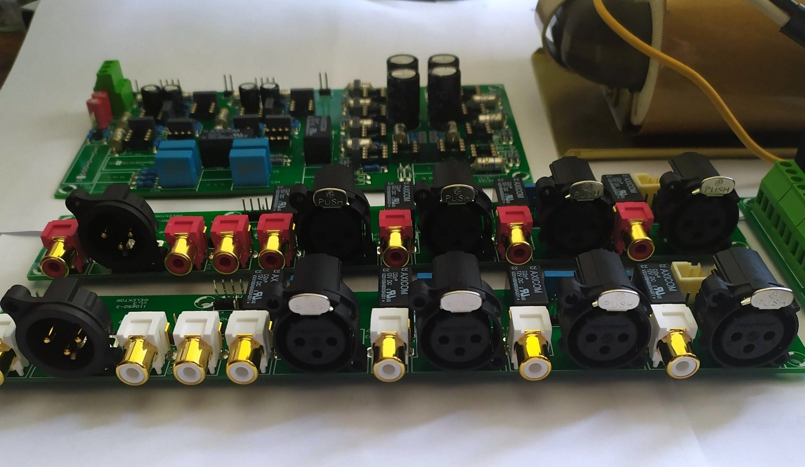

I'm doing good progress with this project. Only a few parts are missing butthey're on their way. Elektor's articles quality is outsanding.
Still have to complete phono preamp board and source a suitable chassis.
