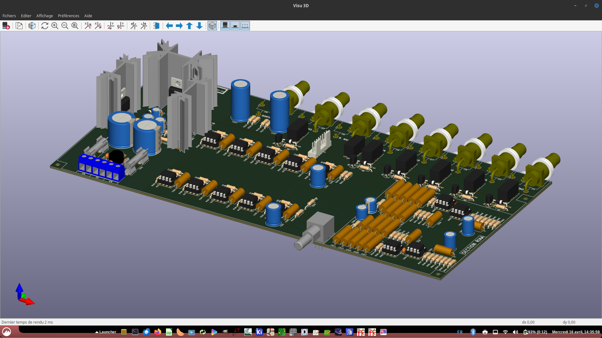

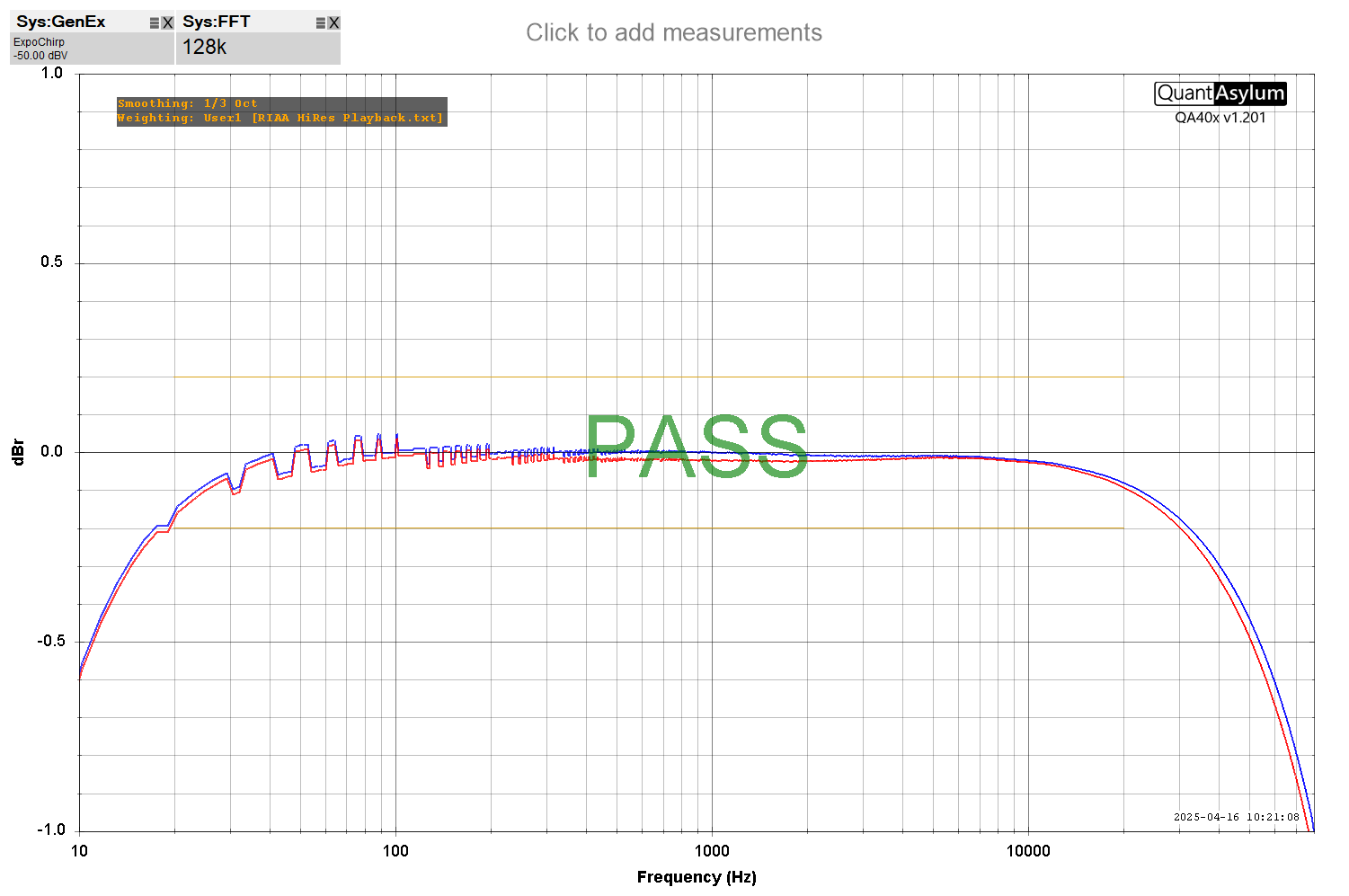

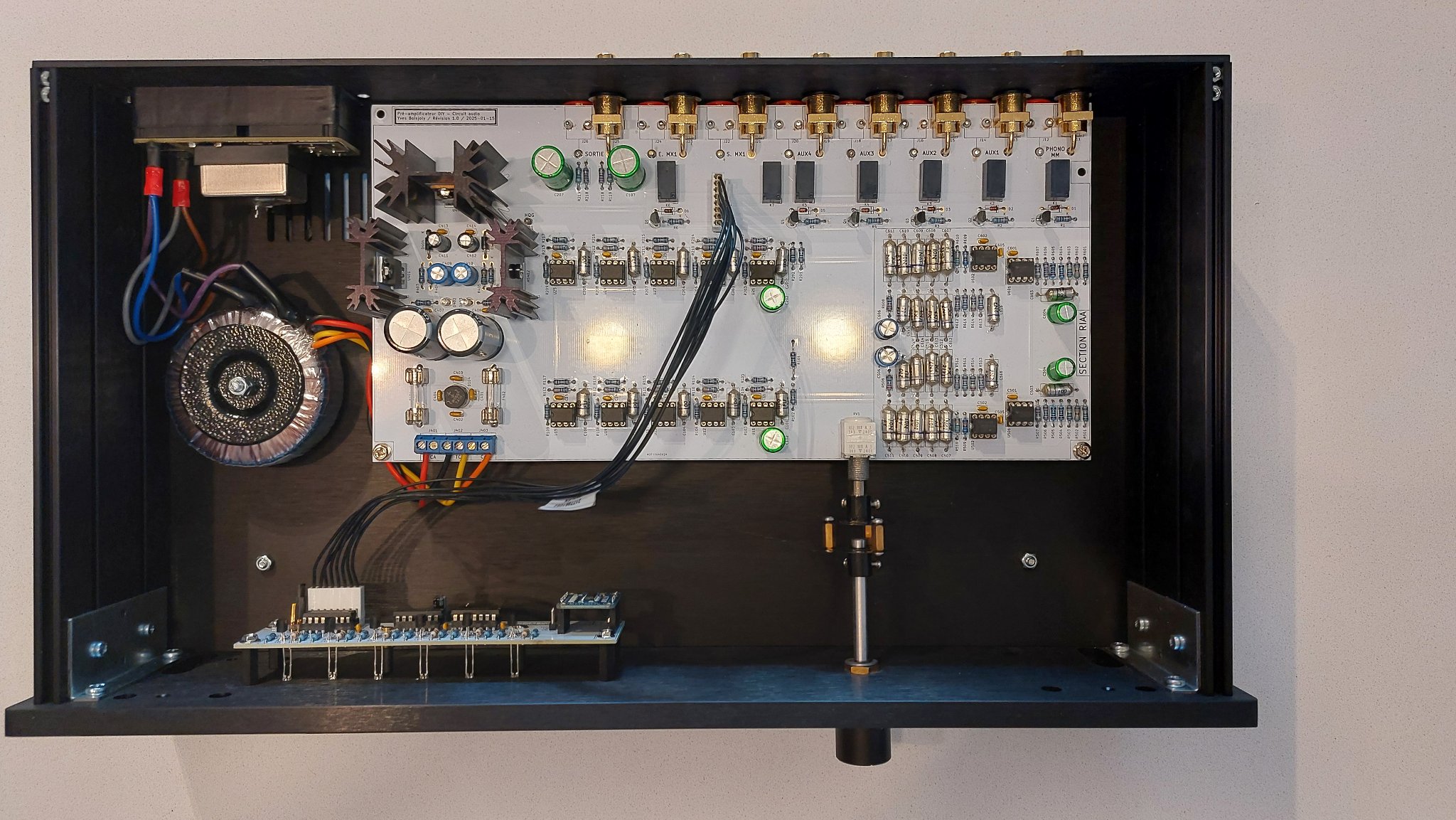

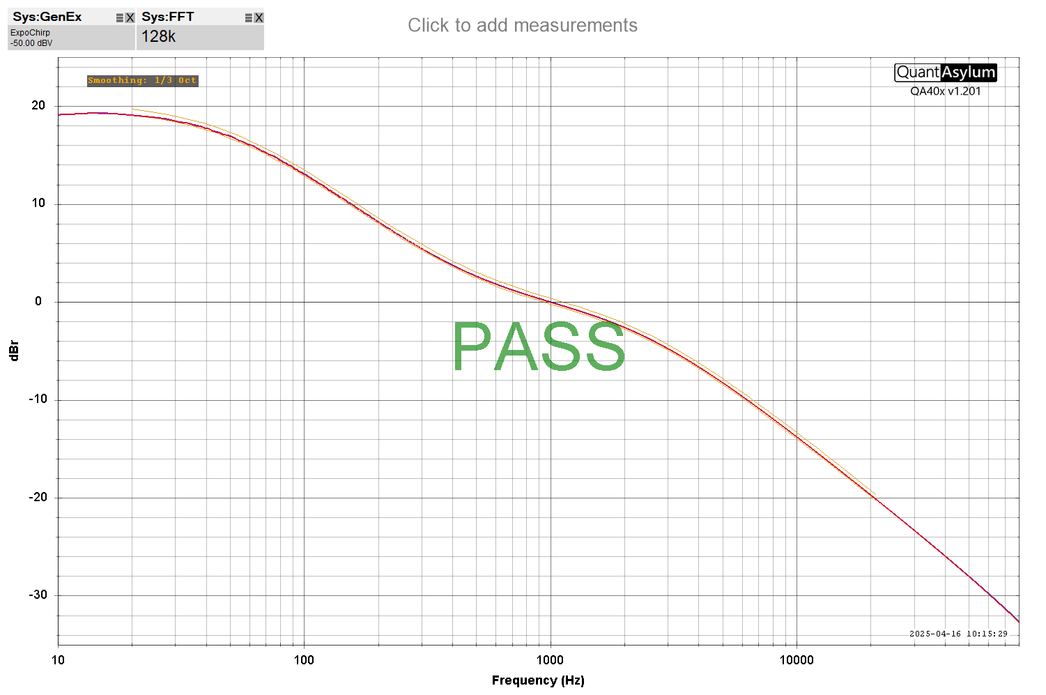

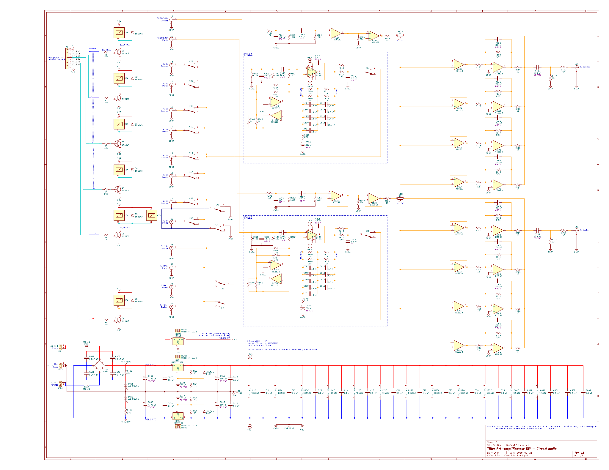

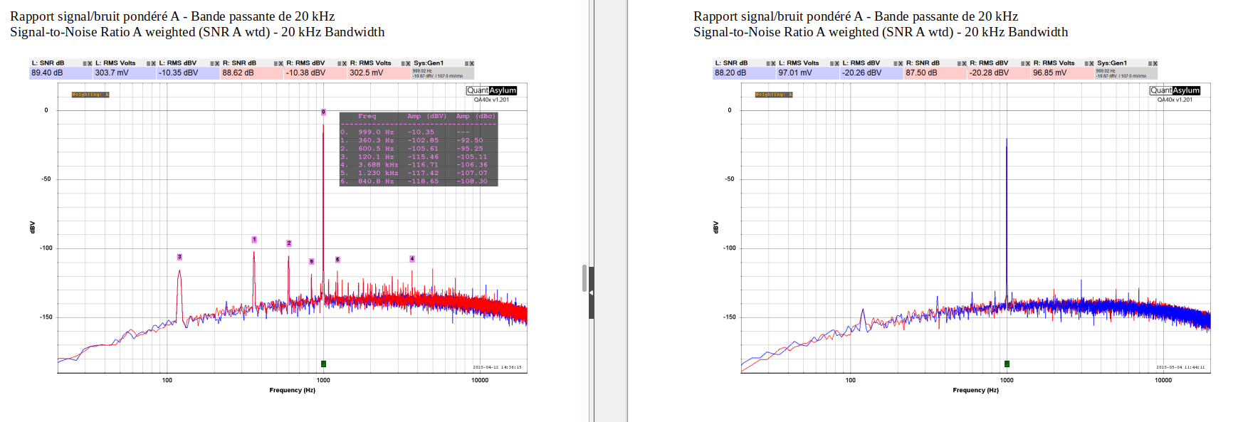

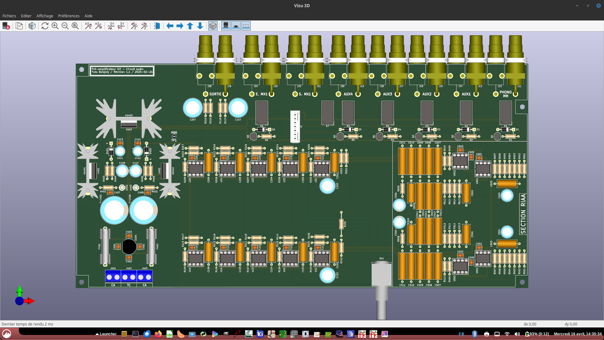

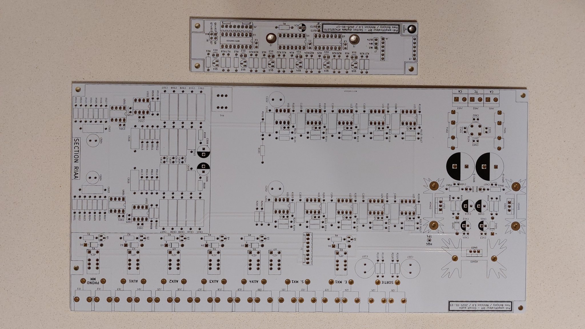

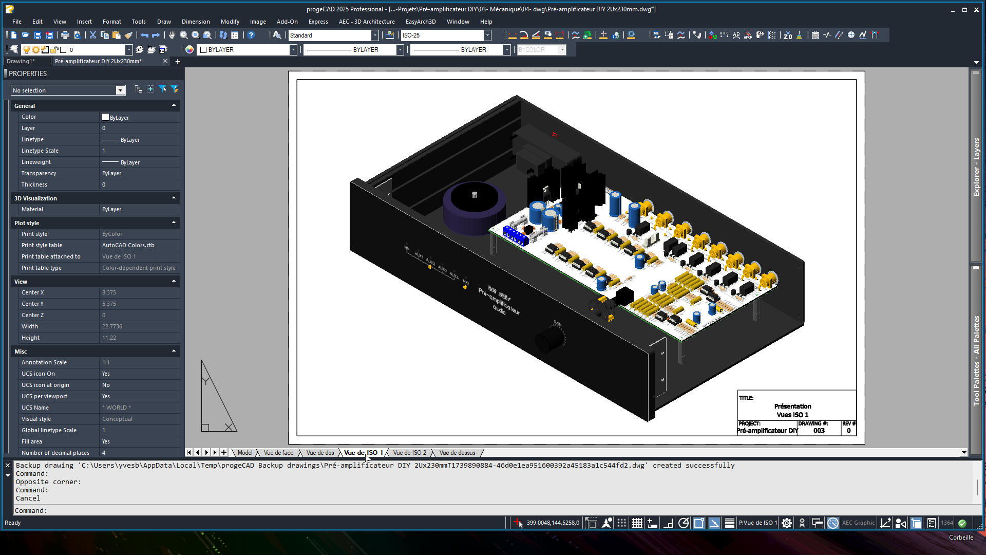

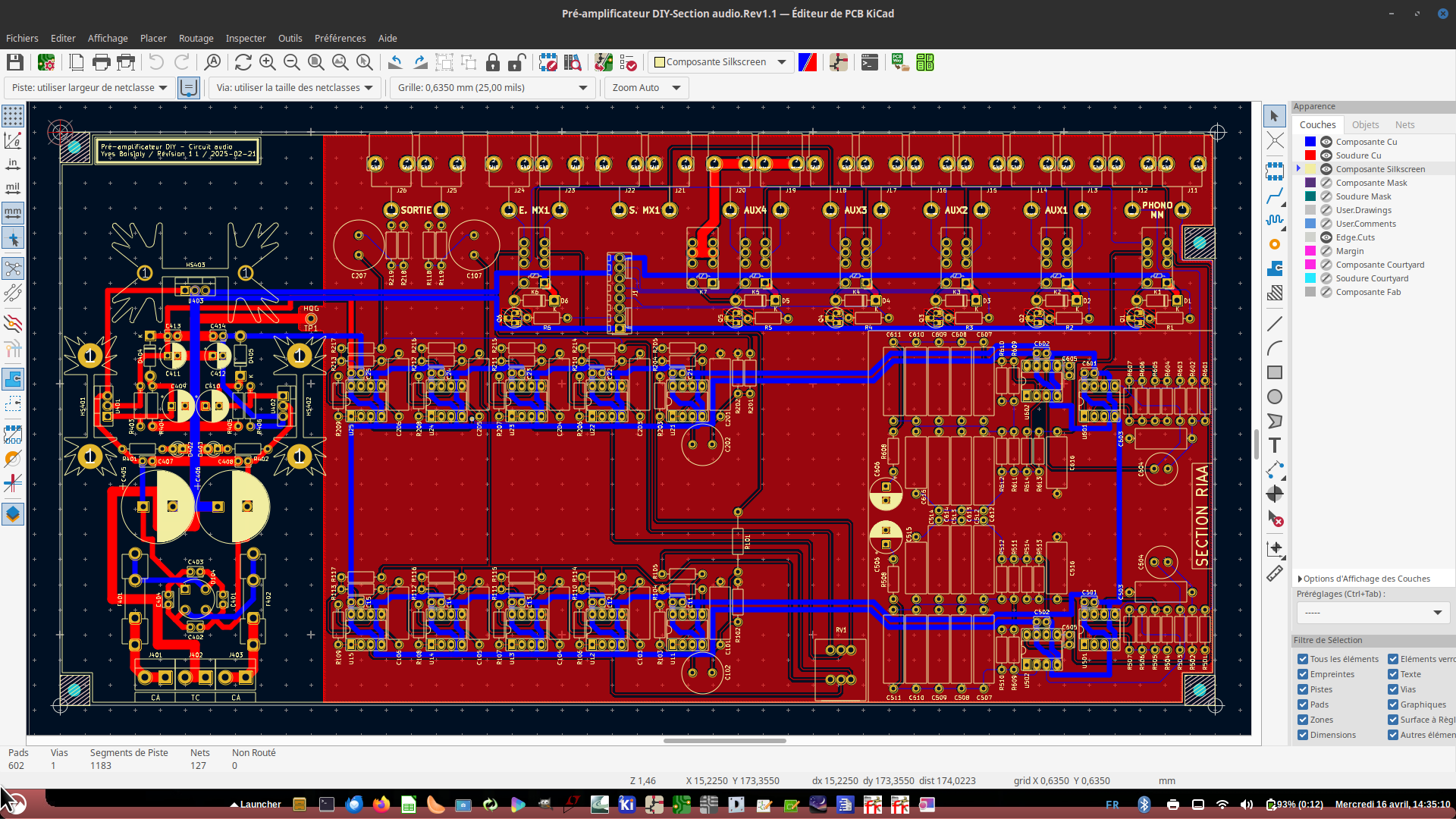

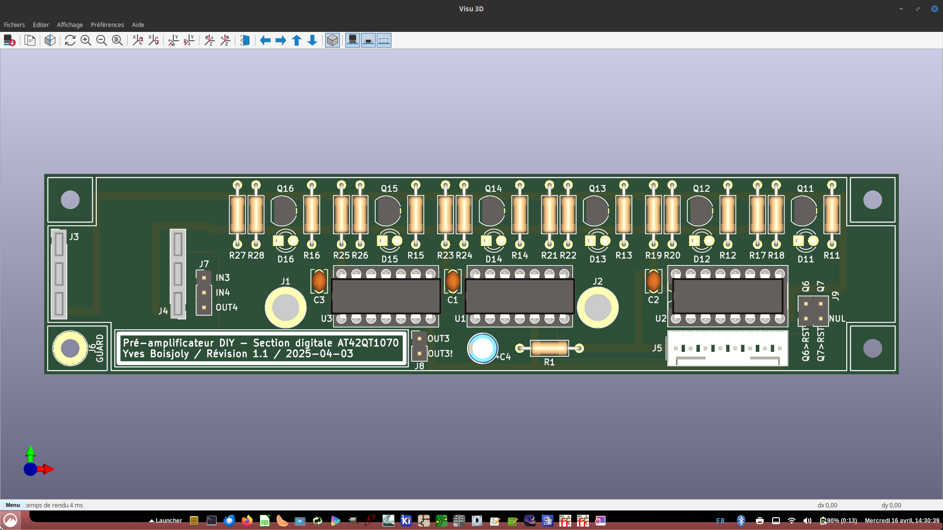

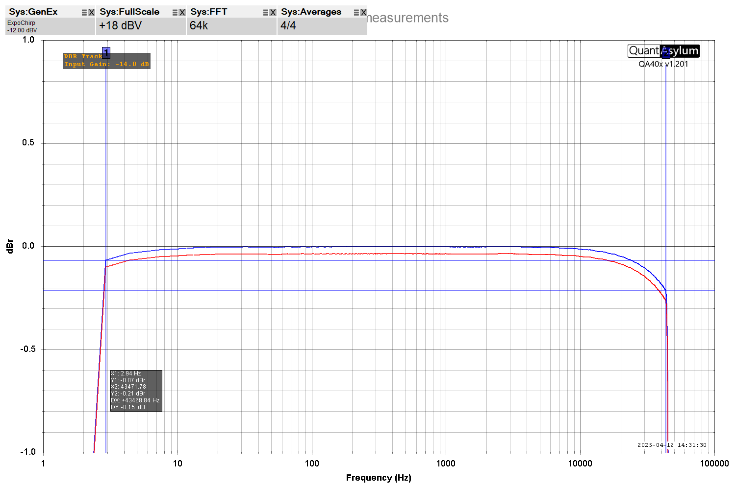

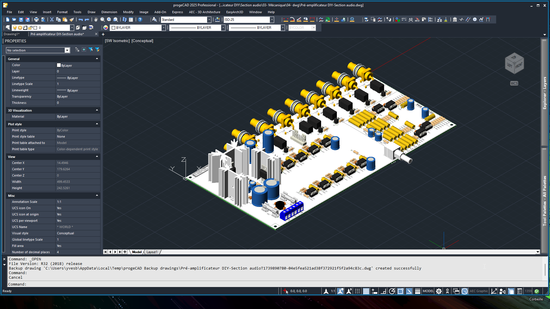

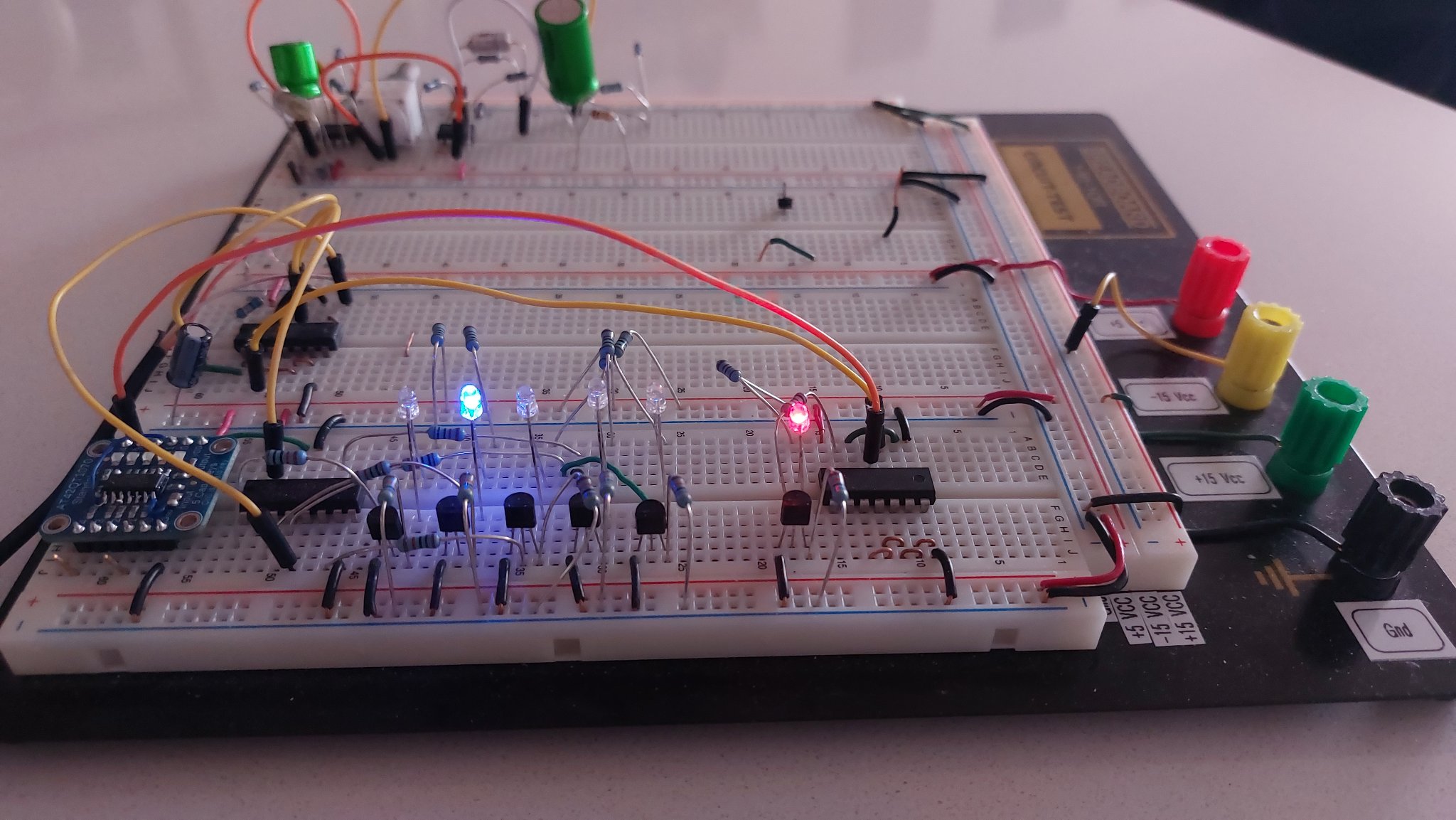

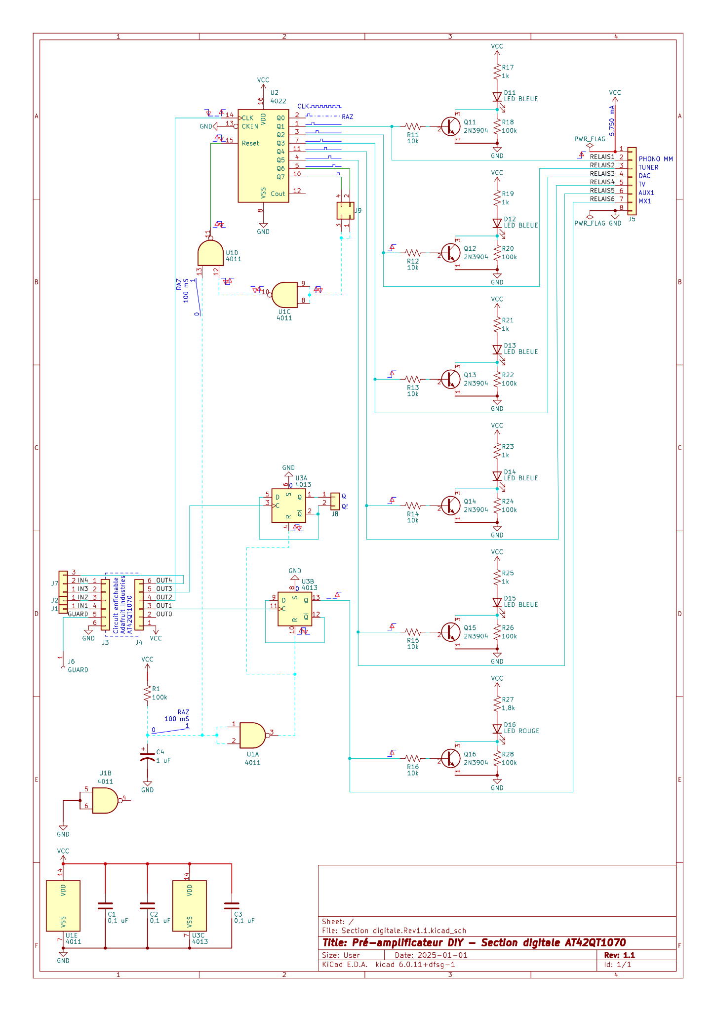

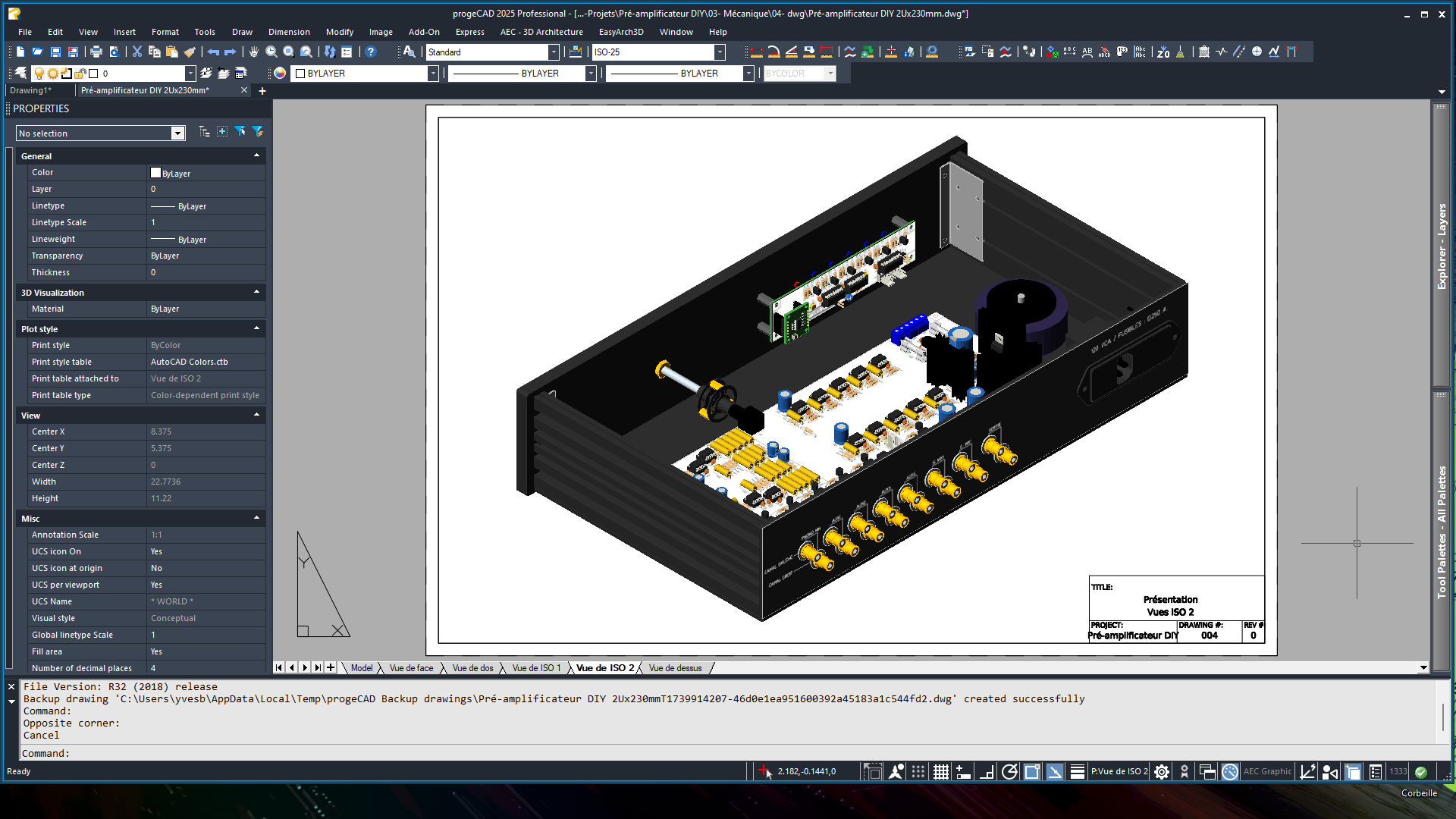

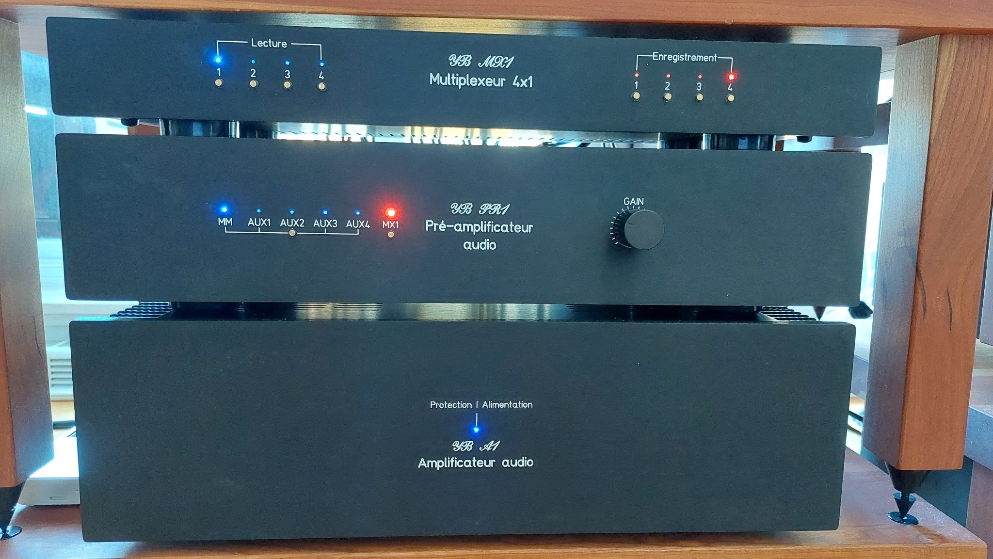

I totally forgot to share the conclusion of my original project here. As a resume, my pre-amplifier is totally build and works very well. In my modified design, I removed the tone and balance control totally. But I admit that with the volume control at the zero position, my Revox B760 tuner is a tiny tiny bit audible when this device is selected, but very low, almost imperceptible. I also suffer of the unbalanced image when the volume is at it's very beginning position. I will surely study more geoffw1 comment above!
My design is made around selection of source inputs via relay, including a "TAPE MONITOR" input, named "MX1" for my other project "YB Multiplexeur MX1" ; a 4 to 1 R2R tapes or cassette decks multiplexer. All controlled digitally with the Adafruit soft touch module. I used KiCad 6.0 for the schematic drawings and the PCBs. I exported the PCBs as step file and imported them into the progeCAD software, an AutoCAD cousin, much much less expensive. From there, I draw the 3D model of the box based on the Modushop Sim Line 2U 230mm. But pictures is much better than words, so here is the full story...
Seeing that we are limited to 20 pictures, I included a DropBox link below to see all the 56 pictures, including books pictures that I read two times entirely!
https://www.dropbox.com/scl/fo/cimv...ey=8qk2sd1qvsn62ht0kf2z72wl6&st=y3zkhli5&dl=0
You will noticed an extra relay K7 at the AUX4 input, that cut also the ground connection of this input. This choice was made because my SONY television was always making a little noise even when not selected. I used this trick to totally disconnected it when not selected. I changed my SONY television for Samsung 65" Neo QLED recently and the problem is not present with this model. The relay can be replaced easilly with two wires shorting pins 4-5 and 8-9, if prefered.

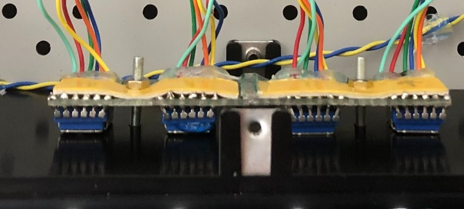

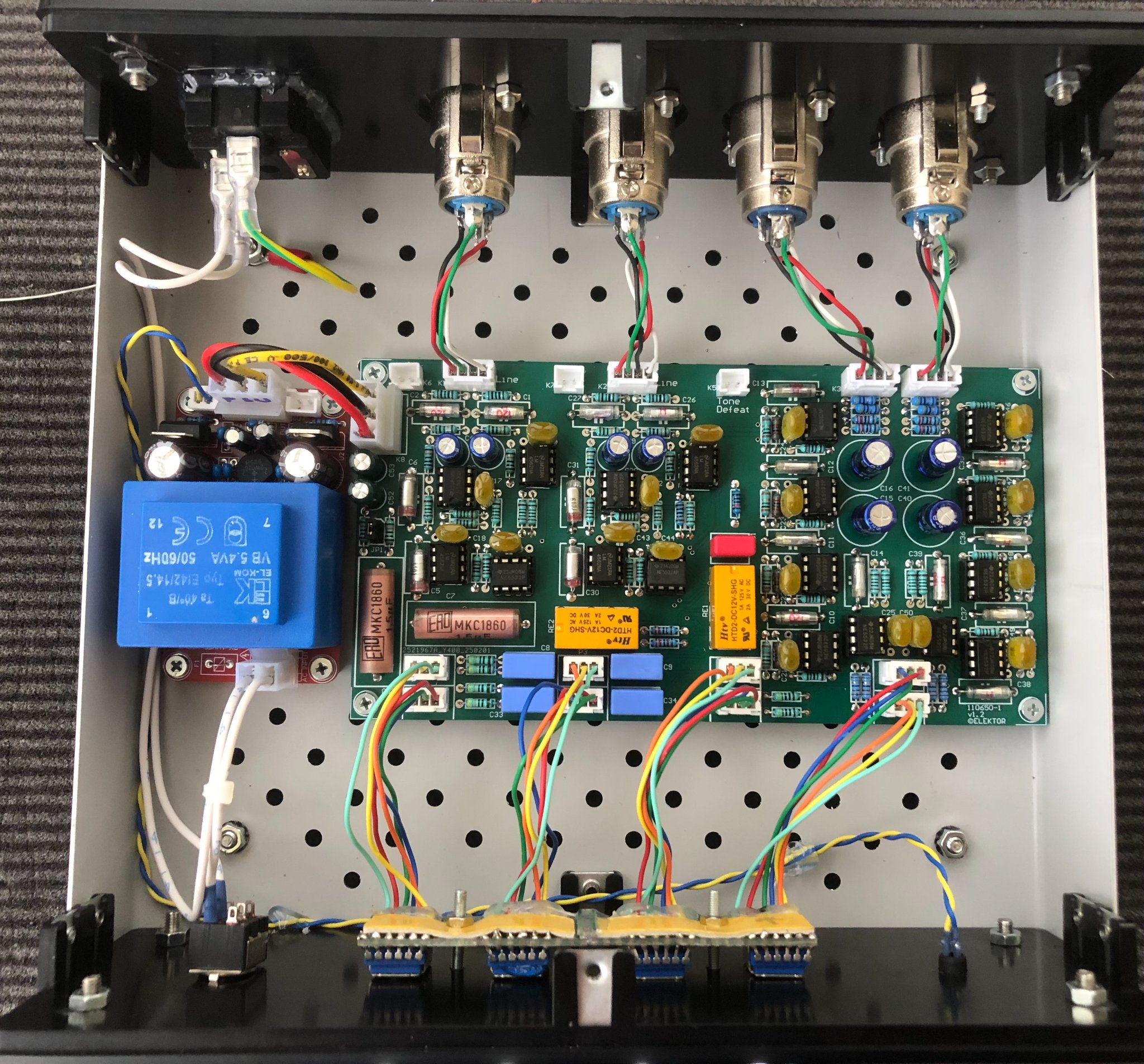

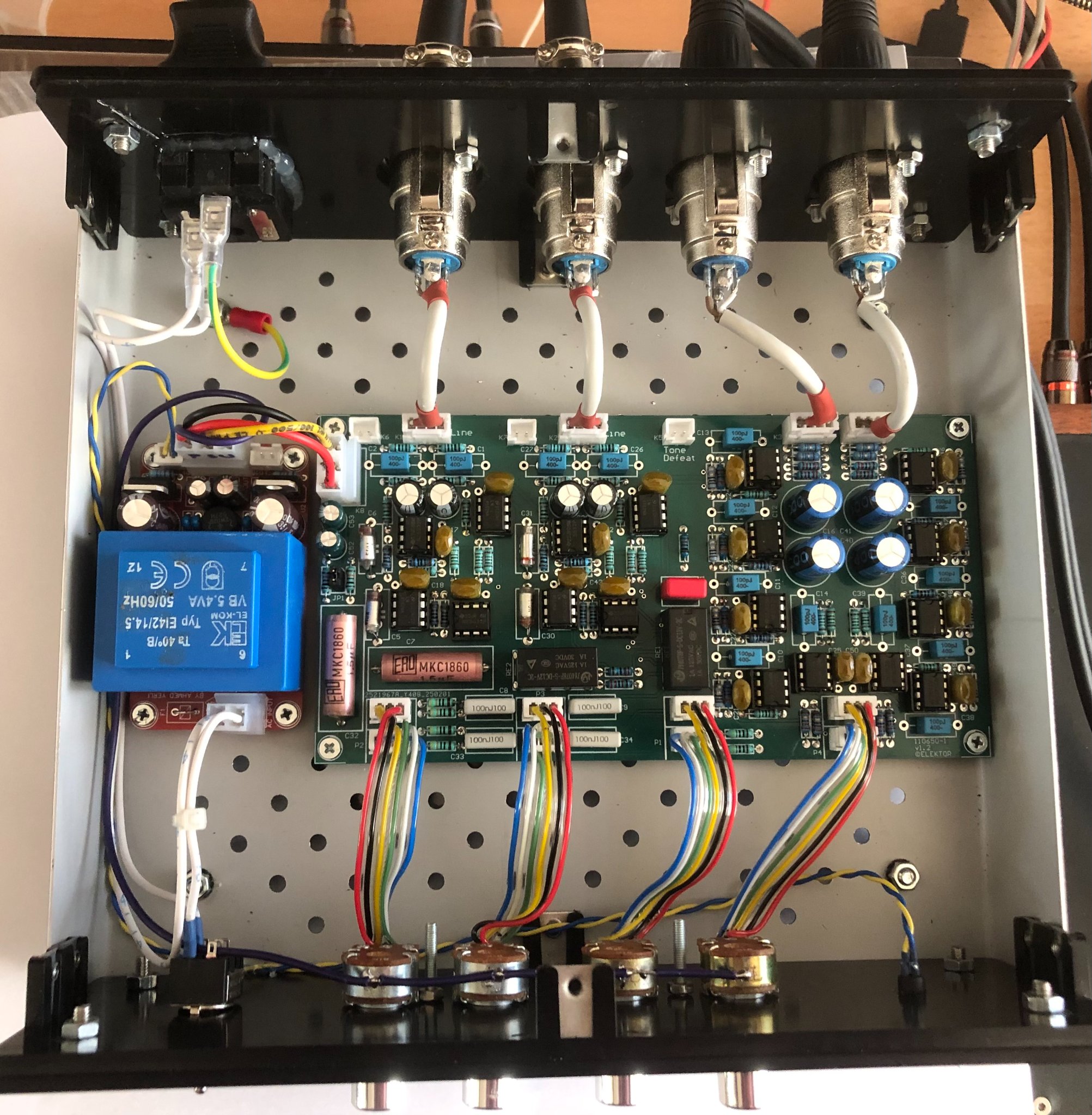

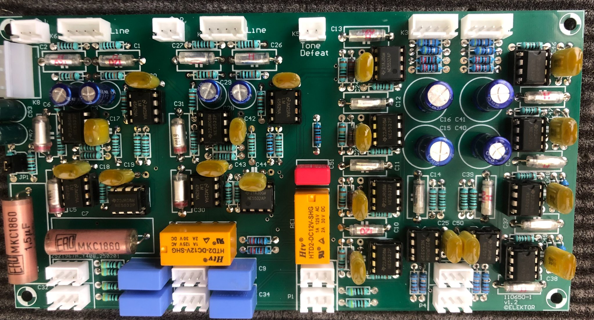

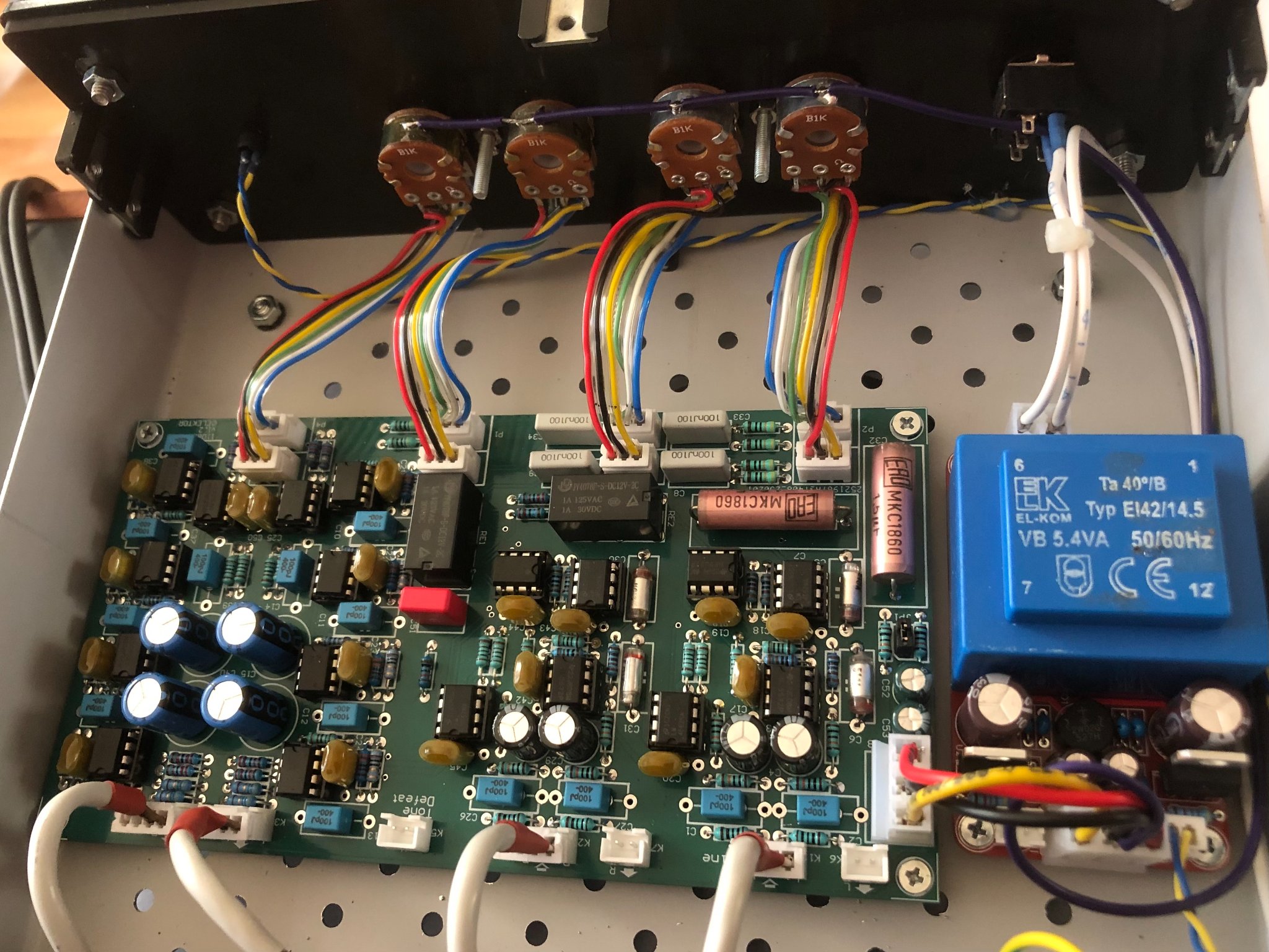

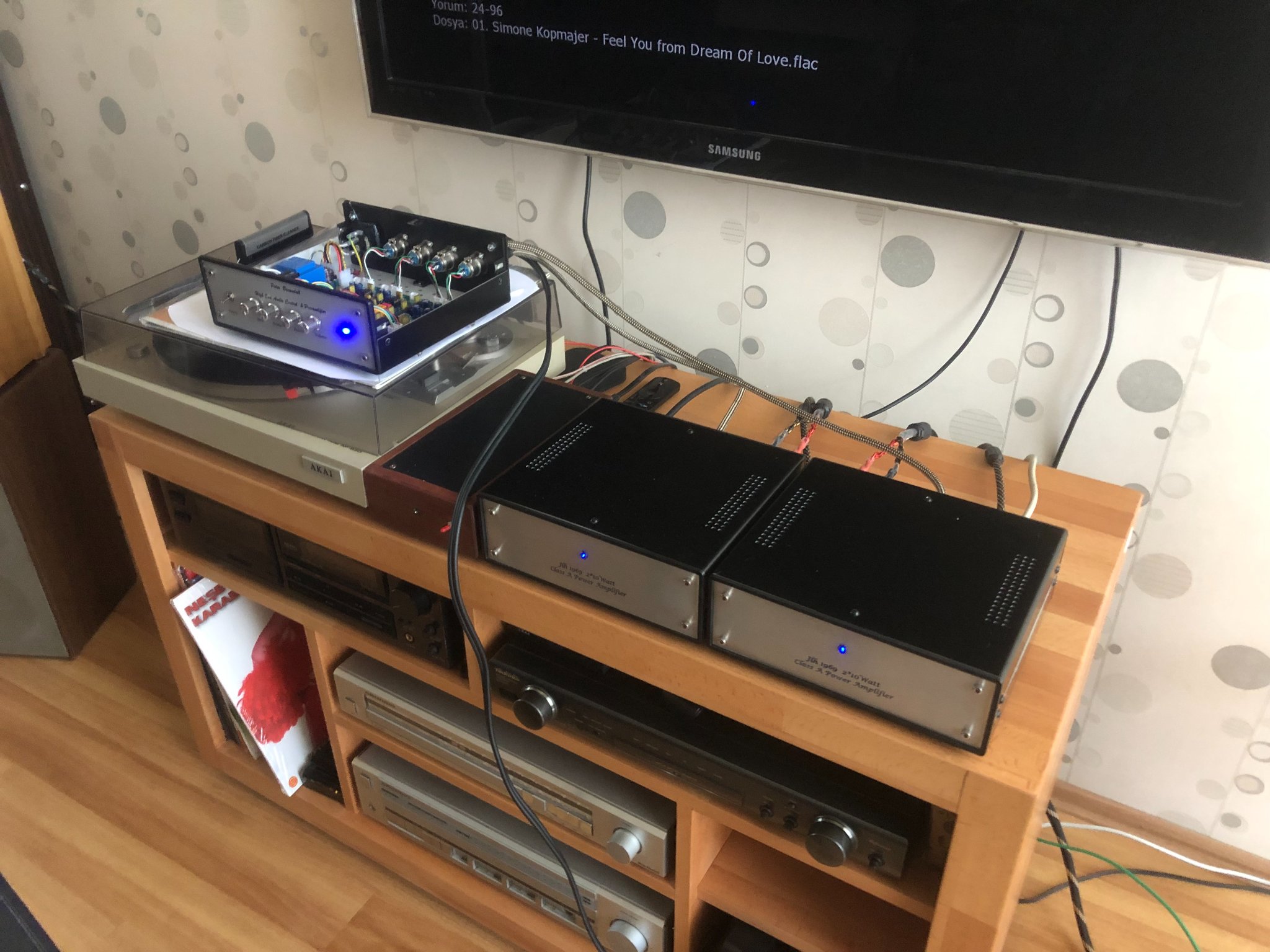

Following your advice, I replaced the 3k3 resistors with 1k. However, the problems did not improve. There is a sound that disturbs the ears at the lowest volume. The balance pot still does not work. Where could I be making a mistake.

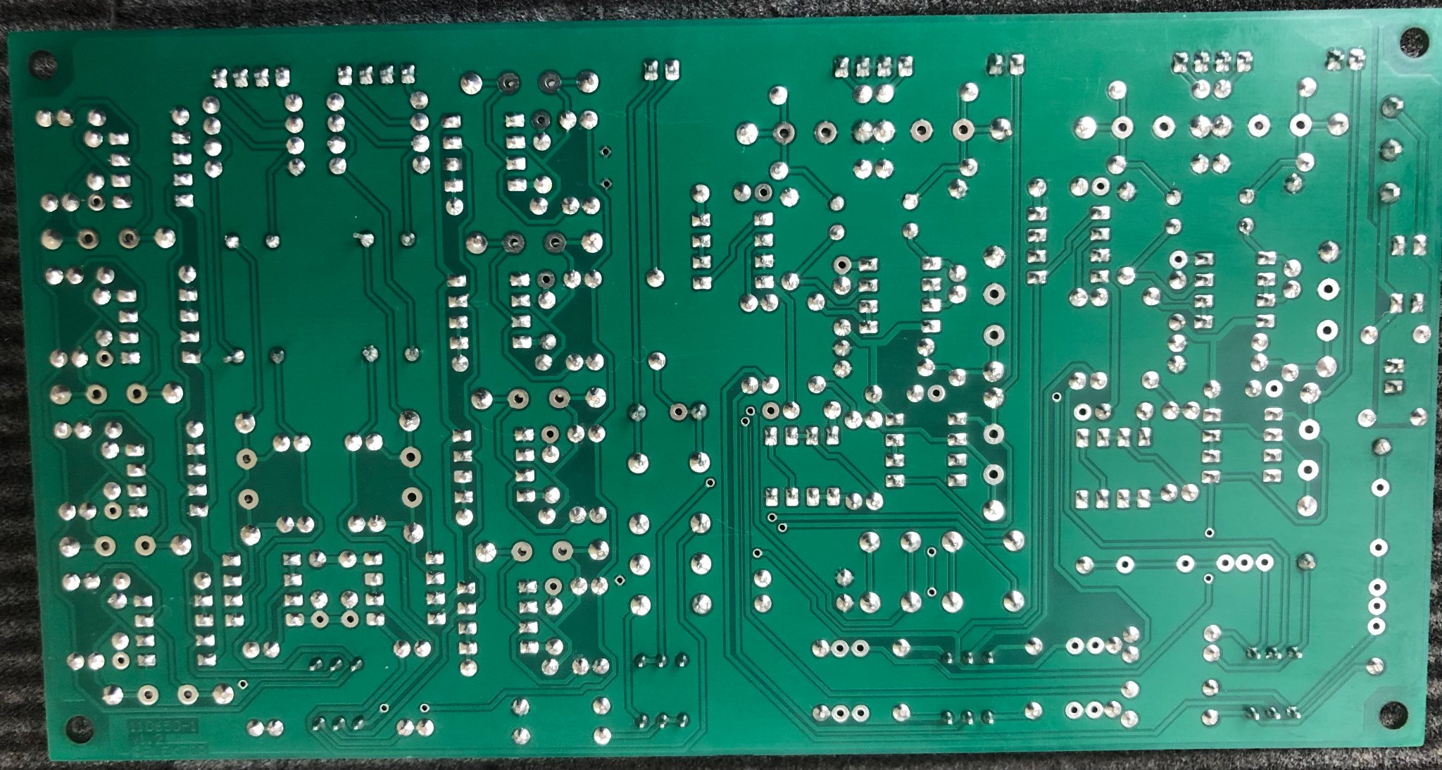

From the photos the pre-amplifier board appears to be very nicely soldered and does not appear to have any problems.
However, it appears that the terminal pitch of the four pots mounted on the panel does not match the pitch of the holes in the board, so the terminals have been widened and inserted. The pots may have a 2 mm pitch and the board 2.54 mm.
If excessive force is applied to the pot terminals, this may cause poor contact of the caulking part between the terminals and the resistive element.
Check if it is OK there.
hi,
I solved one of the problems. I changed the pots. I combined the bodies of the pots with the circuit gnd. When I did this, the bad sound in the low sound disappeared. Only the balance setting does not work exactly. When I make it full right or full left, a little sound continues to come from the other channel. I hope I will fix this problem with your help.

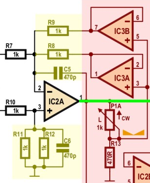

I haven't checked it carefully yet, but looking at the circuit in Sevy's post #1...
I suspect that D. Self's balanced circuits are different from normal balanced circuits in that they are intended to be fine-tuned only, without completely reducing the volume when turned all the way to the right or all the way to the left.
If it is similar on the left and right sides, it may be normal (as D. Self designed it to be).

I built the full version of this preamp, i.e. including the phono stage and LLL system, and I am extremely happy with it. Along the years I have used a number of preamps, including high-end models, and this one is by far the best I have ever had.
Here is what D.Self says about the balance circuit : "The balance circuit is a balanced stage with variable gain over a limited range. The maximum gain is +3.7dB and the minimum gain is 6.1dB. When the balance is set to center, the gain is 0.2dB."
I confirm that when the balance potentiometer is turned fully left or right the opposite channel is NOT mute, and I can live with this since I never felt the need to mute completely a channel. After all a balance pot is there only to to correct a slight imbalance between channels. A loud difference is the sign for a defect somewhere else in the audio chain.
I stand myself corrected, of course you should read "The maximum gain is +3.7dB and the minimum gain is -6.1dB"
Sorry for mistyping.
Hi, Thmartin, it was good to get confirmation from a real user.
I then calculated the gain of this circuit
G = ((R8//R9)/R7)*(P1A+R13)/R13
I confirmed that the gain of this circuit is. (but with R7 = R10, R8 = R11 and R9 = R12)
If P1A is 1kΩ (max)
G = (500/1000)*(1470/470)=1.564=3.88dB
If P1A is 500 Ω (centre)
G = (500/1000)*(970/470)=1.032=0.273dB
When P1A is 0 Ω (min)
G = (500/1000)*(470/470)=0.5=-6.02dB
The value of Self is slightly lower, but this is probably due to the inclusion of the residual resistance of the pots in the circuit and the losses in the circuit.

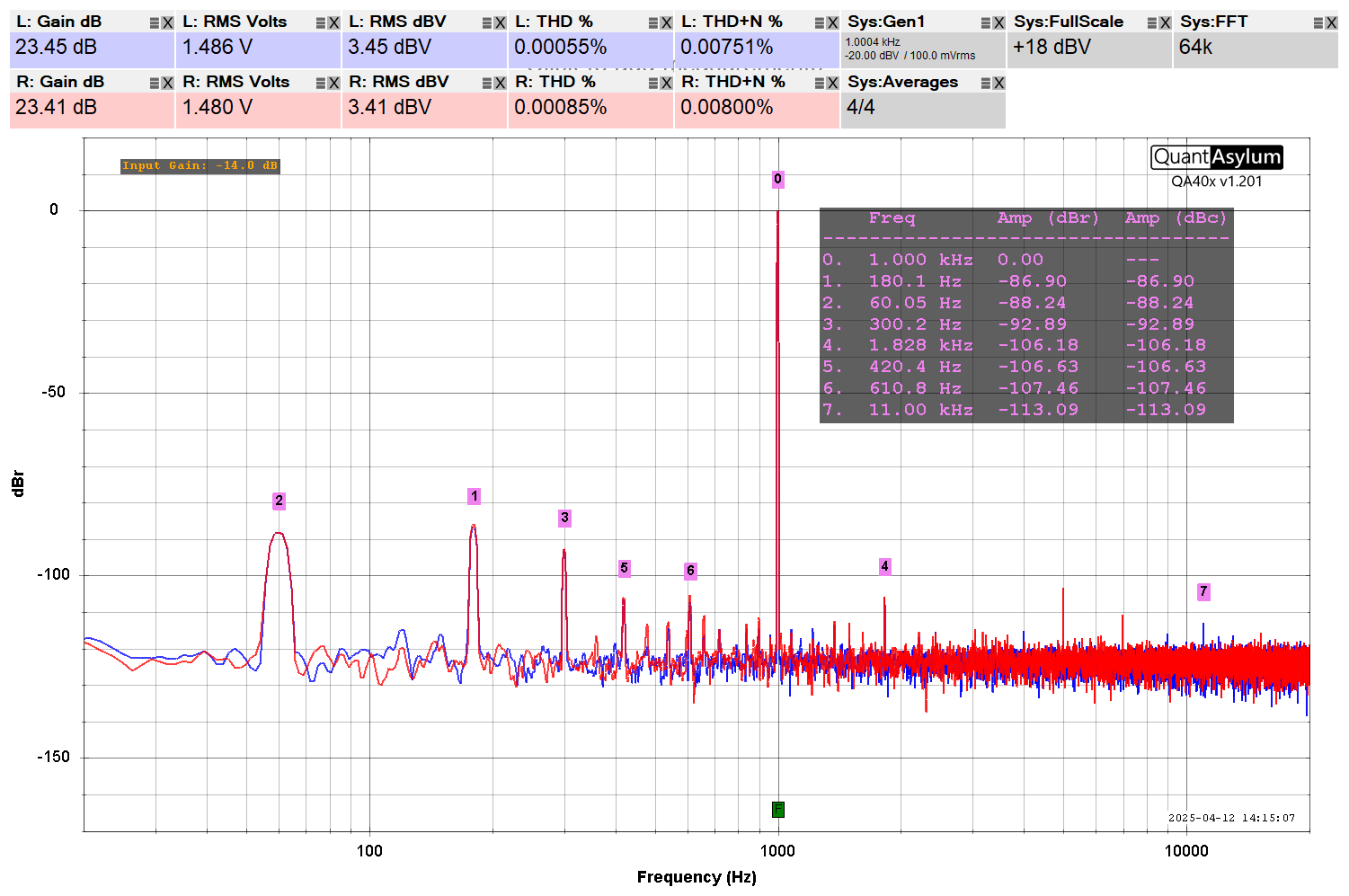

I did the modification suggested by geoffw1 above in the hope to lower the residual sound when the volume was totally counter-clockwise. Although it is not totally silent, it seem to have lower it a bit. That is probably because the total gain is minimized ; 23,4 dB versus 13,5 dB, as seen on my graphics below. The left graph is with 3,3k while the right graph is for 1k resistors. What does intrigue me is the 60 Hertz noise and all it's harmonics that suddenly disappeared with the 1k resistors, as well as a tiny amelioration on global noise showed on the two others graphs under the gain ones below. Could it be caused by bad cables on my lab gears?! I don't remember witch cables I used in the first tests...
No, this 60 hertz is typical to hum from the transformer. It's not pure DC like you suggested that could reach the potentiometer.Could it be DC on the volume control potentiometer?! Wild guess, sorry.
Of course not the 60 Hz, I meant the previous worse global noise because of higher gain. Not so sure there is no DC at all at the volume control potentiometer. In many situations a small DC offset on potentiometers is enough to make them create noise(s). Usually coupling caps are used but in this case the potentimeter is in the feedback loop.
