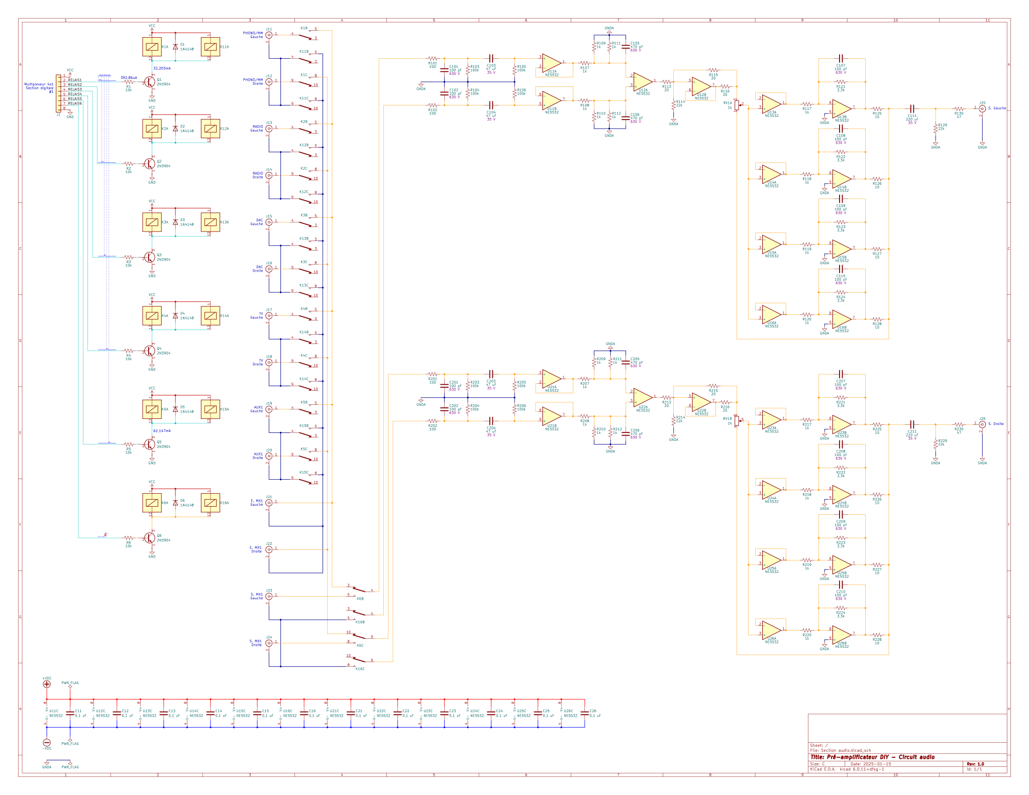

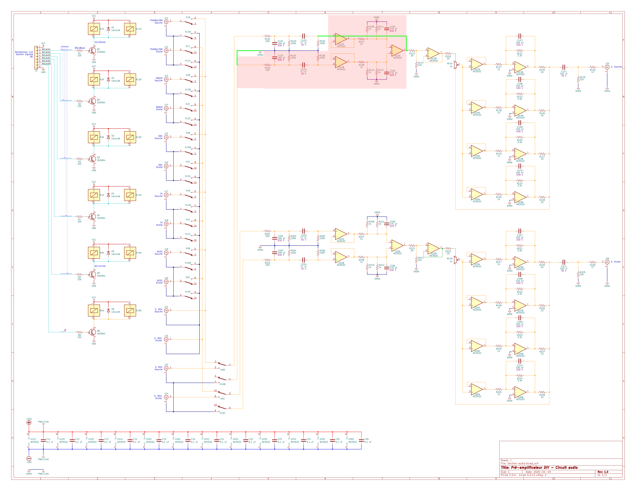

I am working on my DIY Preamplifier new project based on the Elektor Preamplifier 2012 (Douglas Self) schematic.
I don't need the TONE and BALANCE control sections in my design, painted in Red in the picture below. I will directly connect the output of IC2A pin 1 into the input of IC9B pin 5 (Green traces).
Still I have this question regarding the filters in the input of IC2A pin 2 and 3, painted in Yellow. Do I need them or they are part of the BALANCE section only?
And if needed, should I replicated the R11-R12-C6 filter with R8-R9-C5 connected to ground?
Thank in advance 🙂
C5,6 set the high frequency response and offer additional RFI ingress protection as part of the balanced to single ended converter. C1,2 op at a higher frequency. Was this not explained in the circuit description text in the article? I’d have to look at my archives to see for myself.

I read back the Elektor article. It seems that the R8-R9 are part of the BALANCE section and that the R11-R12 resistors are include only to preserve the CMRR of IC2A. I didn't read any mention of C5-C6. So if I get ride of the resistors R8-R9-R11-R12, I wonder if I still need the C5-C6 capacitors, that are in parallel of the R8-R9, also in parallel for 500 Ohms total.

Hum.. Well it is my first experience with OPAMP. Of course I read a couple of books on the subject but my attempt was to start with a very good design that has a good reputation and make it to my needs.
I wasn't sure if the balanced inputs was or not necessary to keep the original design to it's specifications. I admit you made a good point.

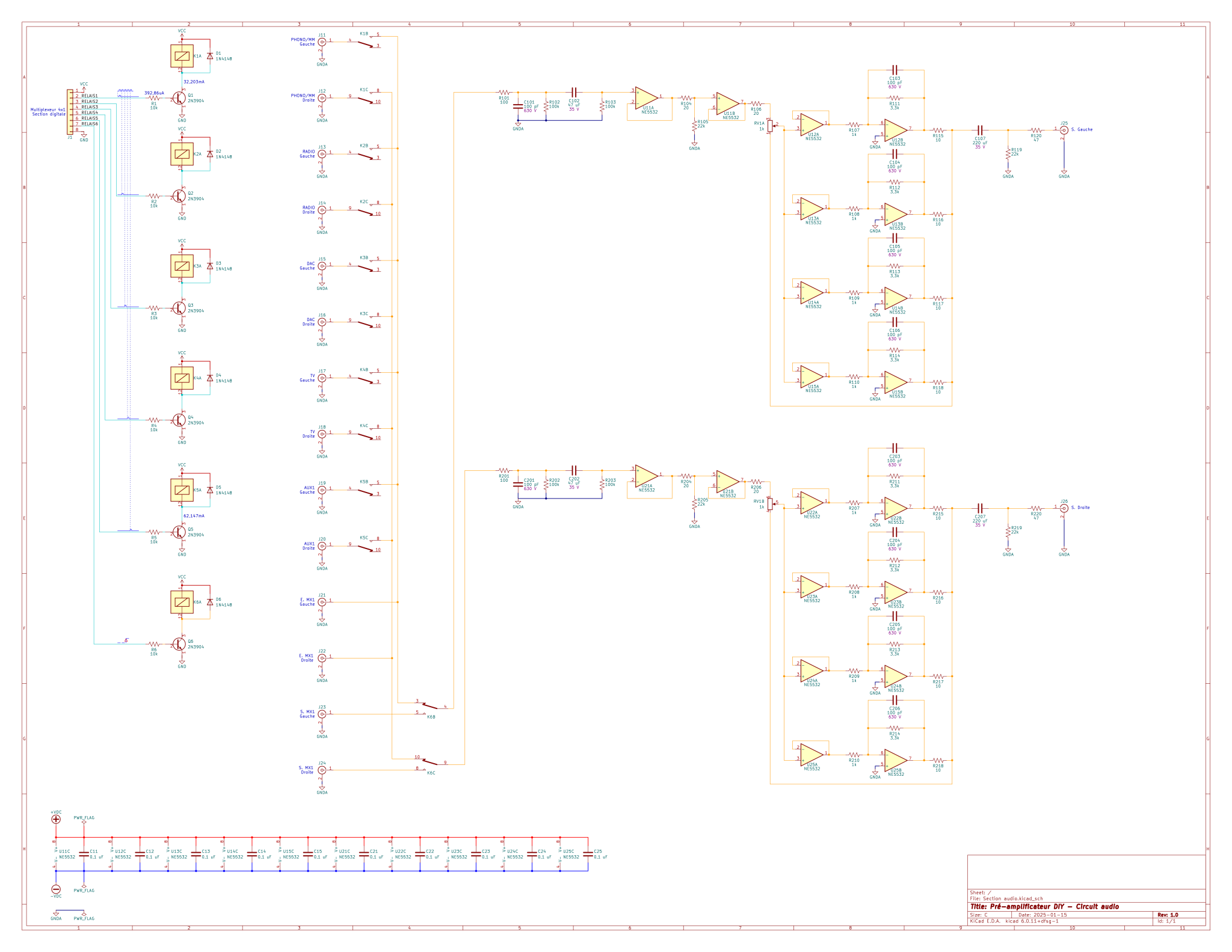

If you refer to my last post, I simply modified the left channel in the schematic as an example to discuss the modification before I modify the entire drawing.
Ah OK. Anyway, it will likely give plops when switched on/off and it will plop when switching sources. You see no problem and that is OK but disconnecting cables physically is usually done when stuff is powered off which is really something different.

And what about the schematic modifications above in post #11 to remove the balance section. Is it alright or do I miss something?
Without knowing the device that well K6 and K7 seem unbalanced L and R outputs.
K5 is called “Tone defeat” which normally is a bypass for tone control. This is done with relays in this device. You could omit tone control and the relays if you don’t need that.

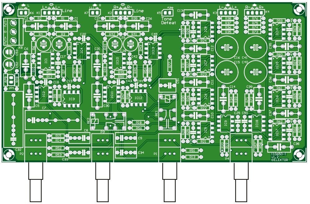

Hi, Jean Paul,
Thank you for your answer. I made this preamp and I'm using it. I don't know what k5, k6 and k7 are in the circuit, so I didn't make the connections. Because I don't know how to make a connection. There are two problems in the circuit, the first is that the balance adjustment does not work exactly. Secondly, there is a lot of noise when the sound is full low.

It are line outputs without volume control.
I can not support a device by Elektor/D.Self and solve the apparent imperfections (IMHO the device is unnecessary) but I can say you forgot to connect the PE pin of the IEC inlet with green/yellow wire to the chassis. This should be corrected.
If you connect a pin of K5 to + Vre and the other one to GND the relays will be activated and the tone control will be bypassed.
Should all be described better in the article really.
Reactions: fazildiken
