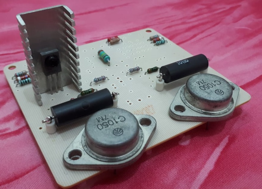

Hi metanastis and HerrFlick,
My progress so far and I have a question. How hot is the driver transistor? The PCB is quite small and I had to find suitable heatsink for that. Will the heatsink in the picture be sufficient? And if I put a rail capacitor in front of it (touching the heatsink) will it be a problem? Otherwise I need to find/make a heatsink that will extend off board to give room for the capacitor.
Hello JOHNEGO,
It all depends of the quiescent current you are using. I have a infrared temperature probe so I measured the temperature of my amplifier using a quiescent
current of 0,2 A and all four driver transistors are about 25 ºC. The heatsink is 12 ºC/W.
Hello JOHNEGO,
It all depends of the quiescent current you are using. I have a infrared temperature probe so I measured the temperature of my amplifier using a quiescent current of 0,2 A and all four driver transistors are about 25 ºC. The heatsink is 12 ºC/W.
Hello HerrFlick, thanks. 200mA is below the optimum stated by the document which is 350mA and metanastis uses 0.6-1A which he said is much better; so there will be big possibility that I will try that class A approach...
May be I will start with 200mA first and then learn from that. Or, I can use bigger heatsink but put it (with the transistor) hanging on the bottom site of the PCB
What kind of power mosfets do you use?
Many. Mostly K135/J50. But the ones on the picture are BIPOLARS. Just there for part placement planning. Latfets are sensitive to electrostatics so I used bipolars for this purpose.
BTW the Rout are too close to heatsink. I may lift its position to avoid heating (if this is an issue). Currently it's 0.15 Ohm but later I may reduce the value as I have down to 0.005 Ohm.

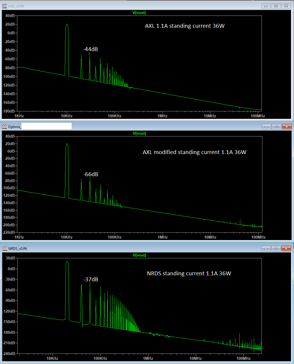

AXL Amp Review
AXL is an old amp, almost as old as Crescendo. But it took me time to try the AXL because many people said that it is comparable to the (mini) Crescendo. But now I know that it is to my taste better than the Crescendo, and especially when biased high, it is absolutely better.
AXL is better than I expected, but cannot compete with my other amps.
So I modified the AXL using all small signal transistor to copy the idea from NRDS amp by J.M Plantefeve who "modified" the Crescendo also using small signal transistors. The feedback return point is changed as used by common amps and there are many other modifications.
I attached the FFT of the AXL, my AXL mod and NRDS. I believe that most of the amplifiers sound quality can be seen from simulation. And from simulation, most of the quality can be seen from FFT.
The NRDS distortion is higher but it is in the style of the Hiraga super class-A that even though high distortion but many people like it and consider it as one of the best sounding amplifier. I have another amp that is better than the NRDS and have the same distortion spectrum but like the Hiraga, the bias is twice as high (and when I reduce the bias to 1.1A it is not as good as the NRDS).
My AXL mod doesn't look special in the FFT (even though it is better than the original) but it has something else that cannot be seen from the FFT.
Note: No simulation file will be posted.

Not that i like to criticise but i simulated extensively Elektor s Crescendo and most of its later iterations including the AXL and frankly that s quite poorly implemented designs.
The crescendo particularly, where they explain that they use some kind of shunt compensation by the virtue of the input capacitance of the lateral fets loading the "VAS", but it simply cant work due to the high standing current of the driving stage, hence an hasardous stability...
Also the AXL is an inverting amp and contrary to what is generaly thought this has an importance and require to invert the speakers terminals, that is, to connect the plus of the speakers to the the amp s ground.

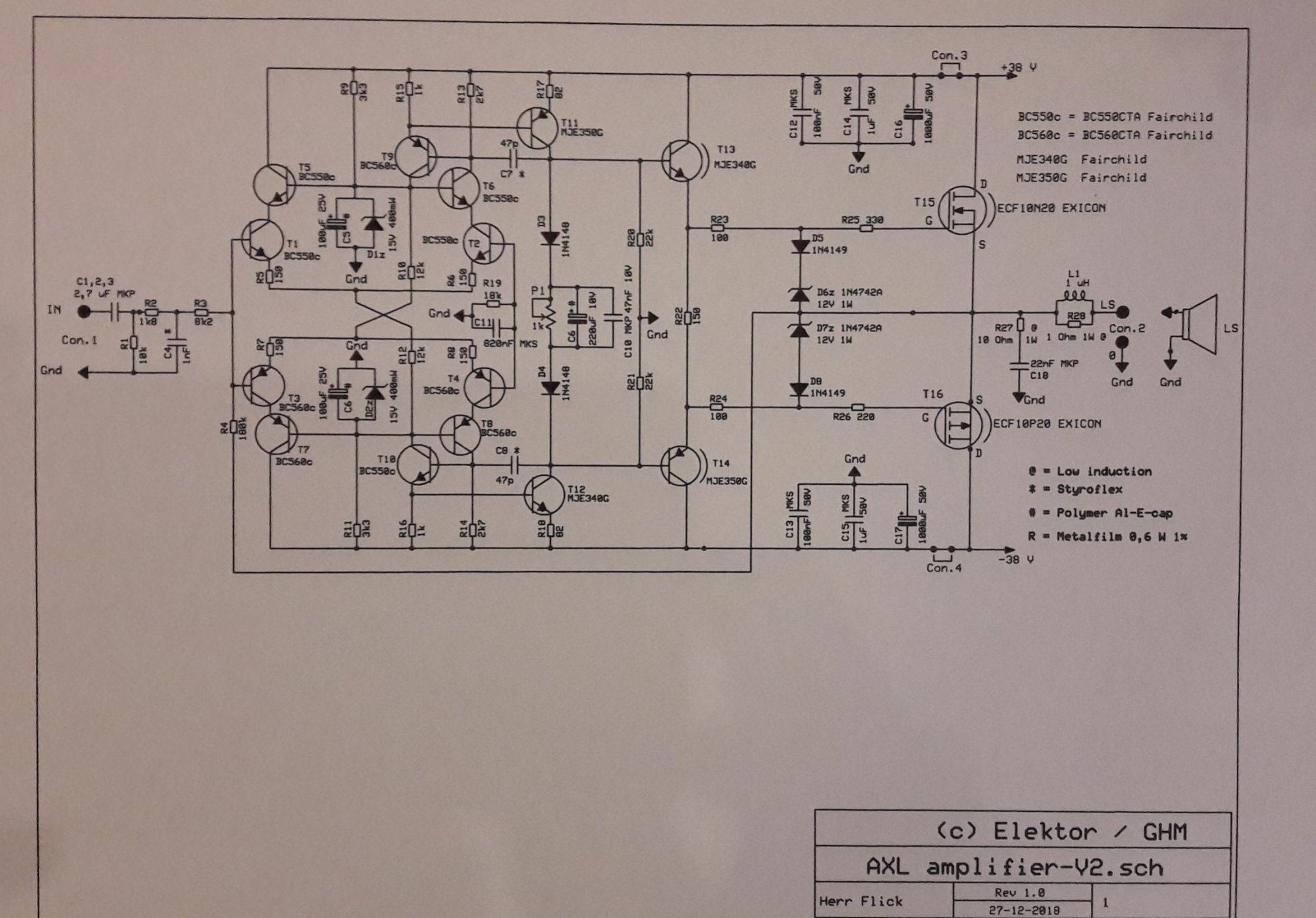

Hello,Not that i like to criticise but i simulated extensively Elektor s Crescendo and most of its later iterations including the AXL and frankly that s quite poorly implemented designs.
If you read the old Elektor article, there is no reference in any part of it that the output is inverted.
When I built that amp, I used an audio signal generator and the signal at the output was at the same phase as the input.
Have you tested that amp and have seen the inverted signal at the output?

Hello,
Here the schematic of the AXL, that s a phase inverting amp, the input signal is sent on the inverting input and the non inverting input is grounded AC and DC wise, to retain the real phase in respect of the audio signal the speakers connection should be inverted, guess that you confused it with the Mini Crescendo wich is not an inverting phase amp.
