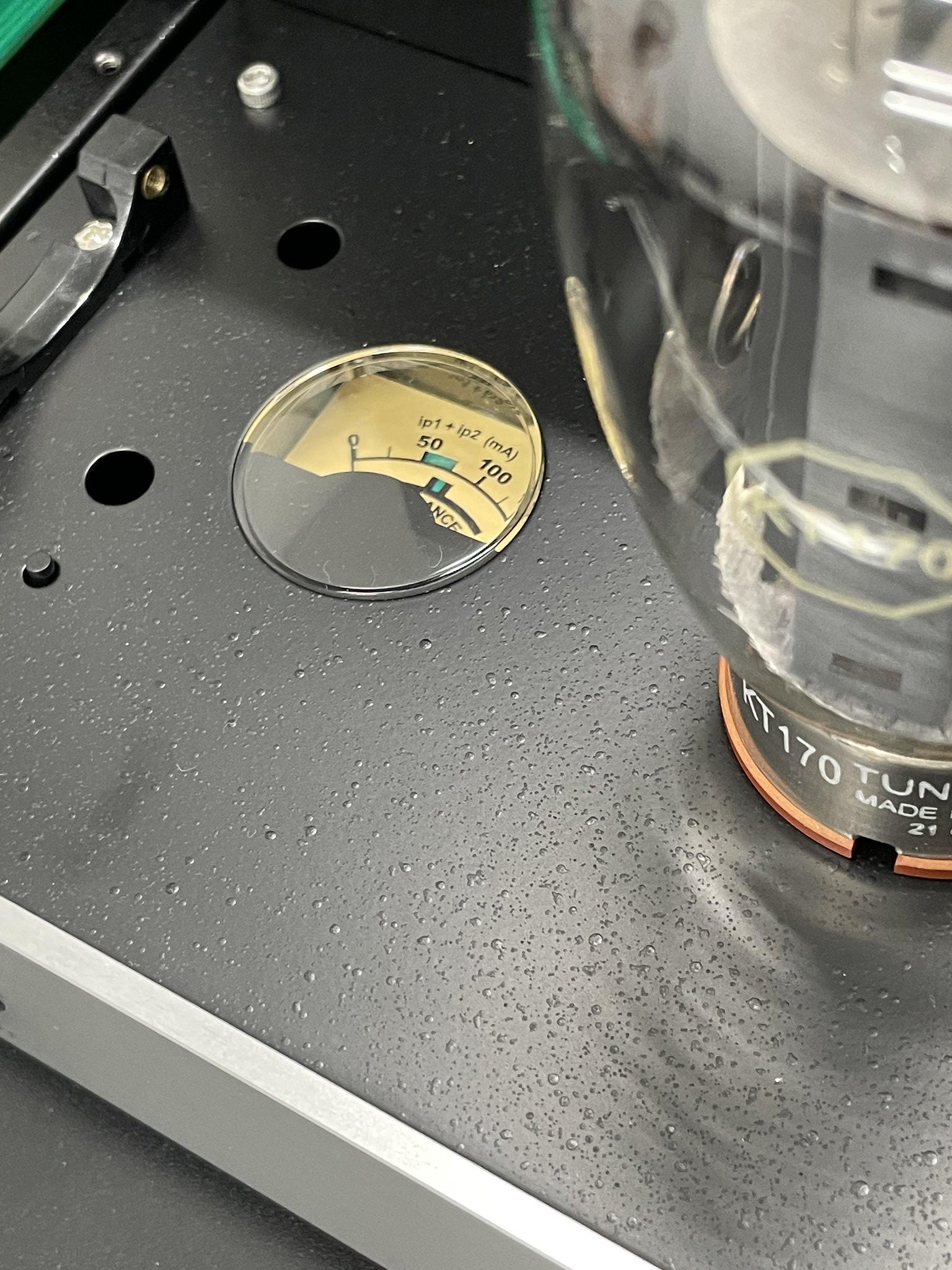

Regarding TU8888 output,
When you are using KT170, you can adjust the bias at the max within the green zone,
or maybe just a little over the green zone, then the output will be higher than 60W..
with KT-170 installed, we tested how the power changes depending on the position of the bias level.
When the bias is adjusted at the highest position of the green zone, the power is around 9-10% more
From Lundahl May 2025 News Letter
LL3733 - Elekit​

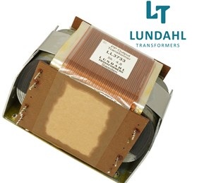

LL3733 is a push-pull tube amplifier output transformer with 50% ultra linear taps and a separate winding for 2% negative feedback. As usual from Lundahl, the transformer is built up from two coils, each consisting of 3 sections, one primary and two secondary sections. The secondary sections are tapped for 5- and 8-ohms load.
The transformer’s windings are arranged to minimize capacitive coupling between primaries and secondaries, and for extremely small phase error between anode and UL tap. This transformer is made with our renowned winding precision using the finest winding copper wire, and the high-quality grain-oriented silicon steel C-cores from our own production.

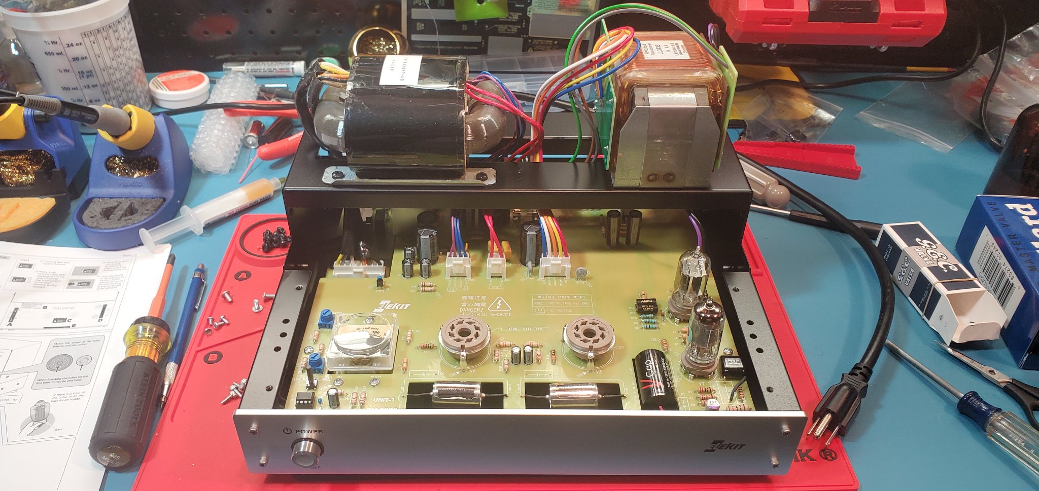

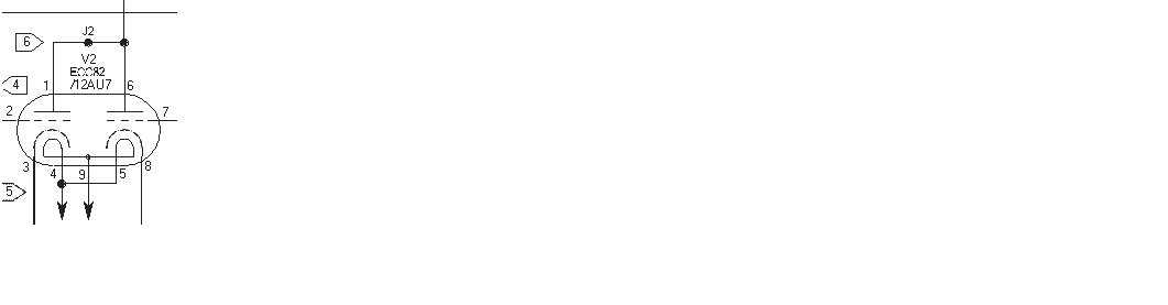

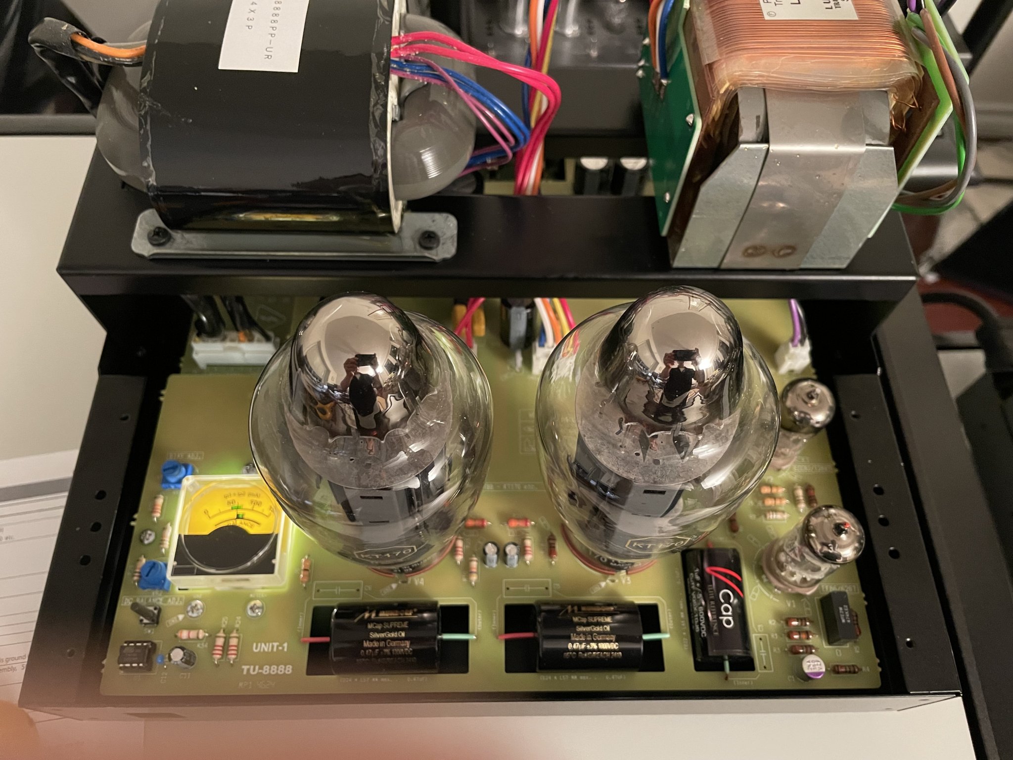

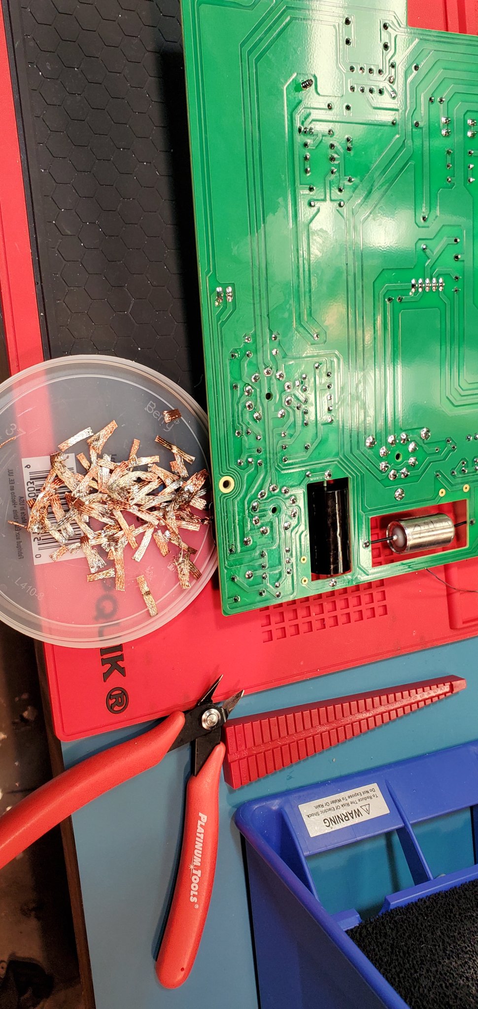

I've recently completed the build of two TU-8888 Monoblocks. The first unit I built is functioning fine. However, the second has a crackling sound coming from it. I disassembled it and went over all my solder joints and improved a few but under magnification I cannot find any other questionable solder points. When I went through all 27 voltage measuring points I have two values out of spec. Point 5: I have 88.5vdc when it should be 95vdc. The second is point 6: I have 175vdc and it should be 245vdc. Any help would be greatly appreciated to determine which components in the 12AU7 area of the board are faulty. Thanks so much!

I'm using quads of both the Mullard KT88 and Tung-Sol KT170. I swapped all four tubes, EF86, 12au7, KTxx one at a time so it's not a tube. I will disassemble and check all solder joints in this area.
I ordered some Zener diodes off Amazon, I think I was a little rough installing this one. I completely missed this step and had to put them in after the board was done.
I just realized I posted to the wrong thread. I completely removed the included zener diode, re-bent the leads and soldered it back in. Reflowed everything in the area and now I'm getting 97vdc and 245vdc. Upon testing I still have have a slight crackle but no where near as bad. I'm going to have to buy a desoldering tool and completely re-solder the entire area of the 12au7 and EF86 tubes.
