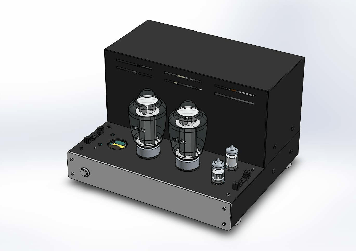

ELEKIT TU-8888 Monoblock (available now)
Another wonderful products from Mr Fujita...PCB type DIY KIT...
Here below are the spec of the monoblock amp.
Tube usable : KT series from 88 to 170 (for output tubes) KT170 recommended
EF86 x 1 and ECC82 x 1 (driver tubes)
Max. output : Over 50W/unit (with KT170)
Manual bias adjustment - A meter at the top panel
No headphone feature
SP impedance : 4ohm and 8ohm
Input x 1
Balance adjustment volume (with 41-point click) on the rear side
Coupling capacitors : 3pcs (100n 450V x 1, 470n 630V x 2)
Max size for the coupling cap :
100n 450V ... D22 x L44 mm
470n 630V ... D20xL57 mm
* as of now and could change the spec a bit.
Tubes are not included.
*The amp is designed to use custom made Lundahl LL3733"
PCB for OPT and harnesses are included in the kit.
