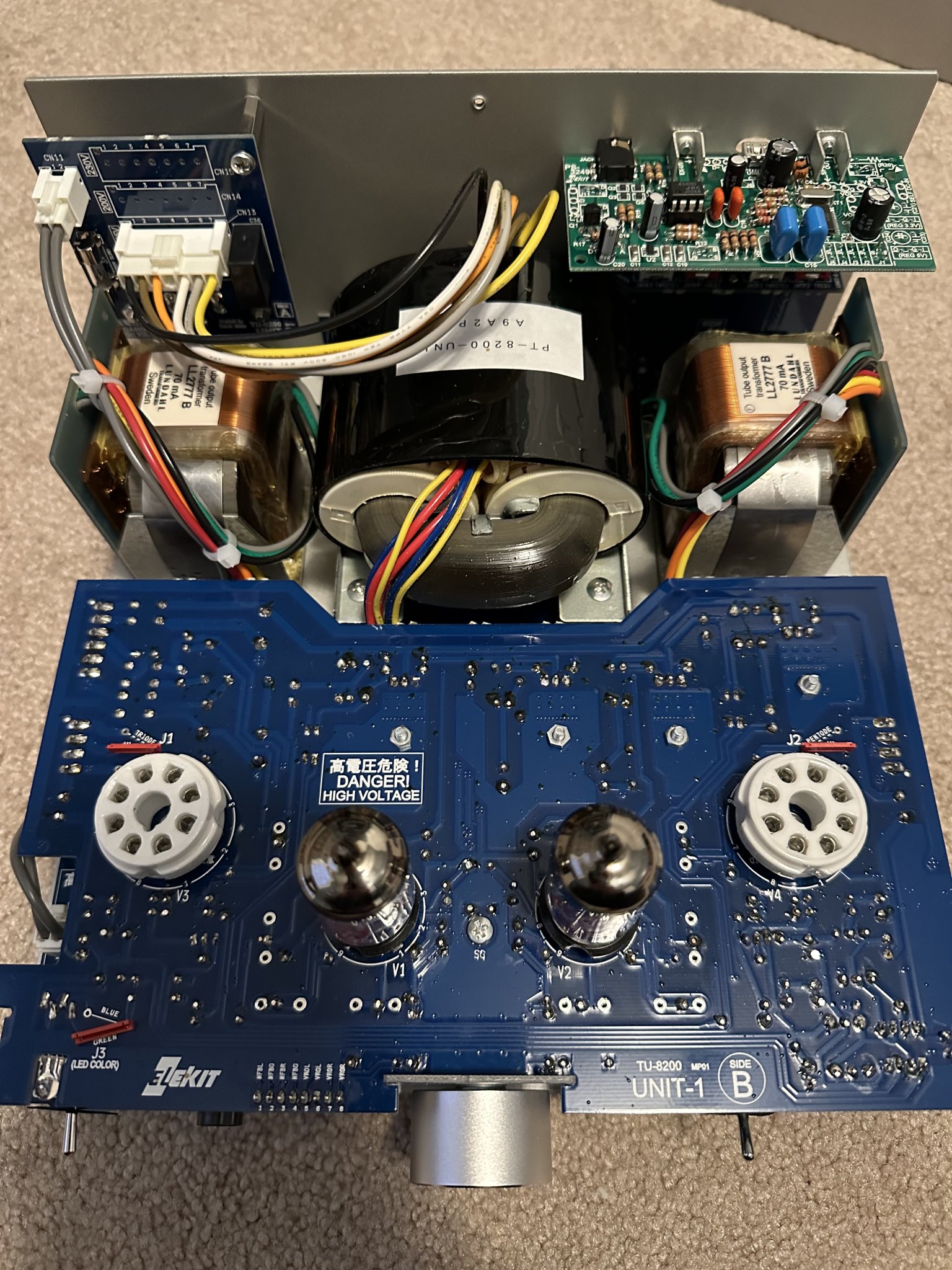

New member here , I got a used Elekit TU-8500R with the lundahl transformers upgrade. I’m blown away by the sound quality .I did A/B comparisons & It beats out my Primaluna prologue classic in sound quality . Recently, I purchased a new TU-8500 preamp. Is it worth it to upgrade the stock caps/components ? Does it really make a big difference in the sound quality ? I’m no audiophile but my goal is to put together the highest fidelity system for the cheapest price possible .

If I had the de luxe version of an amplifier and built the standard, lower cost version of the pre-amp, the nagging suspicion that I'd created a bottleneck would get to me sooner or later. So in your place I'd spend the money now rather than upgrade later on.
The U.K. retailer suggests a number of options here: https://www.hificollective.co.uk/index.php/kits/elekit-audio-kits/tu-8500.html which will give you an idea. (I assume the parts mentioned are available over there.) Personally, I have found some of the Russian NOS caps sold on eBay excellent, and far better vfm, but some 'experts' disagree. If you haven't already, search Elekit on here.

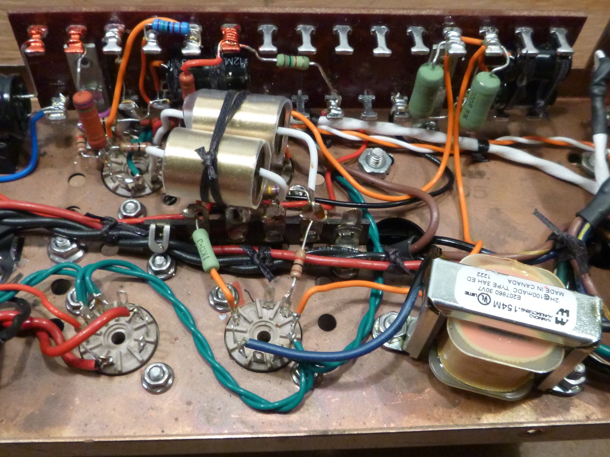

The typical coupling caps found in Elekits are a prime candidate for replacement. I can recommend the Mundorf supreme (the standard version, (not the fancy metals and oil variety) if they will physicality fit. A bit more budget-friendly option, though still a good cap, are the Obligato films. Again, if they will fit. I've used the Obligatos in Fisher and Leak rebuilds and they sounded very nice. The only negative thing I can say about the Obligatos is physical. Their metal bodies are covered with a thin plastic film. I add a layer of thick shrink wrap over them prior to installation. See attached photo of Obligatos in a Fisher rebuild.
Can't say my experience with NOS russian PIO caps was good. Too much of a vintage fuzzy and unfocused sound for my tastes. Replacing the ruskies with Obligatos made the sound more clean and detailed and at the same time smooth and non-fatiguing.

Since this setup is my daily driver, I ended up getting the upgrades victor recommends which costs about $95 extra w shipping/taxes . Hope it’s worth it !
Upgrades include;
4x Mundorf Mcap supreme 0.47 UF, 600V
2x Texas Instruments OPA2227P

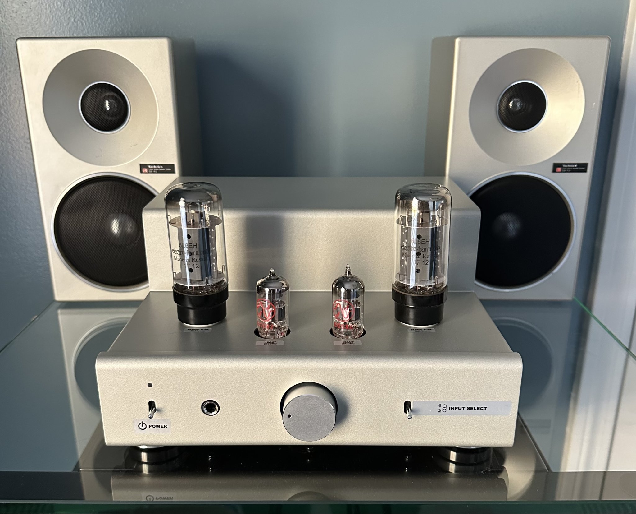

And Here’s the finished unit . Sounds really nice & I’m quite happy with it !! The only complaint I have is , when music is playing & I switch to another selection, there is a little bleed through of music on all the other source selections . No big deal, Just turn off the other source .

I Spent a good amount of time doing AB sound comparisons today, Swapping the CD player & turntable from the TU8500 preamp to direct feed the TU-8200R (with a Sutherland phono stage). The clarity & overall soundstage is much better when I bypassed the TU-8500 preamp . The 8500 adds more haze & graininess to the sound when using both the cd & turntable. I’ll stress that the TU8500 has not been burned in yet & only played for about 1 hour total. Will the sound clarity improve or did I make a mistake ?

Put at least 50 hours running, with signal running through from a CD on repeat or a web radio or music service streaming, before you come to any preliminary conclusions. After 100 hours you'll know where the sound character is headed. I wouldn't exactly call the Mundorf Supremes vintage in tone. Once broken in they are smooth yet detailed. If there is hardness in the sound after 100 hours it won't be down to the Supremes.
I've heard the TU-8500 with 5965 tubes (as recommended by Victor) and it sounded quite decent. Though they require a bit more filament current, the power trannie seemed up to it. Best of all they are dirt cheap, about 5 bucks each! https://www.tubesandmore.com/products/vacuum-tube-5965-dual-triode It makes sense to get a hand full as shipping will likely cost as much as just buying a pair.
I also tried an ancient pair of Telefunken 12AU7s smooth plates I had kicking around. in the TU-8500. More of a soft-ish vintage tone but all of the midrange glow that people go on about. Not exactly my cup of tea but I can understand the attraction. Even well-used ones cost too much though.
Let your JJ tubes and Mundorf caps burn in a bit before changing anything. I think you'll find the sound will develop quite nicely.

Thanks Steve , your 1st hand experience is exactly what I was hoping for ! I will run the 8500 non-stop this week with the power amp off. Hopefully the sound gets more detailed & not as muddy ! I’ve been running the lundahls on the Tu-8200 for about 20 hours, I noticed a huge improvement over the stock output transformers. Much more detail & dynamics . It sounds so good , that I think this is my forever amp !

Update ; after about 40-50 hours burn-in, I have noticed the Tu-8500 has dramatically improved. The clarity & dynamics is now where I think it should be & it compliments the 8200R power amp perfectly ! The built-in phono stage is ok but nothing to write home about. I recommend a separate phono stage. I also switched out the stock JJ tubes with NOS GE 5965 tubes as recommended by Steve.
