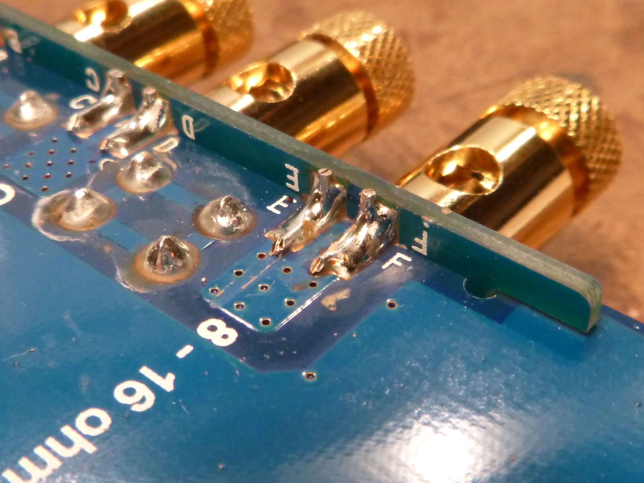

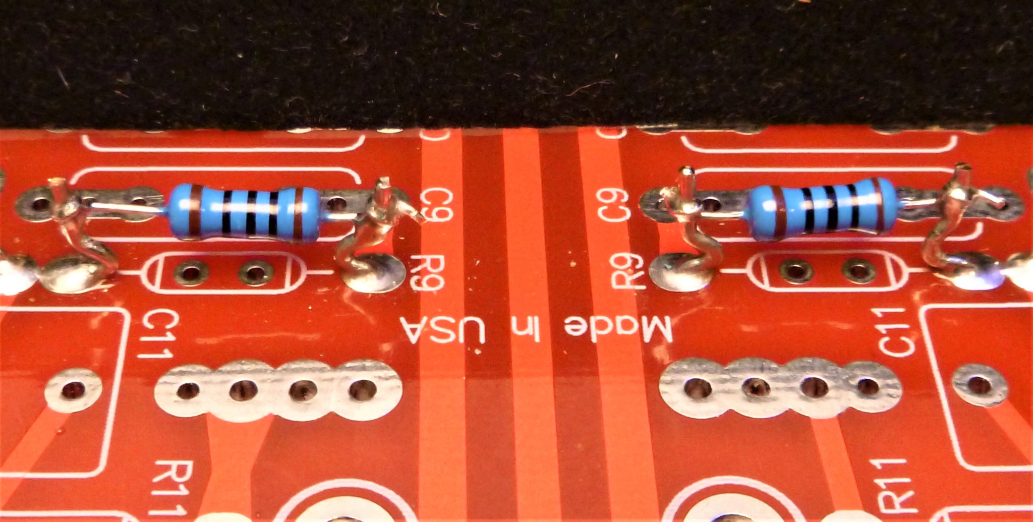

One thing I have done, specific to Elekits, is when boards are soldered 90 degrees to each other is to place short pieces across the connections before soldering. It is a bit tricky to do, help from another person is good, but eliminates a potential connection failure.

To join boards at 90 degrees use a small piece of a cut-off resistor lead bent at 90 degrees and solder it in place across the two boards at each connection point. See attached picture.

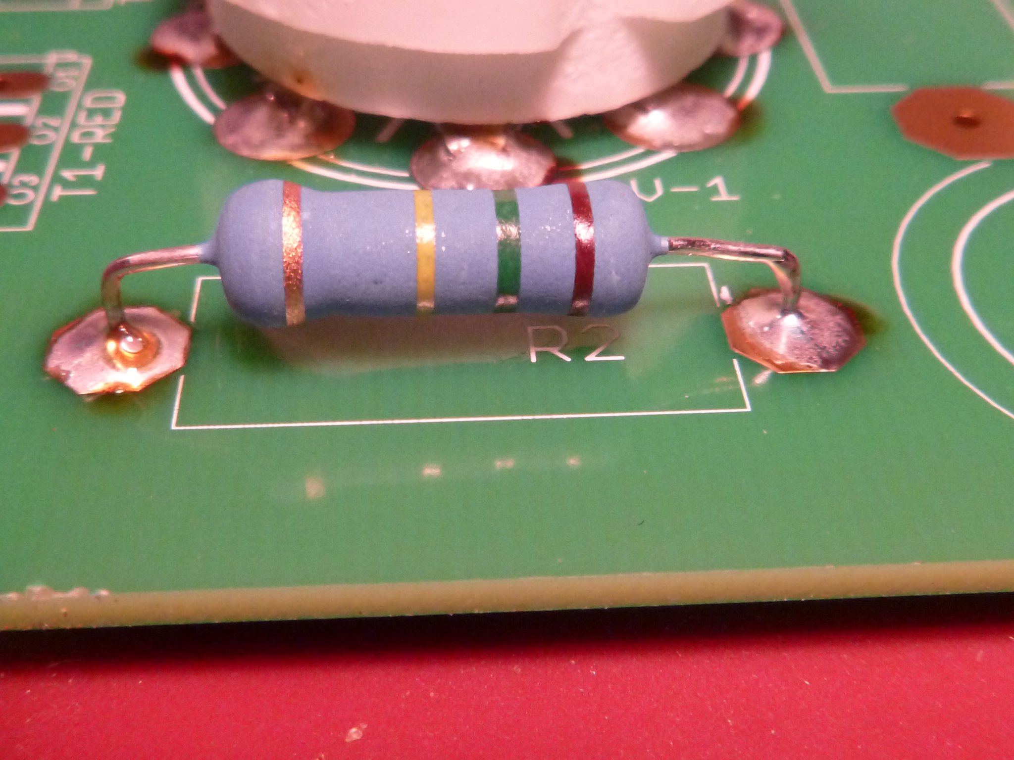

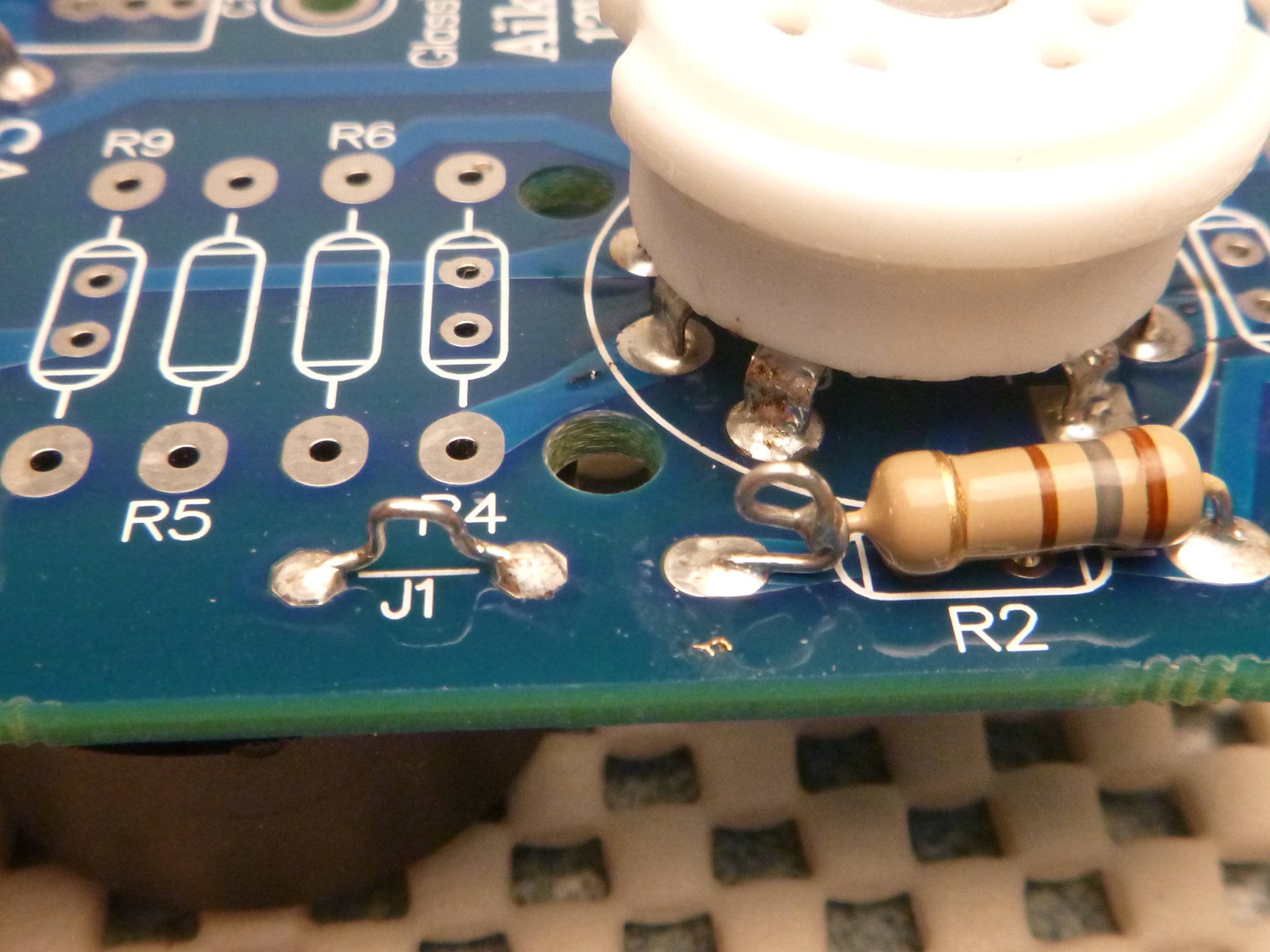

If it is possible I like to solder the tube sockets on both sides of the board. Some people only solder them on the bottom. If there is a pad on the top side of the board I like to solder there too for extra mechanical strength. See attached picture.

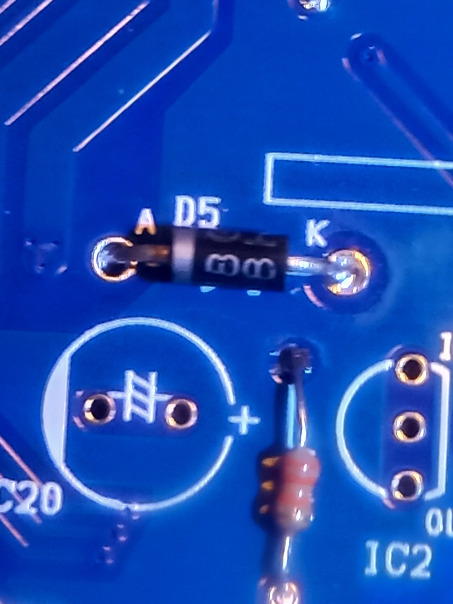

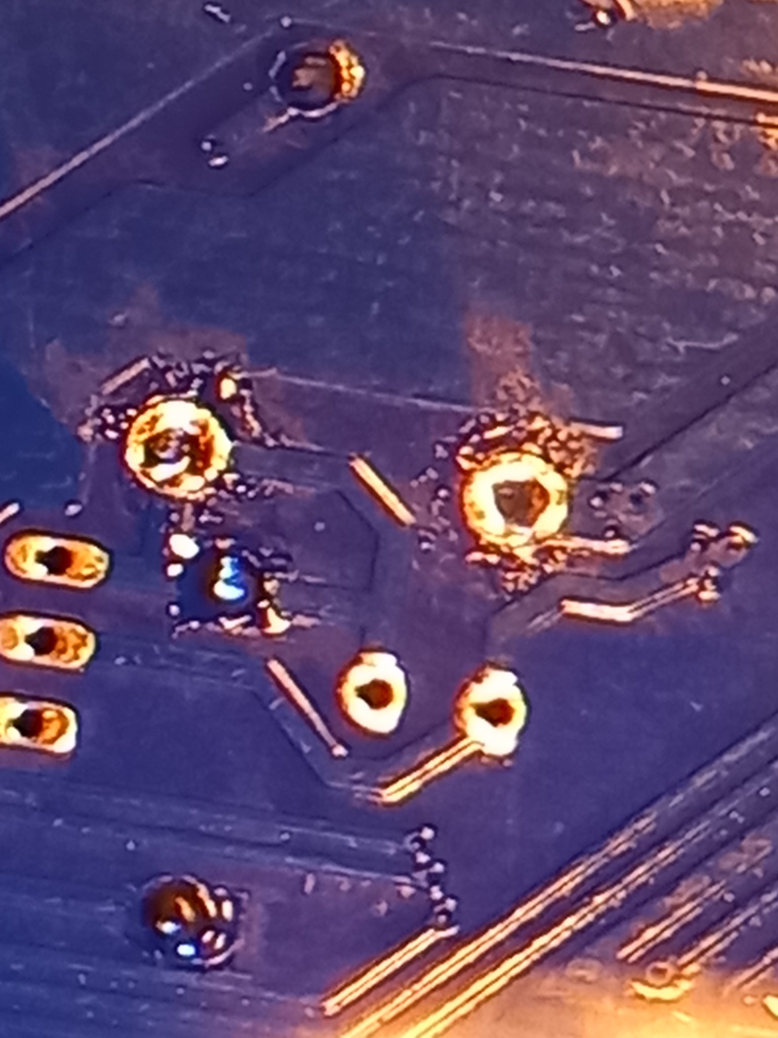

Hello there. I need some help. I got the elekit tu-8100 kit and started soldering the first pcb.
I made the first mistake, I soldered a diode upside down, with the anode lead into the katode hole. It's the diode D5.
I tried to suck the solder with a desoldering pump and most of it came away but I can't manage to get the diode out with the longnose pliers. I'm afraid of damaging the pad. What should I do? I also have some desoldering wire.
If I manage to get it out without damaging the pad, do you have any suggestion on how to keep it in place to solder it the right way?

To remove the diode, add solder, not remove it. When there is plenty of solder on the joint the heat will conduct to the other side and it is easy to pull the diode away. Then suck the solder to clean the hole.
Reactions: newbie802

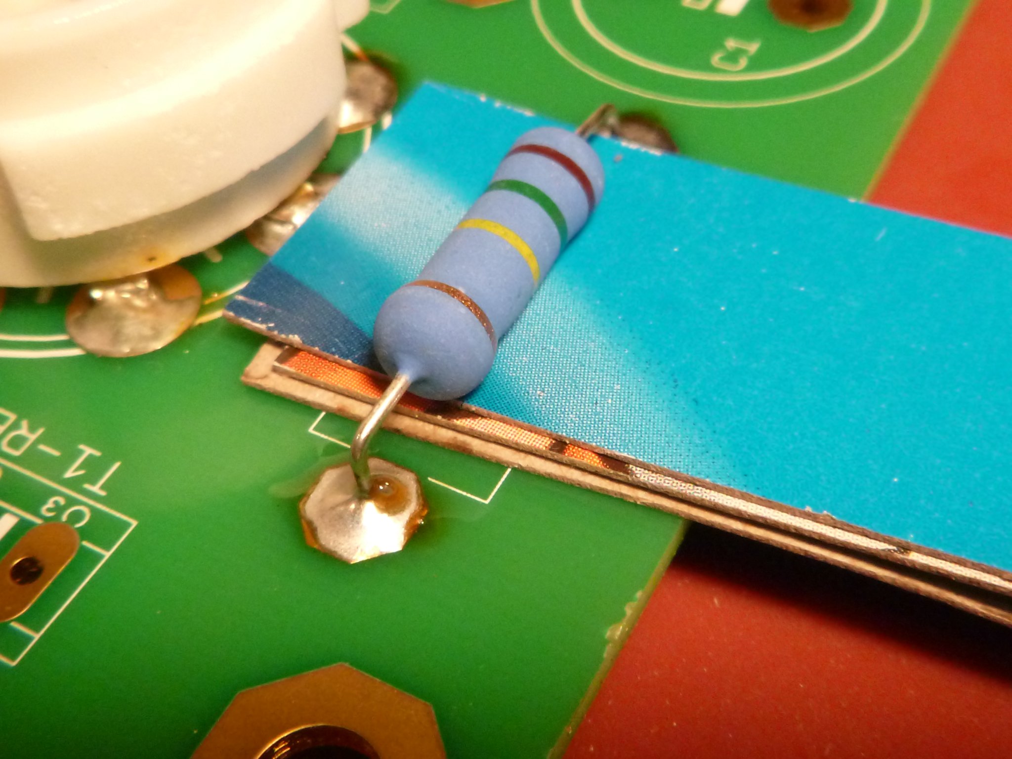

Cut the diode leads as close to the board as you can. Heat the board with your iron and remove the remainders of the leads individually. Solder short pieces of cut off resistor leads into the holes for the diode. Attach the diode to the leads as shown in the attached photo.
In future you may wish to space components a little bit off of the board. See attached pictures using 3 pieces of thin cardboard. Easy to remove even after soldering. Simply remove the middle piece of cardboard first. It helps with heat dissipation (and potential rework) spacing components off of the board.
S.
