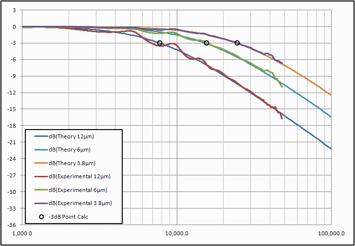

Your observation about HF roll off seem to be correct.
Below are two diagrams, with and without membrane, zoomed in and smoothed to 1/3.
I recently performed a similar test to compare HF roll off for different diaphragm thicknesses.
Attachement shows experimental results match very well with theoretical roll off calculated based on radiation resistance(2*rho0*c) and diaphragm mass.
The -3dB point for Mylar diaphragms can be estimated by:
F(-3dB) = 93,400/t
where t = diaphragm thickness in µm.
bolserst, I saved your graph for reference 😉 Do you know if the material of the diaphragm (soft, rigid) does matter? Same question for the dust covers. Also, how do you take into account the diaphragm and dust covers with different thickness together, that is three vibrating surfaces acoustically in series? Could they be modeled as one diaphragm having the combined thickness, i.e. sum of the three?
I'm not sure I understand your question. Do you mean high or low diaphragm tension? If so, then no, the tension does not affect the HF response and roll off. I guess you also migh be talking about the material strength of the diaphragm. The only property that determines the HF roll off is the mass. However, stronger/stiffer materials will have more pronounced higher order diaphragm resonance modes which could show up in the midrange if not properly damped.
If multiple diaphragms are driven together, as in a 3-stator 2-diaphragm arrangement like the woofer panels on the ML CLX, then combining the thicknesses for calculation of HF roll if will give you a good approximation. If only one of the diaphragms is driven, then things get more complicated as the air volume between the diaphragm and a dust cover acts like a compliance. Depending on the relative masses of the diaphragm/dust cover and the air volume compliance you can get different behaviors ranging from smooth roll off to resonance peaks of +3dB or more.
F(-3dB) = 93,400/t
Hi bolserst. Interesting measurements. I've currently made a 12 micron ESL and used the ESL_UI software (which you know well) to calculate segmentation resistors for a flat frequency response. Judging from your measurements, I need to equalize the high frequencies up to almost 9 dB with my diafragm thickness. Am I right? If so, I'd rather use different resistors to compensate for the diafragm roll off.
This however, is not the case for microphones, where response mostly depends on tension, esp. in true pressure transducers.
