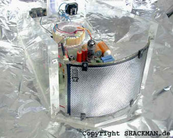

I can't bring it into coincidence with the Shackman ESL that used *two* Mylars *plus* some tissue in between as a membrane and – at least in my memory – hadn't any problems reproducing the top end (wow - what a sound in this department !)
Actually SPL limitation in the lower region was the main problem together with its notorious discharge every now and then burning a little hole into the foil each time happening.
Stator spacing was veeeeery narrow though - basically no more than using a vertical thread each 1cm 0.2" or so to keep distance over the cylindrically curved speaker.
http://shackman-electrostatic-loudspeakers.reromanus.net/

If you are asking about the Shackman – well – this was a really crazy unit one would not think it could work at all.
The membrane between the stators was made as a sandwich of two – non conductive ! - Mylars plus some tissue in between.
Now- the tissue they put in salt water and let it dry. Then stuck it - with a small piece of chopper (to make a terminal for the polarisation voltage) - between the two Mylars.
Bottom line: the little salt left in the tissue after drying, together with the humidity of air formed an close to ideal high resistance (constant Q) membrane.
The weird thing though was that the sandwich was held together *only* by the tension of the Mylars – no glue!
Meaning one would assume that at forward motion the back Mylar would not be moved – but in praxis it worked
As said – the top range was excellent.
Good thing was – very few at that time knew about the inner construction details – otherwise I guess, not a single unit would have been sold...
Michael
