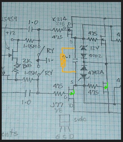

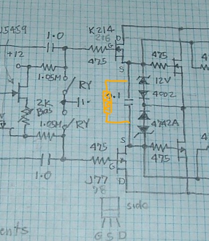

Nice. Long time since I saw anything about Lazarus. It was very good but never hit a bigger market. Case work was too bad.
It have some distinctive trademarks from Allen Wright like cascoded 6922 and CCS loads in the power supply.
No doubt an Allen Wright design...
Since it is an reverse engineered schematic it's easy to miss something and I'm quite sure there should be a resistor between sources of
the driver mosfets. Around 75 ohm would give approx. give a 20mA current through the driver, which will be sufficient to drive the output mosfets.
The P mosfets is not correctly drawn. See green correction.

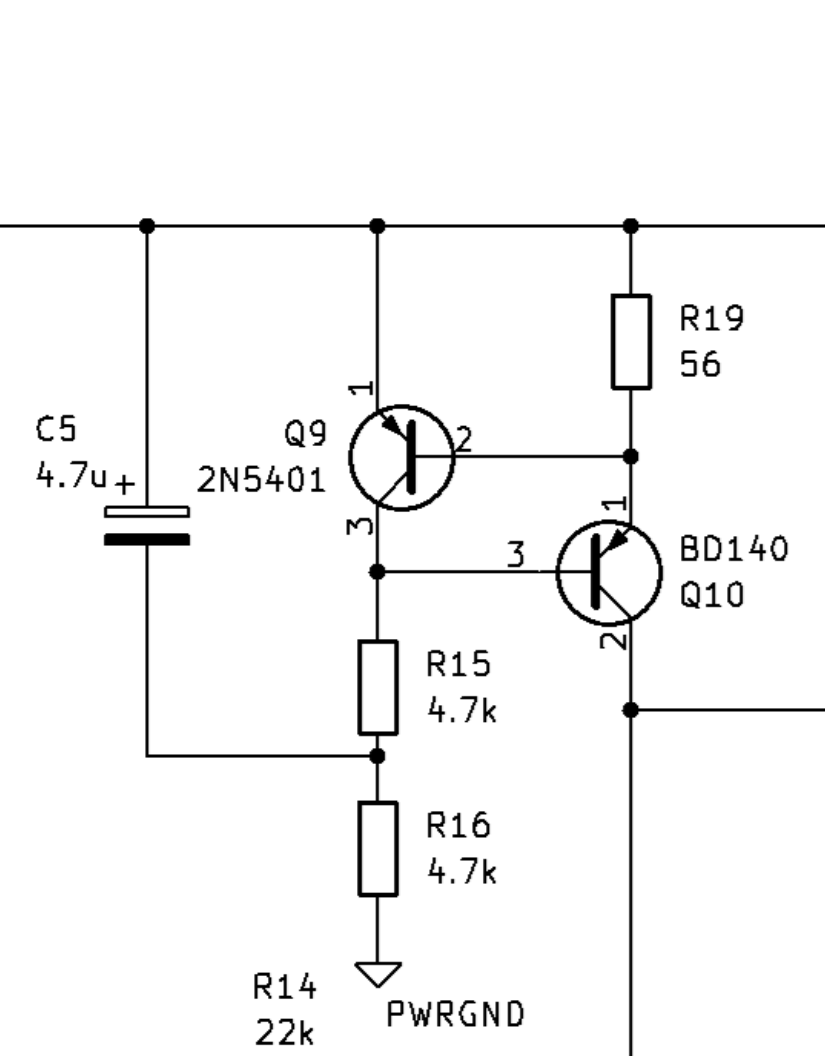

Yes. It’s just a constant current source. There are multiple ways of doing that with tubes, FETs and bipolar transistors. Two BJTs and a couple of resistors will do the trick for less than $1 in component cost. I don’t know much about tubes, but I fail to see what a tube would do for sound in that position.Also out of curiosity, could this Valve CCS part be replaced with something like an FET configured similar to valve such as the lampizator FET-ishitzor design? Just a thought...
Here’s what I’m using in the build that’s on my bench right now. The current is roughly 0.7/R19, which ends up being about 12mA in my case. The capacitor is optional and is there to stabilize the current. You may need different transistors based on what voltage you’re operating at.

Flez, thanks for the corrections - I thought I had accounted for all the on-board components. P's / N's - all the same to me!!!???
Yes Jacques, a 741 - used as a servo...
Some of the stuff on the drawing was the difference between the 1 and the A. I had both and converted the 1 to an A with the addition of my FET current source.

agree for the amplifier posted in OP
use a normal current source. no tube needed, DC so dont hear it.
Being a cheesy cheapo amp is what makes it " warm" aka junk distortion
adjusting bias as shown, would seem to make it jump like hell.
Needs source resistors in output section. Bias could be measured more effectively like normal amps.
Not the wild guess method.
with 86 volts could make relatively high power, use better /larger package mosfet.

Note that the CCS that njswede posted can oscillate, especially if the two transistors are the same part. Recommended is a cap across Q9 or a base resistor.
Doesn’t C5 help with that? That’s the way I’ve seen it drawn in most of the literature, including Self’s book.Note that the CCS that njswede posted can oscillate, especially if the two transistors are the same part. Recommended is a cap across Q9 or a base resistor.
