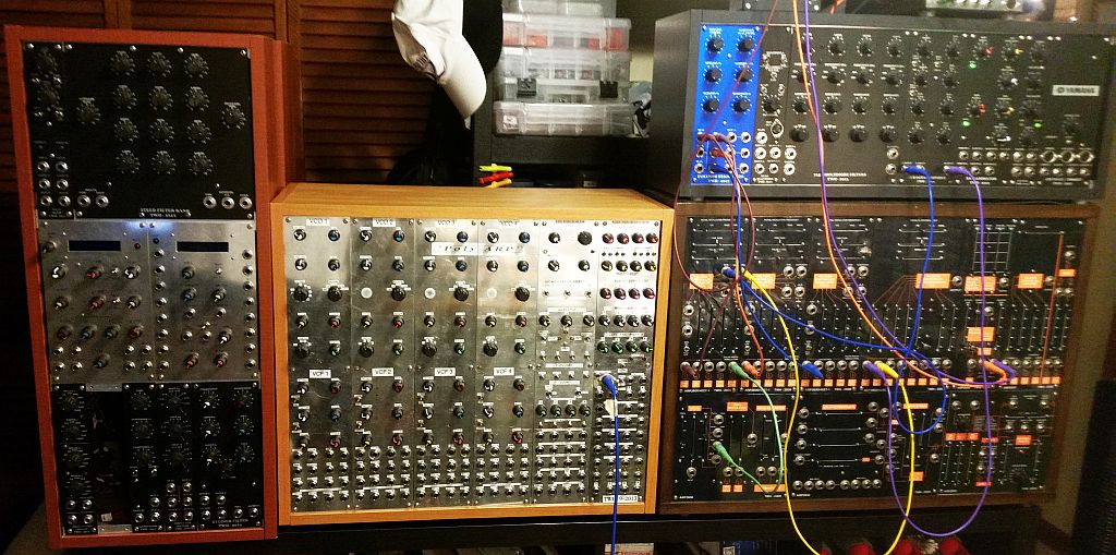

There is a forum dedicated to people who like to DIY music synths. Plenty of good material here, but finding it takes some digging until you figure out who the real builder / designers are. A coworker has been building synths there for as long as I have been here. His music room is awesome. He did a DIY version of the 2600, and even made his own "Poly ARP" before the TTSH V1 existed. See picture. Making the front panel with the slide pots is the hardest part......all my knobs are round!
There is a schematic vault there somewhere, but I haven't looked for it in some time.
electro-music.com :: View Forum - DIY Hardware and Software
