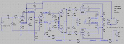

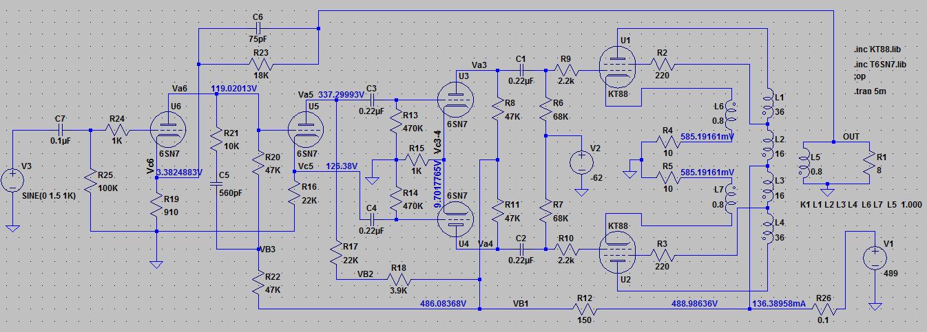

Thanks for all the replies. I've been using LTSpice up to the driver stage to simulate a Williamson design! I didn't realise you could create a transformer like that.
I'll persevere.
The small secret is you don't need to create output transformer model (at least in this particular case) 🙂
Put necessary number of inductors (L1, L2, ... Ln) with inductance value in Henry, and link them with coupling factor (K1 L1 L2 ...Ln 1.0). Coupling factor 1.0 corresponds to ideal transformer with zero leakage inductance. Even with that model, results of simulation are surprisingly close to reality.
Then, if necessary, adjust coupling factor according to measured leakage inductance:
Coupling factor K = SQRT(Ls/Ls + 1)
Of course, inductance is not constant, and there are other parasitic parameters like stray capacitance, yet they are vary from one model/manufacturer to another, and with ideal model you can check problems with tube/transistor circuit alone.

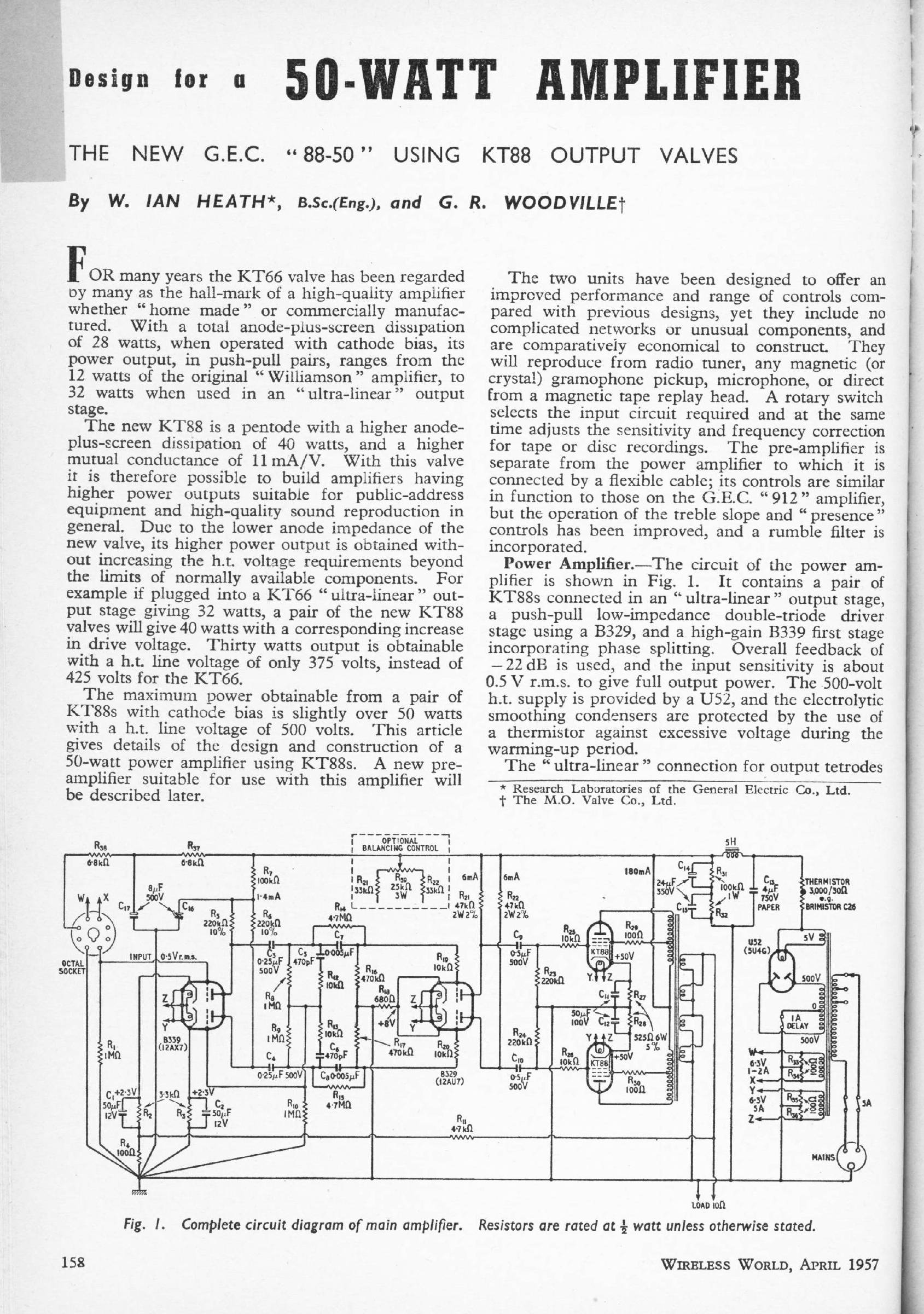

I modelled Williamson upon suggestion from articles
"Improving Williamson Amplifier", Talbot Wright
"Modernize your Williamson", David Hafler
IMHO, even after tweaking, Williamson is not the best PP circuit around.
My favourite PP schematic is GEC 88-50 amplifier.
Its reasonable simple, very stable, and I've got 60W from it with very low distortions.
I have nothing against Mullard 520 derivatives, like Marantz 8, Citation II, Sansui AU111, and countless number of others.
in fact, it was first PP amp I've built.
However, I spent a lot of time fighting oscillation and instability, so I may have some prejudice against Mullards.
