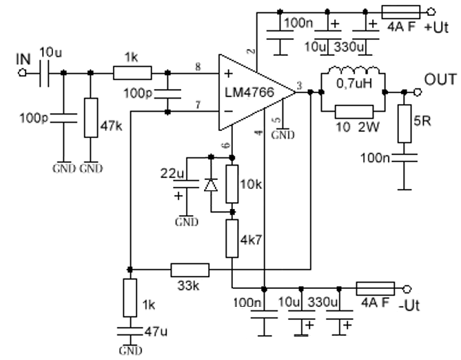

If the schematic here is right then the one for the amp section below should be too, and a little easier to follow...
you might like to build a lm4766 from scratch with a $7 pcb from China you seem to have all the parts?

I've got two of these amps already. I'm not sure what I'd do with another one.
