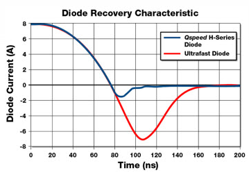

To be honest I was playing devils advocate regarding the Qspeed diodes (was curious to hear your opinion).
I didn't know it is the Q-speed that you are using. I thought it is a super/hyper fast type that I have used before. The Q-speed is indeed very different than MUR680. And it's only 6A, which is a good sign, and the low Q is a schottky resemblance, which is the best compromised diodes IMO.

Read about Qspeed diodes here - LINK

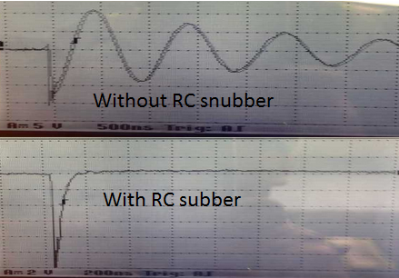

Here is why ultra fast diodes that I have used are always sound terrible. Also why many people prefer Schottky diodes (and I guess tube rectifier too) which has very low Q.
This is also I believe why I have never preferred a power supply RC subber circuit.
What is a "RC subber circuit"? No experience I have.
Search for quasimodo thread. In quasimodo, an RC at secondary winding transformer is used to flatten the ringing due to transformer inductance leakage.

Ah. A "simple" R-C-snubber. Sorry, I have not realized "subber".
