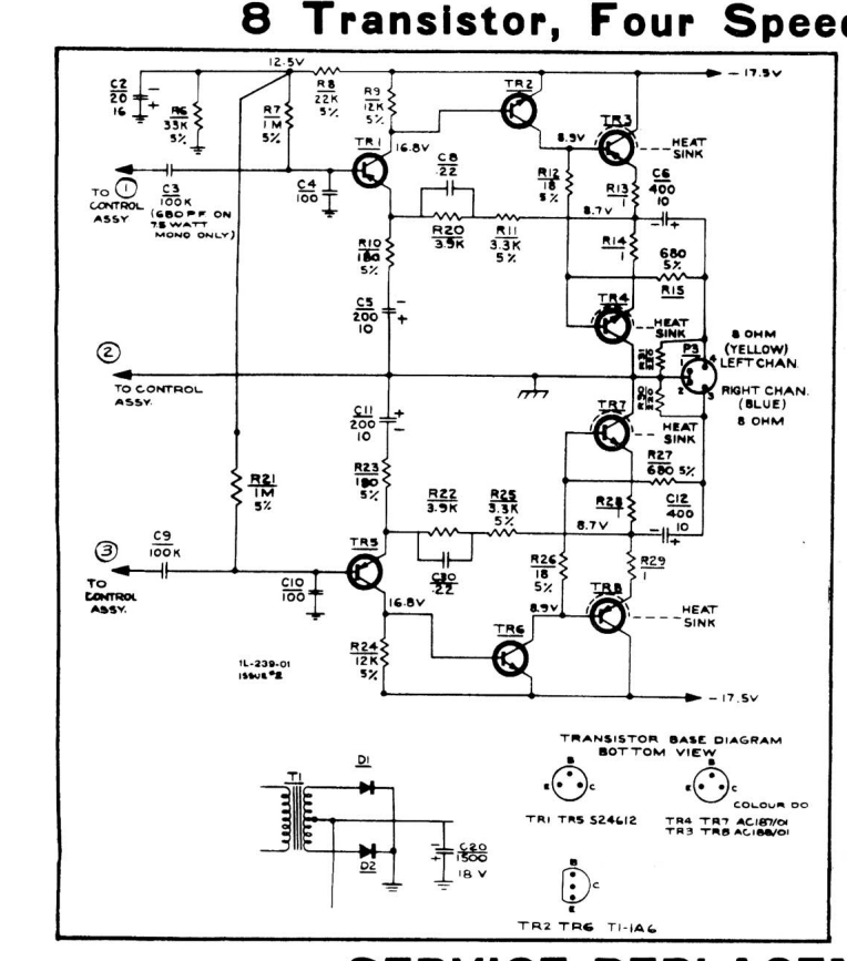

It looks doable - first I'd measure all the voltages and currents you can on the good channel and record them (current for each resistor by measuring the voltage across it).

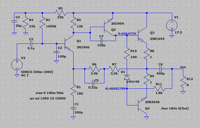

Then various things need changing as Vbe drops will be 0.65V rather than 0.25V, trying to keep the currents about the same. In particular R9/R24 will need to increase, as will R12/R26
However before you start I'd recommend checking connections for corrosion/looseness and electrolytic caps for age-related failure.

Every single resistor should be checked (if it reads higher than spec in circuit, you bet it has drifted), and electrolytics are likely to be shot.
I think the second stage is silicon already, going by the ~0.7 V drop indicated.
You are not likely to get away with simple resistor bias for the output stage once going with silicon - will probably need changing to diode bias. Compensation may have to be redone as well. Given how basic the circuit is, it may never sound quite the same.

I had to do something like that to a Telefunken. I used MPS-U06/56 pair and replaced R12/26 with a 150R/2x1n4148 in series, R15/27 with a 1k5R. It was also necessary to add a Zobel to each output (10R in series with a 0.22 uF) and I added 0.22uF across the power supply cap (C20). You may need to tweak the values and should do both channels. E

It is an extremely "crude" circuit; typical of the period. It is very short on current gain.

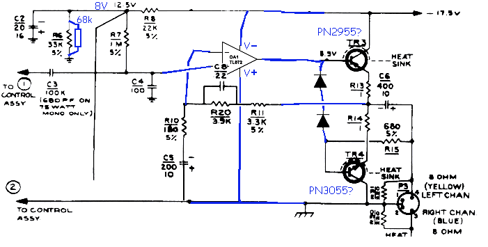

_I_ would consider changing to an opamp and a couple 80+Watt Silicons as you suggest. A bit cleaner (not that it matters). A lot more robust against shorts.
An issue is keeping your polarity-head on straight in this positive ground (negative hot) circuit. I think I got this right.
Remove TR1 TR2 R12. Shunt R6 as shown. Jumper in1N4148 diodes (polarity!) near heatsink. Jumper in TL072/TL071s. Shunt R6 as shown to best-center. Idle current is uncertain but probably fine for what it is (not hot, not too raspy). It *may* be down from an optimistic 3 Watts to a solid 2 Watts.
Not a bad idea, though the wimpy TL07x seems like a less than ideal choice - would suggest NJM4580 (perhaps RC4580), NE5532 or NJM4556 instead. (Perhaps a type that can swing closer to the rails, too, like OPA(2)132/4.) I think a '4580 with both halves combined via ca. 47 ohms each should have enough grunt. Transistor wise, I'd think something medium power like BD139/140 or MJE340/350 or maybe TIP31/32 should be quite adequate - I mean, we're only talking a 17.5 V single supply and 8 ohm speakers, so that's like what, about 1 A max? Even the original AC187/188 were only rated 1 A, and all of the above are between 1.5 A and 4 A. Going medium power has the advantage of being able to use all-plastic packages that do not require explicit insulation from the heatsink via mica washers or similar.
As mentioned by others, the diodes may appreciate some extra series resistance for some decent bias current (I'd want to have 20-30 mA if the heatsink supports it); I would also add some parallel capacitance to the whole shebang. With some more elaborate biasing, there actually is no real reason to stick with the 1 ohm emitter resistors, and going down to 0.47 ohms may be advisable.
The circuit may appreciate some extra supply bypassing, and having 10-33 pF to go between each opamp output and inverting input may also be beneficial to stability.
