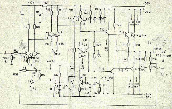

john,
can you comment the schematics? is there anything different? special?
thanks
http://home.online.no/~tsandstr/schematics_of_the_real_ec_25w_am.htm
thanks

It uses degenerated bipolar differential (while JC likes Jfet there).
I wonder how can this achieve large OL bandwith. The differential is 2 stages in series, the VAS is current mirrored. Usually, this design result in high OL gain with low OL bandwith

The 25 watt design by Matti Otala is a major milestone in audio history, his work was a great influence to others, like Jean Hiraga and Akihiko Kaneda.
I think it is the only amplifier design that can be built with Philips components only, does over 100V/uS with a bandwidth of 1 MHz on 2 MHz output transistors .
