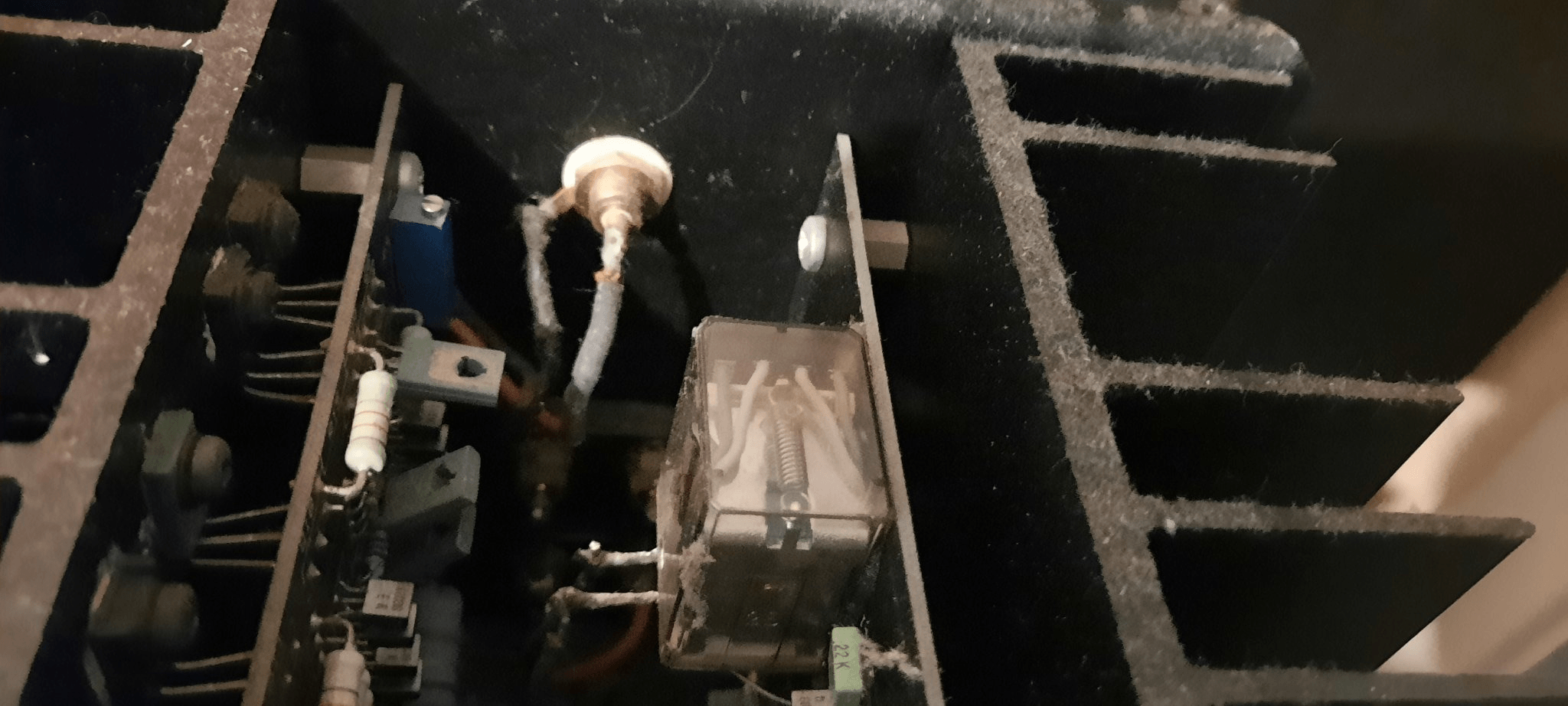

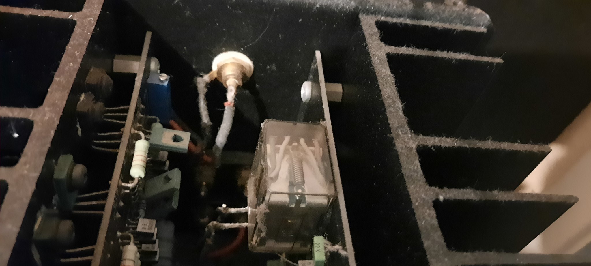

Here's what my Relay looks like in my AW-250. There are different versions so here is what I have.
You can barely see some sort of adhesive attaching the side of the relay to the PCB and the leads connected to the wire that go to the speaker connector.

@huggygood Yes, mine is different from the ones you see on the net. The one's on the net are AW250-R and relays are soldered to the PCB. This may have been a late revision change that lead to the R model. Hopefully the replays haven't been modified. The LEFT channel is fine, it's the RIGHT channel that is measuring bad. Resistance is all over the place, while the LEFT is measuring OPEN when the amp is off and CLOSED when the amp is on. RIGHT Never changes when amp is on or off.
If I can get this issue fixed and working fine I will have a very nice amp! 😉
Nah, that's just the dust. I went back and double checked it and cleaned it, it's fine do discoloration. I remember when I first looked at this amp with better eyes for stuff like that just in case it was something else that cause the relay to go bad. But I remember a Carver "The Receiver" 130 MX I had fixed had a bad channel and would come in and out. It was the same thing, a bad relay. Just replaced the relay and all was good. You would think relays would handle this type of circuits. If I'm correct with my memory, the side that is stuck to the PCB is the side with the P/N and other info which sucks if I can't read it for replacement or upgrade to a better relay. Electrocompaniet will not help either, before they were sold they would help but not anymore.

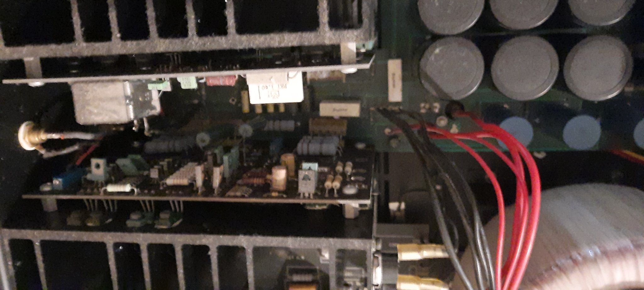

Well, today I got into this and found out there is more to this amp than just the relay. Looks like the right channel has been mess with around this relay. I will remove that pcb with the relay and get to the bottom PCB that its plugged into and see what going on. I always thought it was just the relay but there is more. I really hate working on something that someone else has hacked up but at least I have a good working channel and schematic to help me out.
I tried removing the Clear plastic cover on the relay but it will not come off so I will have to be very careful and cut away that adhesive that is holding it on the PCB. I did get to see a green label inside the relay cover saying 60V DC. The good channel has the same thing. Good thing the pcb is small and easy to remove since it is a plug in module.
