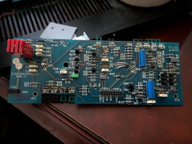

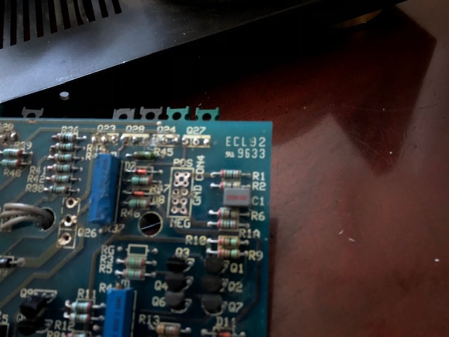

I know this is an old thread and I apologize for reviving it. Any help you can provide me will be greatly appreciated. Do you have a parts list and a schematic for this AW100DMB? The board markings show:
ECL92
9633
A schematic for the power supply would be helpful also.
I tried to post photos below of the left channel board, hope it worked.
Thank You
HW

What I would like to know is the number on the amplifier pcb. (it could be on the back in between the heatsink and pcb) But a picture of the amplifier board would be better, so i can easily identify the board and help you out.
(also point which components are "gone") Your amp is probably coming from the early nineties.
Is that board from an AW100 DMB? Only 1 pair of output devices cant be right. Specs say 2x200w @ 4r and 2x350w @ 2r. Your PCB is marked 120L-3 .. AW75 seems more likely.
What are your rail voltages?
BTW: Is that a Burson descrete op amp as DC servo?

Well it came to me this way with a faceplate that’s shows AW100 DMB. That is a Burson but I haven’t powered the amp up with it in place yet. Not completely sure it is comparable. I just had a set lying around.
