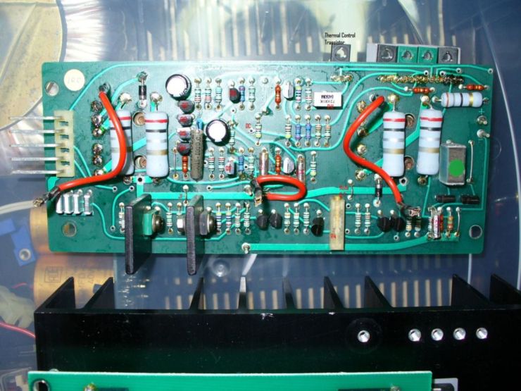

rollo

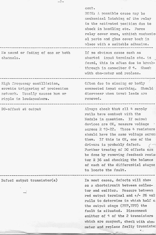

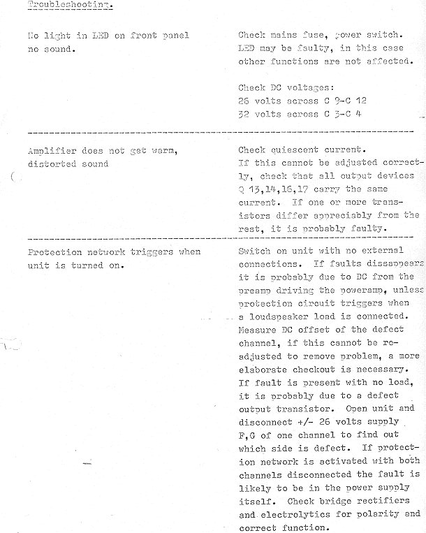

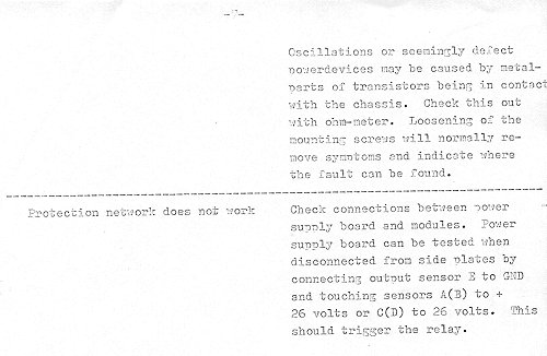

Attached is a troubleshooting list I located at the site of Terje Sandstrom - some good info - there are
three pics - I will try to attach all three if this site allows me - otherwise I will send one at a time
nuvo
P.S. If thermal runaway is indeed the source of the problem then use freeze spray - just a quick spurt -
on the device while measuring may help locate the suspected part. I may be wrong, but Q8 to Q11 seem
to be a long tailed pair with a current mirror as a load - if one transistor in the LTP is at fault you may get lucky and
locate the suspected part for further testing. Also, make sure Q8 to Q11 are mounted to the heat sinks firmly.
Hopefully, mica and heat sink compound was used - EC liked to use thermal blankets, I prefer using mica
with heat sink compound.

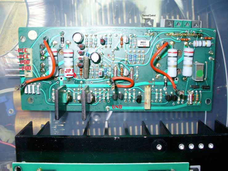

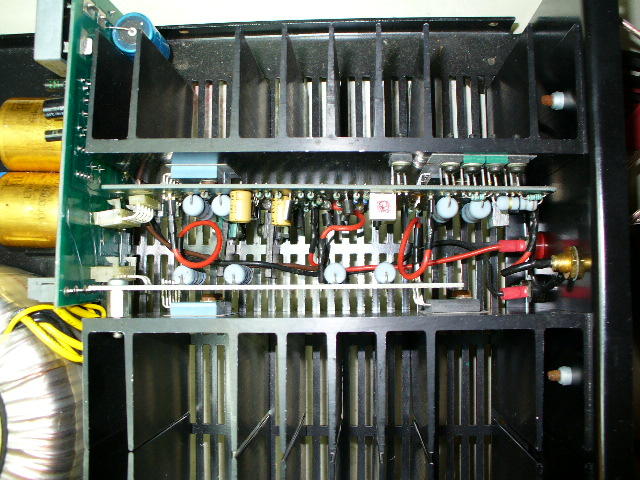

Nuvo,
your picture has the same setup as the most powerfull EC model of the 80s, the AW250DMB. (including the SK53 heatsinks)
If that is 1 channel, i suppose your output stage has 4 pairs of output devices, 2 pairs on the main board and 2 on the auxiliary board mounted to the second heatsink ?
Does your model have regulated rails for the front ends, like the AW250?

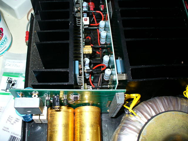

jacco:
Thanks! You have a wealth of information on the EC units - and yes, there are 4 pairs of output transistors - two pair per board. The large (3 watt?) emitter resistors - one per transistor - show the approximate location.
I took another pic and hopefully it gives the perspective in relation to the power board. I have not studied the power supply in detail (no schematic), but I imagine the transistors mounted on the board may be there for regulation.
Also, I checked J1 for rollo and it is set at 0v - my meter (mv scale) showed 0.0009 to 0.0015 - meter tolerances to be considered - I put a scope lead on and measured less than 1mv ripple - good enough for me.

Hello Nuvo
back in town
in post #30 you say:
J1 jumper reads 20.1mv for the left channel (8.4mv drop across the emitter resistors) and 17.9mv at J1 on the right channel (8.2 mv drop across the emitter resistors)
I have to clarifications to ask hoping you remember:
1) I suppose you measured with JP1 in place, right ?
2) across the emitter resistors -->> means connecting the meter between R14 and R13 on the emitter side of Q8-Q9 ?
( because across emitter resistor R14 itself I read 9.86 Volts and across R18 8.18 Volts, which means about 21 mA through Q9 and Q11 emitters )
Rollo 🙂)

I had time today so I removed both PCB's and traced as close as possible to the schematic you provided and yes, I used the incorrect jumper (post 35 & 37) to make the measurement - my apologies for the confusion - unfortunately, my boards do not have the silkscreen legends so I need to trace the hard way. I located J1 and measured to what I believe is node 'DC' as illustrated on the schematic - on startup I measured 33.1mV (no ripple on the scope) - after 5 minutes read 26.5mV - after 15 minutes read 23.6mV - no fluxuations detected at all.
My previous mistake (post # 35 & 37) was that I believe I measured at node 'B' instead of J1 - which explains the ripple. My amp is similar to the schematic but does have differences - I do not have the servo protection circuit and I have dropping resistors in place of zeners - definitely an older version.
I will try to see if I can edit the photos I just took and place arrows to show where the measerements were located on my boards - not sure if I can size for this site but I'll give a try.
nuvo:
rollo
I labeled the attached photo - measured jumper J1 to DC and got the 35mV, etc readings posted previously. The transistor labels may be inverted since this was the best I could do with what I traced - in any event they should be paired correctly according to the schematic. Up at the top I labeled the thermal control
transistor (many circuits just use a diode) which was the original source of my problems.
Hope it helps.
nuvo
Hope it helps.
nuvo
