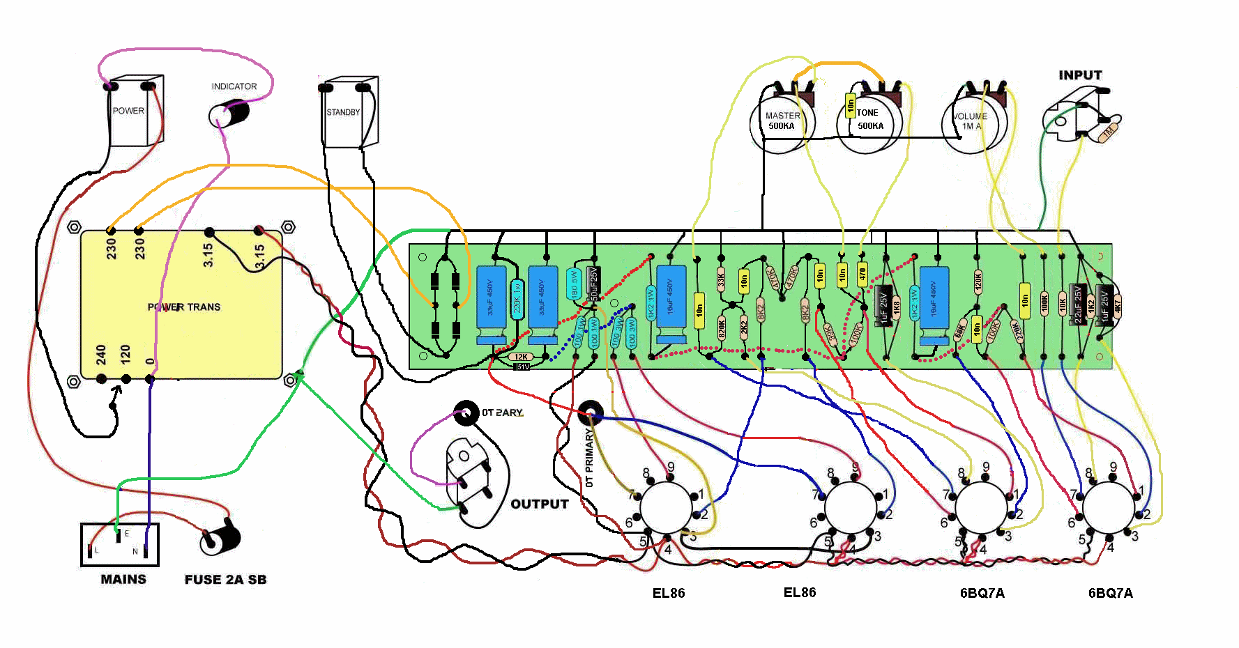

SemperFi... I thought about putting the tone stack as you said, but as the output in Vpp will be low there, with the intention of saturating the 2nd triode, I was afraid of decrease the gain too much, and don´t have enough to excite the third triode.
I will test another values for the coupling caps... Thanks for the tip.

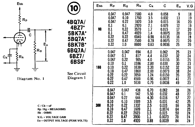

About the 6BQ7A, as i said, i took the values from the "1975 RCA RC-30 Receiving Tube Manual" (table address bellow). Of course, i will try other values too, especially in the second triode.
But do you think the schema is good enough to not explode???
Thanks.

i would like your opinion on my last schematic of EL86 + 6BQ7. Could you take a quick look and give your opinion?
Sorry, but this thread has gone farther along than I would have taken it. When I get an idea, I try not to think about it too much, or I will wind up thinking of 1000 ways to make it better and never building anything. So if this were my project, I would be soldering right now! I don't see anything that would prevent the circuit from working.
There is a discussion about where to put the tone control, and the merits of each place. In my amp I tried the tone stack in between each stage and it wound up right where you have it before the PI. I use an LTP for the PI, but your design is just as valid, try it.
I am getting over 300 volts from my power supply, so I would use 350 volt caps and be prepared to deal with more B+ if you get it. The 6CW5's have no problem with 300+ volts on the plate but the screen voltage might be a problem, you might need a bigger zener.
There is only one way to figure all of this out. Build it, test it, tweak it until you get what you want.
I usually build amps bit by bit. Make the power supply, test it. You will get too much B+, ignore it for now just make sure that you get B+ and all the tubes light up. Then build the output stage and test it with a dummy load and a signal generator. Don't have a sig gen? Use a CD player and a test disk or a computer sound card and a test tone wav file. Then add the PI and work your way toward the input verifying that each stage adds more gain.

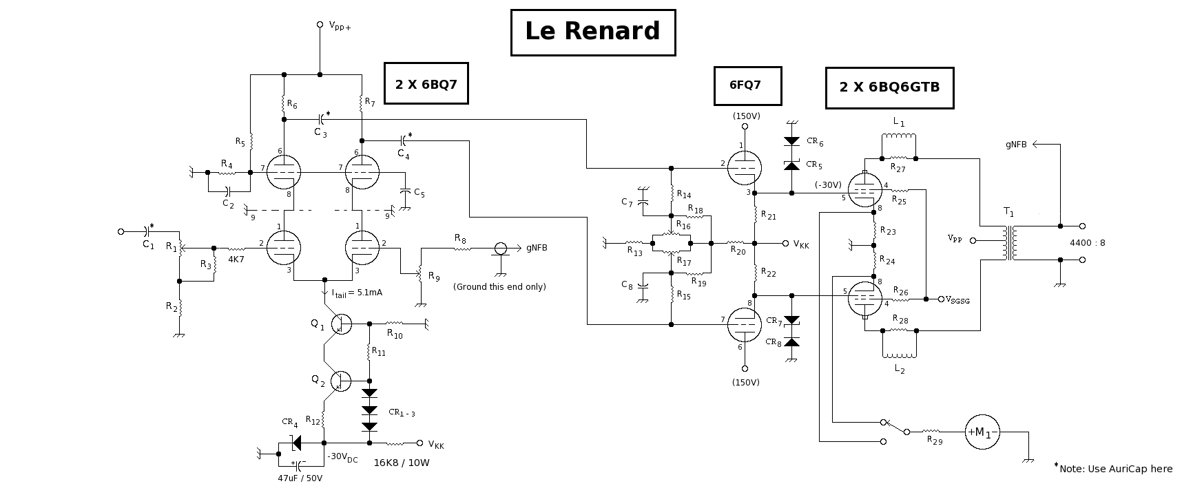

6BQ7s work just great for me. I used 'em to make a cascode LTP, and the sonics are excellent, and there is more than enough extra gain to eliminate a second gain stage.
The main thing about this type is that it was never intended for audio applications, and it does have a funky plate characteristic (undocumented variable-u feature?). You need to get that Vpk up to avoid distortion, but with a good loadline, the distortion is quite low. That, in turn, assumes you have an adequate DC rail voltage.
The other thing to watch out for are the types with the series heaters. These are nastily microphonic and ring like bells. The parallel heater versions don't seem to have this problem.
Great to hear that Miles.
They do have a rather funky graph, at least looking at the last page where the Gm, rp, and mu is plotted, the values vary widely from low to high plate current. To me they look like they have a slight remote cut-off characteristic.
Given that the 6BQ7 was intended for use as an "up-front" RF preamp good to 300MHz, it's highly likely. Most TV sets apply AGC to both the VHF mixer and the preamp. (They shouldn't -- it's a bad design practice, but they do it anyway.) Variable-u behavior seems very likely.
As for sonic performance, I can definitely vouch for cascode LTP performance. George has used the 6BQ7 as a conventional LTP with similar excellent results. As a regular, grounded cathode, audio voltage amp, I dunnow. For that, it it looks like there are better types: the 6SN7-oids, 6SL7, 12AX7 if proper care is taken with the design (get that plate load up: the 12AX7 has rp= 90K, and it's all too easy to load the plate too heavily for decent sonics). For gains in 6BQ7 territory, 6AU6s as pseudotriodes.

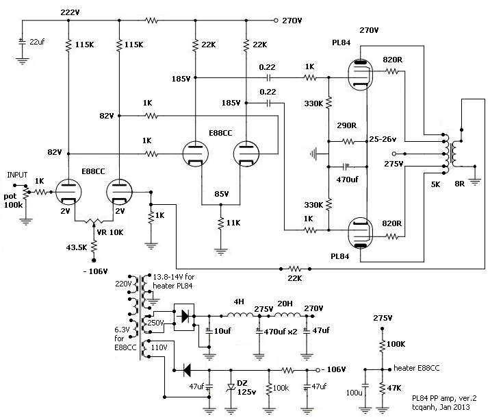

By the way, 25W with a couple of EL86... The designer was not really pessimistic!
Even 45 watts are possible! German musical instruments manufacturer HOHNER once produced the Orgaphon 45 amplifier, featuring two PL84's as finals. Here's the schematics of the power stage:
http://www.hohner.eu/ablage/med_00006406_1264085480_Orgaphon_45_MH_Schaltplaene.pdf

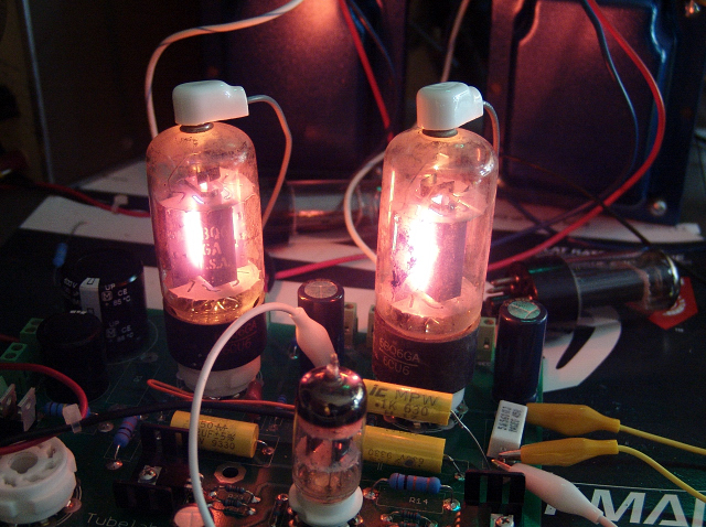

The amp is working... and sounds good.
I changed the inverter ( to a LT inverter), but the rest remains basically the same.
The only problem is a pronounced hum at high volumes.
I am using 2 XL86 (8CW5) + 2 4BQ7A (with heaters in serie), with, of course, a heater supply of 8V (AC).
Probably the 4BQ7A with the heaters in serie are causing the hum?!?
Thanks.
Ps. I am using a lab that I made to test the amp. I know that i have too many wire on the lab, and this increases the hum, but i think the wires are not the only ones to blame. I think the 4BQ7A with heaters in series are the real culprits of the hum.
