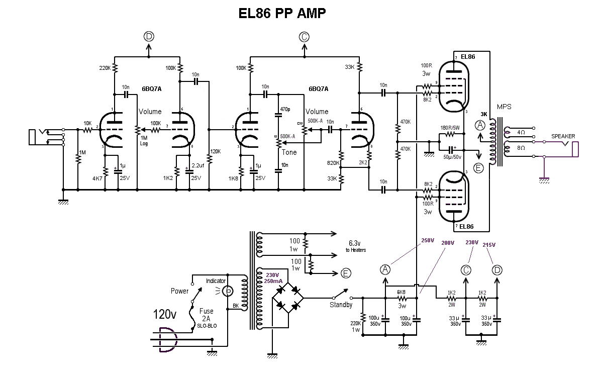

Hi. I am from Brazil, and i am newbie on tube amps.
I am trying to design a PP amp with EL86 power tubes + 6BQ7A pre / inverter with "18W Marshall Lite Style."
Can someone check this schematic to see if there is something wrong? The voltage chart was estimated.
Thanks a lot.

I take it this is supposed to be a push-pull design? One final doesn't even have a signal applied to it. It's just hanging there, doing nothing. If you want the finals to self-split, you need a substantial (preferably a CCS) tail load, and you have none.
Four sections of two 6BQ7s in cascade is going to give way more gain than you'll need here, especially if you aren't using gNFB.
6BQ7s aren't the best type to use here either.
Either the design is badly messed up, or the schemo is.

There is a phase splitter:-
33k Anode load
Cathode 2k2 + 33k to gnd, 820k Bias, 10n cap coupled
Right! But a quick redraw of the schematics would make it easier to understand at first glance.
Miles was probably at the end of a long day 😎
Sorry for the poor design. It is my first, i tried to make the things easy to me.
The inverter is there, a little hide, i admit, but it is there... It will work???
My biggest doubt is about the value of the resistors on power supply. I need 250V to the plate, but 200V to the screen. 8k2 + 1K is good enough to decrease 50V at that point? Zero-signal screen current = 4mA and maximum-signal screen current = 23mA (G&E datasheet).
Do you really need two volume pots?
And it's obviously a guitar amplifier, that justifies the large gain and the two volume contols 😉

The second volume pot shouldn't be exposed to a high DC voltage, so I would want a cap before it. But you can't remove the cap after it, because the grid of the inverter is not grounded, so you end up with 2 caps. Not my favorite topology.
The screen bias has a common resistor and individual blockers. Not sure what that's all about.
If it's a guitar amp and the purpose of 2 volume controls is to overdrive it at different stages, I would use a higher gain tube for the gain stages.
Personally I don't think it's a very good design for a guitar amp. You're better off copying a recognized good design.

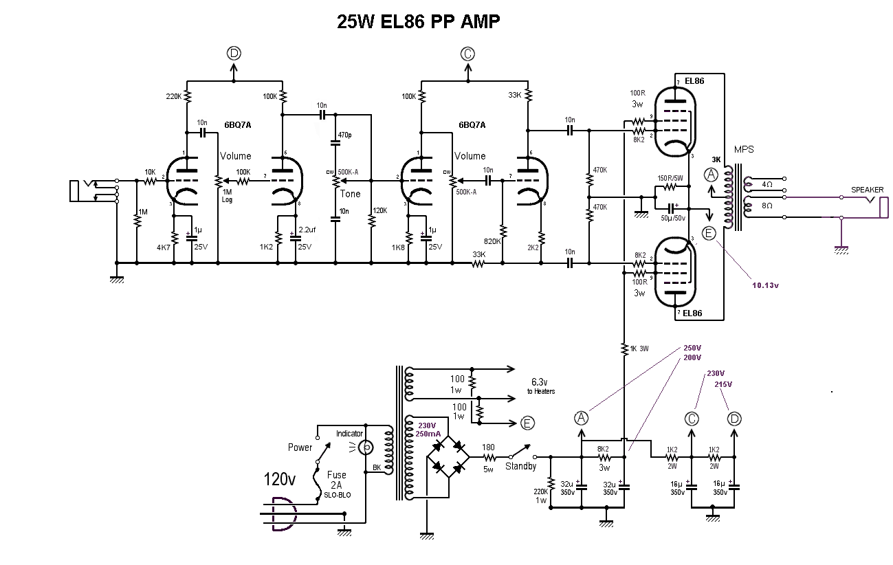

You need coupling capacitor(5-33nF) between plate of 3rd triode and 2nd volume pot.
Yes, 25W is possible, but must rise first 32uF(68uF or more!) in HV-filter, and remuve 180ohm/5W, or substitute with much lower value (10-50ohms)
About coupling capacitor... I used one after the pot. Do you think is better to use just one before the pot or both?
I will put 100uF on the place of 32uF and 33 on the place of 16uF ones. 🙂
And about the EL86 cathode resistor (150R)... Higher values = lower power? If yes, can i try 100R and reduce if necessary?

I used the AX84 18w Daisycutter schematic to modify. These resistors were on the original schematic, and as i am in doubt of what value of resistor use to drop 50V (with Zero-signal screen current = 4mA and maximum-signal screen current = 23mA), i made no changes on them.
Yes, You MUST use both, because withouth capacitor, high voltage will be conecteed via volume pot. to ground!
Also, do not change common kathode resistor from 150ohm, to 100ohms! Smaller kathode resistor will give You "WARM" sound of guitar (~Push-Pull Class A), but less output power! Rather change it to 180 ohms, and also change 8k2 resistor to lower (5,6 kohms or 4,7 kohms) value.
Pair of EL86 (or UL84 and PL84) can get You more than 30W with plate voltage 360-380V and screen voltage 180-190V (Raa=3-3,4kohms), but only with fix bias.
davorin... Do you think it is better that i use, for example, the AX84 PP schematic?
My RCA EL86 (XL86 - 8V - same size of EL84) can delivery this power?
And now i realized that the 180R resistor you was talking about is the SAG resistor, not the cathode resistor.
I made some changes on schematics... Listening to what you guys said....
Someone can check again?
Thanks a lot to you all.

No that cap must be. The grid of the phasesplitter is not at gnd. You might want to use resistor values that give a little more juice since those tubes are a little more low voltage/higher current compared to 12ax7s. I assume the schem is based on those tubes.
I build guitaramps with 6922 and they have even less gain (33) so dont worry about that. The 6bq7 is pin compatible and I have just got me some (they are cheap). Besides, looking at the graphs they seem to be slightly semi-remote cutoff types, and I bet that can be really good for guitar duties. I havent had time to test them yet, but definately will use them.
Screen resitors of output tubes can be 100ohms 1/2W, no need to be 3W. You can connect each screen of EL86 via 2 Zener diode 48V/2,5W to center tape of output transformer, and will not need 6,8kohms/3W+100uF. In that case, plate voltage will be allways 48V higher than screen voltage. Also You can rise high voltage to 265V (screens via zener-diode!), any brand of EL86 can work with screen voltage <220V if plate voltage is higher. Last schematic is good, but You can also use full tone control (T-M-B), there is lot of gain there. Put grid stopers at third triode and phase splitter (~100k).
If i remove the cap after tone/volume control, the pot volume will not groud the screen?
I use the resistor/caps values from RCA manual 6BQ7A table. I use first triode with 24 gain + Eo 70, second with 25 gain + Eo 45 (to saturate easier - if not, i will drecrease 1K2 resistor) and third triode with 25 gain + Eo 60 - all approximate values. Inverter have a unitary gain (i think 🙂 ).
To conect the screens of EL86 to B+ via 2 zener, i have to remove the 100R resistors? I have to use only the zeners to provide voltage to the screens?
