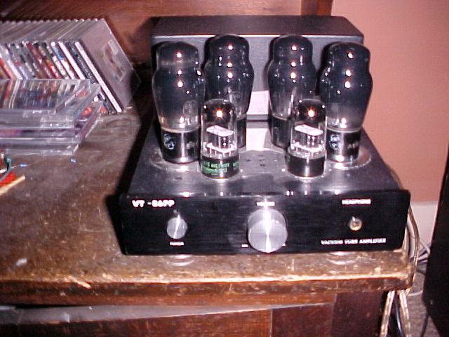

6SL7 and 6V6G
The Chassis and Tranny Cover are from Mabel. This is the full version with CCS loaded MOSFET Source Followers, Fixed bias outputs. Construction into this tiny chassis was a serious pain but I got there in the end. For 6V6 I've chnged the 47K:15K:47K shunt feedback to 39K:18K:39K, the lower (than EL84) gm output tubes need a little more local shunt feedback.

This has "Bog Standard" Hammond 1608 Output Trannies.
I had friends around for drinks last Friday evening just after I'd done the final tweak of the feedback level and the response was not "how soon can you build another one for us" BUT rather "how soon can you build another one for yourself, We want this one".
No kidding - its sounds seriously gorgeous. I'd been listening to some JADIS JA80 80W Class A mono-blocks I'd just finished re-tubing for a local audio nutter, it was a massive relief to get rid of them and fire this up instead.
Some of that gorgeousness comes from the 6V6Gs (Sydney Australia factory AWV circa 1960) but I've also run it with 1980's Russian military 6V6 (the big box they came in still had the KGB stickers on the side) and it was almost as lovely with those.

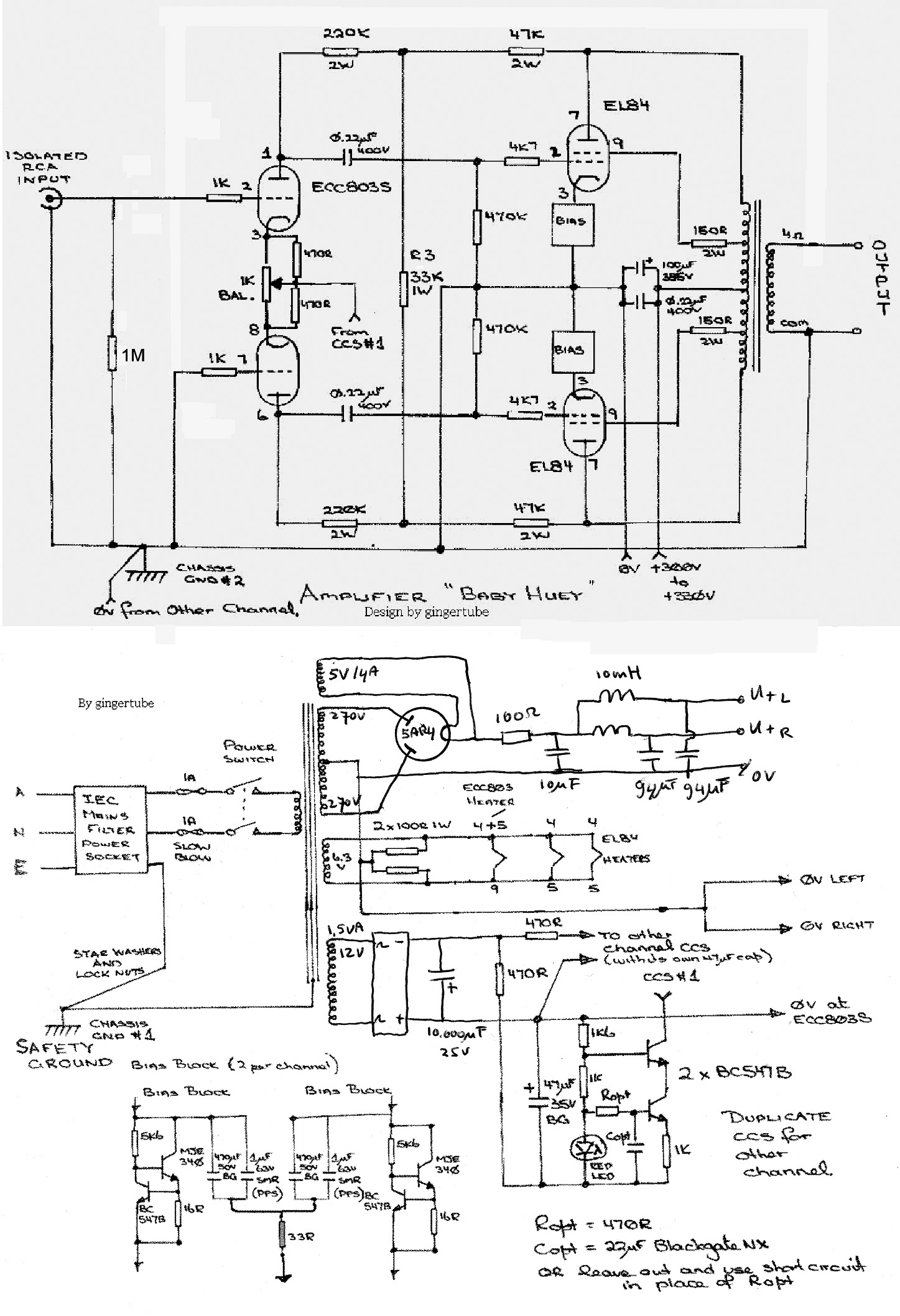

I was curious after the Baby Huey EL84 so I build it. But without global feedback. I have removed R1 and R2 and connect the lower 1K resistor to earth. See picture. I hoop this is all right.
But nevertheless I encounter a problem. Ik have an oscillation of 250KHz on the anode (and UL connection) of the EL84. Input signal is 0V. If I load the LS output with an 8 ohm resistor or lower the oscillation is gone. To me this is not good and the amp seems to be a bit unstable.
Have I done something wrong? Must the grid of the lower ECC803 connected to earth with a resistor of 1M?
BTW, in triode connection I don't have this oscillation problem.
Thanks in advance.
René

Rene,
Your changes should be fine.
To get rid of the oscillation in Ultralinear Mode you will need to increase the 150 Ohm screen resistors. These have a grid stop function and the body of the resitors need to be hard up against the tube pin for the screen connection. Try 470 Ohms or even 1K in lieu of the 150 Ohms. That should fix it.
Ian
