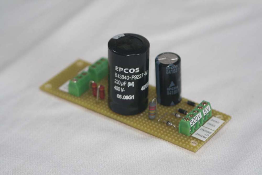

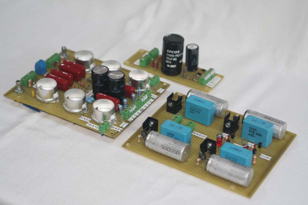

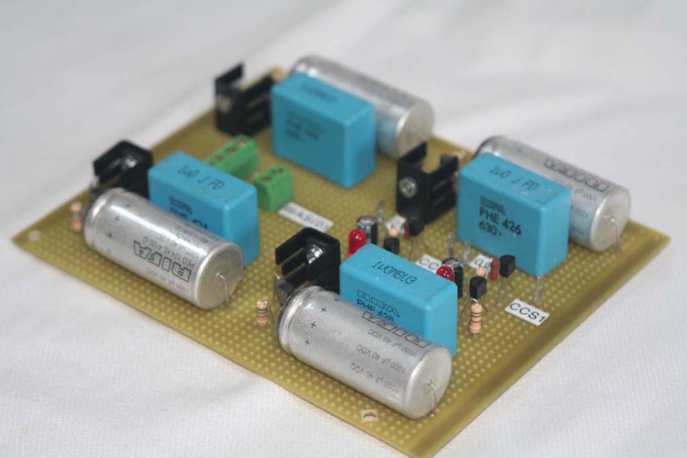

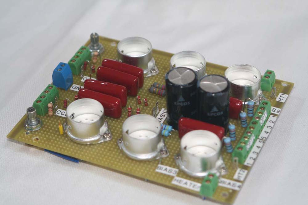

Here is my Baby Huey built in three modules: PS, Bias & CCS and Main. I just finished the modules wiring and I din't test nothing to see if is working. I have a chassis recovered of an old nec inverter that I will try to use to assembly the amplifier. I'll use ECC803 and EL84 both from JJ.
Photo all modules:

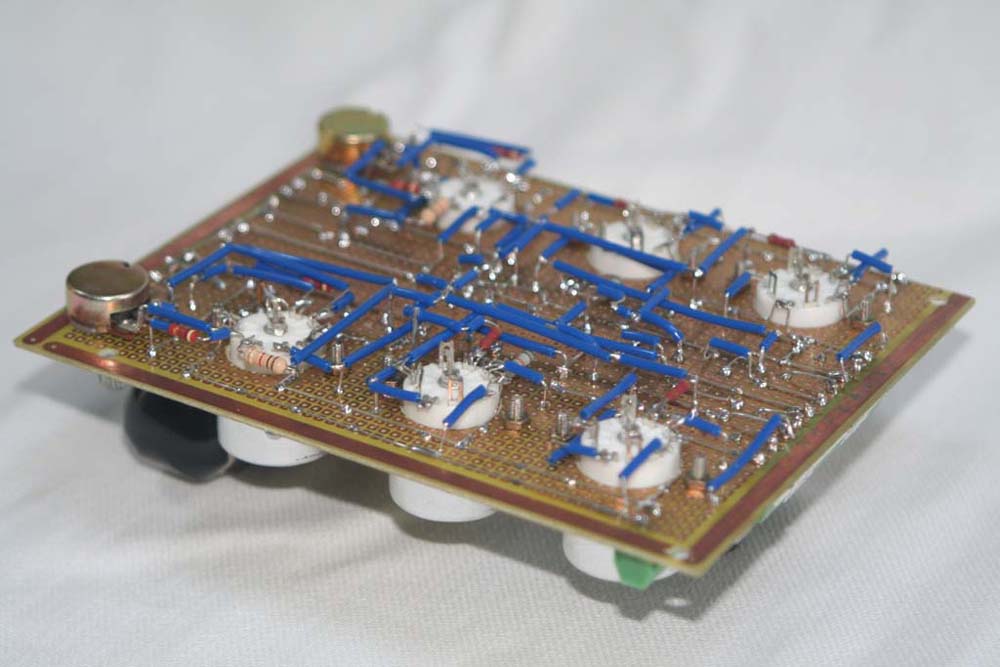

I am still rather new to this hobby, so take my next comments with that in mind... My first scratch built amp was a little ambitious. I tried to put too much in too small a space and I had a poor understanding of correct wiring/grounding techniques. It hummed and buzzed! I am now very cautious with signal, heater and ground/zero volt wiring. Your main amp board looks very neat, but I am a little worried that you might be setting yourself up for a noisy amp.
It is a little difficult to see, but it looks like your heater wiring is very thin, and running as two parallel wires. Remember, the EL84s draw about 760mA each and the ECC83 will draw about 300mA, that is almost 2A total. Unless you are running DC heaters, tightly twisted wiring tucked in to the corner of the chassis gives the lowest noise. Also looks like you have lots of wires running parallel to your HV. This can also induce noise.
I would suggest hooking everything up before you start drilling holes in a chassis. If my fears are unfounded and all is OK, then congratulations on a very neat job! If you do get some noise, then perhaps the areas I mentioned might be a good place to start trouble shooting.

Yes, probabily I'll get some hum because,as your
comment, parallel heater wiring is not recomended
despite of short lenght - mine is more than 10 cm.I can
easyly re-wiring with twisted pair if necessary. I used
for heater, tinned copper 24AWG (0.5mm) and you are
corrected, it's not enough to heater 2 EL84 and 1 ECC803 - thanks! I will change to 22 or 20AWG that will support 2 or 3A.

Hi Akira
That is a compact layout...I just hope that the capacitors between the EL84's don't get too hot...there is quite a lot of warmth there (48W plate dissipation + ~20W in heaters)
Maybe you already thought about it, but anyway...I would use some longer screws to hold the sockets, and use those screws to bolt the whole module to the chassis...that way you won't apply strain to the fragile PCB when inserting or pulling your tubes.
