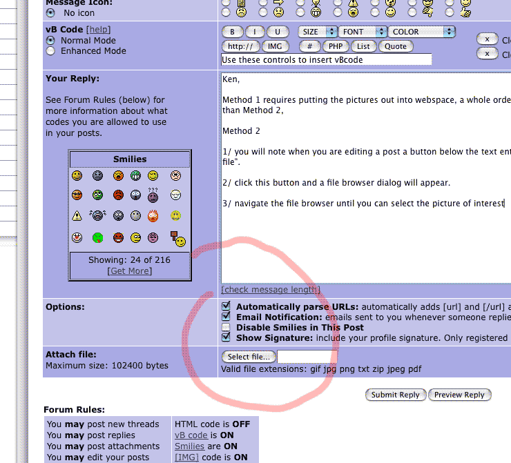

Ken,
Method 1 requires putting the pictures out into webspace, a whole order of magnitude trickier than Method 2,
Method 2
1/ you will note when you are editing a post a button below the text entry window called "select file".
2/ click this button and a file browser dialog will appear.
3/ navigate the file browser until you can select the picture of interest and say Open (or OK or whatever your computer uses)
4/ the file will then be copied into the forum database and your post will say "jackomancy has attached this image"
5/ do not use the preview reply, just submit it.
dave
