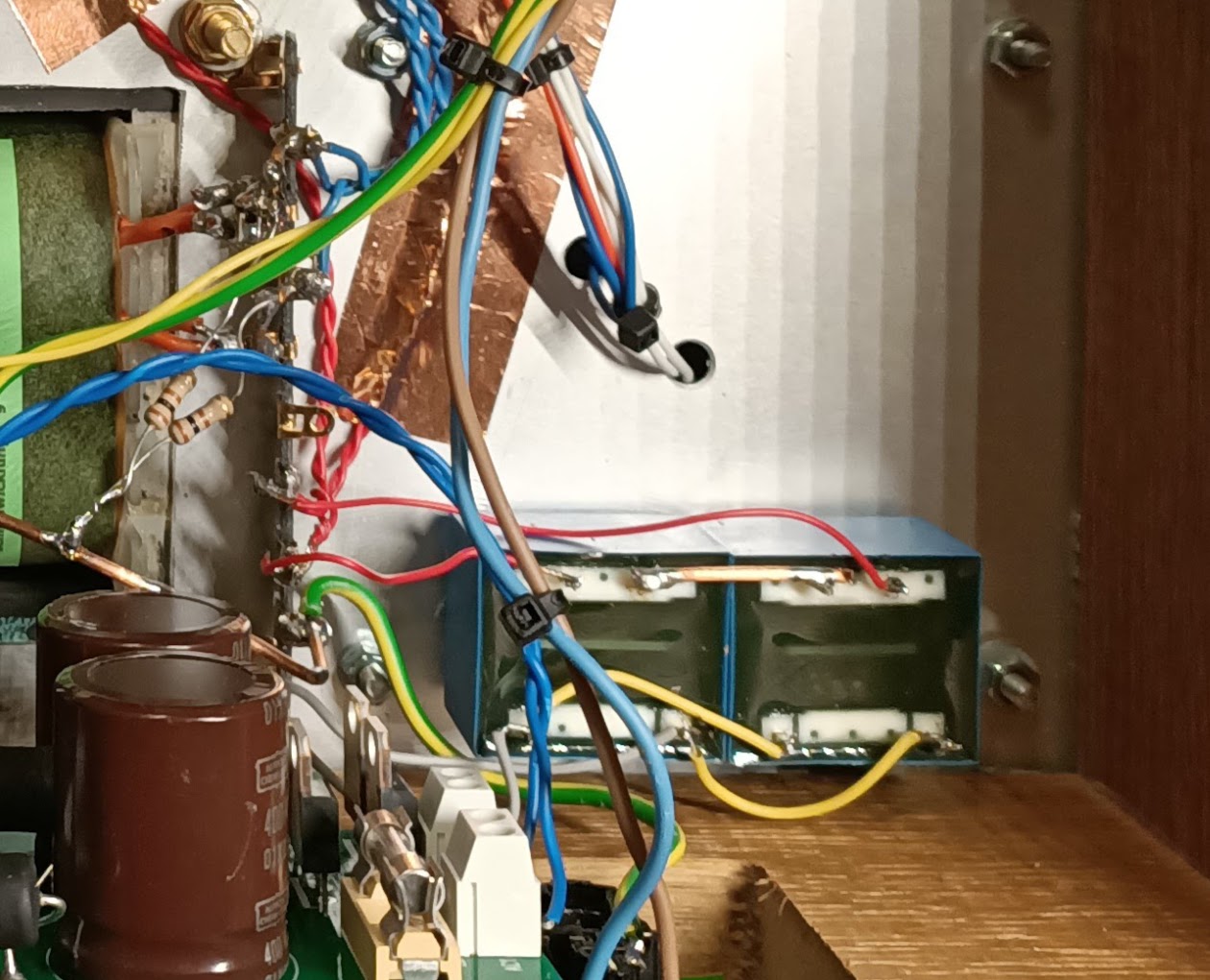

Bias/MOSFET supply
I'm looking at building a couple BH into a pair of existing monobloc chassis that have no source of 40 to 50VAC for the bias/MOSFET supply.
I found a Triad VPT48-1040 48VCT@1A toroid that looks suitable. Still not exactly cheap when shipped to Australia.
Is anyone aware of a small switcher, boost or buck converter module, a pair of which could be used to supply ~ ±65V?
They seem to max out at 35V.
Thanks!
Thanks!
Here is an idea to consider. You do not need +-65 volts for an EL84 based BH. The rule of thumb is 3 x the - grid voltage on the power tube. For an EL84 this is usually in the -8 to-12v range . So +-35 would be fine. I recently completed a BH EL84 and actually use +20 and -36 for the bias supply without issues. There are a few resistors that may need to be changed for these voltages to be ideal, but +-65 is not needed. For an el34 version you need the higher voltages. Personally, I would stick with a linear supply and not use a switching supply for the bias voltages. There is a good chance that with a switching supply you could introduce HF noise or leakage current issues into the most sensitive part of the output stage.
Thanks for the suggestion. I'll play around with my simulation and get some starting points for the resistor values. It's a pretty cheap experiment if there are HF noise or leakage current issues.
I used two 80mA 24VAC IN series. Bottom left... Primaries were probably 220...came out to above 80VAC. So I lowered it with a 330 Ohm resistor.Is anyone aware of a small switcher, boost or buck converter module, a pair of which could be used to supply ~ ±65V?
You only need 10-15mA per channel or so I believe.
Thanks Bas. My simulation suggests 10-15mA is indeed fine.
The lower voltage suggestion gives plenty of options. Small 24V and 30V 150mA transformers are available locally for under $10.
I'll do the same.
