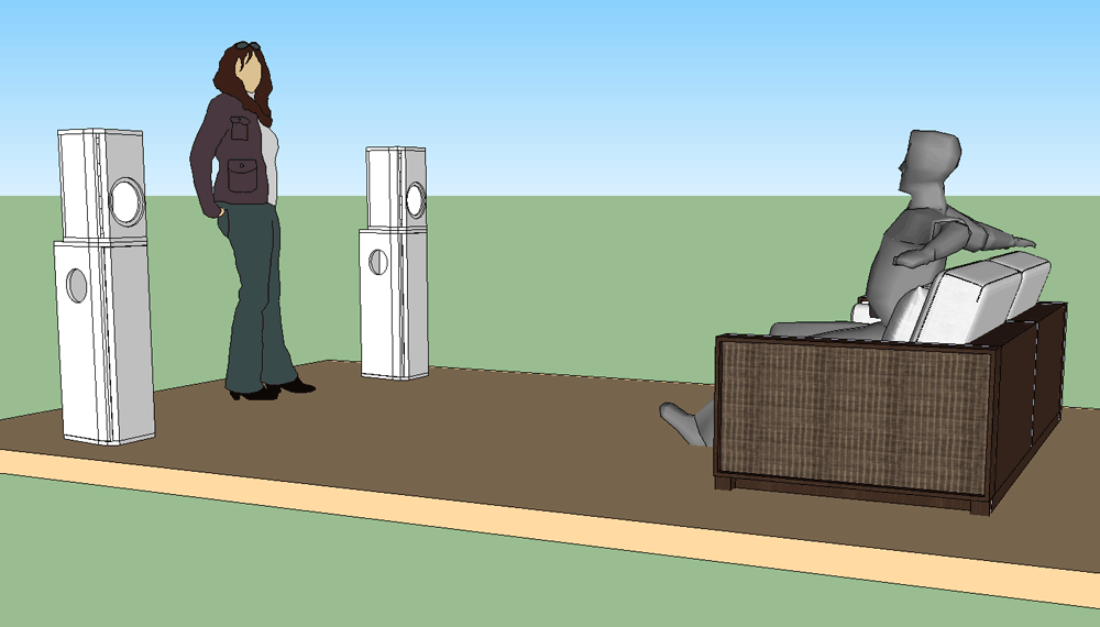

BTW, we are going ahead with the Mar-Kel70wT + Push-Push EL166 ML-TL bass/base unit.
Like this but with EL70 instead of A12.
The Mar-Kel70wT are already done

Wow, beautiful drivers!
Seems like it would be an OK speaker, but I'm afraid SPL wouldn't be loud enough for me 🙂
For an example, I listened to System Audio Explorer Master helped by a REL Gibraltar G1 subwoofer yesterday. That setup was able to play loud enough 🙂
