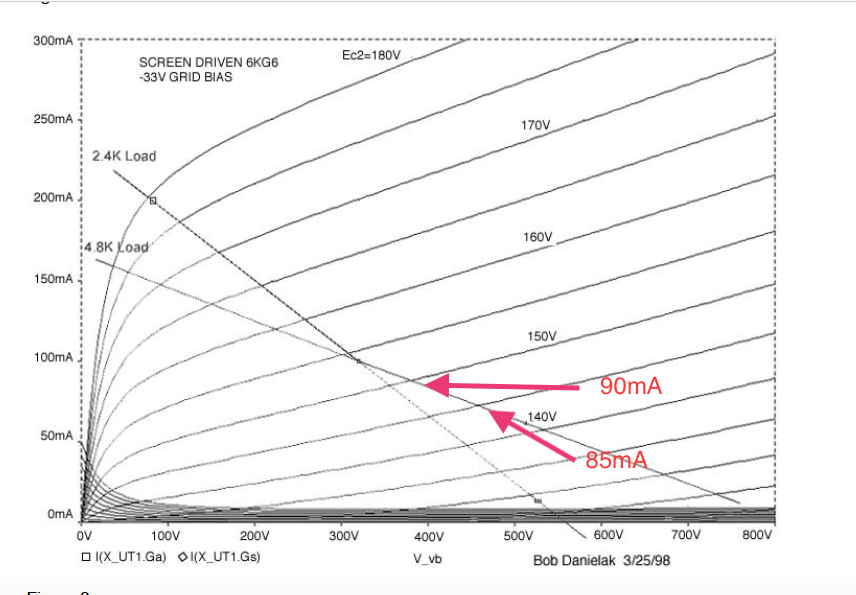

Tim, I spent some time searching for the schematic on the internet. All I could find was a fuzzy “psuedo schematic” without power supply voltages and transformer details. Do you have a clean schematic to post here, please?
Hi Francois,
It took me only a moment to find the schematic on this forum.
https://www.diyaudio.com/forums/tubes-valves/27132-ear-859-questions-2.html#post316531
https://www.diyaudio.com/forums/tub...transformer-300b-shootout-12.html#post4289564
The B+ is shown (500V) and if you search you'll find where TdeP says the OPT impedance is 4.8K.
There are photos of the commercial amp innards to give you ideas for the layout.
It is a very stable reliable design.
best
tim

Oh yeah, I forgot.
The 519/509 runs at 80mA.
So your load-line was not far off.
(and of course the 4k7 input is wrong--it's 47k as you'd expect)

Thanks again. What is R in the schematic in the power supply as well as on top of the driver (cathode follower) tube? If the two R’s are to be connected it would short circuit half of the power siupply.

PCL82 Cathode to heater Voltage Max 200v , so if there is less than 200V across the tube no need to lift the heater potential with 100K>33K to ground
if that is a concertina phase splitter dc coupled to the pentode plate, then that means the cathode will be at a dc potential of more than 6vdc, perhaps 100vdc or there abouts, i will use a dc lifter anyway...
single ended DC coupled PCL82>EL509
350 B+ > 47R> 349V on plate of the PCL82 160v on cathode -10K cathode R > 20mA
any way, you do not have to make up your mind now, but make provisions for a ground dc lifter, when the amp is running listen for spluttering noise on your speakers, if you hear none, then congratulations, you do not need to do anything more....
but if you did hear some noise, connect the dc lifter on the first tube and that should clear the noise..
there is an unwritten rule with tube circuits, that is never leave any element floating however if unused.....filaments included...thus we see in many cases, one side of the filaments connected to ground...
