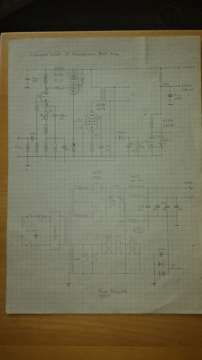

Of course. Here's my hand-drawn circuitry.
The main differences from Danielak's design are:
- In Danielak's the bias adjustment trimpot also impacts the amplifier's gain, 'cause it is in the GNFB loop. This appeared absolutely unwanted to me.
- I've found severe current take over issues when the PL519's screen was high and plate was low level, as described several times above. To cure this, I lowered both cathode and screen idle voltages.
- I didn't find any use in tying the bottom side of the PCL82's pentode's cathode resistor to the triode's cathode's network, so I returned it to ground.
- I've also found out that there's no reason for the PL's plate load of being more than 2400 ohms.
All the other differences mainly are according to my taste.
Here's a link to the amplifier when I presented it at a German tube lovers' meeting in March 2005. And here's the Synola 509 prototype. Reinhard Seyer from Hamburg, the designer, also has been at this meeting.
Best regards!

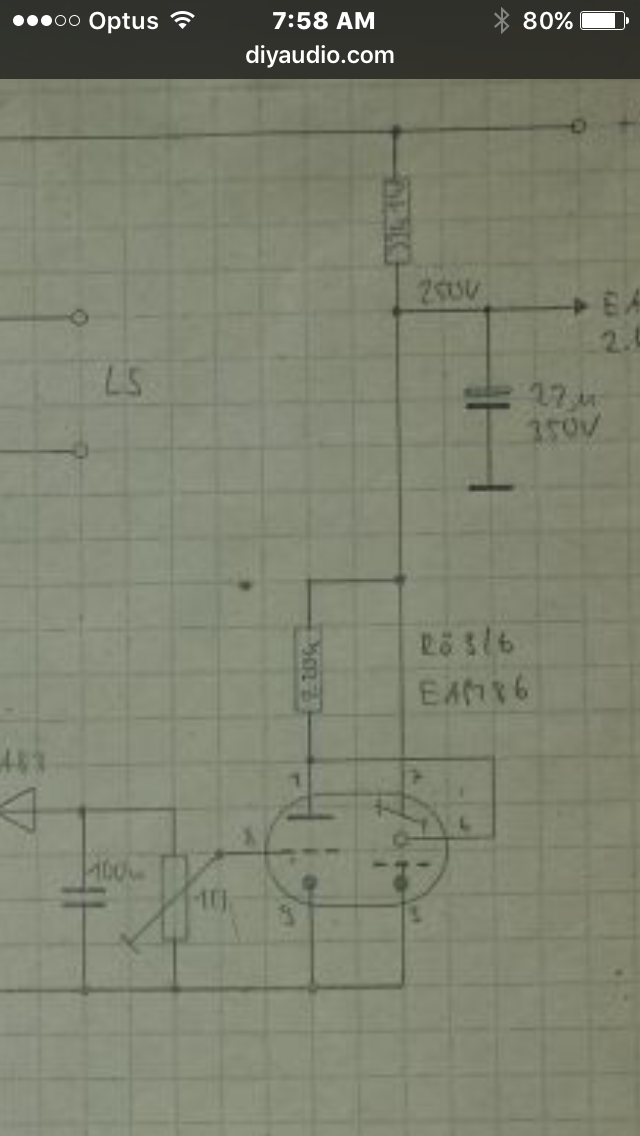

I was wondering if the voltage on the plate of the 509 was increased to 500v and current load pushed back to 80mA the 509 could infarct deliver 12-14 watts output ?
Thanks for the schematic ! What is the tube type introduced in the feed back loop And can't read the plate R value or adjustable pot value that is the the right of the 100uf capacitor Image include Interrelated also in the adjustment needed within this Feed Bsck loop ?
How much gain peak to peak is now in your driver circuit, as the 509 grids not only need quit a bit of current they also need a lot of input voltage to drive the 509 to good output levels
Hi Perfectusaudio,
it was in 2005 when I designed and built this amplifier. It hasn't been very much in use since then, sitting apart most of the time. I didn't write down all of my measurements, so I'd have to put it back to my bench to answer your 1st question. Most probably you're right in your assumption that a higher plate voltage may ease the PL's task.
To your 2nd question: The tube shown in the left part of my drawing doesn't have anything to do with the amplifier itself, and it doesn't impact the GNFB loop in particular. It is just a volume indicator, using the nice little EAM86/6GX8 tuning indicator that easily can cope with the relatively small output voltage this amplifier is able to deliver. Btw, the related cap's value is 100nF instead of 100µF, the trimpot's is 1MOhms, the plate resistor's is 220kOhms. Sorry, but I don't own a, maybe better readable, computer generated drawing.
Best regards!

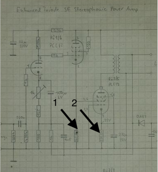

Hi ALL,
The Synola with the ECC82 swapped out for a 6N30P will supply plenty of cathode current (needed when the EL509 519 PL 519 etc swings positive and draws losts of grid current , this is worth a try ....
Resistor Values - arrows 1& 2 please on attachment?

Sorry, you should have better asked immediately. I can't find my drawing at the moment.
Edit: I think it was 7k5 and 250R, respectively, for these.
Best regards!

Thanks, as I have just 3 Siemens EL509 to experiment with , also have a spare 2.5k and 3.5K transformer .
