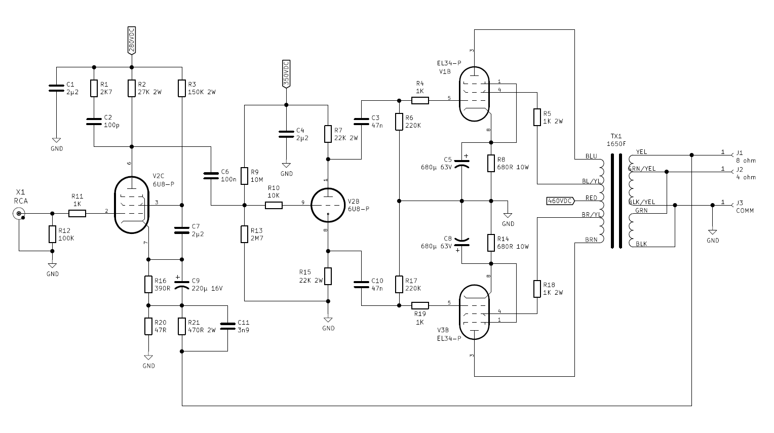

With pentodes you get lots more gain from a single stage, lower input capacitance and sometimes more drive capability, though that last point is a moot point if there's a light load after the input. Such as a phase splitter. It does matter, though, in two stage SE amps.
I've built a few PP now with pentode inputs, and I quite like a simple input/phase splitter made with a single pentode/triode, like an ECF82/6U8.
Here's one I built last year as a practice piece. The schematic had to fit in an existing chassis with it's existing transformers, so I had only three tube sockets to populate. Granted, this isn't the most technically perfect example of an EL34 amp, but it works, puts out about 25W (over 30W at clipping). But distortion is stupidly high, hitting 1,2% at specified power. It does sound kind of sweet, though.
Ooh, that's an interesting design. I've got a lot of NOS 6U8s, but I think I'll stick with something I'm more familiar with, and that being triode gain stages. Thanks for the information on small signal pentodes though!

I gave that design the name PP/34 Stetson, since I pulled it out of my hat. Or my @rse, to be honest. I came up with this design quickly when I was offered a pair of amps useless to me in their inherent form, but saw that I could do something new (to me) with the iron present there. Even if it was just an excercise. I think I concocted that schematic in a day or two. It does combine elements from many previous designs, though.
The individual bias resistors come from Mullard recommendations. That front end is one I designed previously for an EL84 PP, just slightly beefed up. I do have some 7199 tubes, but didn't want to use them here. Now that I've found where I stashed my bunch of ECF804s I would've probably used those instead of 6U8, given the higher transconduntance of it's pentode side, but back then I couldn't locate them.
But still I think a simple driving stage like that is a little too weak for larger pentodes. A cathodyne splitter is OK for a little power pentode like an EL84, but an EL34 requires more. I've a working but not yet complete KT66 PP prototype with a pentode input and an LTP splitter, and that makes 35W with >0.1% THD given good output tubes. It is a fixed bias design, though, which generally gives more power given the same B+. But still, the difference in THD is in the decade department, and that is noticeable.
However, this simple design does work, and it isn't stupidly expensive to build. And it does sound quite nice. It does require an active preamplifier, however. It uses Hammond 1650F output transformers, and any JTM45-style power transformer should work in this monoblock form. What should be noted is that this schematic has been compensated for that exact transformer, and thus stability with any other iron is suspect. I took great care making it stable.

But one thing I set to solve for myself was output tube balance with cathode biased output stages. I had been taught that current imbalance would bugger the output transformer, so I thought that you'd always need either balanced tube sets or some mechanism to put them into balance. So, after building this amp, I popped a completely differing pair of output tubes on it: a Mullard XF4 EL34 and a Psvane EL34 (completely over-hyped chinesium, if you ask me). And lo and behold, the current imbalance was below 0.5mA. Took the stress out of that one...

I agree with you; individual self bias has many advantages (and as others will point out many disadvantages).
I prefer individual self bias.
Normally, global negative feedback covers many imperfections in an amplifier.
But if anybody would like a lesson in OPT core saturation, take a look at the original Instruction Manual for the Heath Kit W5 amplifier.
At the very bottom pages, there is a graph showing the rise in harmonic distortion at 20Hz and at 100Hz versus the un-balanced current in the output tubes.
The distortion is quite high at small differences in push quiescent current and pull quiescent current, even though the global negative feedback is in operation.

A few reasons why some do not like self bias:
When the signal amplitude is large, the bias can shift.
Electrolytic caps as self bias bypass caps are disfavored . . .
(some say they add 'grunge' sound, But then at the same time they use electrolytic caps for their B+ filters).
Self bias gives a little less power for the same B+ voltage, versus fixed bias.
A few reasons why some do not like fixed bias and/or adjustable fixed bias:
If you use RC coupling from the driver(s) to the output tube(s), When the signal amplitude is large, the bias can shift (similar to the bias shift in self bias circuits).
Individual adjustment of each output tube bias is required for best performance.
Re-adjustment of bias can be necessary when tubes age, and/or if the balance changes.
I probably missed a few reasons for both self bias, and for fixed bias circuits.
Tradeoffs.
The most revealing thing to me on the Heath Kit W-5 amplifier and slightly un-balanced plate currents, was the Harmonic Distortion of low frequencies ___even with___ Global Negative Feedback.
A Push Pull transformer that has un-balanced plate currents in it, is what "makes" the transformer into a "Turd".
Cinderella's Fairy Godmother's "Wand" = Presto Change-O, Good to Bad.
It is not the transformer's fault, just the designer's good or bad implementation of it.
Heath Kit had a solution in their current balance circuit (one of many designer's different solutions).

When you do that . . .
The Secondary DCR goes up (higher Z tap = more turns), and more power is lost.
The increased loading effect, reflects a lower impedance to the primary.
The DCR becomes a larger portion of the reflected load, so there is an increased power loss.
Most of my transformer losses at mid frequencies are caused by Primary DCR and Secondary DCR.
How do I know that?
I measure both DCRs.
I measure Turns Ratios (primary driven by low impedance, and secondary open; that swamps reactances at mid frequencies).
I measure primary volts versus loaded secondary volts.
A few calculations using the above measurements and the total insertion loss is known.
Then calculating the portion of the insertion loss that is only due to the DCRs.
And . . . by far, most of the insertion loss is due to the DCRs.
Just on my single ended, and just on my push pull transformers (my experiences).
Your mileage may vary.
Some say, I carefully calculated the amplifier power out, and I am getting less than I calculated.
I ask, did you account for the output transformer insertion losses?
Some have 0.3 dB, 0.5 dB, 1 dB, etc.
How do I know that?
