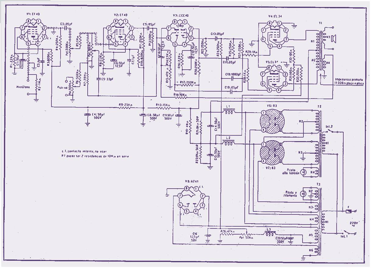

Philips/Mullard/Fapesa was happy with pulling 100W 😱 out of a pair EL34 😎
800V on plates, 400V on screens, 11k plate to plate impedance.
Biased very cold, it was meant as a PA amplifier, usually driving 70V or 100V lines.
Was very popular here, specially because FAPESA (our Philips branch) published full data on how to wind power and output transformers; they were mainly used in Commercial duty, often in small town so called "open radio" service: companies creating radio program type shows, with news, music and paid announcements, no RF involved, "transmitted" along high impedance wired lines stretching for many City blocks, easily over half a mile each on every direction.

JMFahey,
Thanks for the story on "Broadcasting" Audio over 70V or 100V lines over several city blocks.
I do not prefer Mercury Vapor rectifiers (like the 83 ones in the schematic you posted).
But they did do it properly, they used Real Choke Input B+ filters (no cap before the choke).
And they also used 2 power switches.
The first switch warmed up the 83 filaments, the fixed bias tube rectifier filaments, and the rest of the amplifier tubes, including the output tubes.
Then, Only After all the filaments were warm, the second switch was closed.
Sometimes engineers do get everything right (lots of times).
Just do not give any credit to the engineers of the [first] Tacoma Narrows bridge in the State of Washington, USA.
