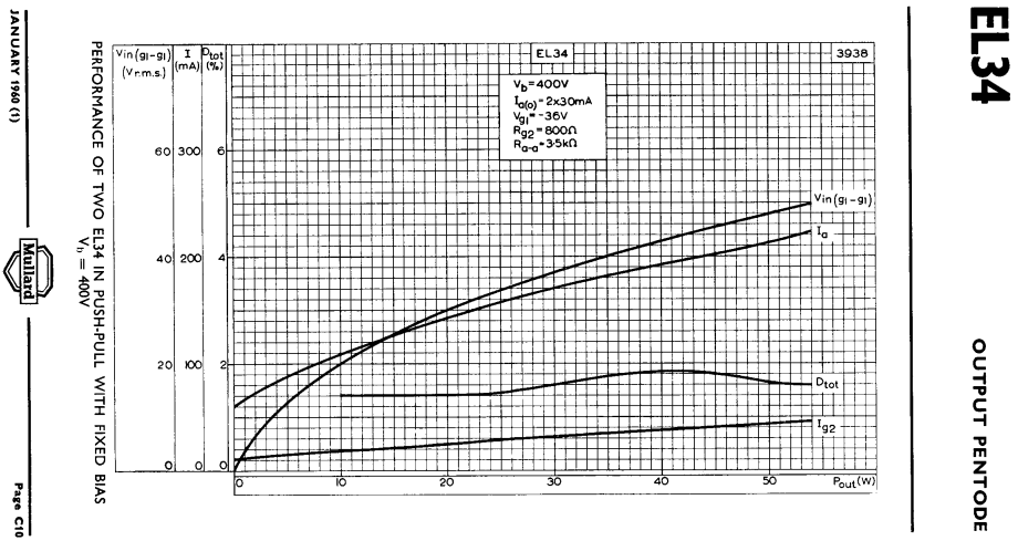

50W is pushing it ? Look at the Mullard data, up to 55W no problem.
You want pushing, look at what Telefunken propose 😎

Okay, so the ham radio operator would say "the tube is rated for 25W dissipation, that means that if I accept a little bit of cherry on the plates it can take 30".
This isn't necessarily good practice for audio amps (not that it's good practice for RF amps either). I hate pushing tubes hard in audio service, because when they fail there's always a chance of them taking out something expensive. Especially in UL operation, a short involving the screen grid can take out an output transformer. It's rare, but less so on amps that push tubes hard in UL service. A 100R screen resistor and a 10R 1/4W cathode resistor can help, but I still don't like pushing my luck. Regardless, it's a massive transient that will get your attention.
So would it be better to shoot for something like 35 watts? That will almost certainly still be sufficient. I'll do some looking at those schematics later! For tubes, I was going to buy a matched pair of JJ EL34s, and the datasheet does spec them at the same level as the Mullard one does, but I have no plans on running them at 800 volts on the plate.
