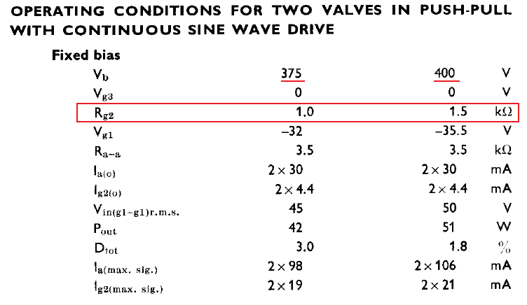

I am using a pair of Tung Sol EL34B for a guitar amp push-pull output stage, and I have come across the following: Tung Sol specifies that the limiting value for G2 voltage is 425V.
In my application, cathodes are at 0V (fixed bias), and since B+ is around 456V, the Vg2 voltages rest at 453V. Which exceeds the ratings of the manufacturer.
The bias voltage is around -40V, resulting in about 35 mA current per tube (the actual currents are 20% apart, which I think is acceptable for matching.)
Is this voltage stress really a problem? The amp has operated for about 330 hours without any noticeable changes in behaviour or problems.

Phillips and mullard allows 500V ( https://frank.pocnet.net/sheets/010/e/EL34.pdf )
telefunken and JJ 450V I would not worry about your tubes, if they manage they do. You will eventually replace them later as tubes are consumables.

Yes, I use 1k in series with the grids.
This is my feeling too, that since they work, I will change them when they wear out. I was just curious! It seems that the rare strains ensure the tube functions well I suppose.

If you overload (clip) for a long period and play loud a lot, I would consider 2K instead of 1K, this will drop about 50V off G2 and keeping it closer to it's 8W (~20mA G2) limits.
