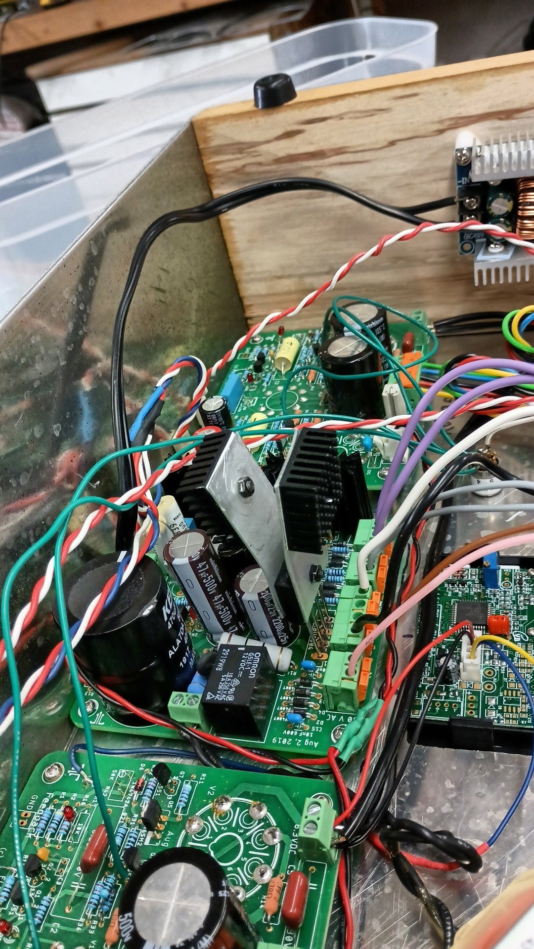

This is probably all fixed with the heater supply changes referenced in the past few posts here and maybe other had this problem and found fixes. But it's too long of a thread to go find what others have done. I thought I would just come back here and drop a note of the problems we had and how we resolved them.

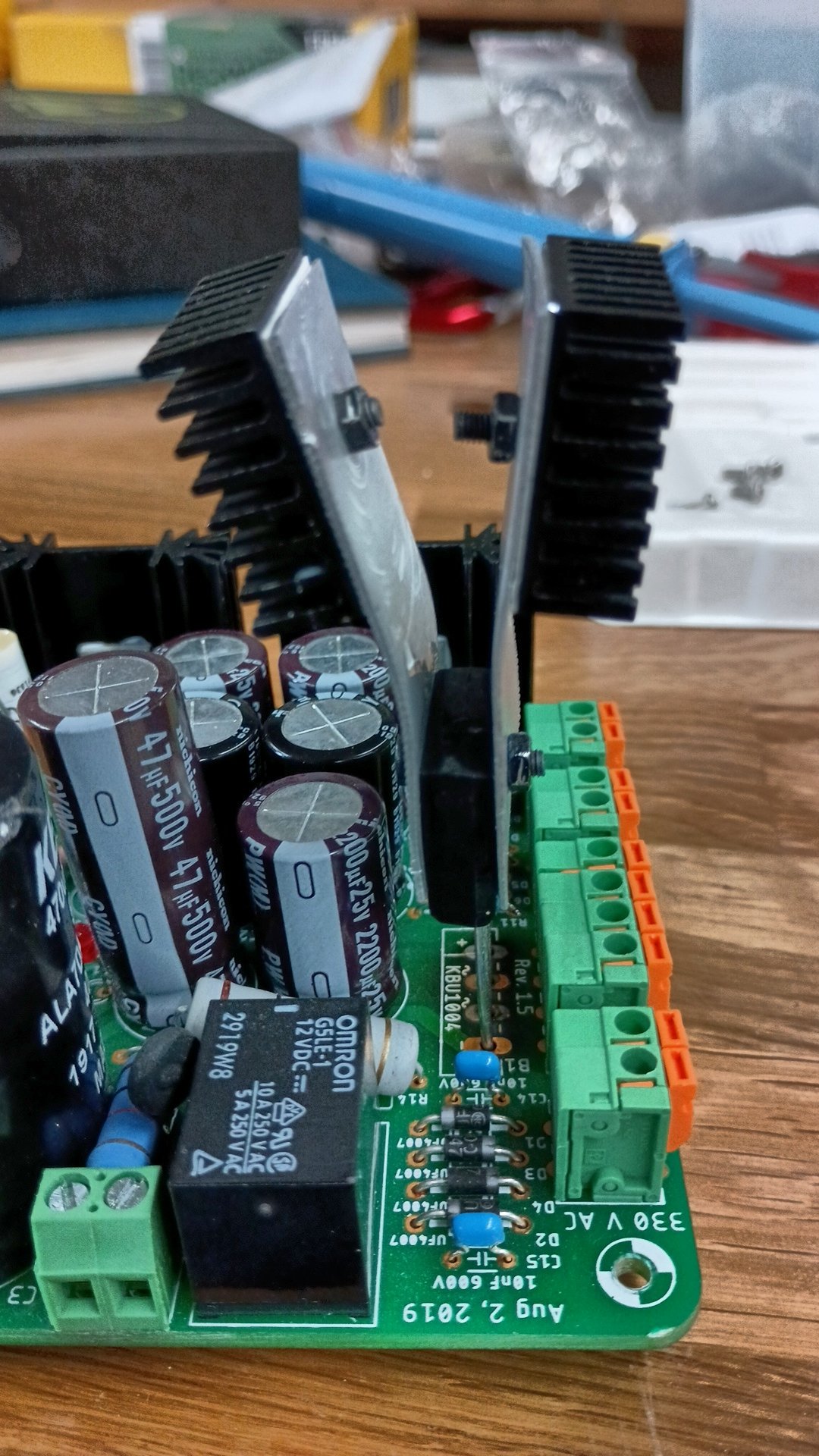

We had problems recently with all 3 amps, after years of operation. The problem is with the tube heater supply section of the power supply board. The KBU1004 rectifier gets so hot that it eventually caused the solder joints for the rectifier to fail, which lost heater power.
The rectifier is rated for a max of 10 amps. With 4 KT88s and two 12AX7s we're still under that threshold but pushing it pretty hard at close to 8 amps. And the rectifier specs say the 10 amps is with a heatsink, which the version 1.5 boards we used did not have. They also didn't have any space for a heatshink.

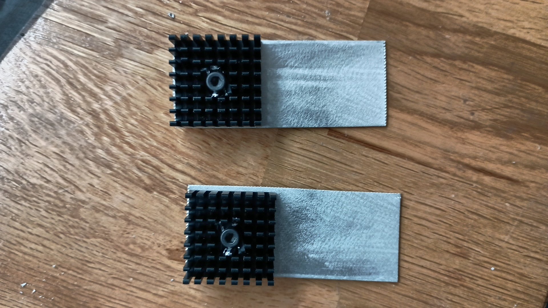

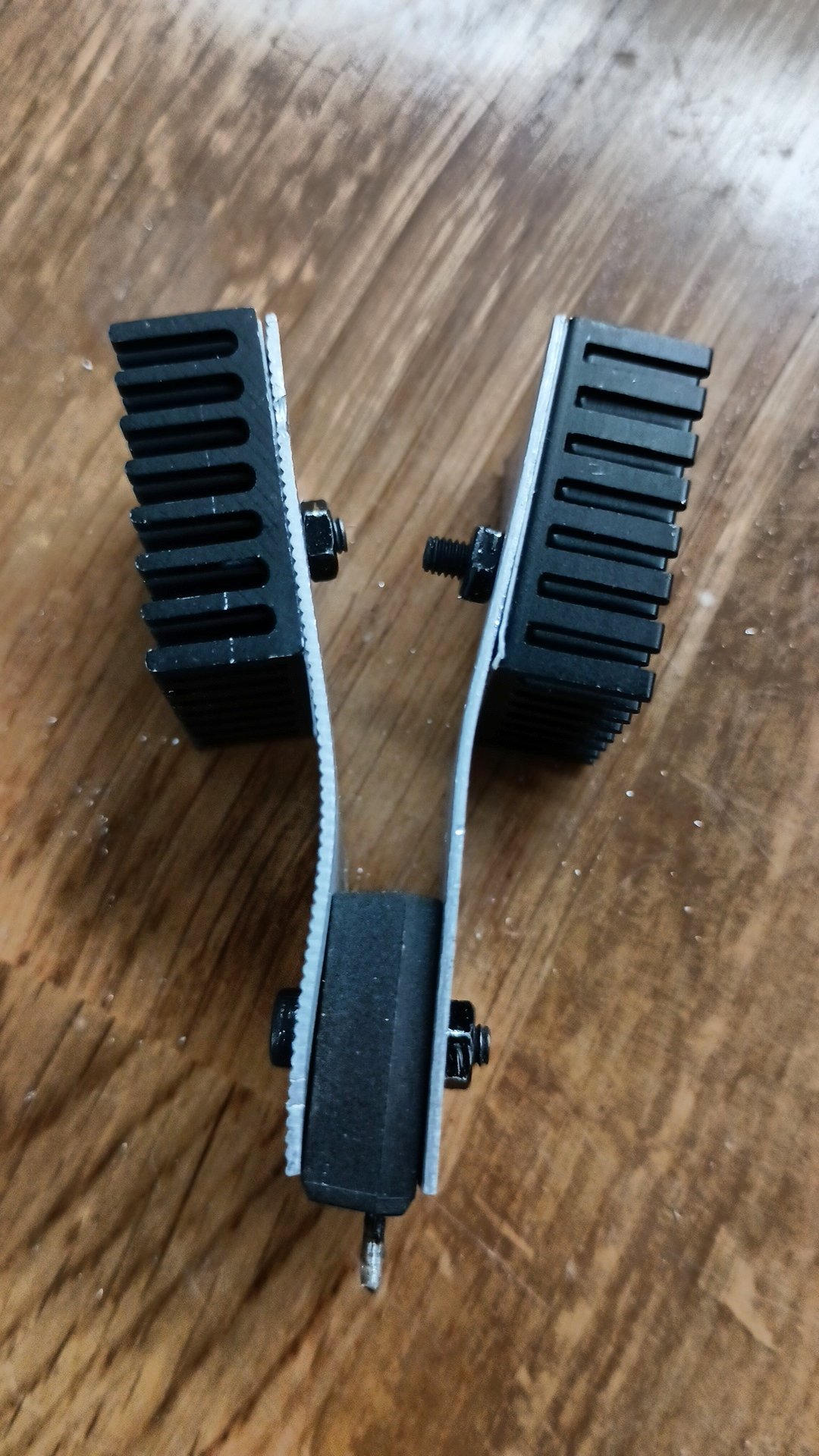

We purchased new rectifiers, and left the legs long on them so we could mount them up high, then made a heatsink to attach to them. Here's a few pictures that describes what we did.

Use separate heater supplies. The same winding if the transformer is happy, but teh rectifier forward should be divided. Heat (current) is your enemy, and that goes for ripple current in your heater filter capacitors.

Yea, that's a good idea @anatech but that wasn't the way the v1.5 power supply board was designed. The version we built had the output of the PSU board feeding a buck converter that supplied the heaters.
Sure, it can be modified, but for now we're going to see if the homemade heatsink will work. I suspect it will, it operated for 5 years, used almost daily without anything before it failed. Raising the rectifier off the board and adding the heatsink should provide considerable cooling over the way it's been.
I'm looking at it from a service standpoint. If the rectifier runs that hot, a heat sink merely lowers the temperature a little. You really want to drop it a lot to be reliable. This will also greatly extend the life of the filter caps.
The power supply PCB was not suitable for KT88 output heaters, or even EL34 heaters. I split mine running 6L6GCs, two windings in the power transformer to reduce temperatures and IR losses. It can handle EL34s no problem. Also, no need to run the outputs on DC, there isn't enough gain to be worried about hum. Going AC right there solves a lot of grief.
