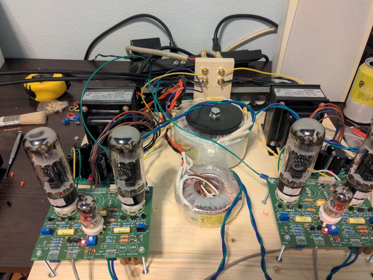

thanks @zintolo, will get an order going 🙂. Voltage at C1/G and C2/G are cathodes voltages, yes? One concern I have is balancing these two with R5, the value is very jumpy. Varying 100-200mv around 0. Also I set it after let's say 2 minutes, after 10 minutes it has drifted some, the same after 1hr. Is there anything you might think of which might alleviate this? Anything I might include in this next order..
No @arteom, C1/G and C2/G are the plate (anode) voltages. You want to adjust them as close to zero as is possible on the volt scale of your meter (NOT the mV scale which could jump around a bit). Exercise your R5 wiper a few time to make sure it is tracking as well as possible.
Ah, thanks Francois. I misread the schematic. Pins 3&8 are cathode, where pins 1&6 are connected to C1&C2.

Just to be clearer. It is the difference between the two plate voltages (as measured at C1 and C2) that you want to adjust to zero. You mentioned you measured C1/G at 152 Vdc, but C2/G is much more and can’t be adjusted adequately by R5. (There is of course a problem! Have you checked the resistance values of R8 and R10?) Both plate voltages to grounds should be about the same when adjusted by R5, and between 150-200Vdc in value (as you noted depending on the supply voltages you use)
Hi Francois,Both plate voltages to grounds should be about the same when adjusted by R5, and between 150-200Vdc in value (as you noted depending on the supply voltages you use)
At this point I'm getting 136V on one of my two board and 140V on the other. Am able to get R5 around 200mv of zero, but it fluctuates up and down. I did try what you mentioned with turning R5 left and right many times, but had no effect.
R8 is 220k. What is weird about R10 is it is a 47k resistor, but when it measure lower when installed on the pcb - 30k. Same R9 and R13.
I am using a 275V HV transformer and 58V transformer for bias.
It's 138V +-1,4%. That's reasonable. Not optimal but reasonable.I'm getting 136V on one of my two board and 140V on the other

@zintolo, the parts I have in use are AS-3T275 - 300VA 275V Tube Transformer, this one for bias voltage AU-0558 50VA 58V / 116V, Hammond 1650N Output Transformers. A pair of these 6.3VAC to 6.3VDC LDO supplies MIC5156 fed from HV 6.3VAC secondaries for the heaters. Besides that a pair of the original boards (with onboard PS), currently stock. Maybe chokes you are referring to are one's on the V2 power supply board? Or I might be very well missing something, as I am sure I am missing a lot 🙃.
Looking at the photo in post 1654 it appears that you are using two power supply boards, one for each amplifier board. Is that correct? What power supply boards are they? There is room for a choke in BH power supply PCB (between the large cap and the relay), or on each original PCB in lieu of R27. Personally, I would not have used two power supply PCBs (as cost saving) but since you have them I assume you are building two mono amps with only sharing the AC transformers. If that is the case you will need a choke for each power supply.
