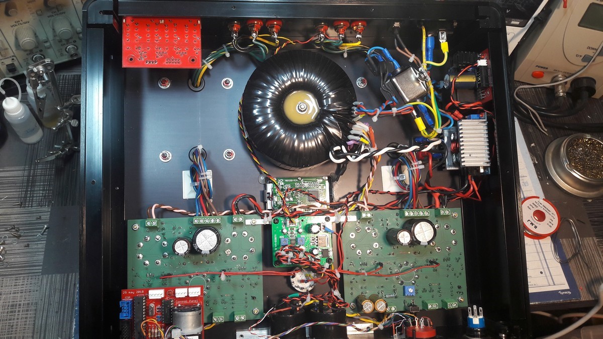

Hello BandoI83
Actually, I have experience in solid-state DIY but this is first time do the tube power AMP. I have some fool questions about the BH EL34 Rev.2 design. The PCB I received and looked the finishing very well. Following are my questions :
1) Can you tell me the board feedback 1&2 points, what is the function and where of the PCB or OTP transformer make this connection, if i use it ?
2) Does this feedback 1&2 is a mandatory make connection to somewhere ?
3) How the circuit (in middle stage) do the phase splitting or phase inverting ?
4) Where shall I do the connection from PCB output 1-2-3-4-5 to the XE-60-5 ?
I intent to use my old Tango XE-60-5 output at primary 5K impedance, and power tube is KT-66. If I deploy this configuration and wants around 35W per channel, then what kind of parts & voltage need to be modified according to the BH EL34 Rev.2 circuit ? Or any better suggestion from you ?

Out of curiosity, Why the hybridness of the amplifier? like the reason for mixing the transistors with the tubes?
Hi ckwong99,
It is funny because you have made solid state amplifiers and you want to try a tube amplifier while I am doing the other way, I have made tube amplifiers and now I am testing a solid state amplifier, only because someone say that the Quasi sound like a tube amplifier Very simple quasi complimentary MOSFET amplifier 😀
I will try to answer your questions :
1) The feedback should be connected to the speaker output of the transformer for a better stability in case of problem, be careful to connect it in the right polarity because it can make an oscillator if unversed, in this case just cross the wire, test at very low volume to avoid a strong sound from the speakers ! Personally I don't use it 🙂 If you don't use it it can be used for a differential input !
2) See point 1, you can leave it open...
3) The phase splitting is made by the ECC83 which is a differential amplifier.
4) I don't have the schema of this transformer but I assume that you should connect P1 (plate), SG1 (screen grid), B+, SG2, P2 to the output connector in this order (see connection info in post 1).
For the Power supply I have already recommended the TOROIDY transformer 250/001 that include all voltages required by the EL34 Baby Huey, see previous post too
You can connect directly the AC voltage to the PCB since there is already diode bridge and a C-R-C filter on board, after you will have tested this easy solution, you can use an external filter, the PCB will accept either DC or AC and the diode bridge will protect you of a wrong connection 🙂
If you are using the 330 VAC please use 500 VDC electrolytic capacitors and 630 VDC film capacitors, otherwise 400 VDC capacitors will be OK...

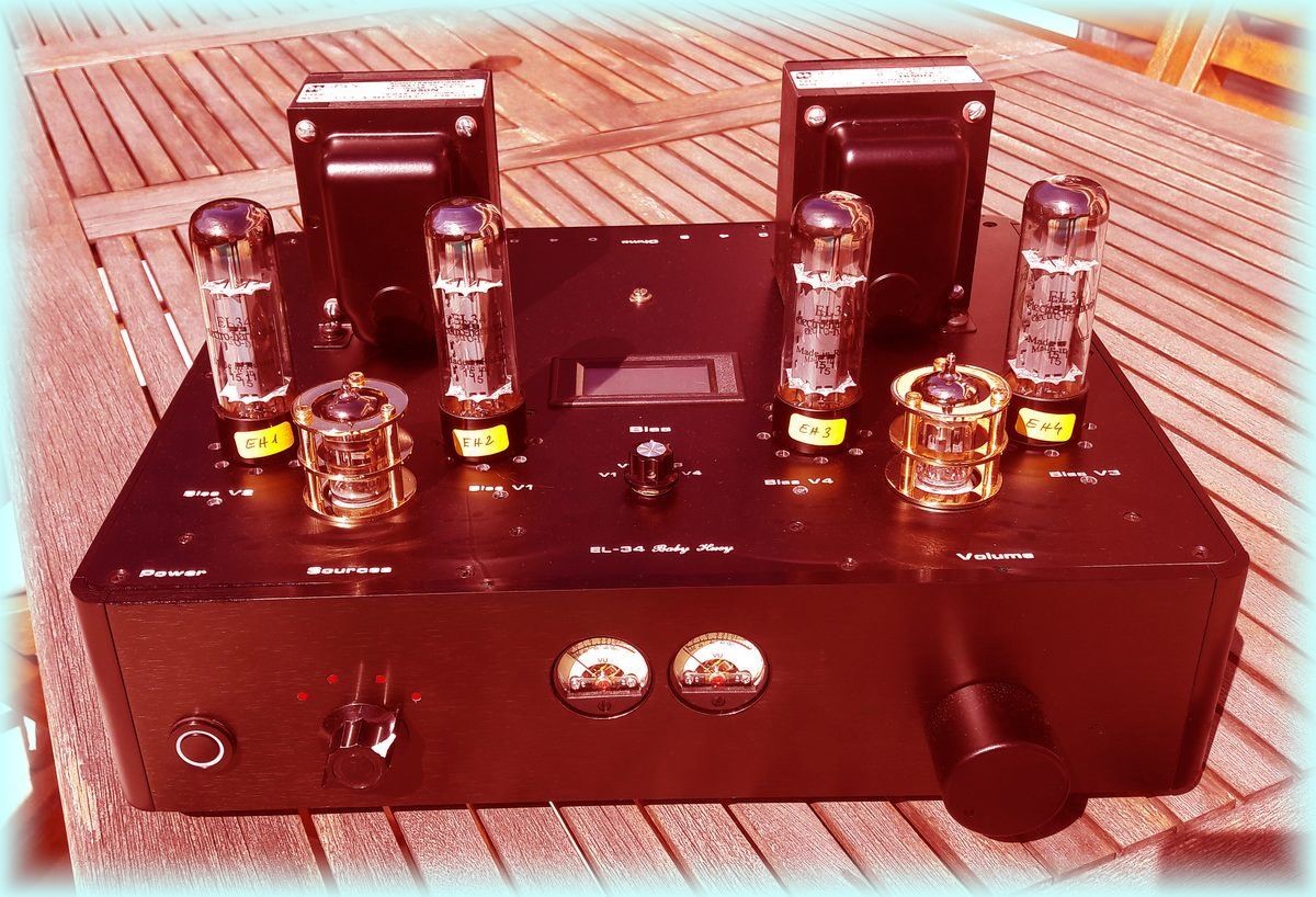

Very nice board, Marc. I am interested in this version, will follow this. 🙂
The op amp is used for the auto-bias because with a stereo quad you will have to adjust 8 trimmers for setting the bias on the 8 output tubes 😡 With the auto-bias, you will adjust only one tube per channel and the 3 others will be automatically adjusted too 🙂
This design is inspired by the very nice TENA amplifier from Norman Koren : The Emperor's New Amplifier and the Baby Huey of gingertube for the shunt feedback and the MOSFET drivers to save 4 tubes ! I don't know yet if it will work since I have not enough knowledge to test it with LTSpice...
I will start a separate thread when I will be ready to work fully on this project, now I want to support the EL34 Baby Huey first and finish my own which will be ready soon now, see pictures... I hope to see also the picture from the others builders, nearly 400 boards have been sold, therefor there could be close to 200 stereo amplifiers...
After this GB will be finish and many will have built the EL34 Baby Huey, I will spend all my time on the quad and I hope that there will be a lot of enthusiasm for the new one too

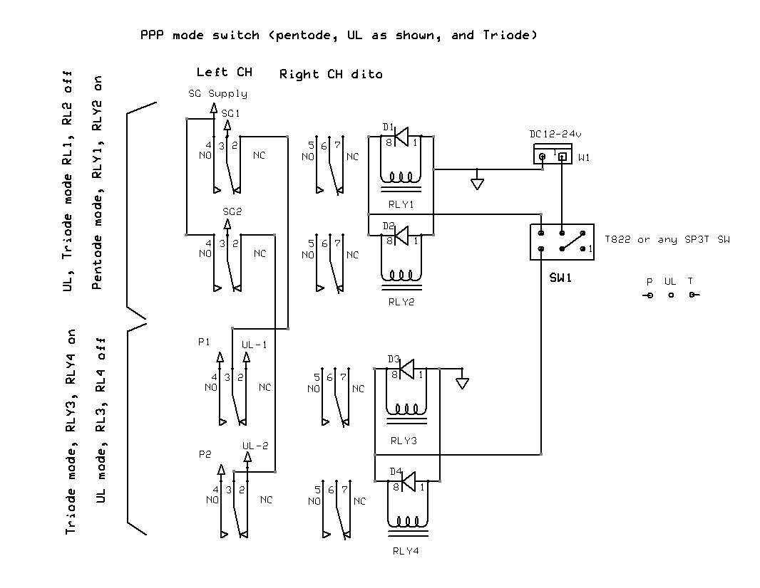

Is it advisable for quad or PPP to have all 3 mode i.e. pentode, UL and triode? An electronic version of relay SSR of the mode switch maybe designed though.

Looks great Marc.

very good layout, I like it much
