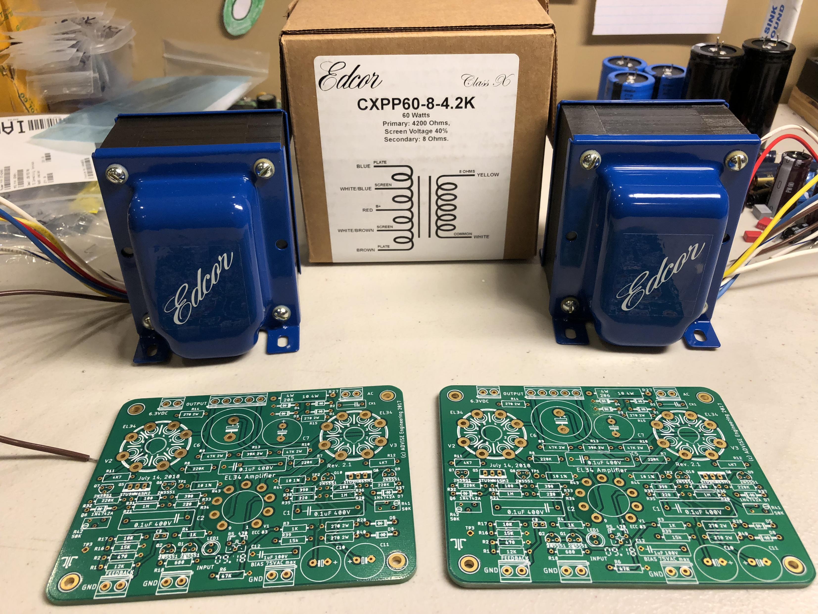

So as i was going through some old project i came across a pair of Edcor CXPP60-6K OPT's. I was going to order something around 4K but since i am not using these other ones for anything right now i figure i would put these in and budget some other stuff for the build...coupling caps...connectors...etc...

Sounds good. You must have some deep parts bins for a pair of output tranys to hide! You’ll get a little less power with the higher Z transformer if you use the same B+voltage but you’ll have a lower Z out.

I know right? I went berserk building amps and preamps for a while. Took a little break and wanted to build again. I have a nice little el84 pp amp but have never built a higher power tube pp amp...
I hear you! I’m saving up parts for 2 PP builds- el84 and the BH with KT88/6550. I already have a PPPkt88 triode mode amp that I want to rebuild to use a feedback scheme similar to the BH and have UL/triode but who knows where that sits on the project stack. I’ve recently gone on a SS First Watt binge and am now shifting back to tubes but first up is an ACA. So much fun and not enough time for everything!

I am pleasantly surprised with how fast Edcor got my OPT’s out to me! I was ready for the 6-8 week lead time, but they were delivered in less than 3 weeks. Sweet!!
I can start the Baby Huey sooner than expected 🙂
Dang I'm ordering the same opts!
