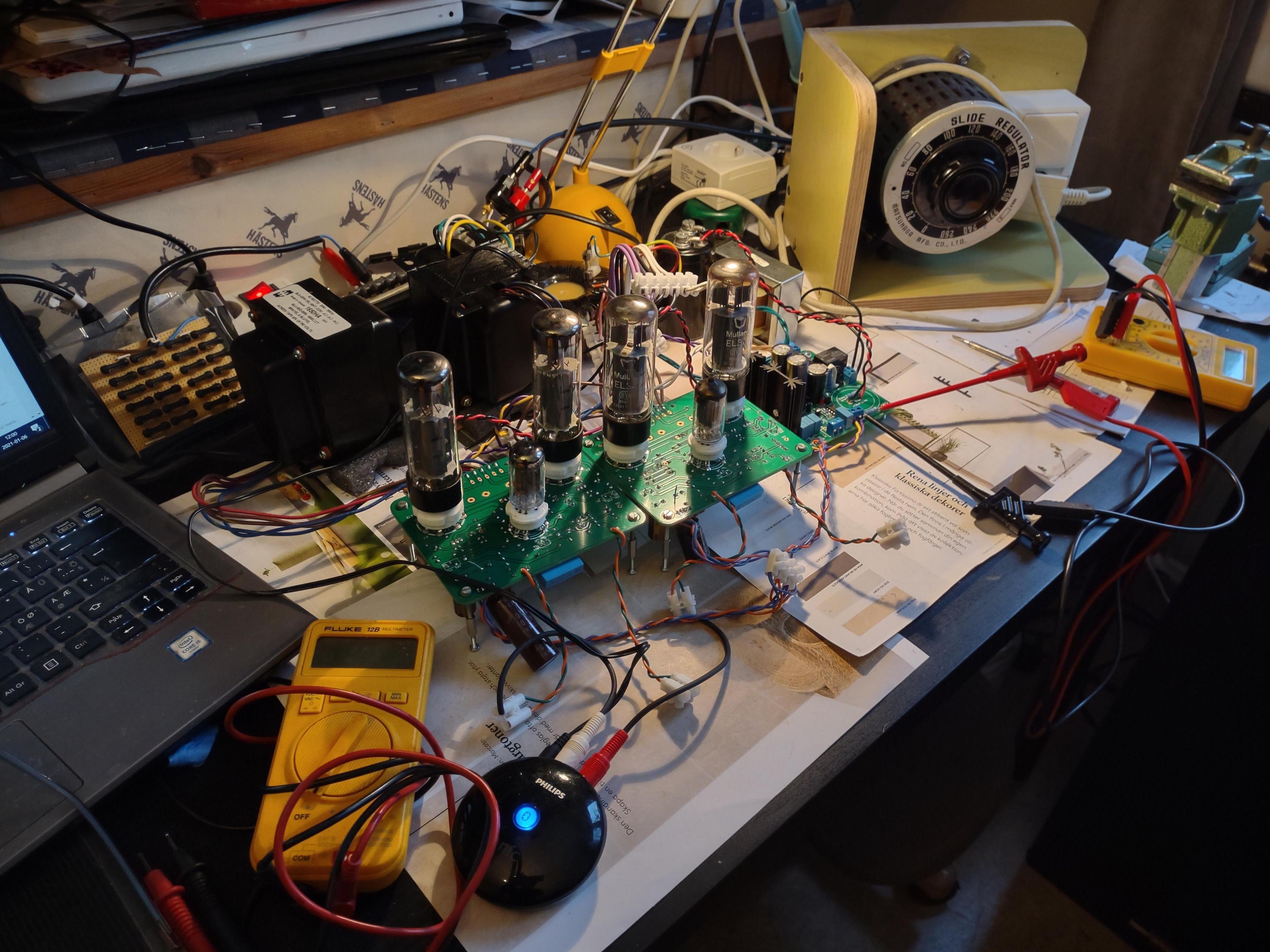

Music has not arrived yet. Lots of fun and games with the resistor values on the PSU board for setting the bias output. Found the relevant info in a post by gbowling (thanks! if you read this), and hope to have the right voltages when I try it out tomorrow. I also had fitted some 1meg resistors from a bag that was marked 10k, and originally thought that would be it.
I have 6 power supply boards, thinking I could use them as a generic supply for future projects, so a lot of fettling, solder sucking and tinkering.

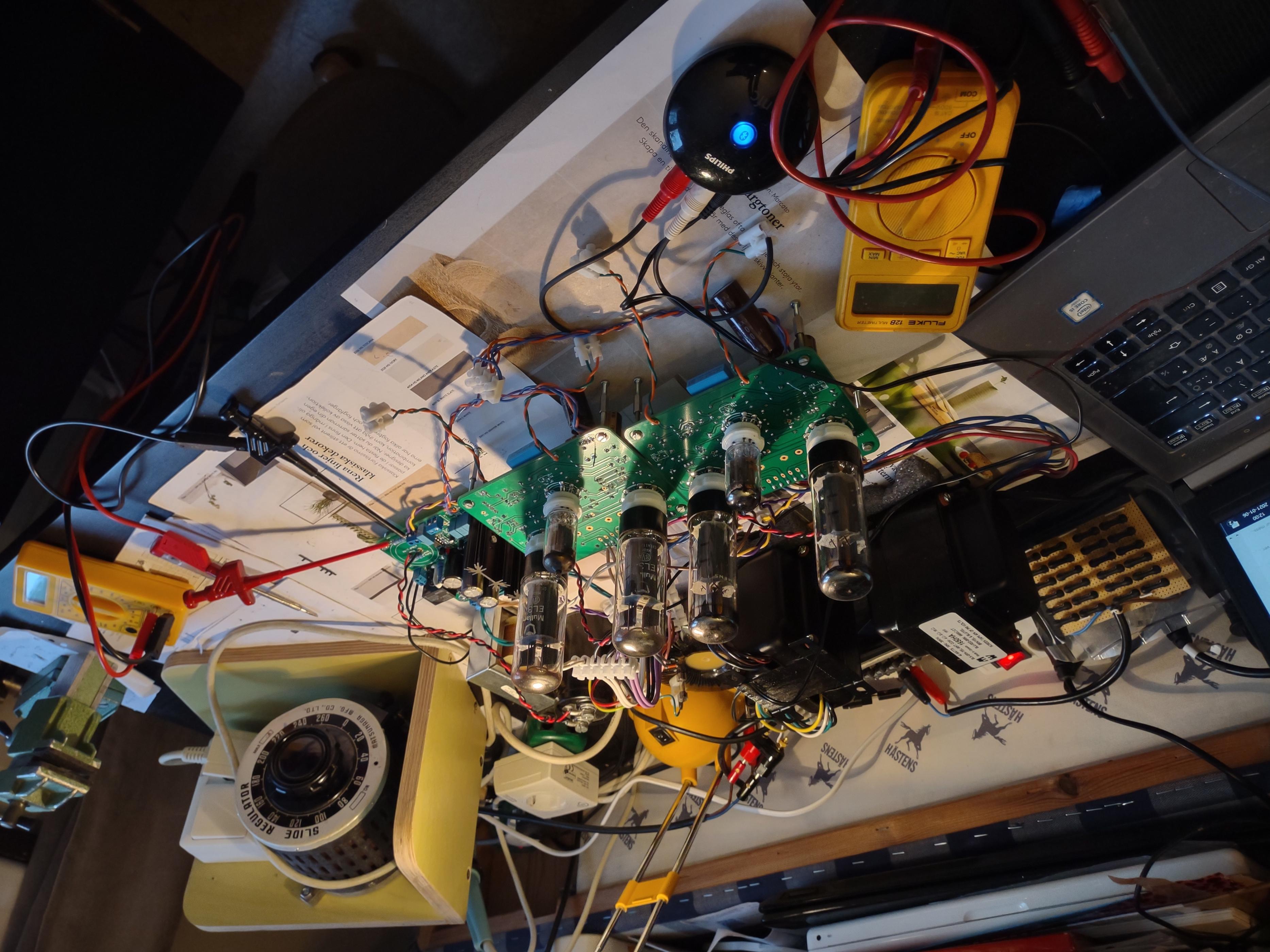

As Brian Wilson wrote, "I can hear music ... Sweet sweet music', and that was finally true today. I have Hammond 1650HA 6.6k output transformers, and it is the first build without toroids. First impressions were good, but maybe not quite the bass punch of the toroid. The EL34 tubes were biased low at 30ma, B+ 416V and I had no feedback, so expecting an improvement.
Now I need to make it presentable, which will keep me occupied for a while yet.
I am hoping I can finish it well enough to find a home for it, so I have an answer for the wife when she says "An amplifier? Why on earth do you need to build another one?" ;-/

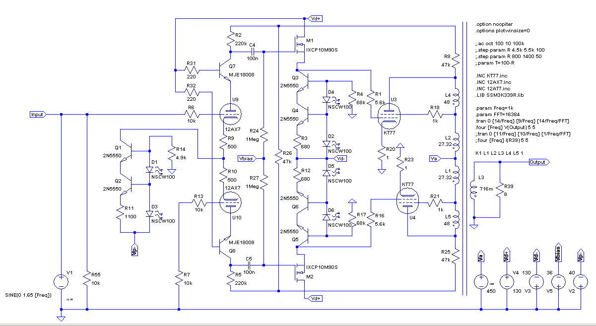

Hi, while playing with my cascoded version (njfet on bottom, 12ax7 on top) of this amp, I tried to simulate the circuit in attachment based on the BHEL34, but with a cascoded PI (12ax7 on bottom, SS on top).
This is the result with no global negative feedback, B+ 450V and 6k6 Raa at 40 Wrms:
Has anyone ever measured his BHEL34 to compare, or wants to check this solution on the boards?
R9 and R10 can be reduced in order to increase gain (at the expenses of less current lnfb) and apply some gnfb if needed.
R15 is there just to drop some negative voltage and improve the PI.
Vd are set to 130V for two reasons: it's the perfect reference voltage for the cascode and it's around 3 times the negative bias voltage (needed to properly supply the PowerDrive).

Interesting results! Is this what you plan to build?
If you don’t mind, could you include a schematic for those of us who are not LTSpice savvy? I believe you can capture that from the simulation file.

Francois, in attachment there's the schematic.
I've noticed the 3rd harmonic has an optimum when the current through the leds of the CCS of the PI is 6.8 mA vs 2 mA suggested by gingertube in the BH EL84 thread. Is it a simulation trick or it will be replicated in reality? Anyone knows?
I've seen those CFB transformers, but this cascoded driver is not enough for it.
Here I'm swinging 66Vpp to reach full power, but with 10% cathode feedback I'll need to swing 142Vpp that is 66Vpp plus 2 x 10% x (450 - 70)Vpp.
It is not possible to have the right gain nor the right THD from this cascode driver. I've reached 1%THD from a single triode of a 12AX7 using Rod Coleman's shunt cascode driver at 250Vpp without any feedback, but then it's needed to add a mosfet concertina or to add another complementary shunt driver. In that case you'll get very low THD, very high damping and again no gnfb.

Roberto,
Thanks for providing the schematic and persisting after the forum deleted your attempt to post! This one is very informative.
Thank you also for your reminder about CFB transformers - I forgot about the additional drive requirements with them. I will have to learn LTSpice to play with and balance these things and devise a proper drive circuit for those Toroidy TTG-CFB6600PP transformers in the closet.
I don’t know if it is a simulation artifact, or some other cause, but I am dubious about the “optimal CCS current” result of >6 ma for two 12AX7 triodes. See the chart below.
