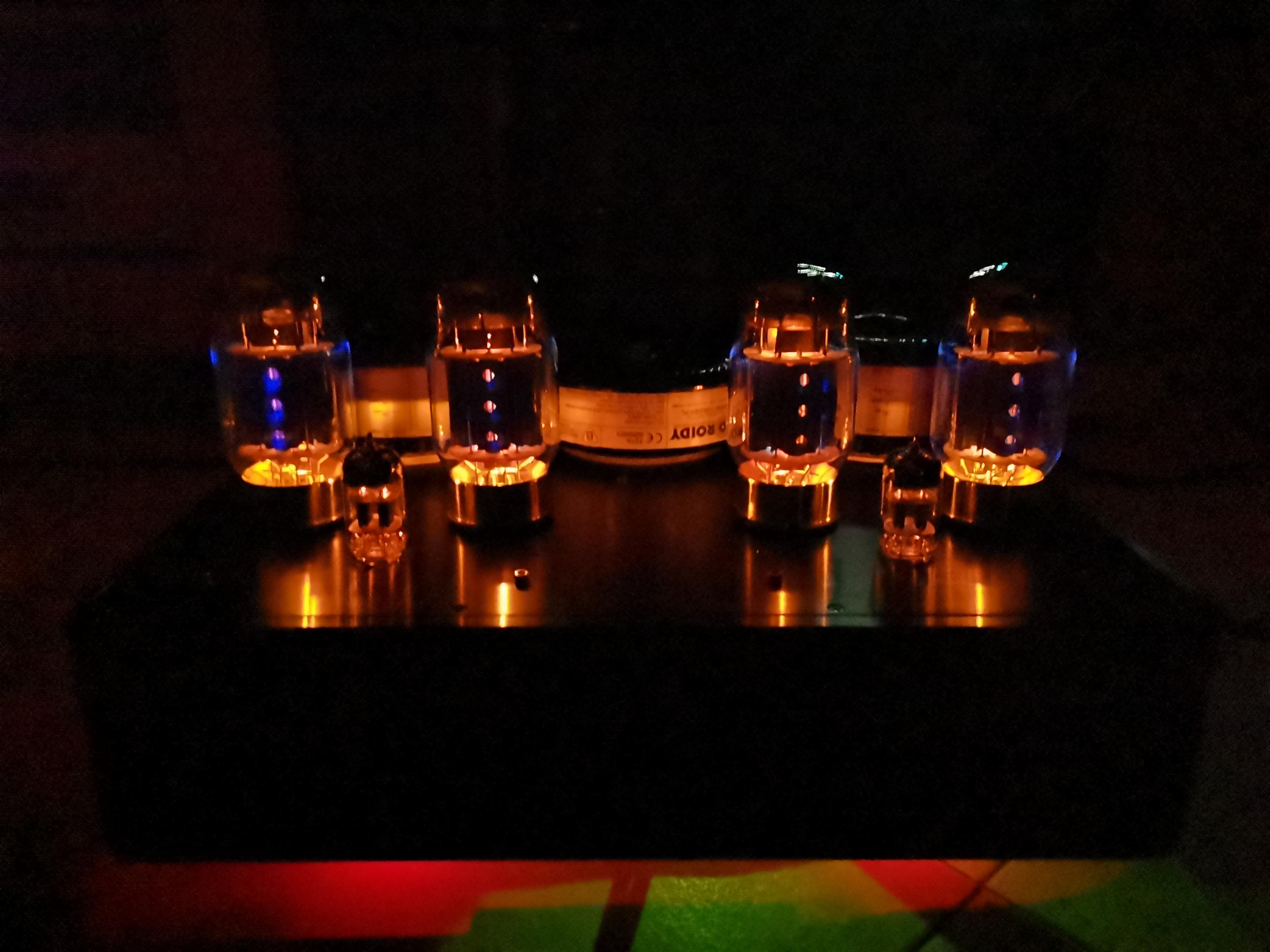

Hello, first try of my baby huet tonight and for the moment I can say that it sounds quite good, I just have to finish the box and improve the wiring because I have a slight buzz on the speakers but nothing serious .I have set the bias at 43ma for the moment I will increase it more afterwards, is it normal that its oscillates the voltage on the tp3 and tp2 adjustment points it is not really stable at + or - 20mv?It varies between 420mv and 440mv for my adjustment at 43ma.
And thank you gabo for the advice on the potentiometers you have to turn them fully clockwise before the first start to have a minimum bias.

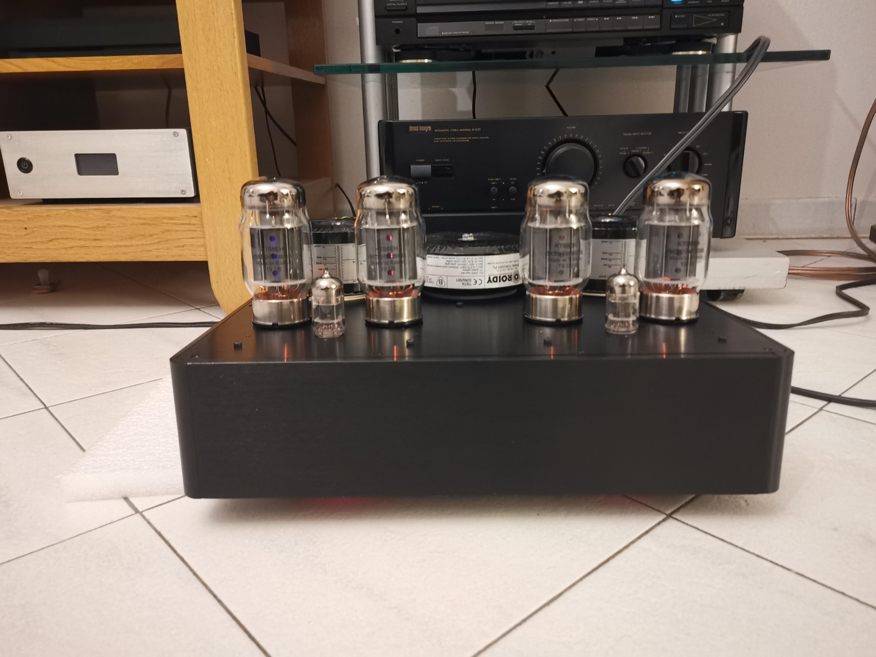

Steven, wow that is one beautiful build! Great job. Your previous photos showing the inside and your modifications for the new relay show how excellent your work is. It takes a lot of patients to get it that neat and perfect. I always get impatient and convince myself that spending hours trying to get wires exactly right doesn't make it sound any better. But in reality it DOES make it sound better! I always admire those who can do it! Kudos to you!

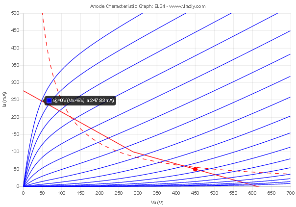

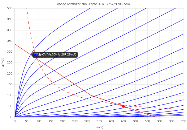

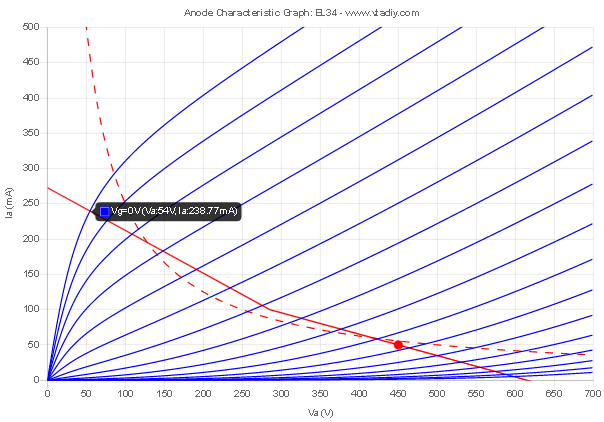

I was looking to other possibilities for the OPTs:
TTG-CFB5000PP - Tube output CFB transformer [5kOhm] Cathode Feedback Push-pull - Shop Toroidy.pl
Without using the CFB it would become a:
5 kOhm Raa * 0,9 * 0,9 = 4.050 kOhm Raa
33% UL / 0,9 = 37% UL
TTG-CFB6600PP - Tube output CFB transformer [6,6kOhm] Cathode Feedback Push-pull - Shop Toroidy.pl
6.6 kOhm Raa * 0,9 * 0,9 = 5.350 kOhm Raa
TTG-CFB8000PP - Tube output CFB transformer [8kOhm] Cathode Feedback Push-pull - Shop Toroidy.pl
8 kOhm Raa * 0,9 * 0,9 = 6.500 kOhm Raa

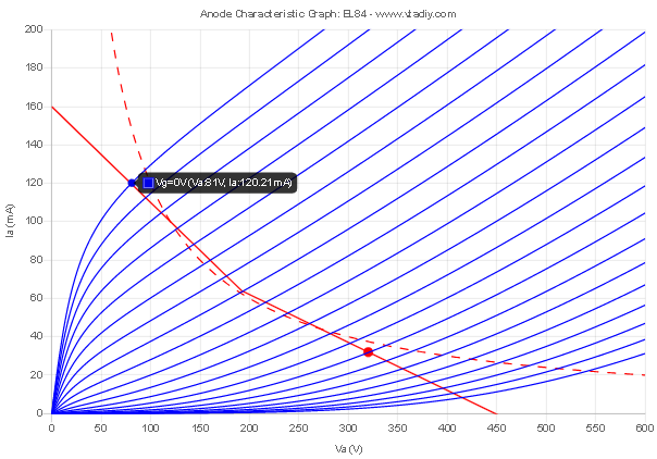

Just thinking loud for a comparison between the EL84 and EL34.
EL84 at 43% UL (even not considering the "triodesque" effect of the shunt feedback), 8 kOhm Raa and 320V: the loadline drops in a very linear region of the curves:
EL34 at 37% UL, 4.050 kOhm Raa and 450V: the loadline drops in a very linear region of the curves, but at something less than twice the max dissipation of the tube (being in class AB it the tube will be off around 50% of the time, so the avarage value will in any case be lower than 25W:
EL34 at 37% UL, 5.350 kOhm Raa and 450V: the loadline drops in a less linear region of the curves, but in a better area for the plate dissipation:
EL34 at 37% UL, 6.500 kOhm Raa and 450V: the loadline drops in a even less linear region of the curves, but in an even better area for the plate dissipation:
Considering that the internal resistance of EL34 is half the one for EL84, both in triode and in pentode mode, a Raa of 4 kOhm (so half of BH EL84's 8kOhm) could be a good choice, but I would say at 400 Volt instead of 450V, not to exceed too much the plate dissipation.

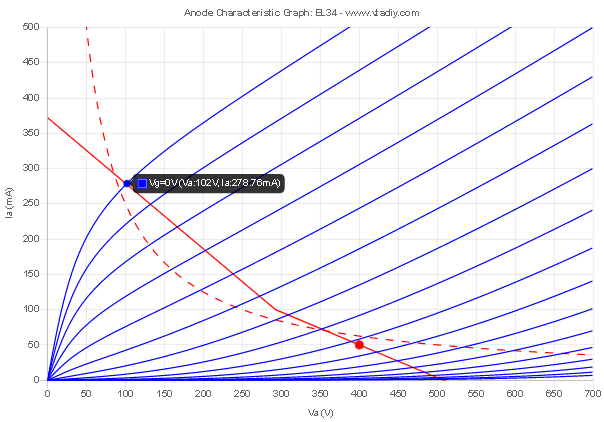

Other options are:
TTG-6AS7PP - Tube output transformer [5kOhm] 2x6AS7G / 2x6N13S Push-pull or similar - Shop Toroidy.pl
EL34 at 43% UL, 5 kOhm Raa and 400V: the loadline drops in a very linear region of the curves, across the max plate dissipation , and around 40 Wrms as the transformer is rated for.
This could also be a good option for a 80 Wpc amp with a quad of EL34 per channel and 2k5 Raa.

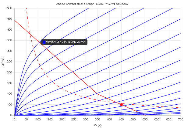

Then there's the other Toroidy's option we were talking about:
TTG-EL34PP - Tube output transformer [6,6kOhm] 2xEL34 / 2x6L6 Push-pull or similar - Shop Toroidy.pl
EL34 at 43% UL, 6.6 kOhm Raa and 450V: the loadline drops in a less linear region of the curves, across the max plate dissipation.

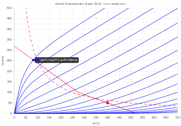

This is the other Hammond's option we were talking about:
https://www.hammfg.com/files/parts/pdf/1650N.pdf
EL34 at 43% UL, 4.3 kOhm Raa and 400V: the loadline drops in a very linear region of the curves, across the max plate dissipation.

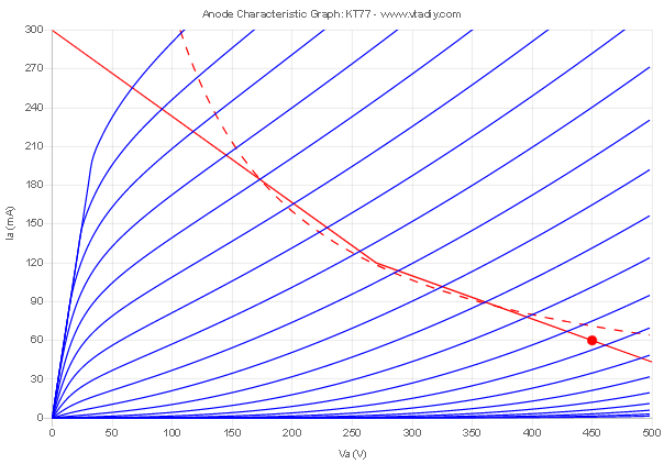

A better candidate seems to be the KT77 at 43% UL, 6 kOhm Raa and 450V ( https://shop.ehx.com/catalog/addimages/kt77-genalex.pdf ):
Hi, how do you compare this amp with KT77 vs the one with 6V6GT vs the one with EL84? ThanksFinally got my build done.
Running B+ of 470V, KT77 output tubes into Hammond 1650P (6K6 Raa) and R13 (the shunt feedback set resistor) at 18K.
