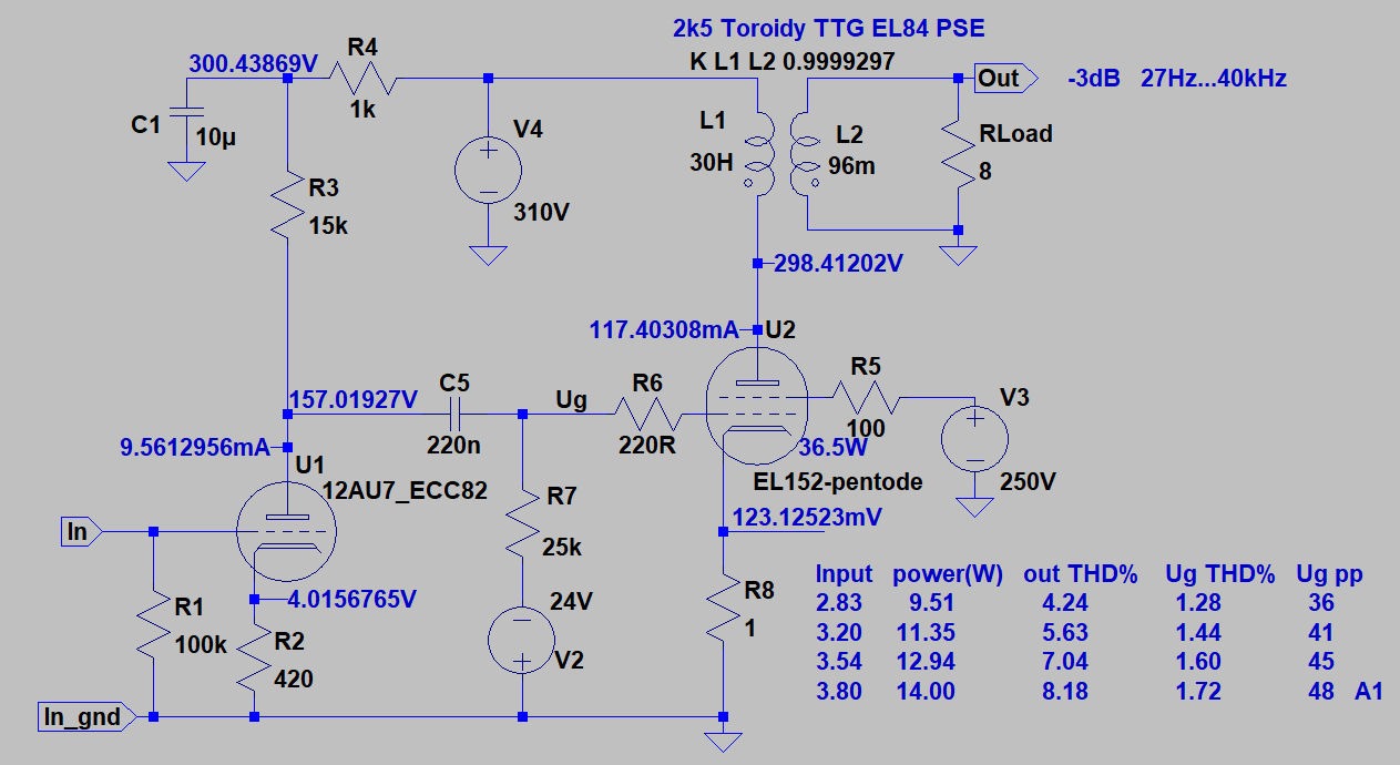

Yes fixed bias has risk, self bias has advantage.I had a look, G1/G2 mu seems not listed.
But the triode curves reveal mu to be ~3.
That is thermal runaway territory using foxed bias.👎

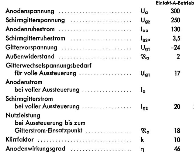

Like famous 805 or 211 or 10Y , EL152 is RF power pentode. In my memory, Telefunken EL152 sounds like Telefunken EL156. Telefunken power tube has its sound signature. Actually I can upgrade my EL152 amp to EL156 amp by changing power transformer and minor modifications.Here's the most comprehensive datasheet that I'm aware of. You see it's a rather universal power tube, although having been designed for RF applications.

Fortunately there are good and useful documents on the E/FL152 tube in the web. In addition, you may consider a look at the GU-50 which also is a descendant of TELEFUNKEN's LS50 or RL12P50.

Please have a look at the datasheet's page 1. The parameter »Schirmgitterdurchgriff« is the inverse (= 1/µg2g1).I had a look, G1/G2 mu seems not listed.
Note that LS50/EL152 etc. nothing have in common with the much more recent, post WWII EL156, besides the manufacturer, of course 😉 .

IMHO the "main" problem -not only the THD- is tube's enormous impedance (pentode mode), so to find appropriate OPT (150-200mA saturating current, enough large inductance) not an easy job.We will equip spectrum analyzer soon.
Most OPT's inductance (in this range mainly not larger than 30..40H) isn't "enough" for good LF bandwidth, so optimal loading is problematic.
Sample:
The other "problem" is the relatively low B+.
This tube's anode voltage swing sooner ruins out (below 50V) if the operating point's anode voltage is 300V, so the THD relatively high even below estimated output power.
See Ale's measured curves.
https://www.bartola.co.uk/valves/2020/10/23/el152-pentode-spice-model/
If you see the curves, the suggested loadline rather 4k than 2k.
BTW the coupling capacitor with this first stage large output impedance and EL152 required grid leak resistor is LF limiting factor too, so increasing it to 0.68-1uF helps.

Your simulation is so nice and elegant.IMHO the "main" problem -not only the THD- is tube's enormous impedance (pentode mode), so to find appropriate OPT (150-200mA saturating current, enough large inductance) not an easy job.
Sample:

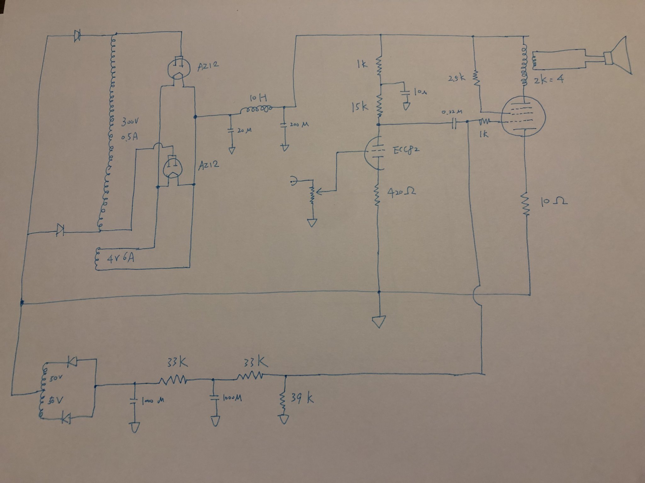

The output transformer primary winding is around 3000 turns and current capacity is 250mA. I tradeoff between primary inductance, primary winding and primary DCR. For the next EL152 amp I will raise OPT impedance. Low anode voltage and high current profile of EL152 are challenging in component selection. Large current causes large voltage drop in choke and OPT.
Best Regards,
I use EI size 86 (86mmx74mm), lamination 60mmYou should go with E16 or E20 lamination and 20...25 sqcm.Keep the magnetic core square.
Correct it. EI size 96 (96mmx86mm) , stack 45mmI use EI size 86 (86mmx74mm), lamination 60mm
