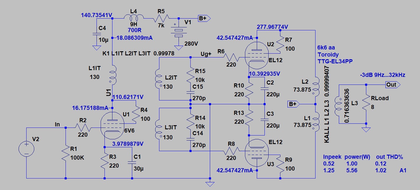

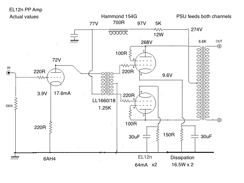

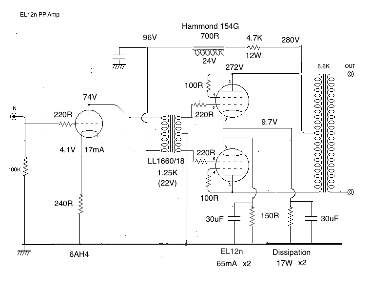

EL12n Push Pull amplifier
Encouraged by the good sound of the PP EL12n amp, I built a SE version. Fortunately it maintains the good sound of the PP version.
Right now I have the EL12n outputs going into a pair of nice Japanese Tomiko 5K OPTs. This is crying out for a DHT driver, since mu is 18 in triode and it doesn't need the 1:4 step-up on the input I use with 2a3/6C4C outputs. Dissipation is 18W stated max.
Driver at the moment is CV1135, a nice version of the 6J5 with 2 top-caps. Sound is good but will be much better with a DHT driving it. The 46 in filament bias will be one I'll be trying. The 2P29L is an easy build and would sound good too, as would the 112A.
I really recommend the EL12n or indeed the EL12. Excellent sound and it gives you a choice of drivers from mu = 5.6 upwards.

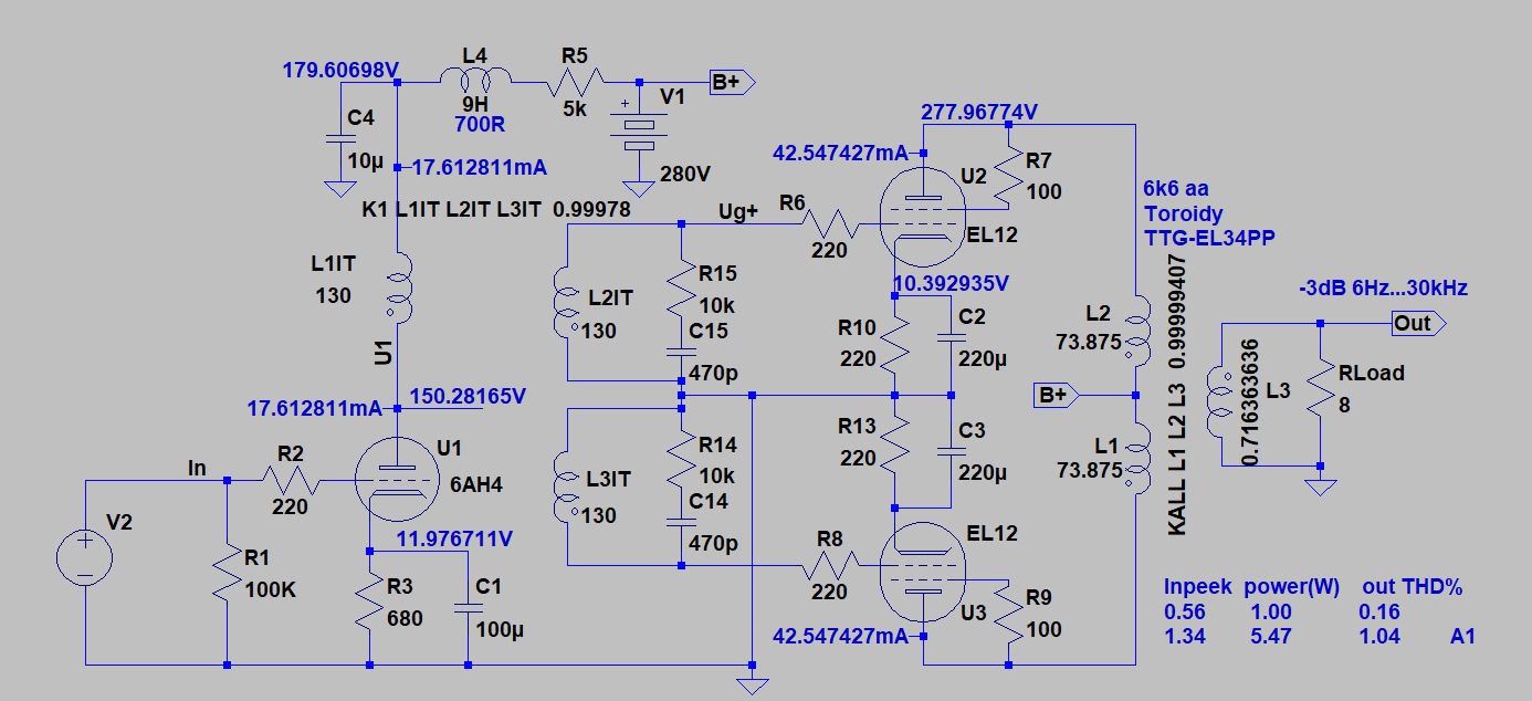

I've tried 4 different drivers so far for the EL12n.
  • The 6AH4 was disappointing - I'll have to revise the circuit because I've heard it sounding better.
