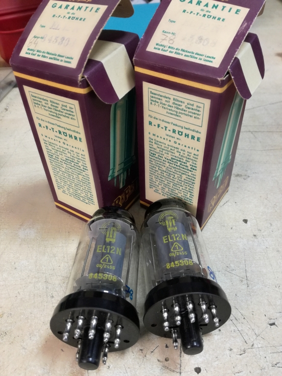

I compared by measuring (Neuberger-RPM370 tube tester) a pair of EL12-325 (I don’t currently have an EL12-375 with me because I built them into a guitar amp I last made) with a pair of EL12N.
Even EL12-325 does not show any traces of instability at Ua = Ug2 = 425V, and G2 shows no traces of overheating, current increase and secondary emission even after ~ 1 hour at Ia ~ 40mA (Pa ~ 17W) which is quite on the limit of maximum allowed possibilities for EL12N as well! The G2 current was very stable and ranged between Ig2 ~ 3.9mA and Ig2 ~ 4mA.
I can’t say with certainty that all the EL12s produced in the “Mühlhausen tube factory” are actually EL12N, but they certainly speak in favor of durability and build quality.
No difference can be seen in the pictures between the EL12N and the EL12-325, except of course in the print on the glass.

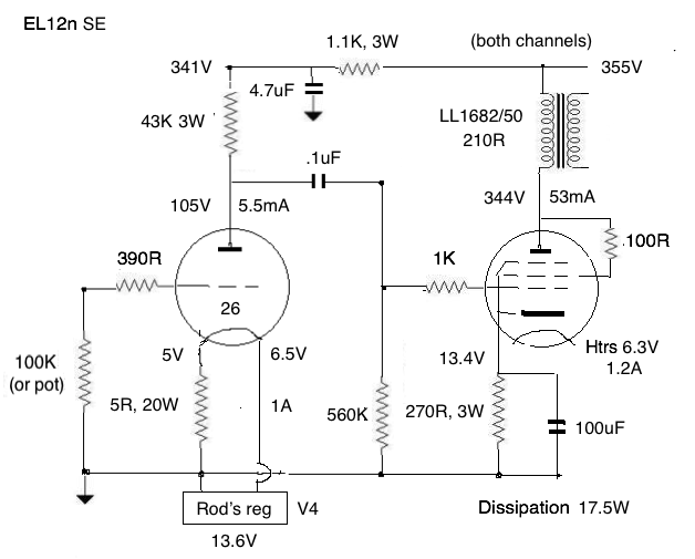

Well, my EL12n arrived and I've been doing some listening. I'm using it in triode as a driver for 300b outputs. It's set up with a big NP Acoustic amorphous core plate choke, 180H, and Russian teflon FT-2 coupling caps. I have around 20mA going through it, a-k around 160v. Bias around 4v, no cathode bypass. It's clearly a good valve, no doubt about that, and well worth the relatively cheap price from European dealers who seem to have quite a few of them.
So - listening impressions. Sound is clear, clean and has plenty of details. Tonality is neutral - not warm/euphonic like a 26 DHT but not flat/lean either. Right in the middle, I keep returning to "neutral" which seems to describe this tube well. I'd say it is quite involving to listen to, it holds the attention. Strings are particularly good - resonant but still smooth, quite lifelike. It's not lush on vocals like a 26. Vocals are cooler - not so warm and forward, but not flat or boring. Again, natural and neutral. This is all exactly what I'd say about the teflon FT-2 caps I use - very detailed, neutral, clean. The sound could probably be warmed up a little with boutique paper in oil coupling caps if this were desired.
I've only done some basic comparisons, but I think I'd say I prefer listening to this in triode as a driver, rather than EL84 or 6V6. It was also more involving than an E80L I tried which was in many ways very nice and better than an EL84, but had a slightly cooler presentation.
I'll leave this in my system for a while. Listening to Meistersinger/Solti as I write and enjoying the sound. It's good on classical music. Natural and very easy to listen to. I have no idea if tubes burn in - these were straight out of the box. So altogether a positive recommendation - I like it. The EL12n in hifi is a definite "yes".

What amplification do you arrive at with these settings? How well does it present the low bass register compared to EL84 on 20mA?
Mu is listed at 18, EL84 is 20. Deep bass is there, though not out of balance with the rest of the frequency spectrum - this is from a listening point of view. I'm unable to take measurements.

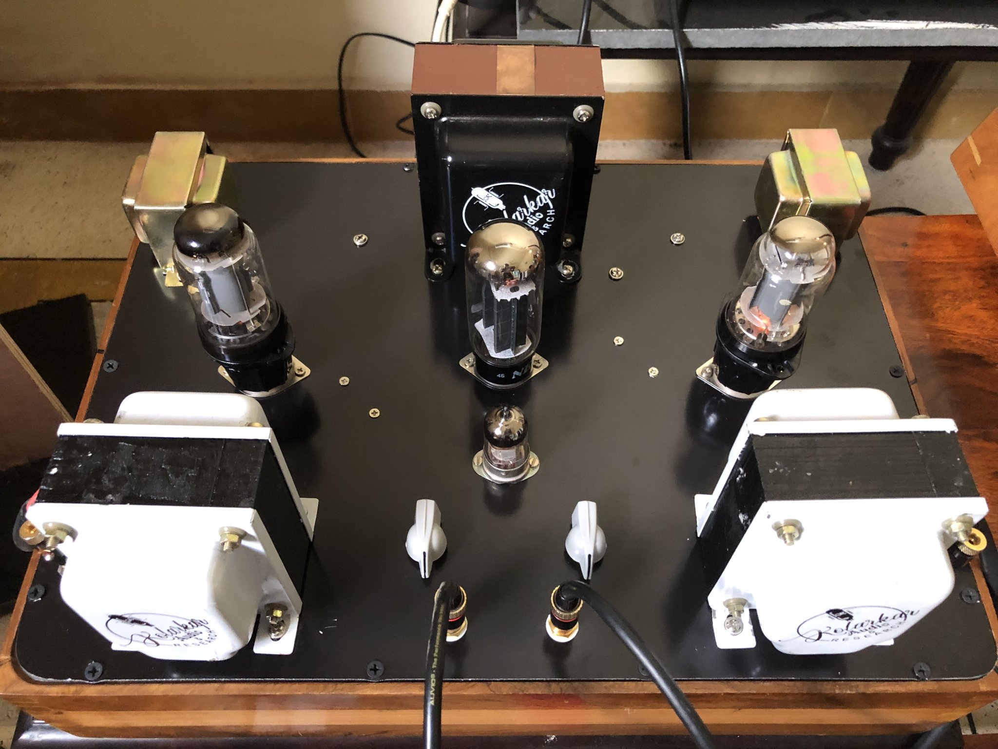

EL12N playing with diy converters. The amp sockets are octal and I play 6L6, 807 and tried F2a too.
Output transformers are Nickle permalloy and handwound.
Power supply is 5U4G tube rectified and quasi monoblock based on Graetz Bridge connecting concept. 6N2P at driver stage.
I'm surprised you need a 6N2P with the EL12n. I'm using a 26 in a 2 stage amp. See the 26 preamp thread. Plenty of gain in triode with the EL12n.
