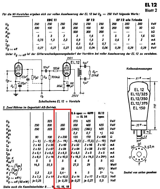

Why 125-130 Ohm? The datasheet TS posted, gives 90 Ohm for single ended operation and 2 x 350 Ohm for class AB push-pull operation. In the note it is stated that for push-pull operation using seperate cathode resistors is mandatory (probably because of the high transconductance of the EL12N).
But maybe you were thinking of a different way to use the EL12N than in the datasheet.
For a voltage of 350V (as approximately in a QUAD II amplifier) and a Push-Pull connection a pair of EL12 tubes needs a pair of 250 Ohms resistors, which result in 125 Ohms when replaced with just one. Due to the slightly lower current consumption of the EL12N compared to the KT66 (not much!), the voltage could be slightly higher than ~ 350V, so a value of ~ 130 Ohms for the cathode resistor might be more accurate. I have experience with EL12N because I made several guitar amplifiers with them with almost the same voltage conditions and I can say that they are very high quality, stable and tonally pleasing output tubes.

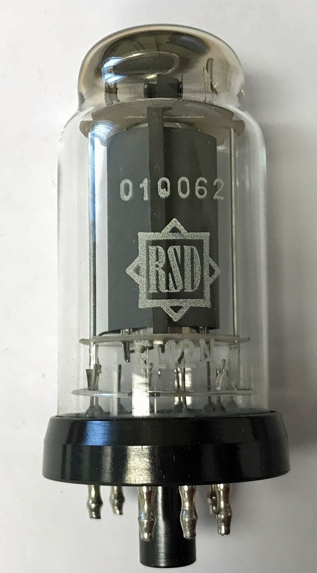

The EL12N has been prduced exclusively at the Mühlhausen tube factory in former GDR. In it's data and ratings, it is an equivalent to the old TELEFUNKEN EL12 Spez, but has it's plate connection brought out to the socket instead of a top cap. Pinout is the same as with the EL12, but it's construction, omitting that pinch stem, is much newer.

Yes, very curious. They look identical and specs are same except for height 95mm EL12n and 110mm EL12/375.
There was an ST version it seems. Says "different maximum ratings" so maybe it could take more power. Looks like 375 is the maximum anode voltage rating. "A suffix /xxx indicates the max. voltage this tube is especially selected for, otherwise it's 250 V."
